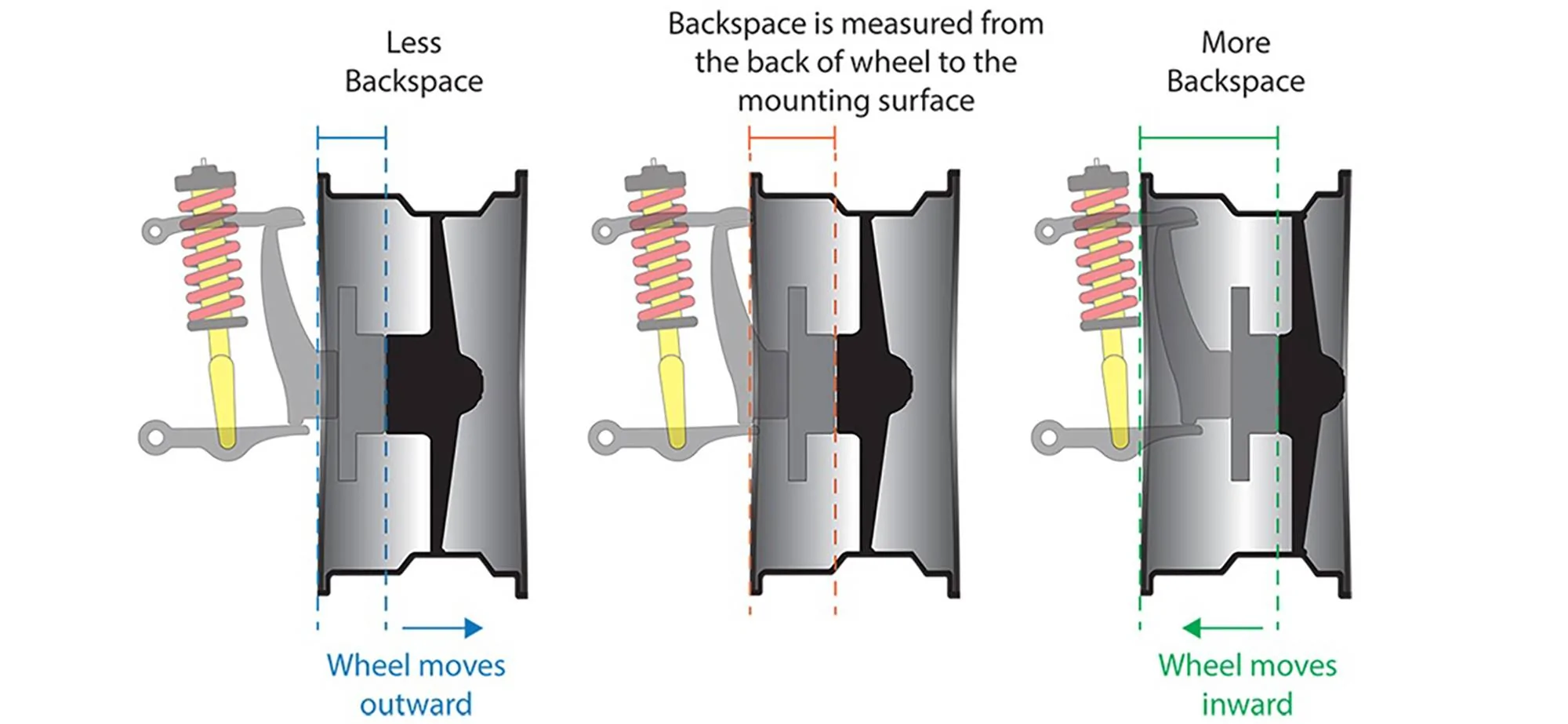

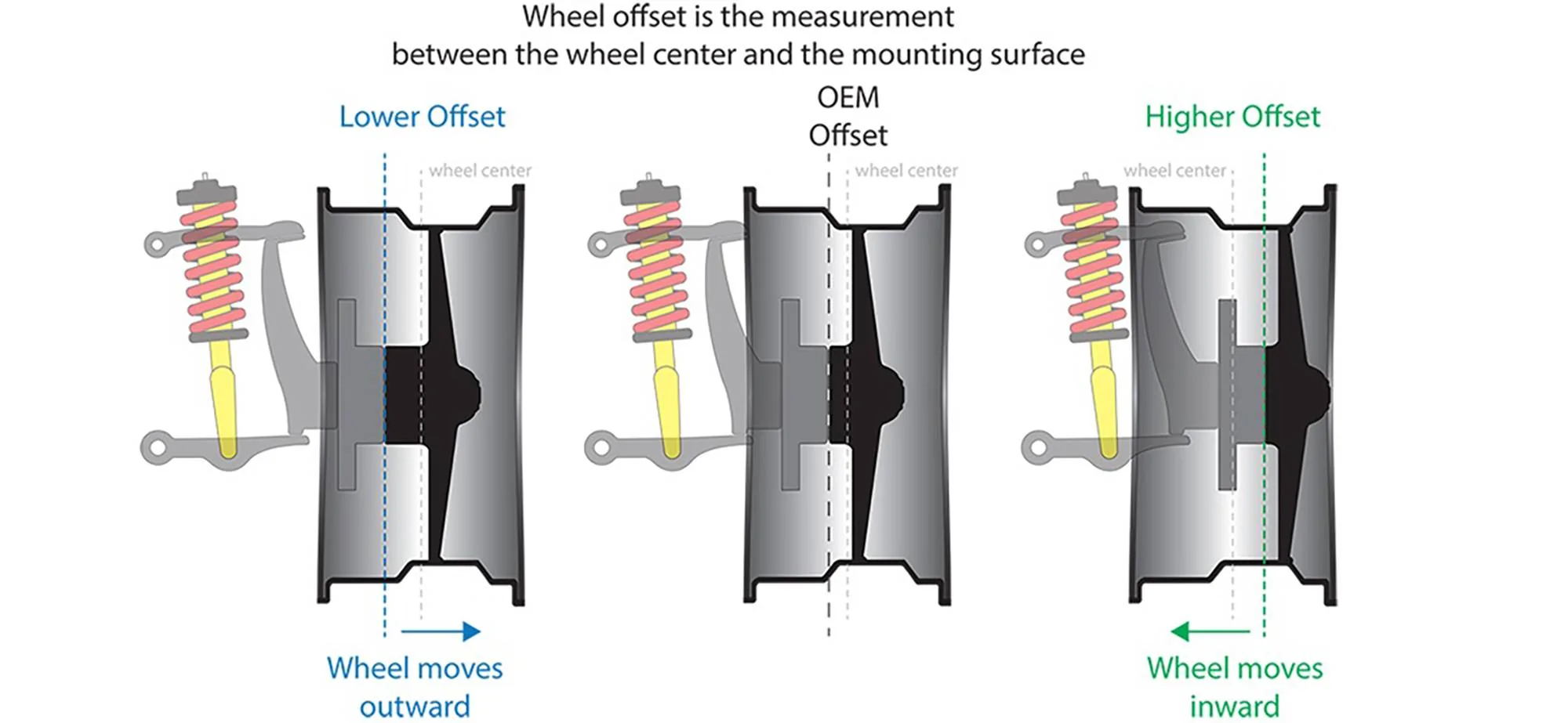

Here are 2 diagrams that explain the difference/similarities.
Thanks. That helped my pea brain slightly. Now I just have to check to see if for some crazy reason the manufacturer would change offset/backspace for a spare that would be different from offset/backspace on running tires/wheels. Could I determine that from any of the numbers on the wheel, if there are any?
