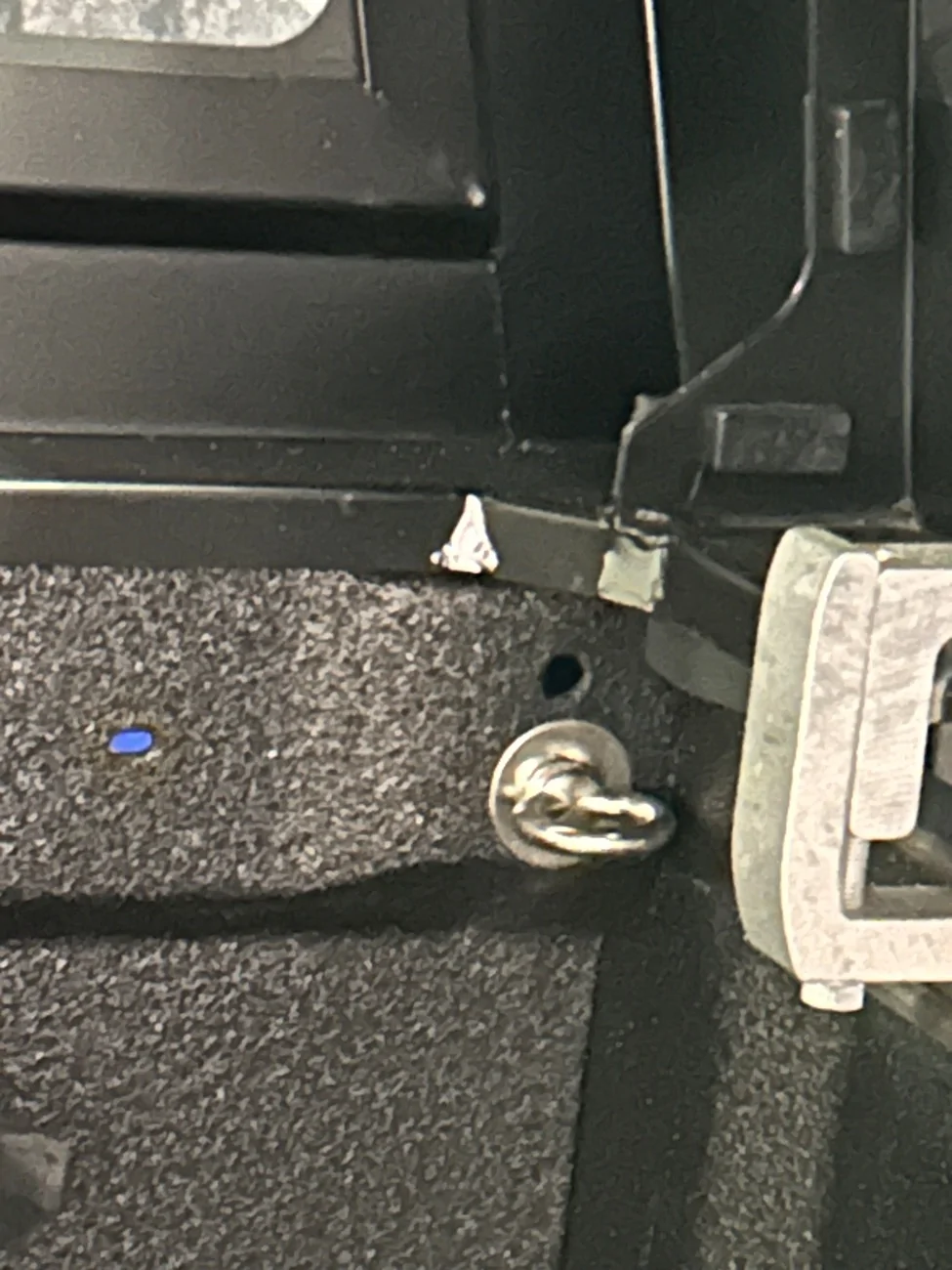

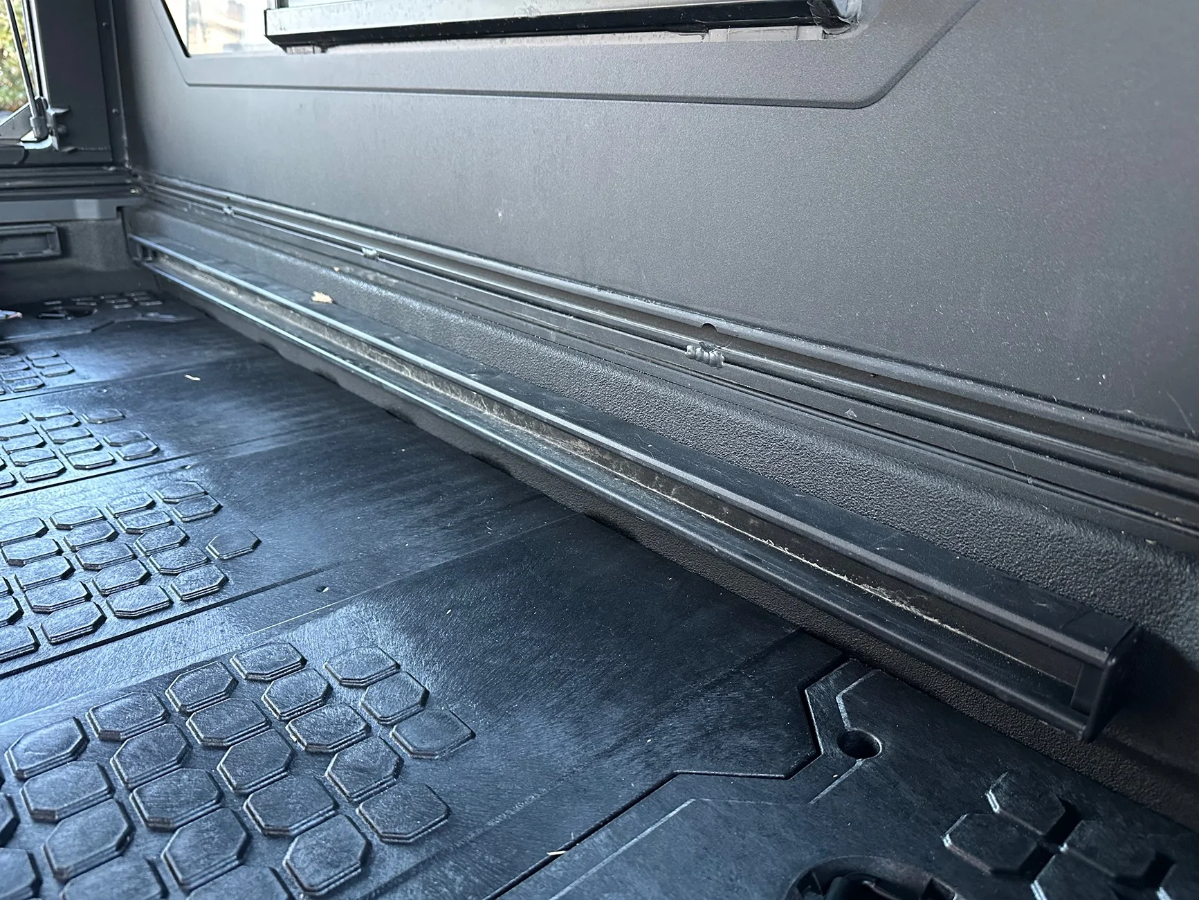

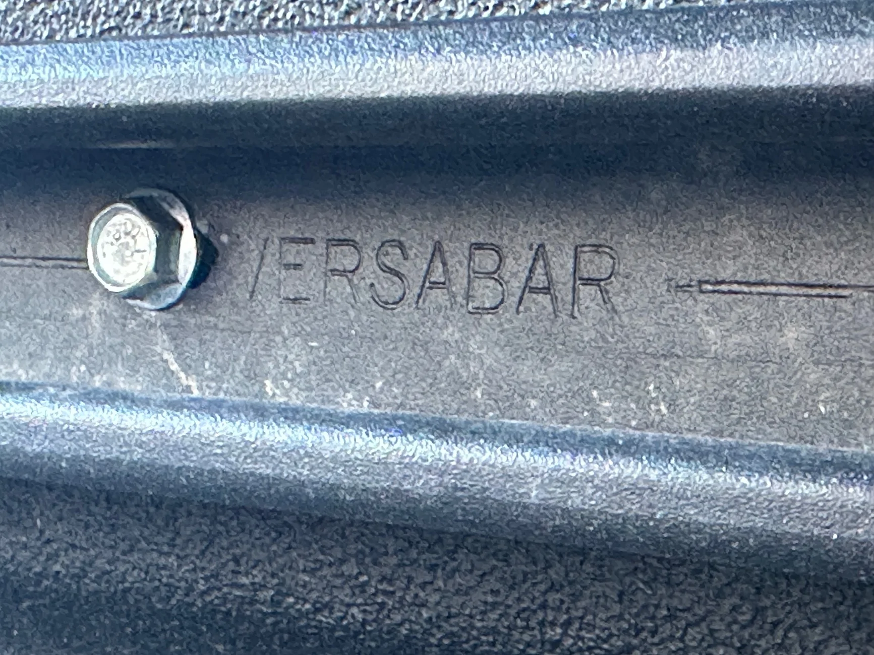

I just bought a used Alu-Cab Contour Canopy. The owner supplied some third party rails to mount the canopy. They didn’t come with any tie-downs. They are only marked “Versabar.” I can’t find any information on them in an internet search and I would like to find some tie-down eyes that will work with the Contour Canopy mounted (meaning they don’t have to “slide-in”).
Does anyone know anything about them? Eyeballing them makes me think that standard U-Channel nuts may work. If that is so, there are some eyes on amazon that may work, but I would prefer not to just pull the trigger on them if anyone knows that they won’t work.

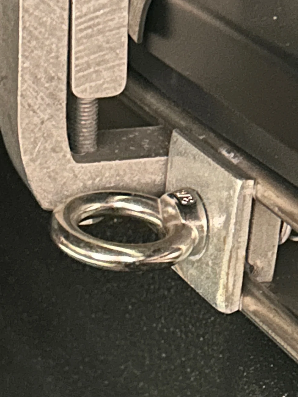

Versabar is a strut, like Uni-Strit, B-Line, Kindorf which as all seem to meet the same specs. I have not used Verasbar and am not sure who is a supplier, or even if they are around anymore. I used stainless
b-Line strut in my bed and used standard spring nuts, square spacer and a stainless eye bolt that had a threaded stud on end. I would take the chance Amazon , or stop at Home Depot and shop the strut, better yet would be an electrical supply house. I’ll post a picture of my setup….Jack

Couple pictures of mine you can see the spring and spacer …Jack

That is pretty much what I am looking for I wasn’t sure if the U-strut nuts would work. Guess I can always just return them if they don’t. Thanks
