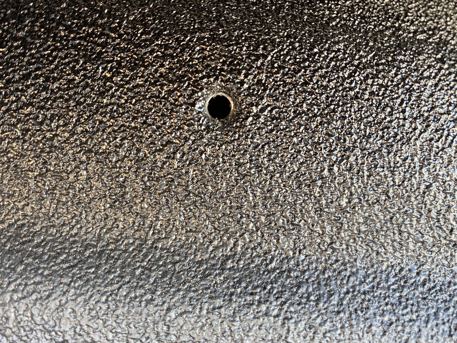

Guys, I have a JT Rubicon with spray in factory bed liner. I was trying to install the Mopar bed rails but threaded holes in the bed have the bed liner coating sitting in it for first couple of mm. It’s not allowing to start the bolt. How should I get rid of it and what is the best way to go about it.
Thanks for your help

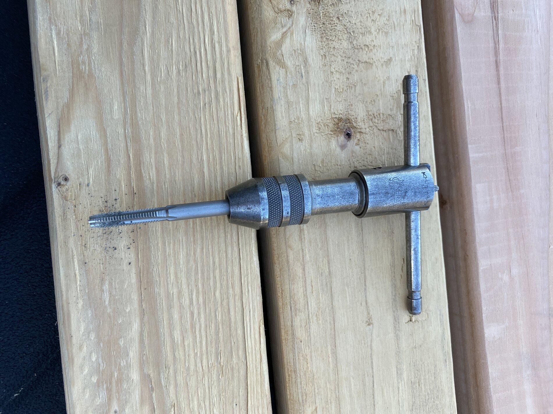

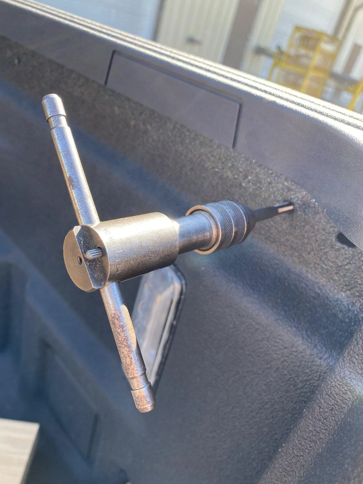

Jeep Gladiator Installing Bed Utility Rails IMG_0086
Worked perfectly.

Is this a thread chaser
Rummie
Troy
May 25, 2019
80
668
1,409
Siesta Key, Florida
www.siestakeyrum.com
'20 JTR, '24 Model X Plaid
Rum
No, that's a tap. It's what I had available and what the Rebel Off Road instructions called for. I was careful with it to try not to cut anything. It worked well because it was easy to get into the gunked up hole due to the smaller tip than you find on a chaser. I just made sure it was lined up and it took the path of least resistance just clearing out the bed liner.
With that said, I don't have a lot of experience with either so you may want to hear what others with more experience with taps and chasers have to say as well. In my case the tap worked great but there is probably a bit more risk of tapping when you don't intend to.

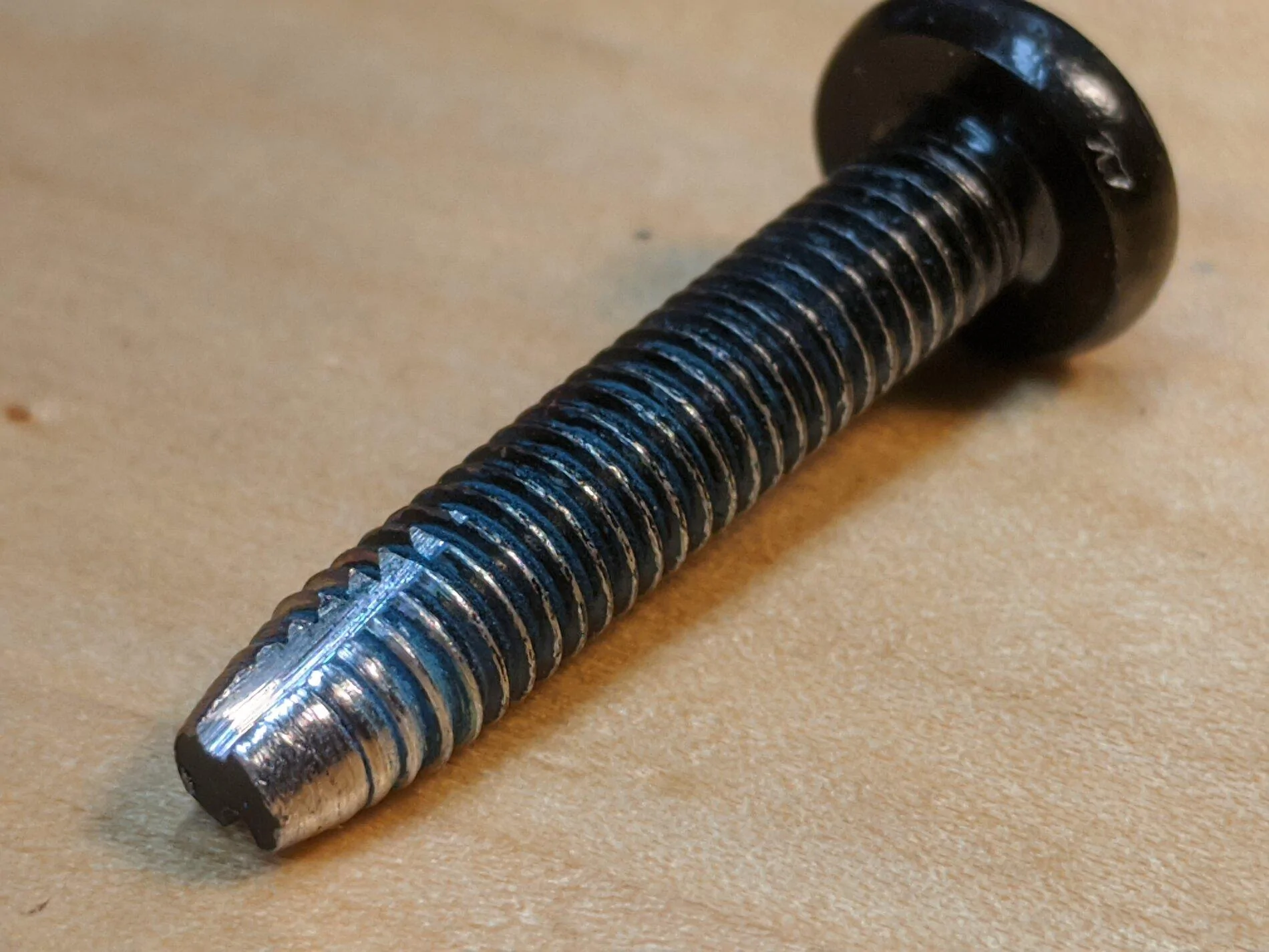

I made my own tap because I don't have a lot. I managed to find some metric fine thread screws in my screw bins. This screw came from left overs from wall hanging TVs. VESA mount TV wall hanging is all metric and normally come with black screws.
First I tapered the tip on a bench grinder. Then I used a dremel tool with a thin cut off wheel and carefully cut a deep line on both sides. This created a cutting edge for the threads and it's basically a tap now. At least strong enough to cut through the paint. This worked great for me. Make absolutely sure you are actually in the thread tracks before using a tool so you don't strip it. I used an impact driver and just worked the screw in and out 2 or 3 times per hole. I was gold after that.
Another tip: watch some YouTube videos on how to properly install a rivet nut, or rivnut.
Good luck.
