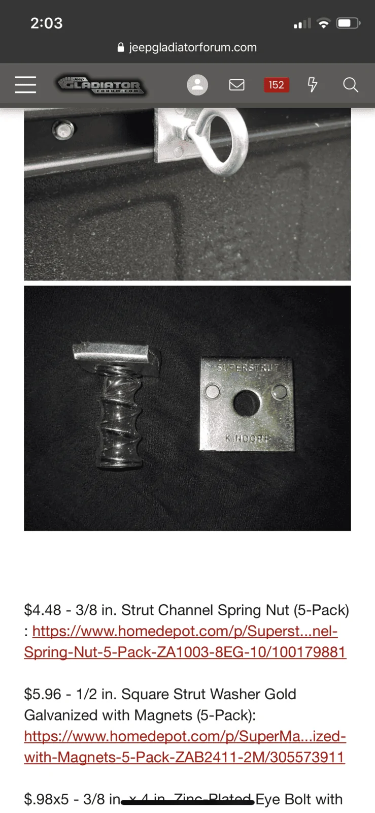

I've spent a fair bit of time searching this forum and other sources and have yet to come up with a definitive answer to the correct size t-nuts to fit in the BuiltRight utility bed rails. If anyone has found a good solution for this I would appreciate it otherwise it will be a trial and error trip to the hardware store.

I just used Unistrut bolts, nuts, etc from HD.. you can order fancy/black ones from McMaster-Carr
