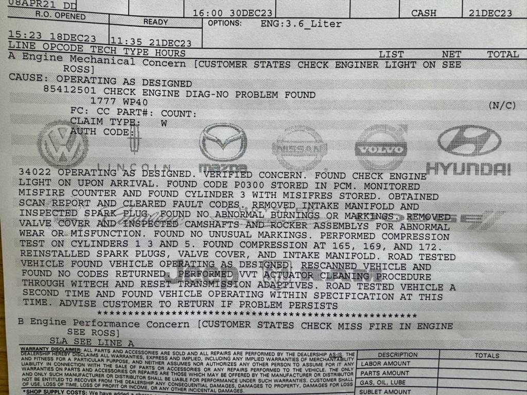

After 2 days they said they couldn't find the cause of the misfire. I spoke with the Service Manager to get more info on what they think the issue could be, and he said he thinks something was interfering with the VVT. He said they cleaned it as a precaution. He said he thinks that may have been what I heard and it 'worked its way through', which I then asked if they changed the oil as it seems like if it did, the oil filter would have collected it. He said they didn't, but I'm getting close to an oil change so I scheduled one next month. Not sure what to think about this.....

At least it appears like they took a good look at it. Hopefully it'll just be a momentary glitch and won't return.
For a dealership, that is a pretty decent deep dive if they did the work stated.
Only thing I would have done different is swap cylinder #3 spark plug, fuel injector and coil to another cylinder different from each other and see if the problem traveled with any of those items. Also a coolant system pressure check.
