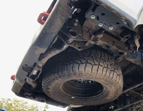

Per JCR, the Vanguard rear bumper is 115lbs. Anyone know the combined weight of the stock rear plastic bumper and tow hitch?
I got my eye on the mid-width Rock Hard aluminum. If they’d have had a Black Friday sale I would have pounced.
My personal requirements are so specific I’m really limited. For instance on a front bumper, I do not want a winch so finding one that is light and not designed for a winch is rare. I think that RH fits the bill.
On the JCR, if the increased weight is minimal, I’d trade that off for the superior strength and greater departure angle. The factory tow hitch kills the departure angle.
Did some digging the other day and the factory hitch is apparently right at 50 lbs. Factory steel bumper kit is ~40lbs (boxed weight is 46lbs) and I can imagine maybe 10 lbs for the rocker protection? That would put you right around 100lbs replacing a steel rear bumper and all the related parts so you'd really only be adding 15-20lbs at most and the added protection is massively better than factory.
The RH bumper is technically winch-rated but I'm not sure I'd trust it as it's literally 100% aluminum and most others (e.g. Genright) will do a steel cradle to reinforce their aluminum. If you don't want one then the top-mount winch bumper is probably right for you so there's no opening.
edit: I just realized that that bumper kit may or may not be complete so you might even save more weight... not sure what is included but that might just be the steel shell. You'd need someone in parts to verify but it's P/N 82215634AC
