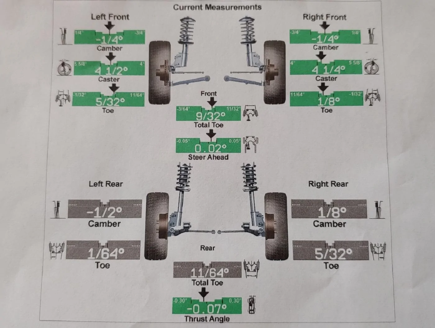

I try to stay ahead of wear patterns, since tires never true themselves up very well.
That's why I have a concern at all - once they wear like that, it's not like the road will fix them.
I learned years ago when I align a solid axle vehicle to go to the screen that gives me total toe. I set it to the preferred setting, then I deal with the steer ahead.
Yeah, on IFS it's simple to set the wheel straight ahead and then adjust each side individually, but I still always took them for a test drive to verify.
On the solid axles, it's easier, at least for me, to set total toe and then center the wheel.

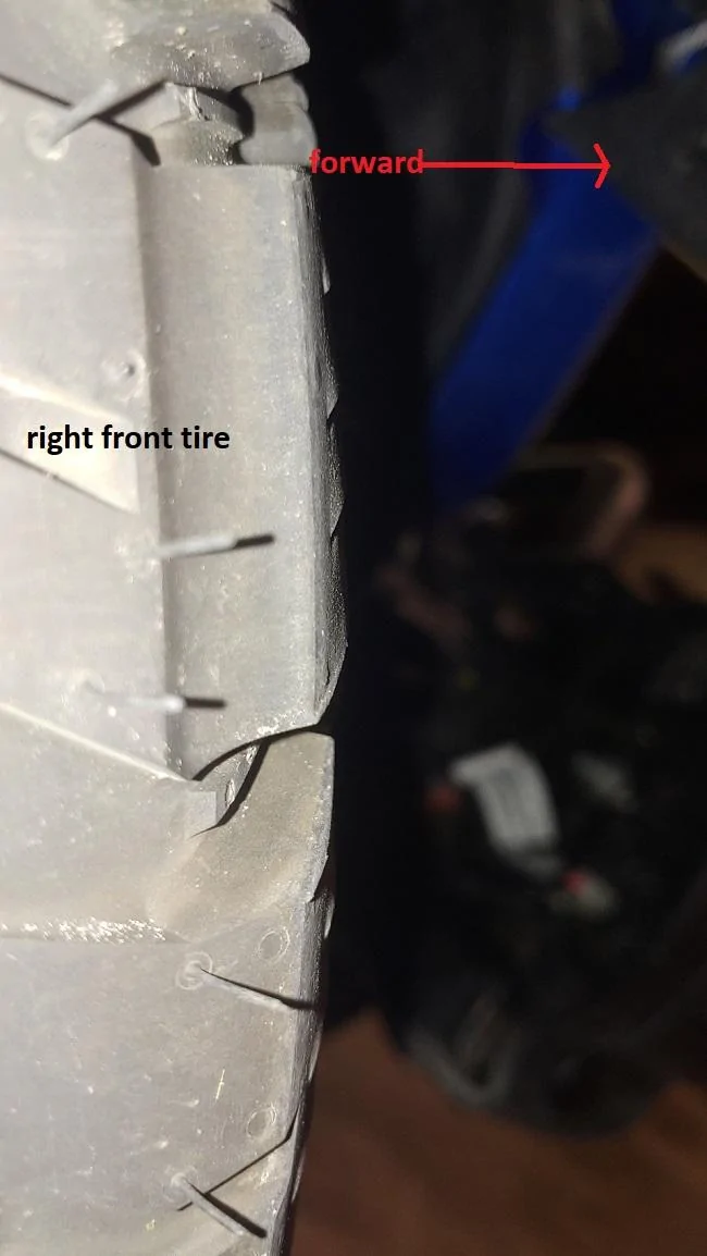

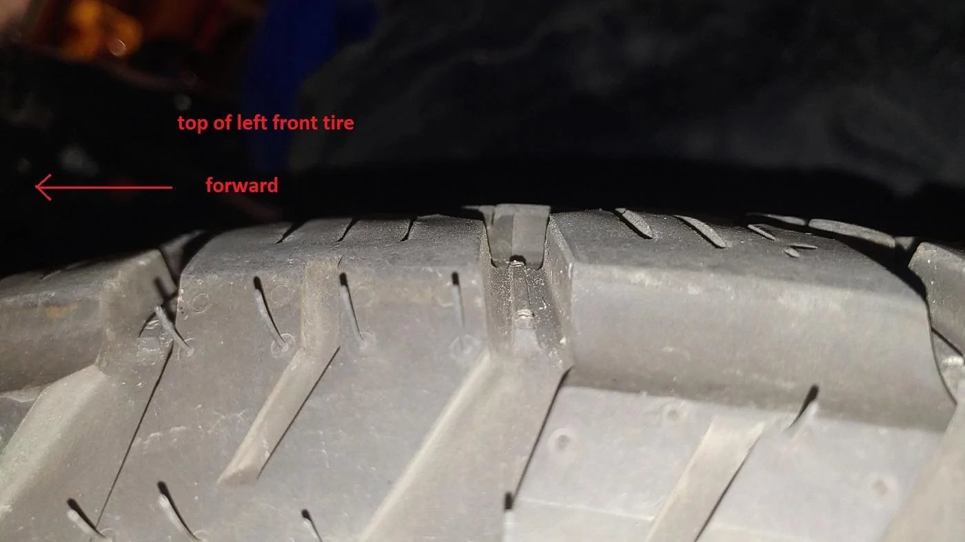

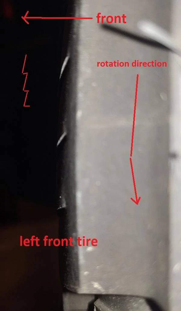

All of my Jeeps have always worn the same way. If you figure it out please let us know.
I just checked my truck. I recently lifted it and replaced the stock LT285 Falkens with LT315 versions. The new tires have this "feathering" on the outside tread of the front tires only. You can feel it when you run your hand over it and catch the slight ridge between the groves and the blocks. This is about 1k miles into the new tires.
The stack of takeoff wheels and tires (with about 10k miles on them) is in my garage. Checked them, and the same thing! Just on two of the wheels. Leads me to think the dealer did not do the tire rotation a while back when they did the jeep wave free oil/rotation service. :(
Checked my wife's 2017 JK which is running Lt265 Falkens - and I found the same thing. On all the tires because I rotate them regularly.
I am reasonably sure my toe is good, but I will take it in to check. I find it intersting that this wear started happening on the stock truck/tires right from the factory and my wife's jeep is also experiencing it. I am leaning towards thinking this is somewhat related to the larger AT time tires and the scrub created going around corners.

It’s pretty normal on solid axle vehicles. Every daily driver I have had for the past 22 years has had this issue. Street, AT, or MT no difference. It’s better when driving highways but on heavily crowned back roads it’s worse. It gets worse as you start messing with the scrub radius. Just rotate your tires and forget about it.
