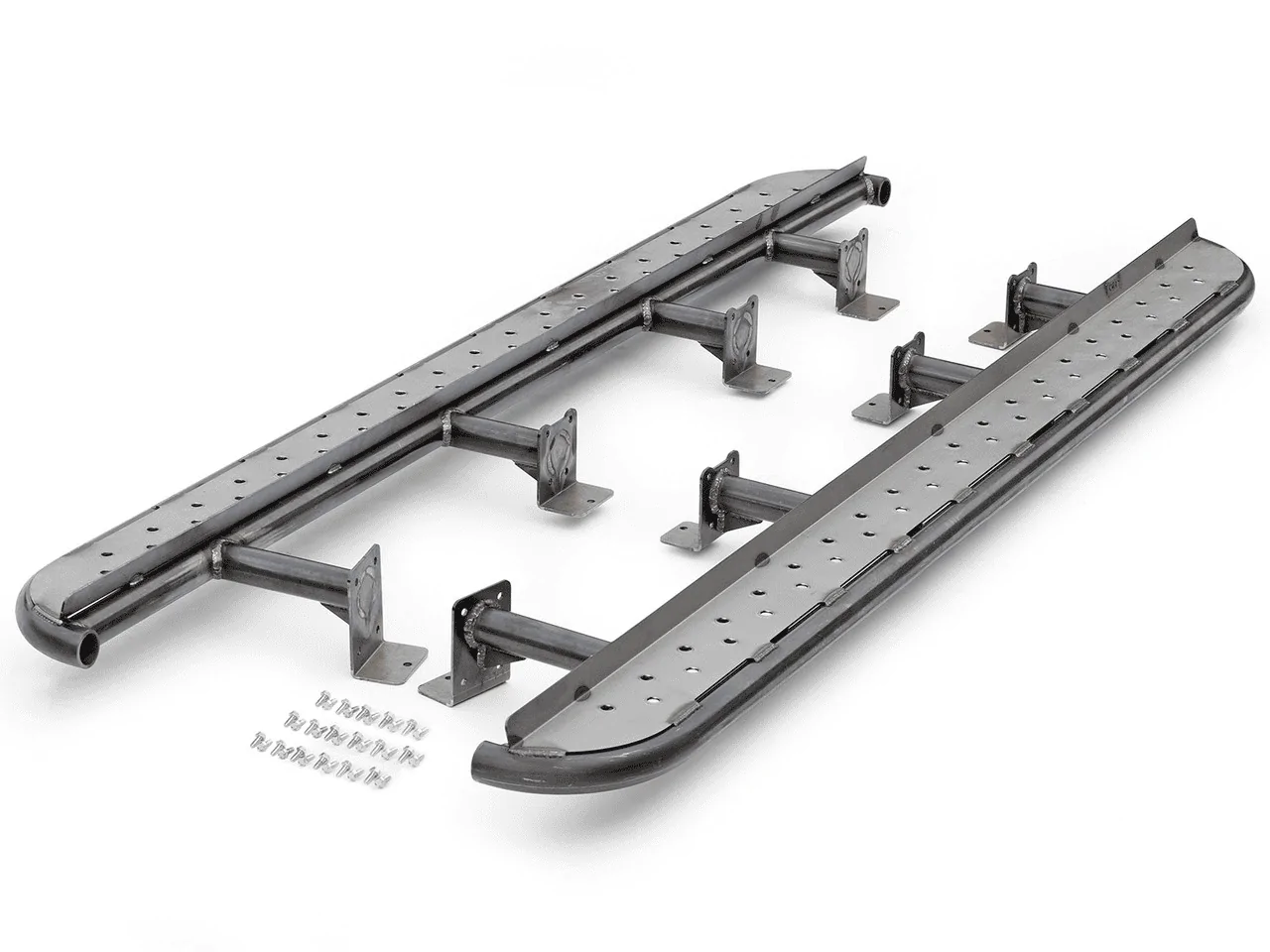

Altho boring i always see the rubicon rails taking a beating and holding up well. since i already have 2 sets (opps) why spend a grand on step sliders when i already have sliders that work well.
Found a couple companies and i found one thread but the company they were talking about already closed
https://www.hkoffroad.com/products/weld-on-slider-steps?variant=39422334992430
https://warriorproducts.com/jeep-jku-renegade-rails-diy-kit-with-steps-54006.html
https://shop.poisonspyder.com/DIY-Rico-Step-trade-Kit-66-5-p/diy-50-050.htm
anyone tried any?

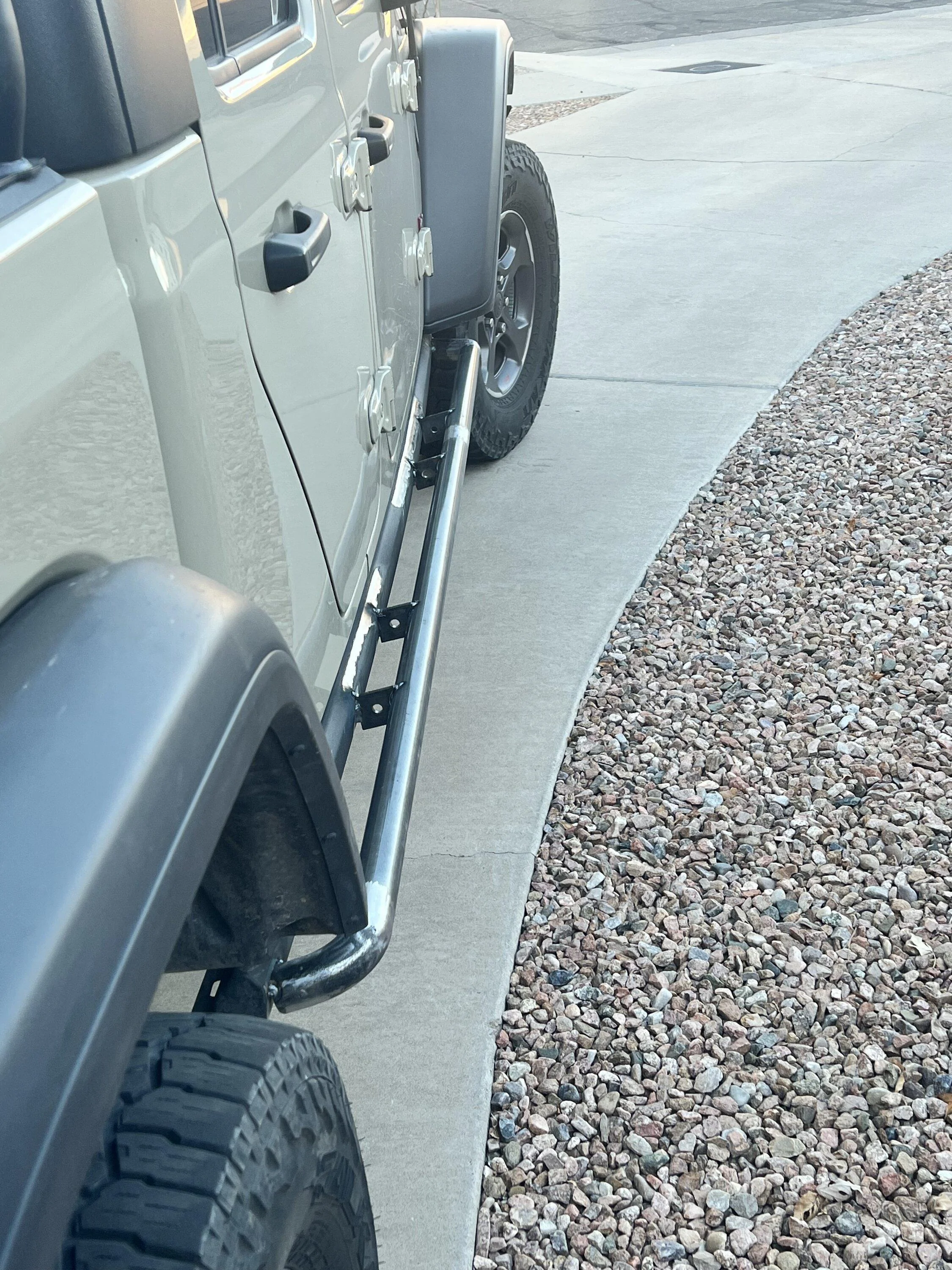

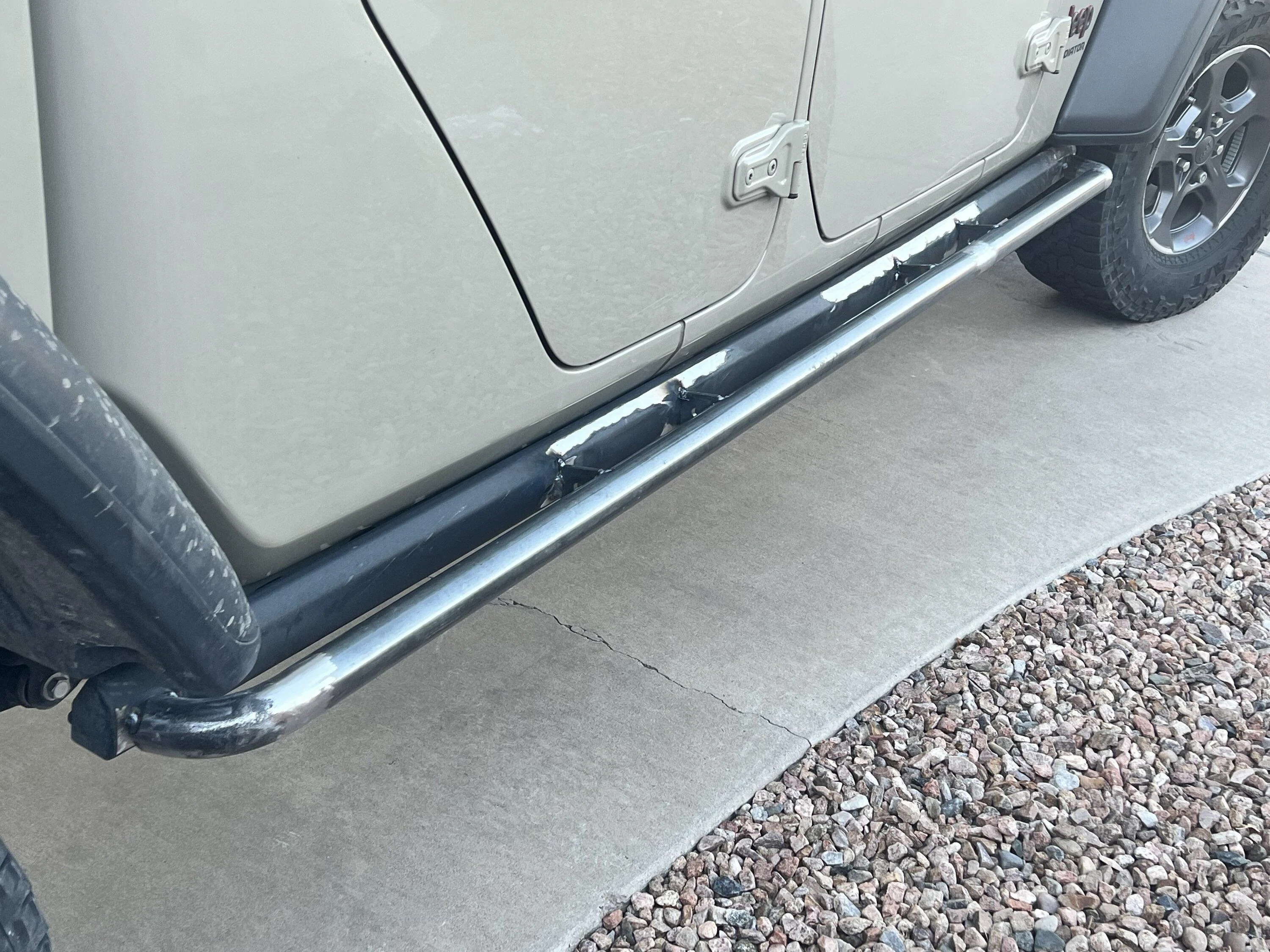

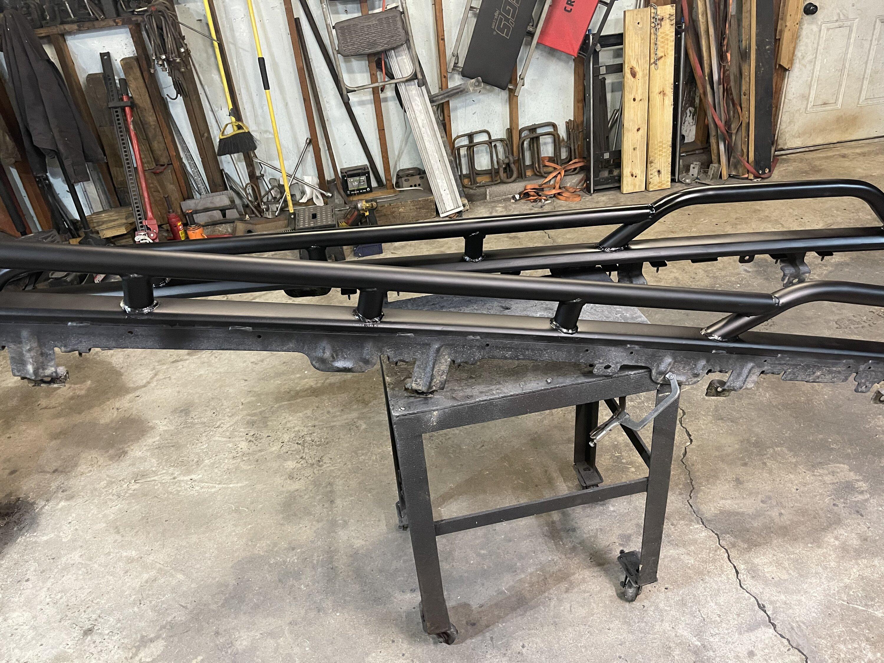

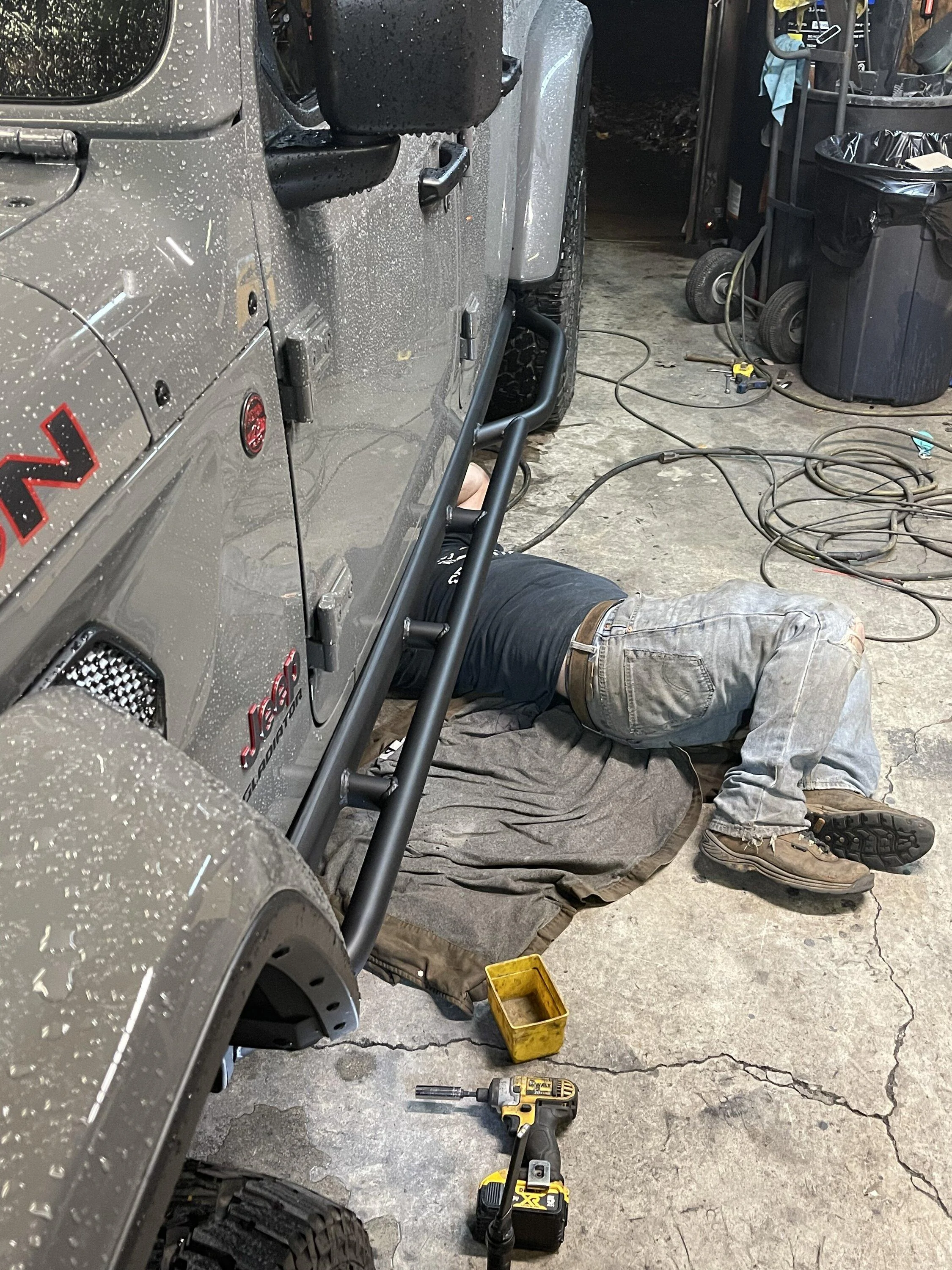

If you donā€™t have a bender get a couple elbows and weld them on. I did a 90 in the back and a 45 in the front.
Mark
