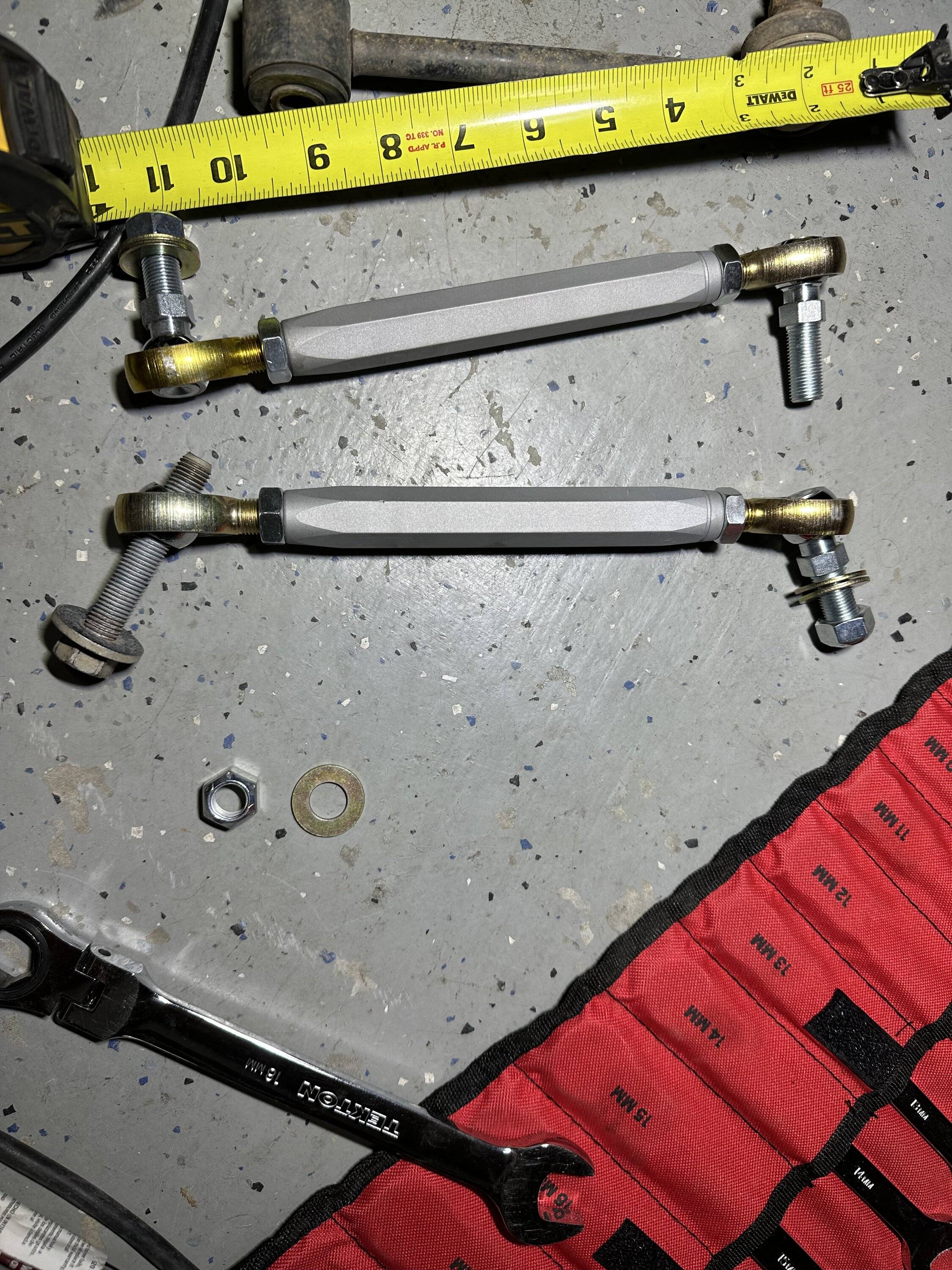

I put on some longer sway bar links with heim joints to maximize the articulation with the rubicon disconnect.
Jeep Gladiator What did you do TO your Gladiator today? [ADMIN WARNING: NO POLITICS, NO GUN TALK] IMG_3901
Went from AEV 2ā€ spacer lift links to ICON sway links #22061. Meant for up to 2.5ā€ lift.
To me these are Rock Krawler no limits sway links at half the price. FK rod ends on both sides, $160.

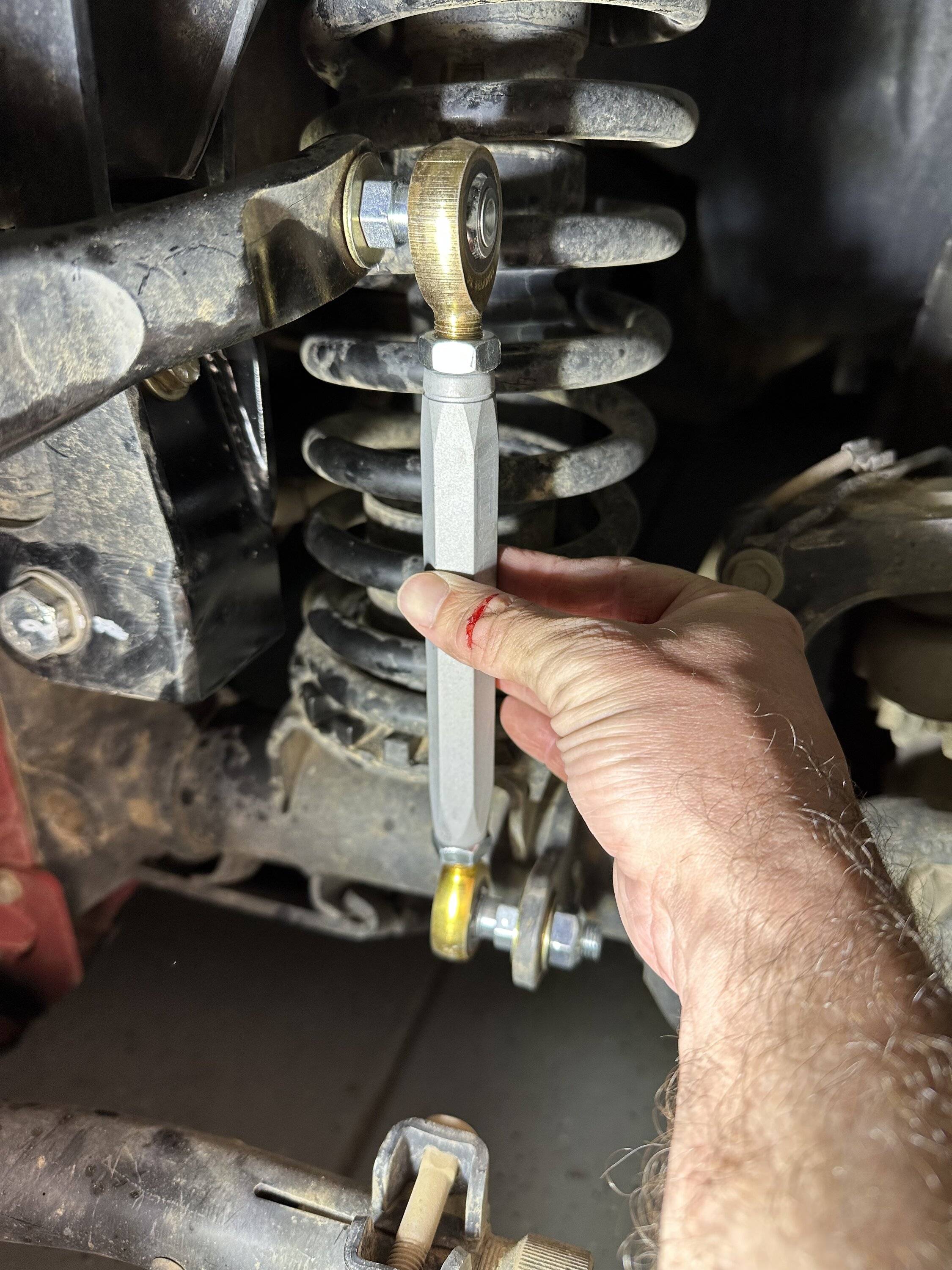

Super simple install, just unbolt old links and bolt them in, right?
Jeep Gladiator What did you do TO your Gladiator today? [ADMIN WARNING: NO POLITICS, NO GUN TALK] IMG_3719
Oops. Took the time to match the lengths, square up the rod ends and tightened jam nuts. Oh sh!t the bolts don’t fit in the sway bar… like most aftermarket ones I researched they use 1/2ā€ bolts that require drilling out your sway bar holes. The sway bar metal is actually pretty soft so that only took another few mins.
I was lazy and kept my wheels on, but there was enough room to drill by turning the wheels lock to lock.
Shortest length is 8.5ā€ eye to eye.
Maximum safe length per instructions is 9.75ā€ eye to eye.
They look like they have pretty good articulation, not sure how it compares to the RK gold standard.

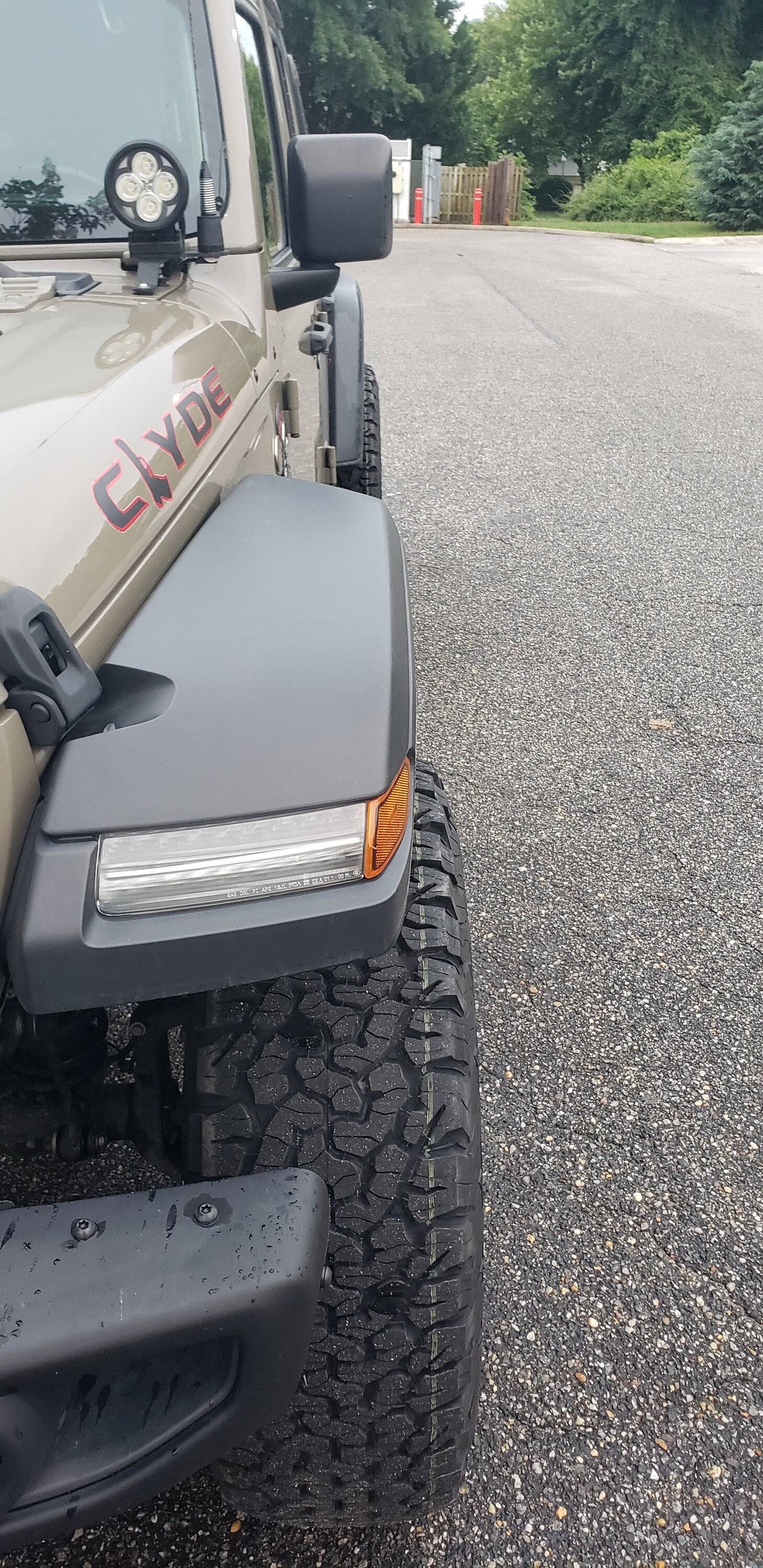

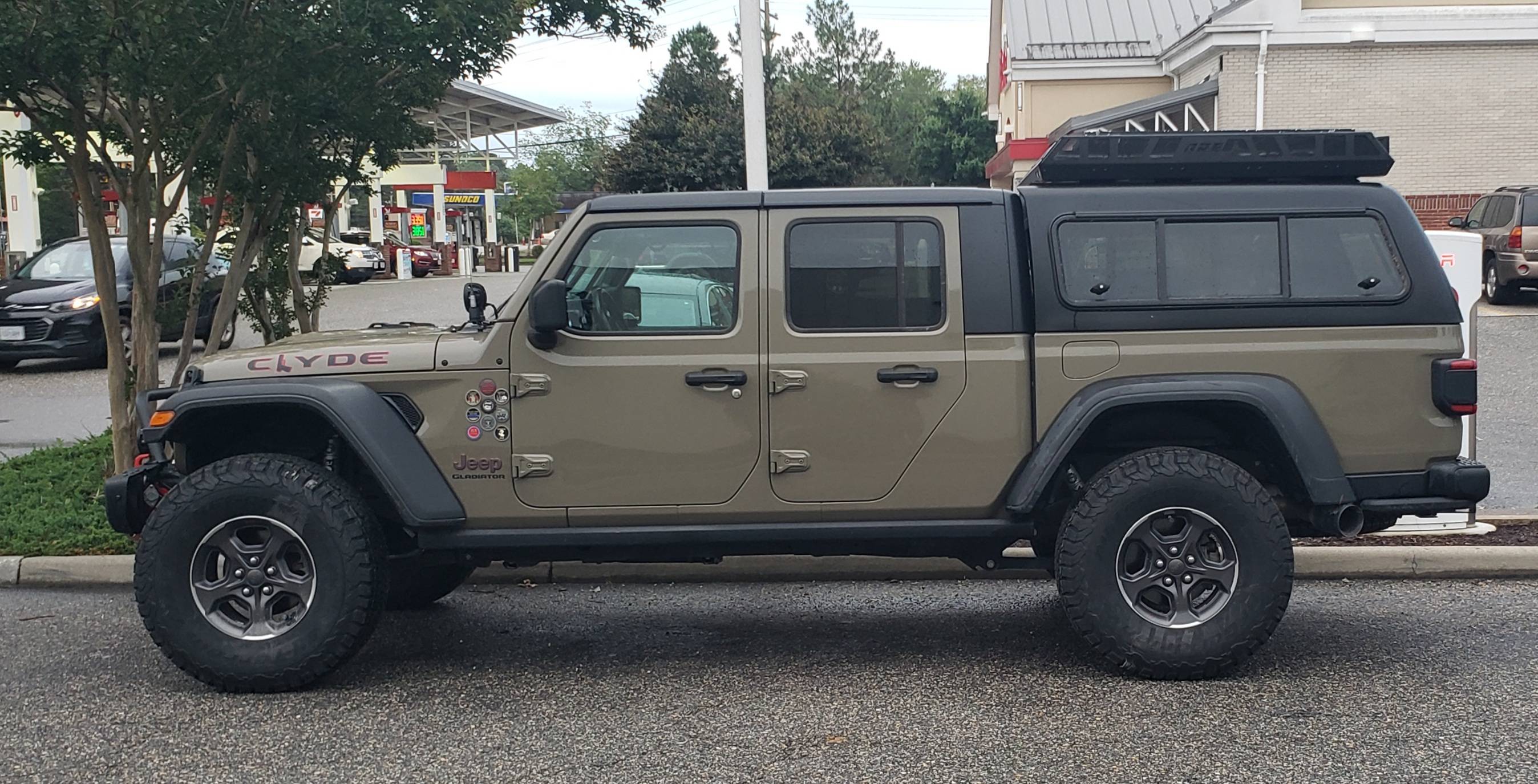

Though it looked like they had another 10k+ miles on them, I replaced the 315/70/17 BFG KO2's load range C at 40,600 miles installed at delivery, with 37x12.50 BFG KO2's (also load range C). For 5 of them, the four wheel alignment, and speedo recalibration, it was $2514 with tax/disposal. Drove 110 interstate miles and found it still got into 8th gear fairly regularly. Williamsburg Jeep.
Mopar 2" lift and Teraflex 1.75" spacers. No rubbing. Stock Rubicon wheels.
