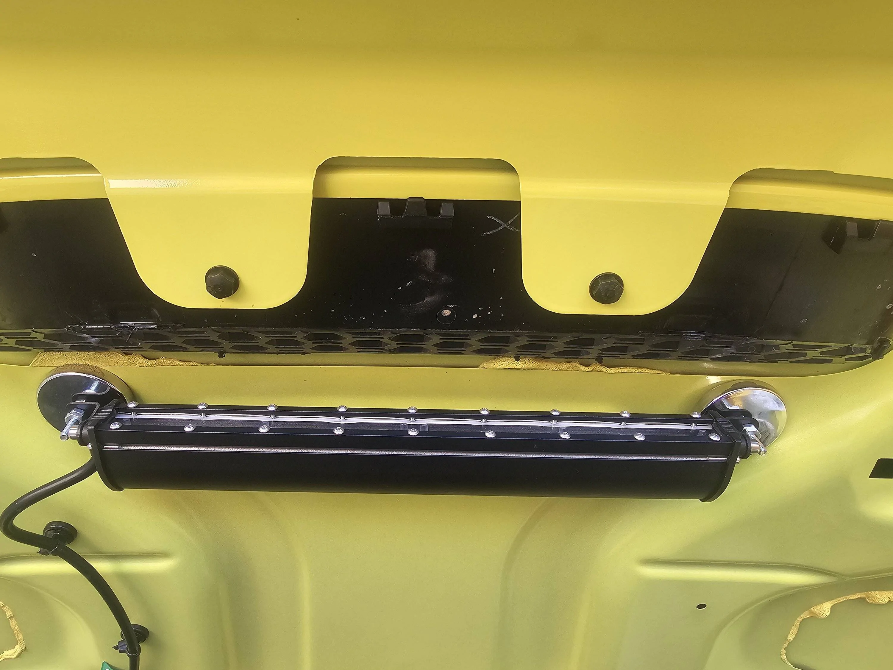

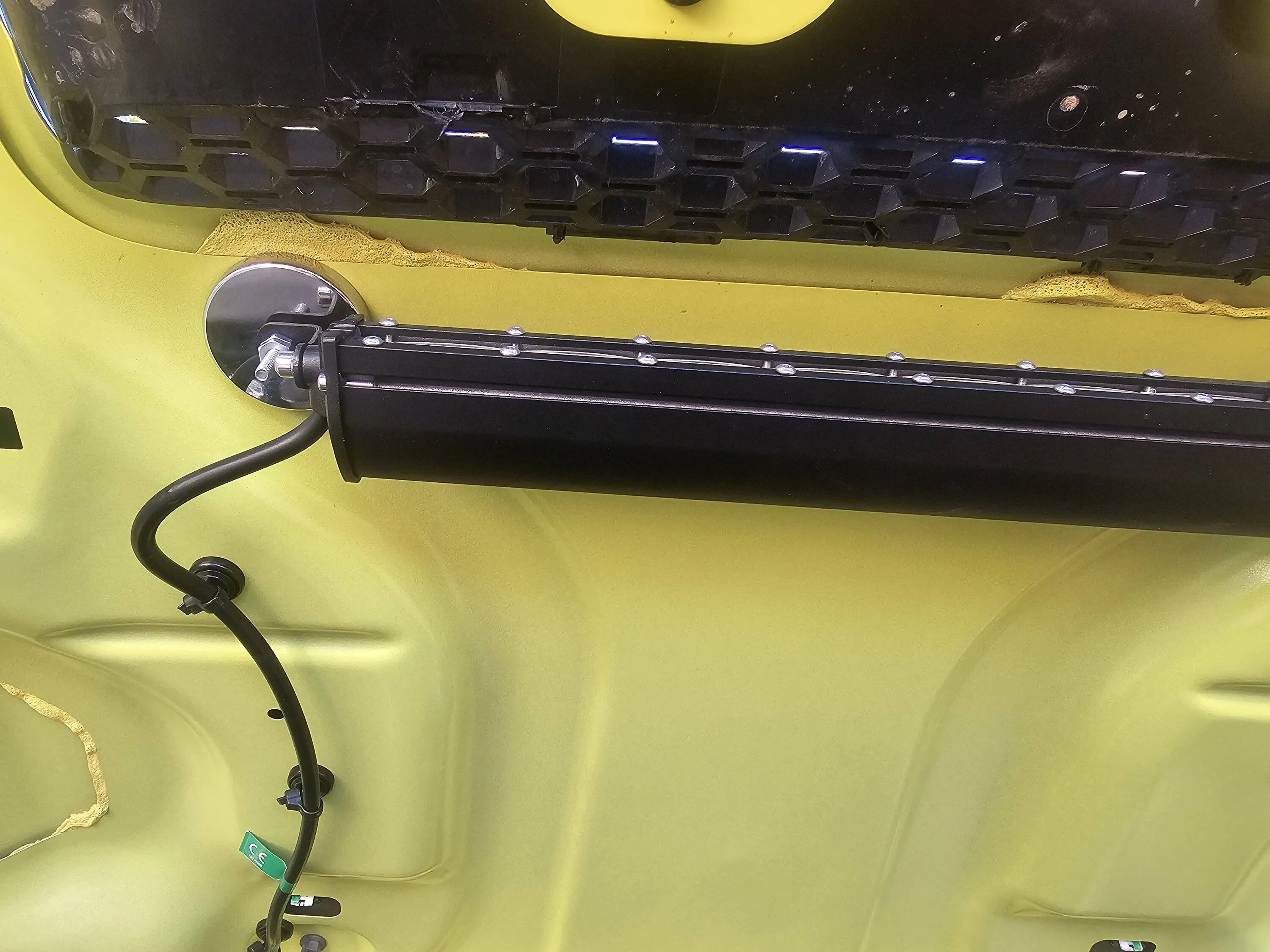

Can you show us how you did the light?

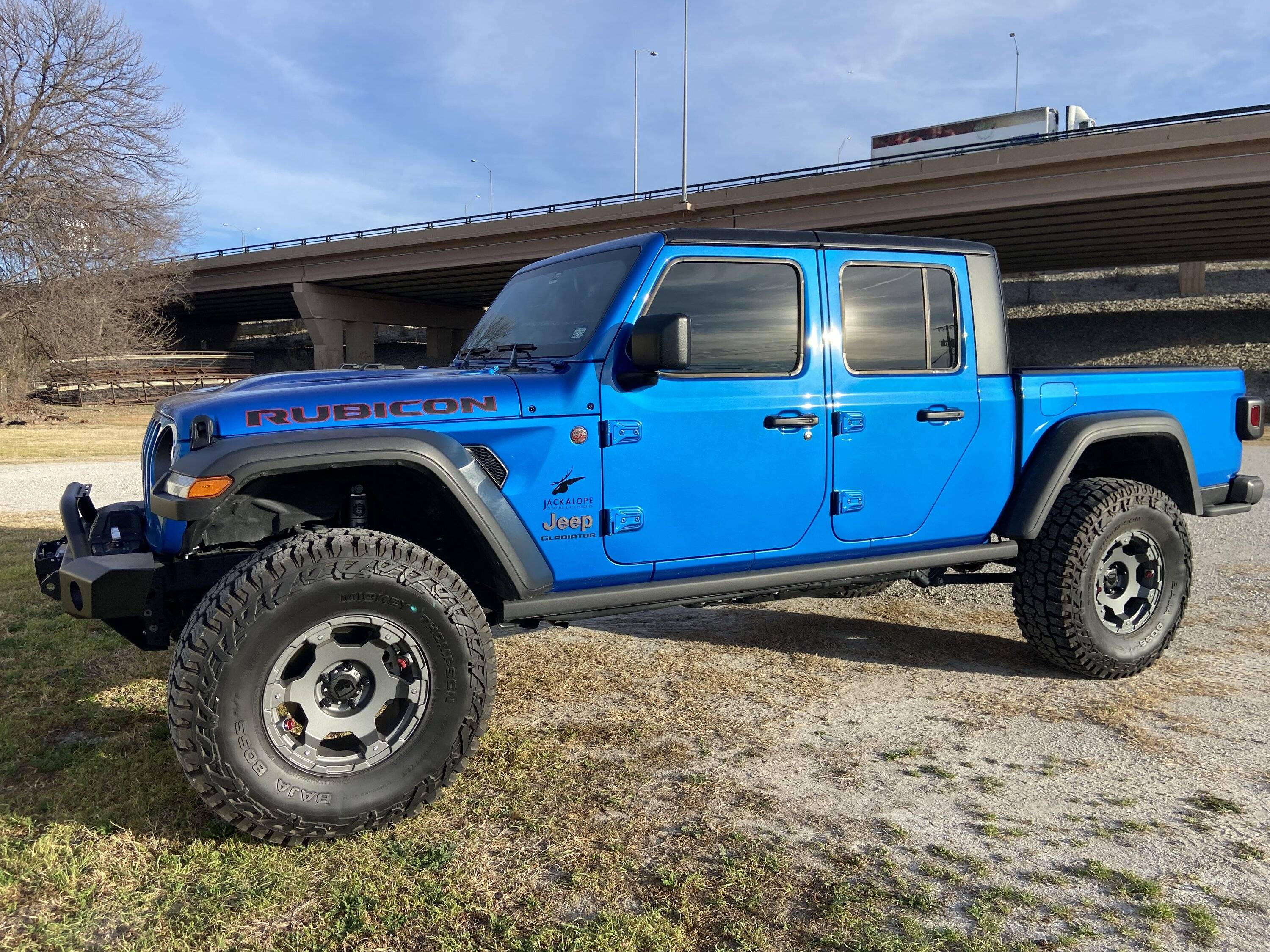

I have a couple picks. Light bar is mounted with a couple 50lb magnets (I'll add epoxy once I'm positive I don't want to move it). Wiring is run on magnetic zip tie holders and tied in to the aux wiring by the battery. The back half of the hood scoop is glued on, popped the clips and then a little prying with a pocket knife and it came right off. Nothing to it really.

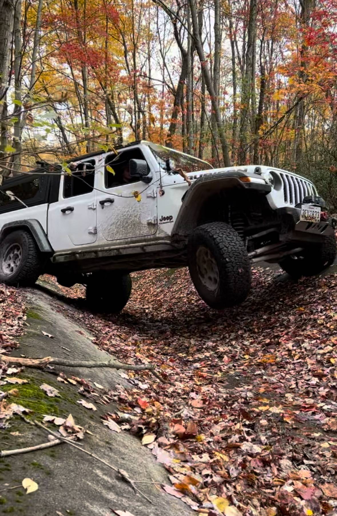

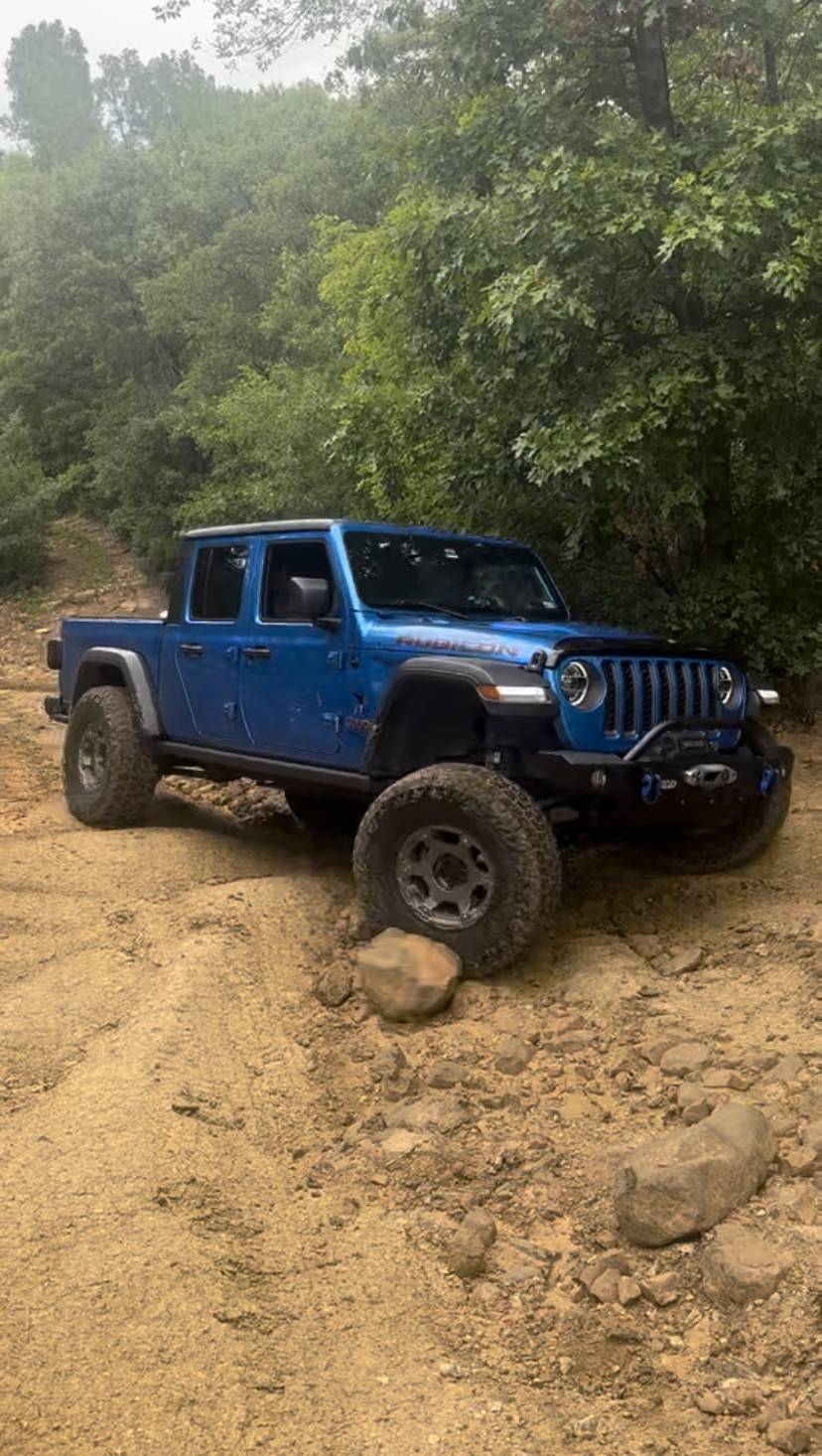

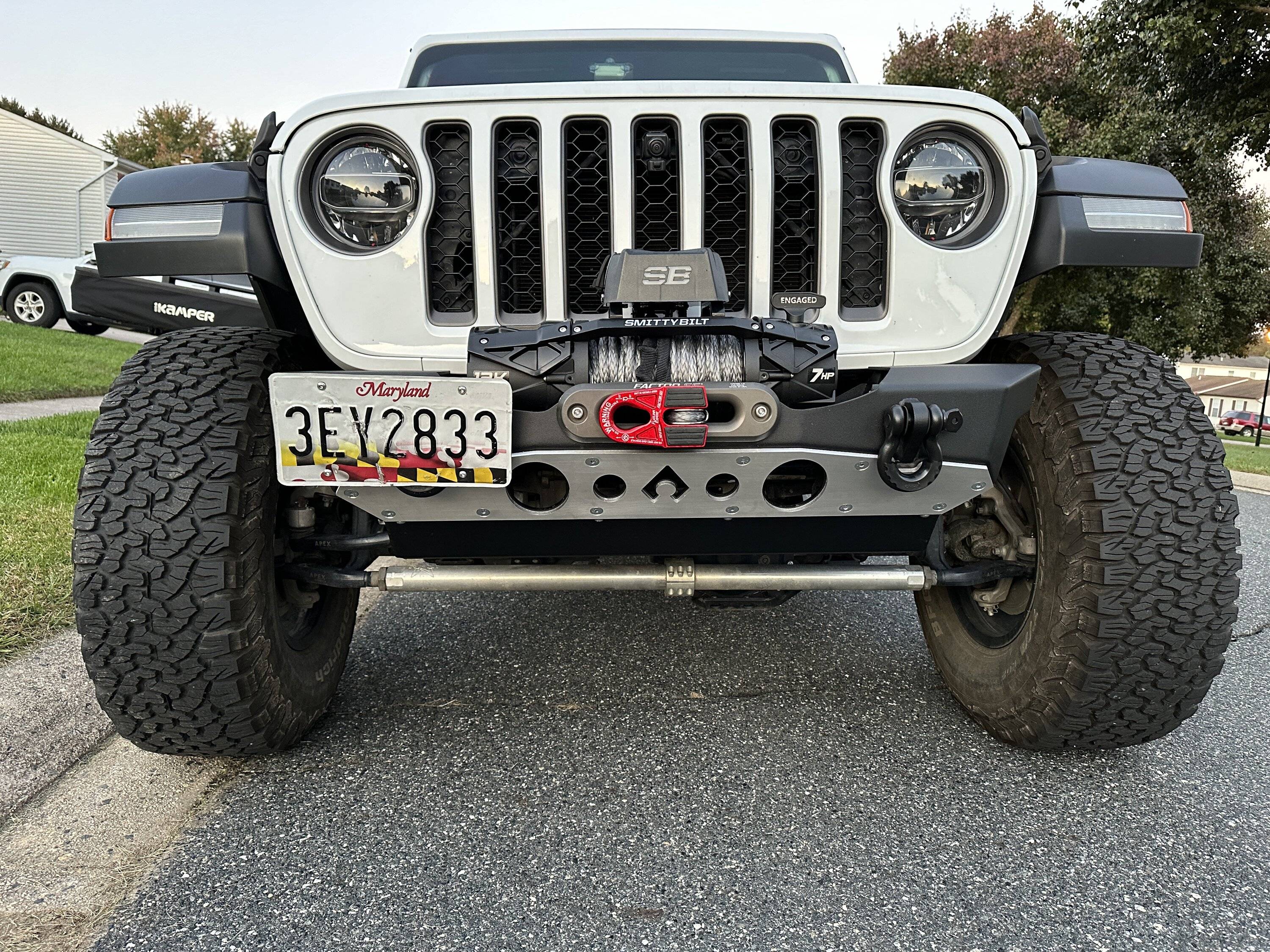

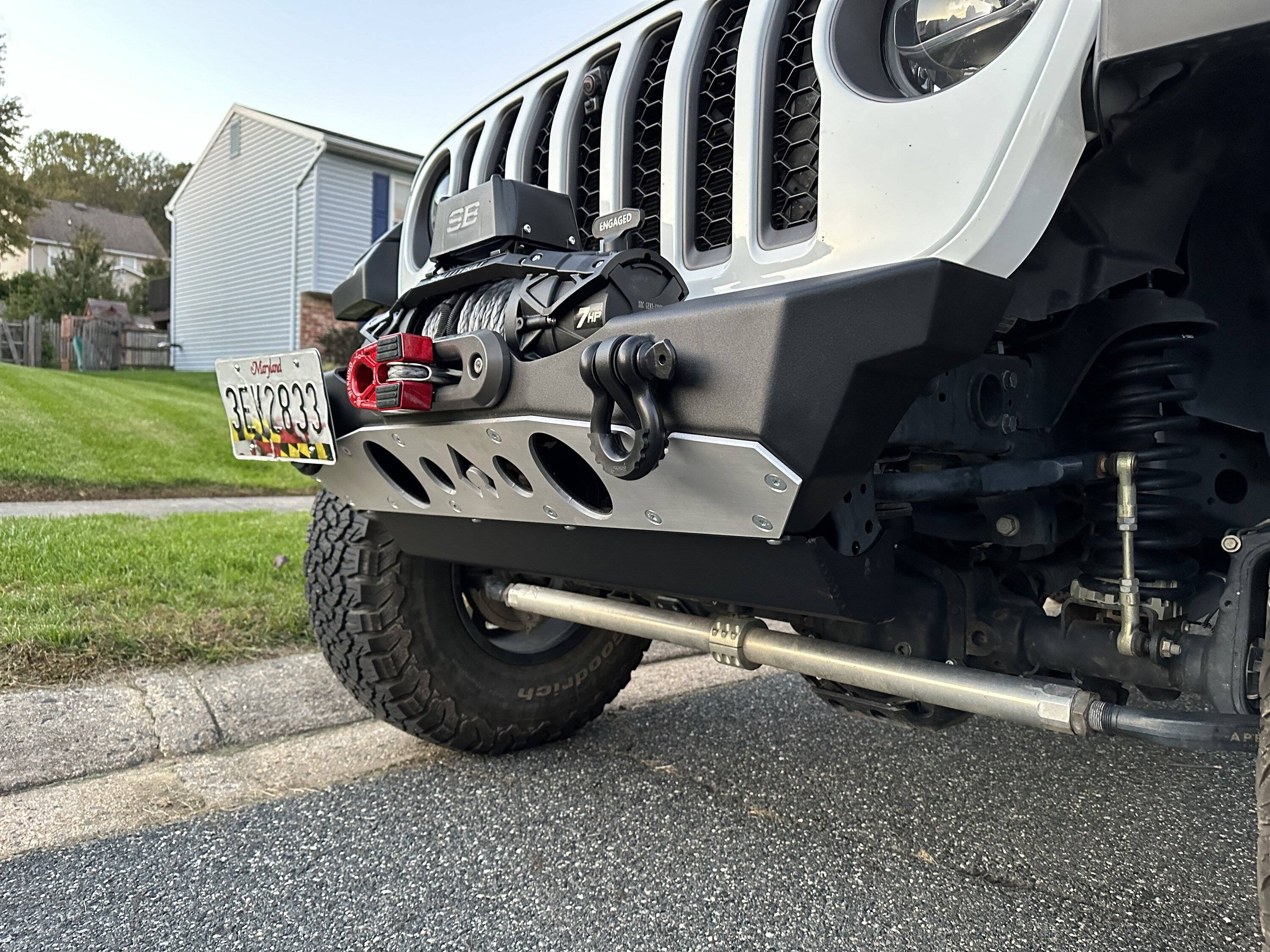

I have not posted on here in a while, but when I was coming home from smoky mountain jeep invasion in August, I got rear ended coming off an off ramp on 81 in Virginia. In turn it pushed me into a rav 4 in front of me. I had to get a new rear bumper, tailgate, front bumper, passenger side head light, and winch. My collision guy was pretty chill and I was able to get an aftermarket front bumper out of it. I decided to go with Artec and I’m really happy with the looks of it. It took a lil over a month to get everything buttoned up, waiting for parts, insurance etc. I also went to krawling for k9s on the 21st at AOAA and it was a blast. Def some puckering moments, the trails there are tight! Heard a guy refer to the Gladiator as the land yacht. Was able to get the Barney rubble badge too!

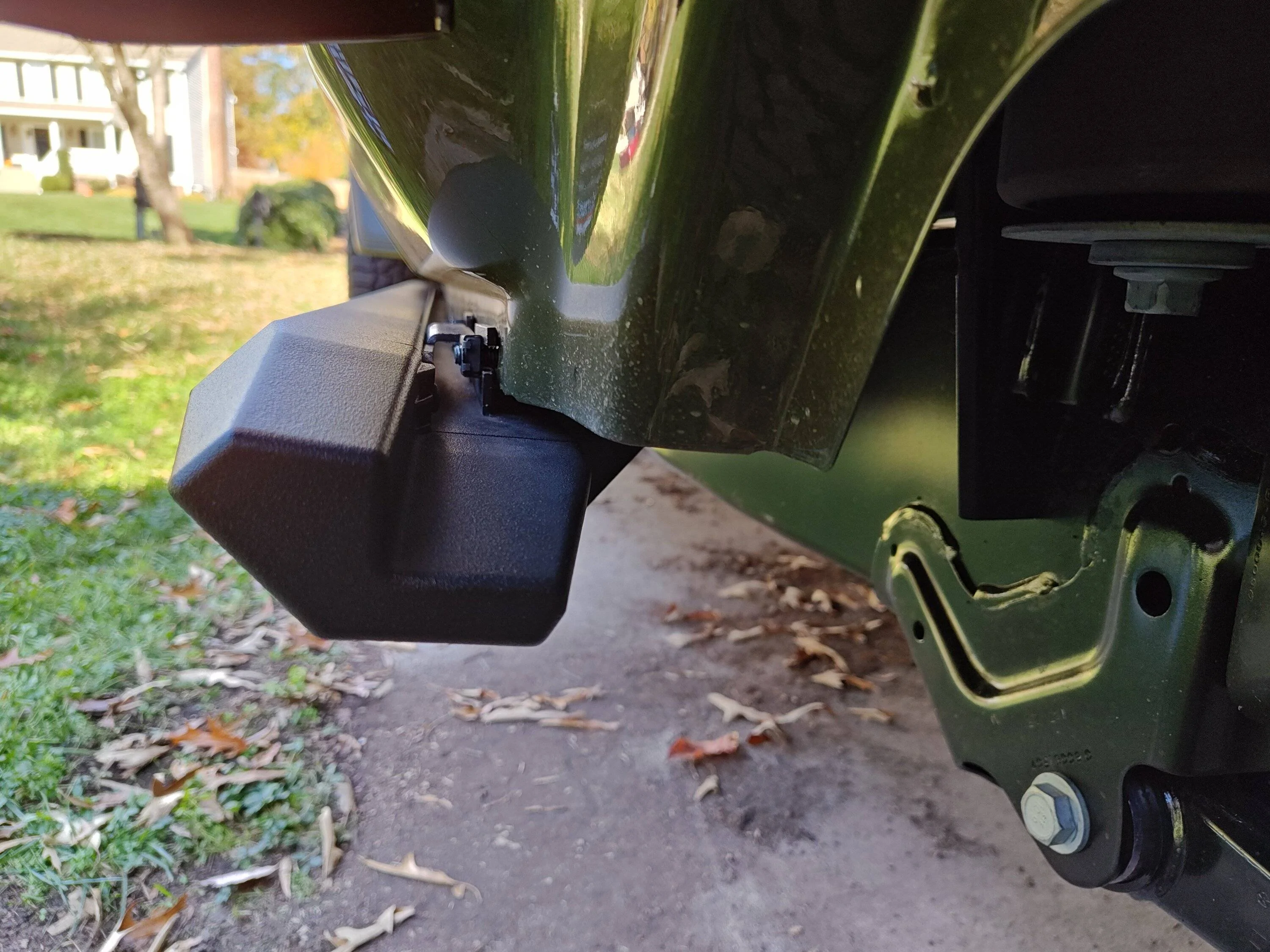

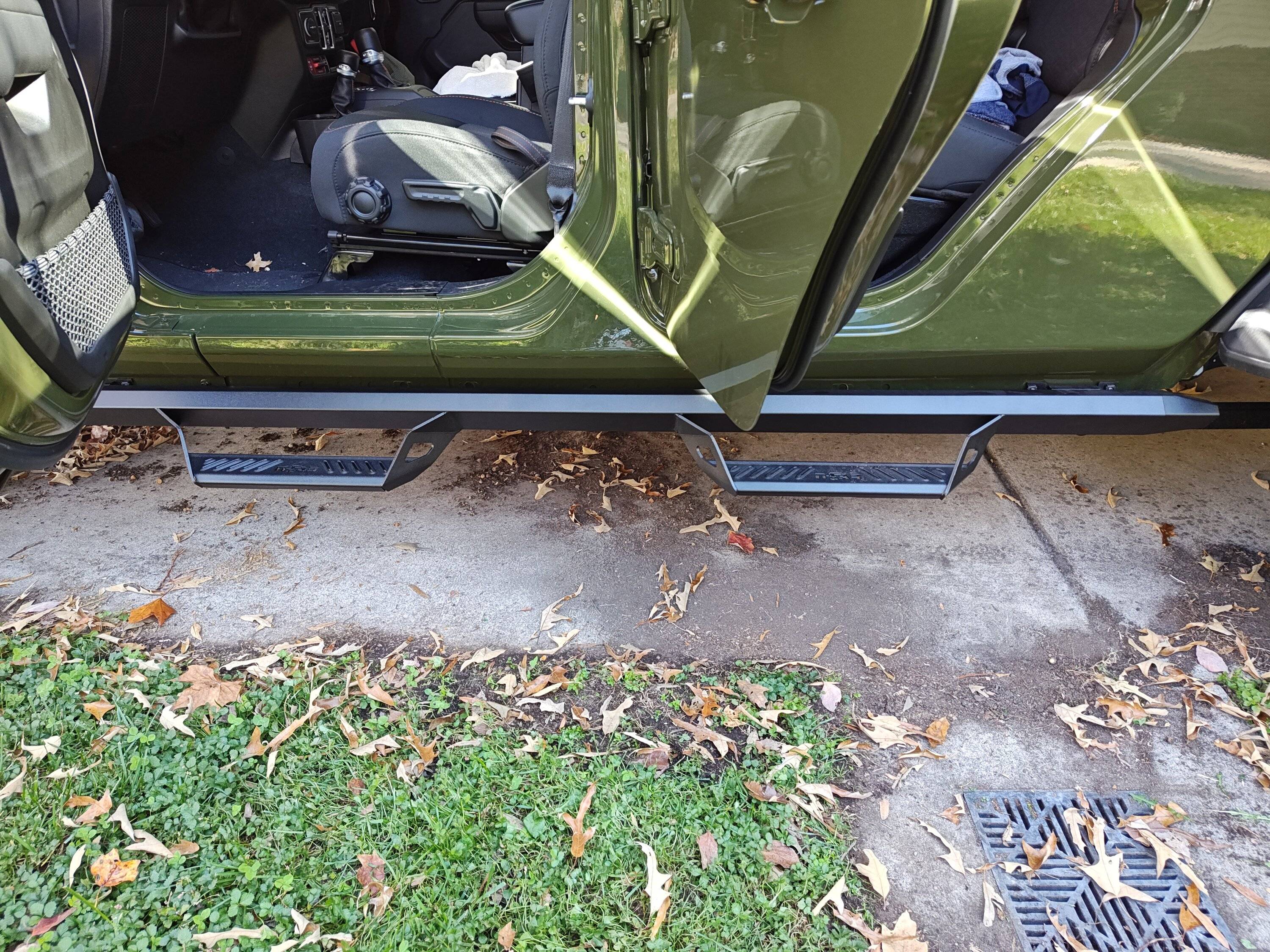

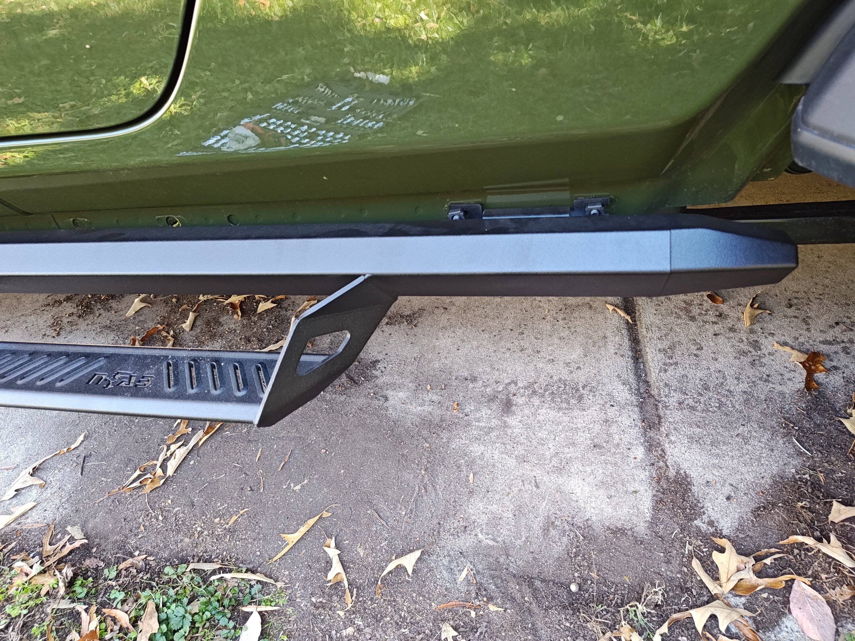

Had installed N-Fab Predator Pro steps. Not a fan. The driver side front step is set too far forward for me, they show too much of the pinch seam, and there are only three mount points instead of the four stock hardware uses. I was able to get it a little closer to the body and a little higher up but I had to not use one of the bolts on the rear pinch seam.
Super light though, which is the only thing I like about them.

My GoRhino steps only attach at 3/4 mounting points as well.

Lemme know when you hit up AOAA or Rausch and maybe I can tag along if you need another Jeep. Not sure what type of sliders you have, but I would def have some for crawl daddy, and depending what line you take on Barney rubble.
