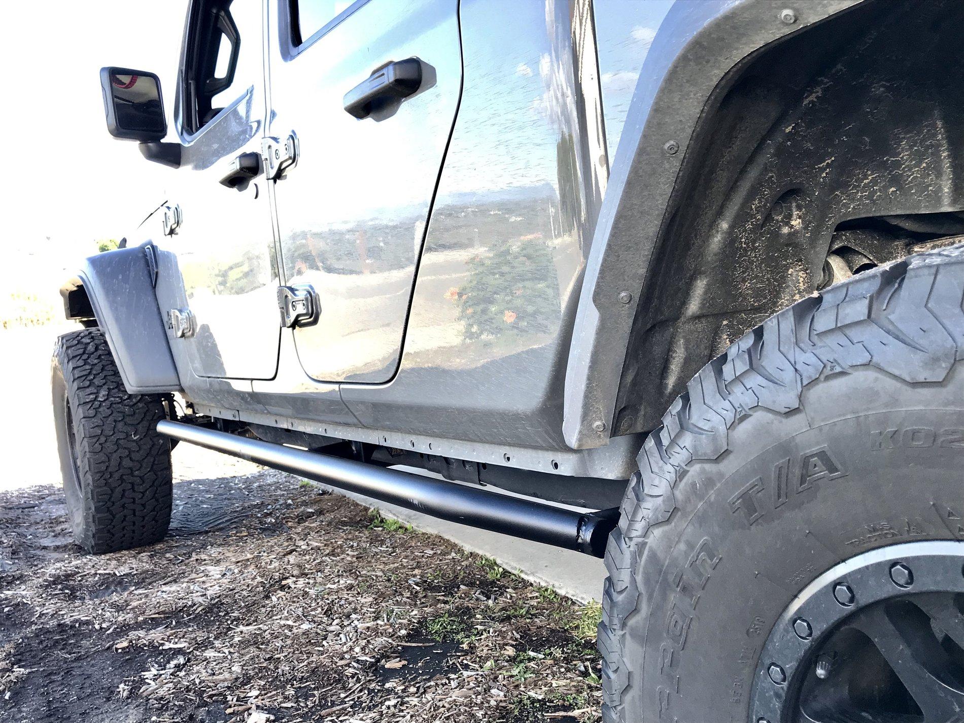

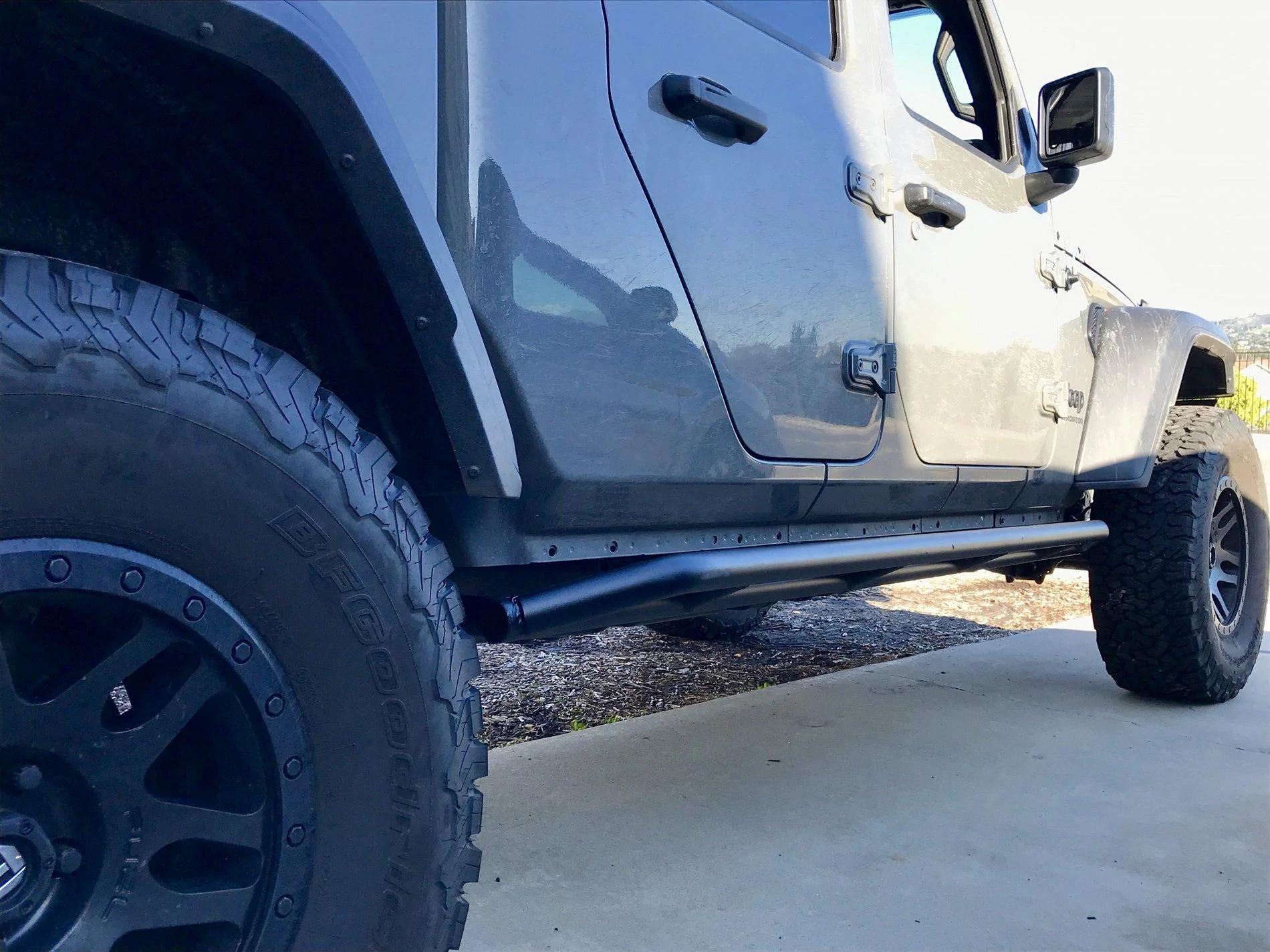

Installed Ace sliders today...no broken bolts. Heated the bolts with mikwaukee heat gun on high for a few minutes before remiving each. Pretty easy install.
Looks good!
Did you notice if the bolts had red or blue loctite?

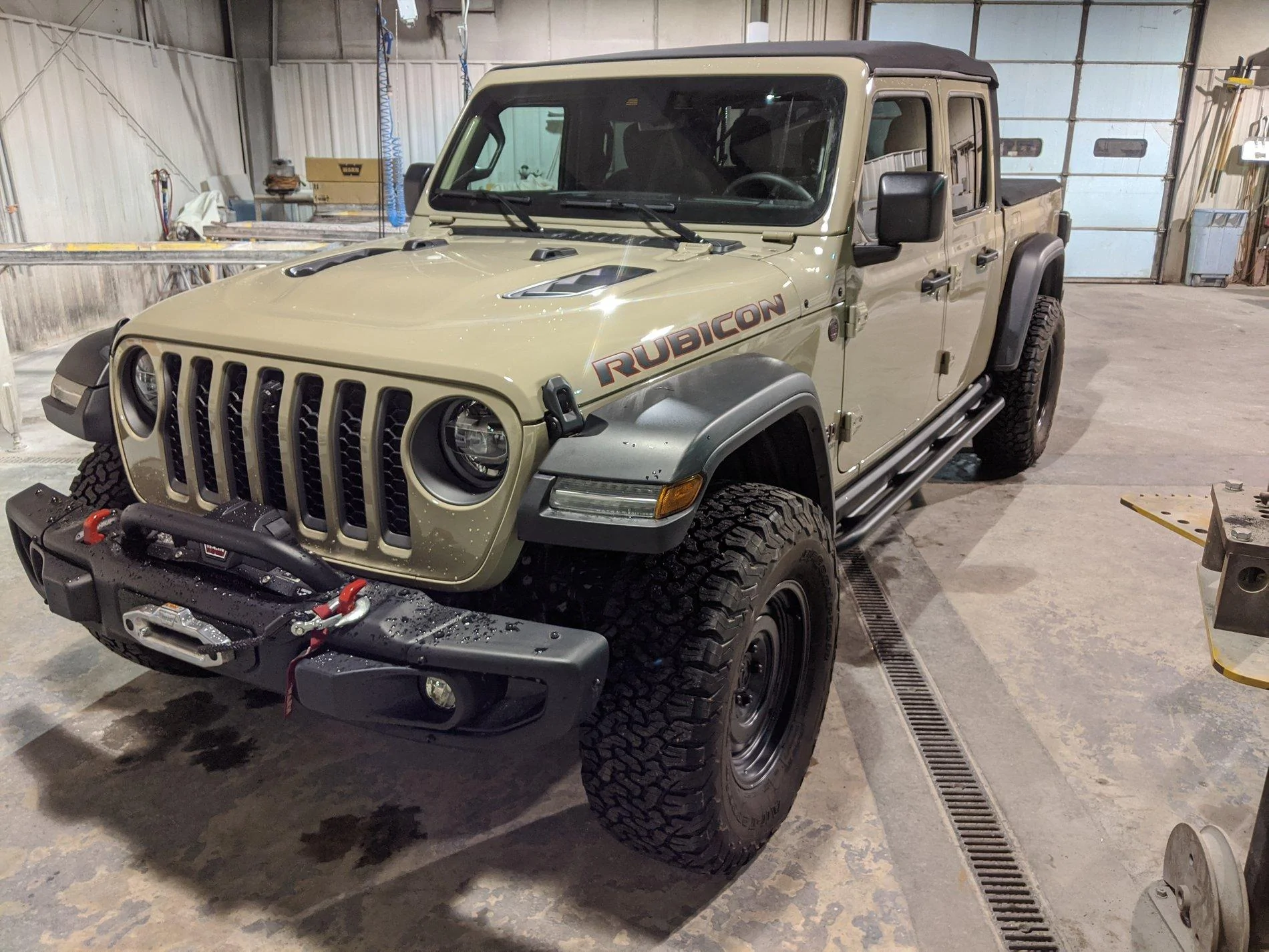

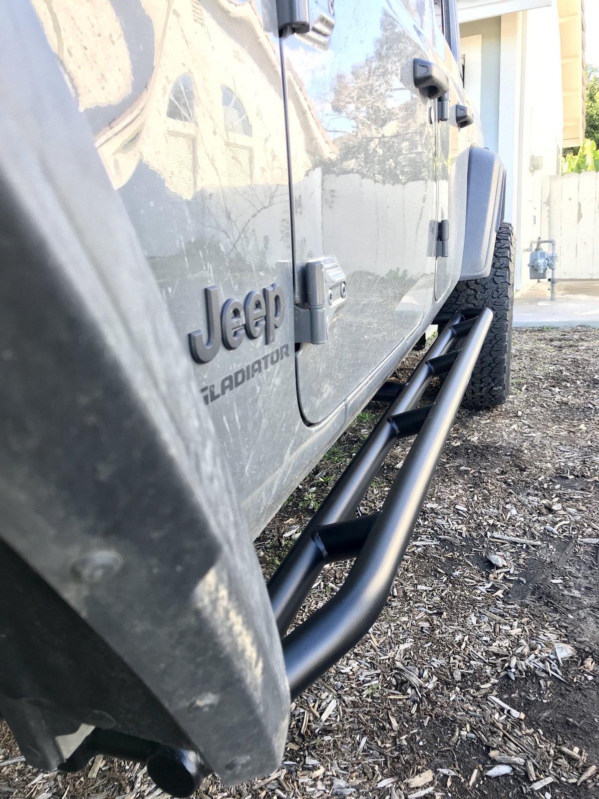

Installed the Ace Engineering rock sliders. Used an extra long 1/2" ratcheting wrench and no heat. Saw no evidence of red Loctite on any of the bolts, but five were consistently tough to turn during the entire withdrawal. Even a Snap-On 1/2" impact wrench on a commercial air compressor was unable to turn them off. Whatever is on them just gums them up all of the way. The trick of using a pry bar while turning the last couple turns was necessary on a couple of them to get them to pull out. Install was a piece of cake. Really like that they fit with the Rubi rock rails ...
Jeep Gladiator What did you do TO your Gladiator today? [ADMIN WARNING: NO POLITICS, NO GUN TALK] Gladiator, Dec 19, CP_172242, New Rock Rails

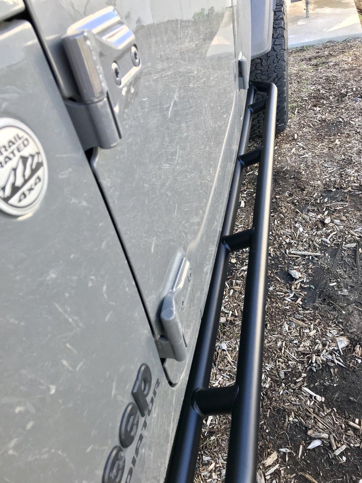

I really like these rock rails. However, just a random thought here: I have the Shrockworks rock sliders on my JK. They look quite similar to the Ace Engineering, however, they use several more bolts to secure them to the frame. I'd have no hesitation in using a Hi-Lift to raise one side of my JK on those rock rails. The Ace Engineering are not as securely mounted. For what I now do--overlanding--they are perfect. Seriously, they will be used mostly to climb into the Jeep, and to keep door dings at bay (267,000 miles on my JK, and no door dings ever. Plenty of trail rash, but no door dings, LOL). If you're a rock crawler, you might want to take a look at Shrockworks, which just became available. See if the JT rock rails are similarly strong to the JK ...

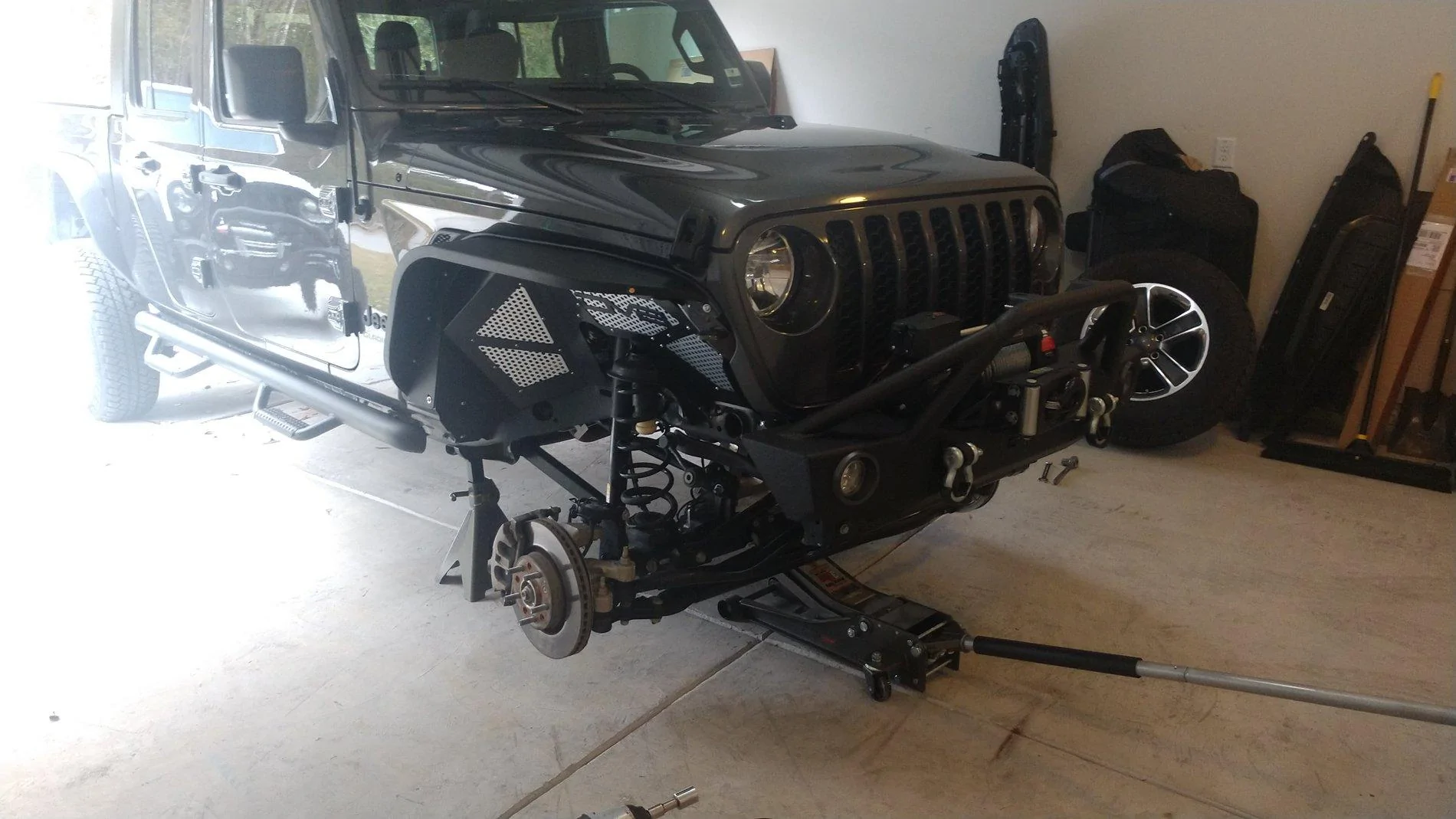

Traveled to VA to visit family.
Had a great time hanging out with my teenage nephew who helped with mounting my Warn Winch Plate and Warn EVO VR-12S winch.
Great to see young kids with a wrench in their hands - just wish they did grow so much taller than me... ha!
Looks great! Exactly what I will be installing very soon. Any issues with the install?
