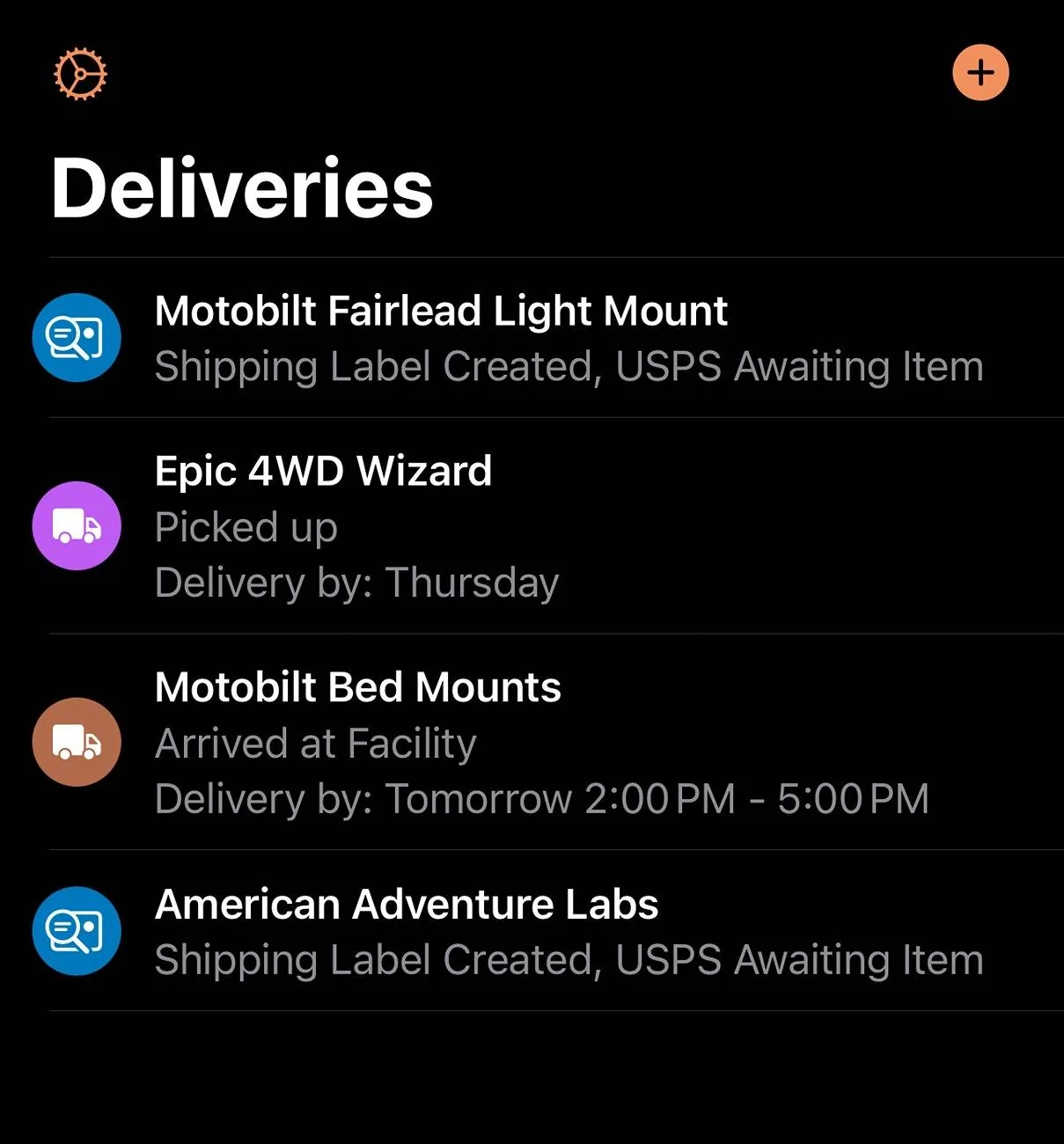

Since I can't put parts on, I'm accumulating parts while I wait for the dealer to get my rig back to me. 😂 Kudos to Motobilt! Same day shipping on one order and next day on an item I ordered over the weekend.

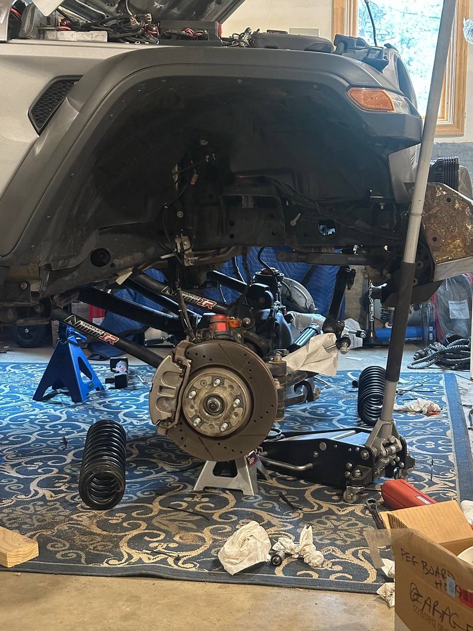

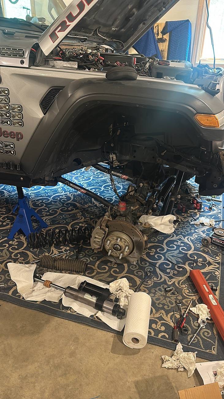

Put it into maintenance mode for a few weeks. Pulling front springs, shocks, and hydraulic bump stops for now. Fox is rebuilding the bump stops under warranty, as they are both leaking. They told me they are in the middle of a seal redesign as a result of this with some customers. While it’s down for the count, will also be rebuilding the RCV axles after 60k miles of service.
Looks like fun! How do you like the Metal Cloak ball joints?
They’re great, but I screwed up the preload on the passenger side. Beginner ball joint mistakes. So I need to rebuild that one. Oh well. Every project teaches me something.
Good idea. They take a lot - and especially in your case. Yours is a case of "harder than typical use" and that's a fair number of miles.
We used to be thankful if the boots lasted that long! Modern design has thankfully gotten us past that. Split a boot, kiss that baby goodbye if you did't catch it immediately.

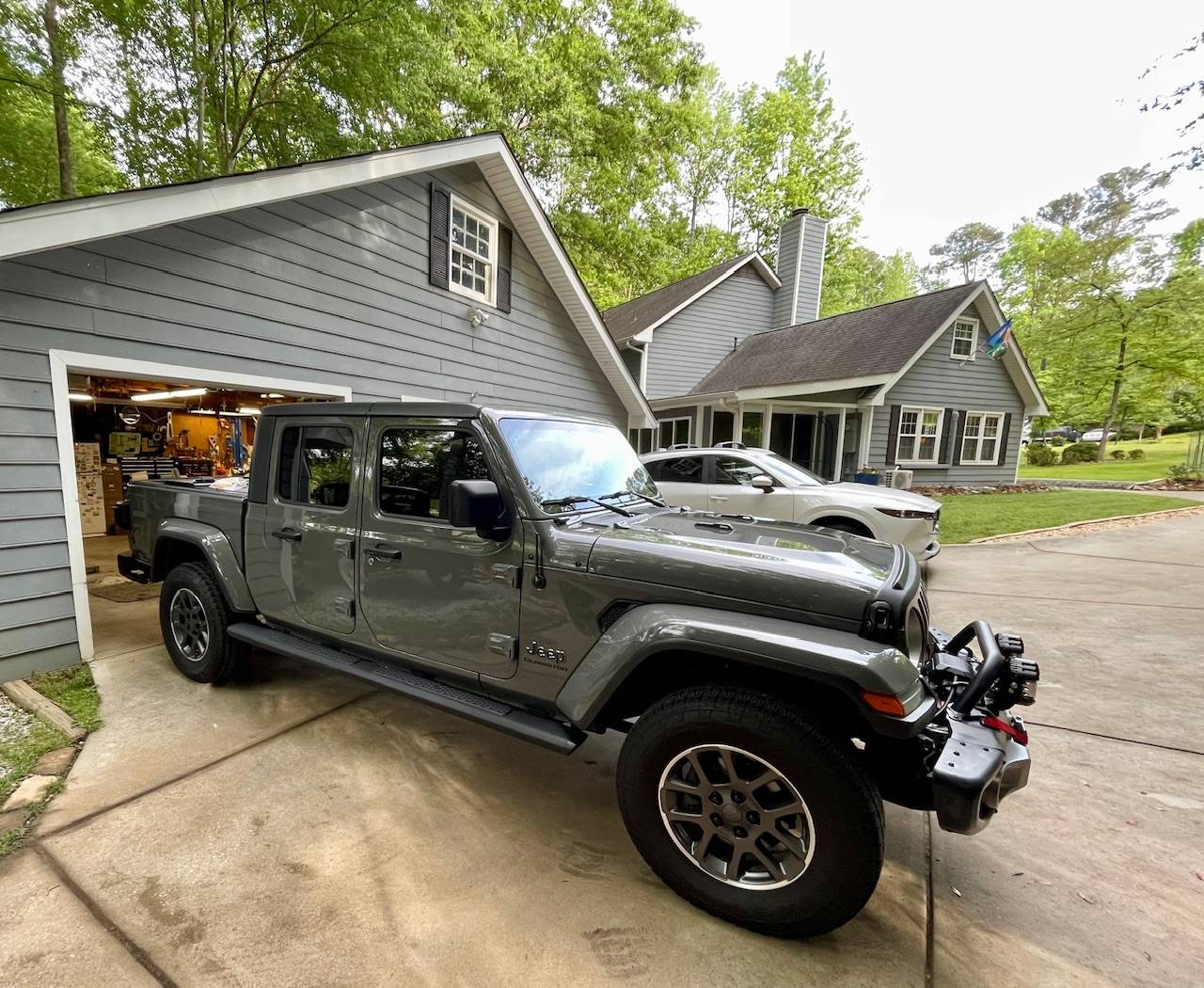

I still have to put a coat of wax on it to seal it up, and de-do the trim I got wax all over, but it’s the shiniest it’s been in years. I spent the afternoon buffing out scratches and polishing the paint up. It’s no longer a 10 footer. Not bad for 5.5 yrs old.
I detailed cars in college and I still take care of my family’s cars, so mine always comes last.
Definitely. New boots aren’t required for this rebuild, and mine are probably fine, but I bought new ones anyway. They’re wear items.
