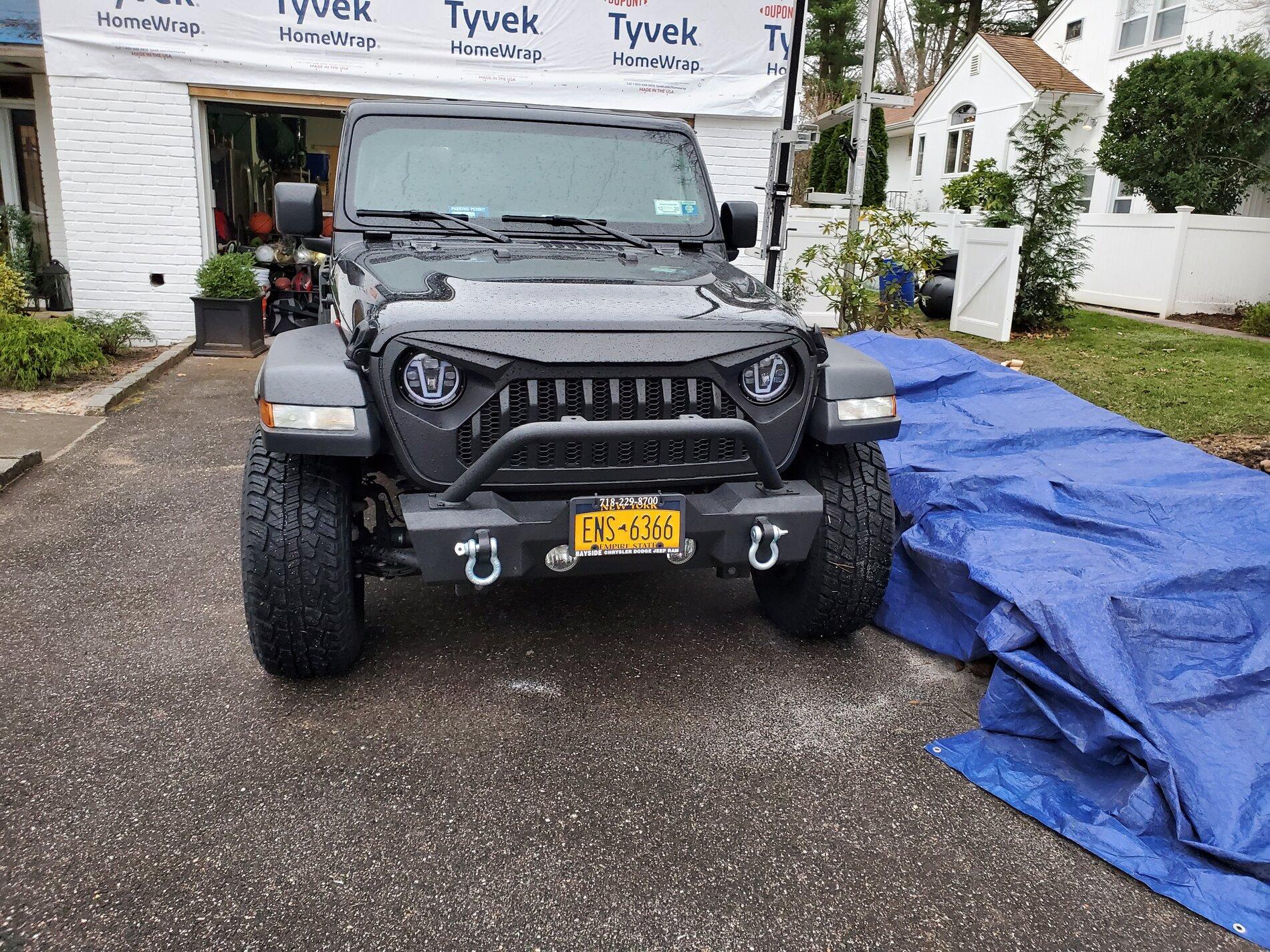

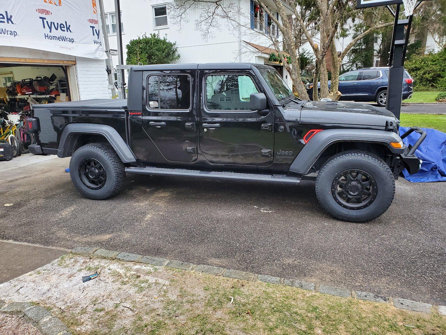

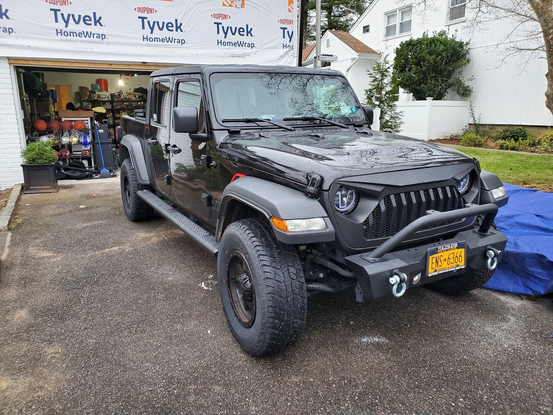

Got my new 285/75/17's tires installed and my new Rocky Ridge stubby bumper. Just got back from the tire shop to get them installed. The bumper I installed myself this morning.
Need to find a better place for my license plate, I temporarily wire tied it on to the winch hole.

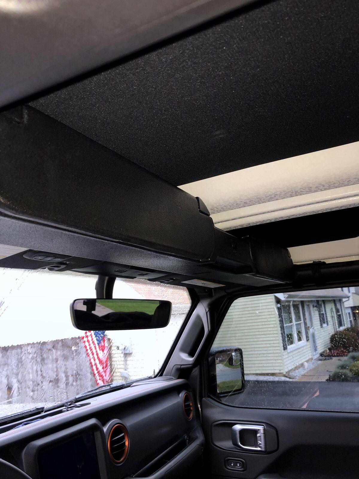

Prior to all of this I installed a Magnuson supercharger, its nice. Just this week I also installed a Truxedo sentry bed cover.

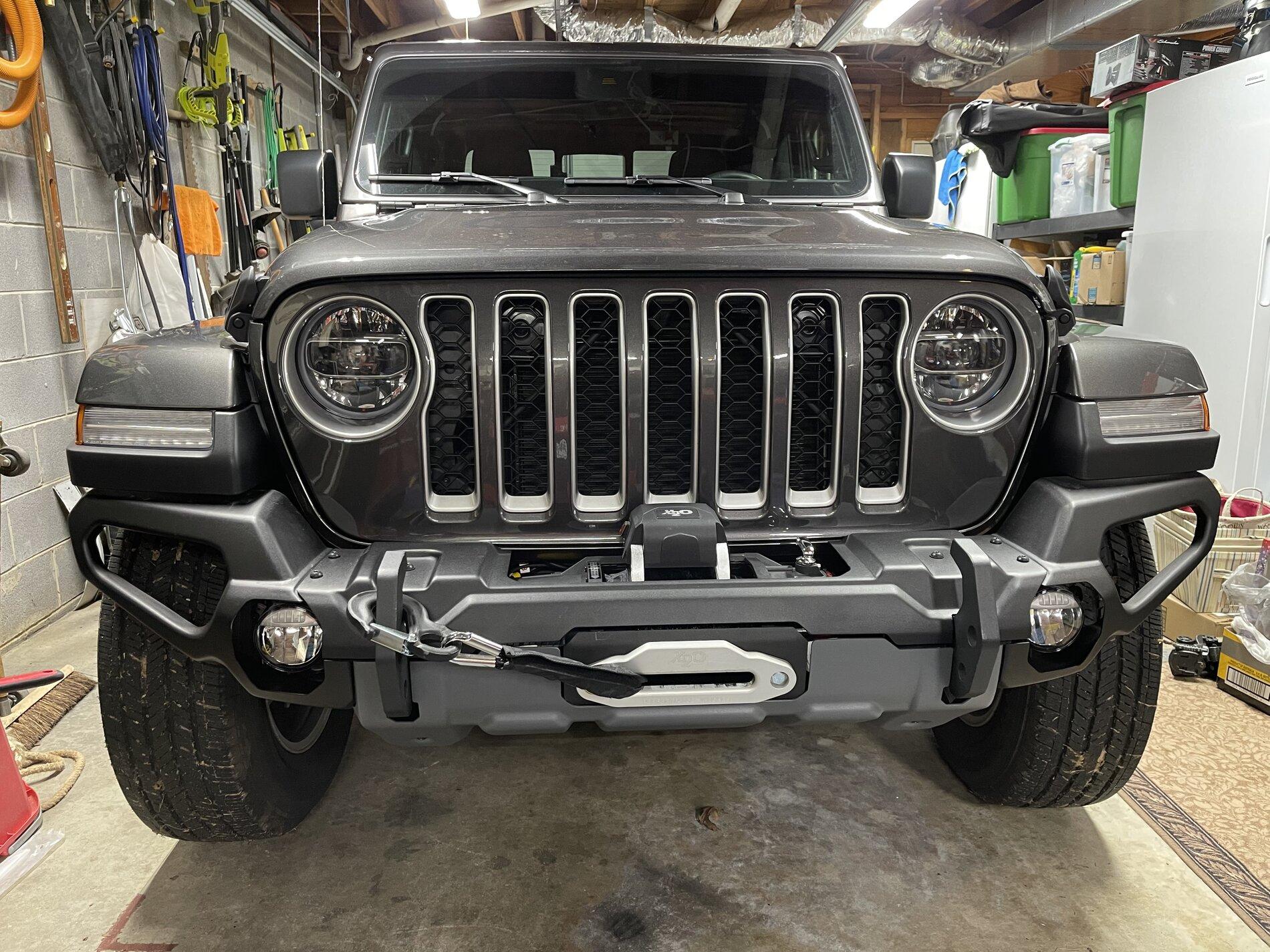

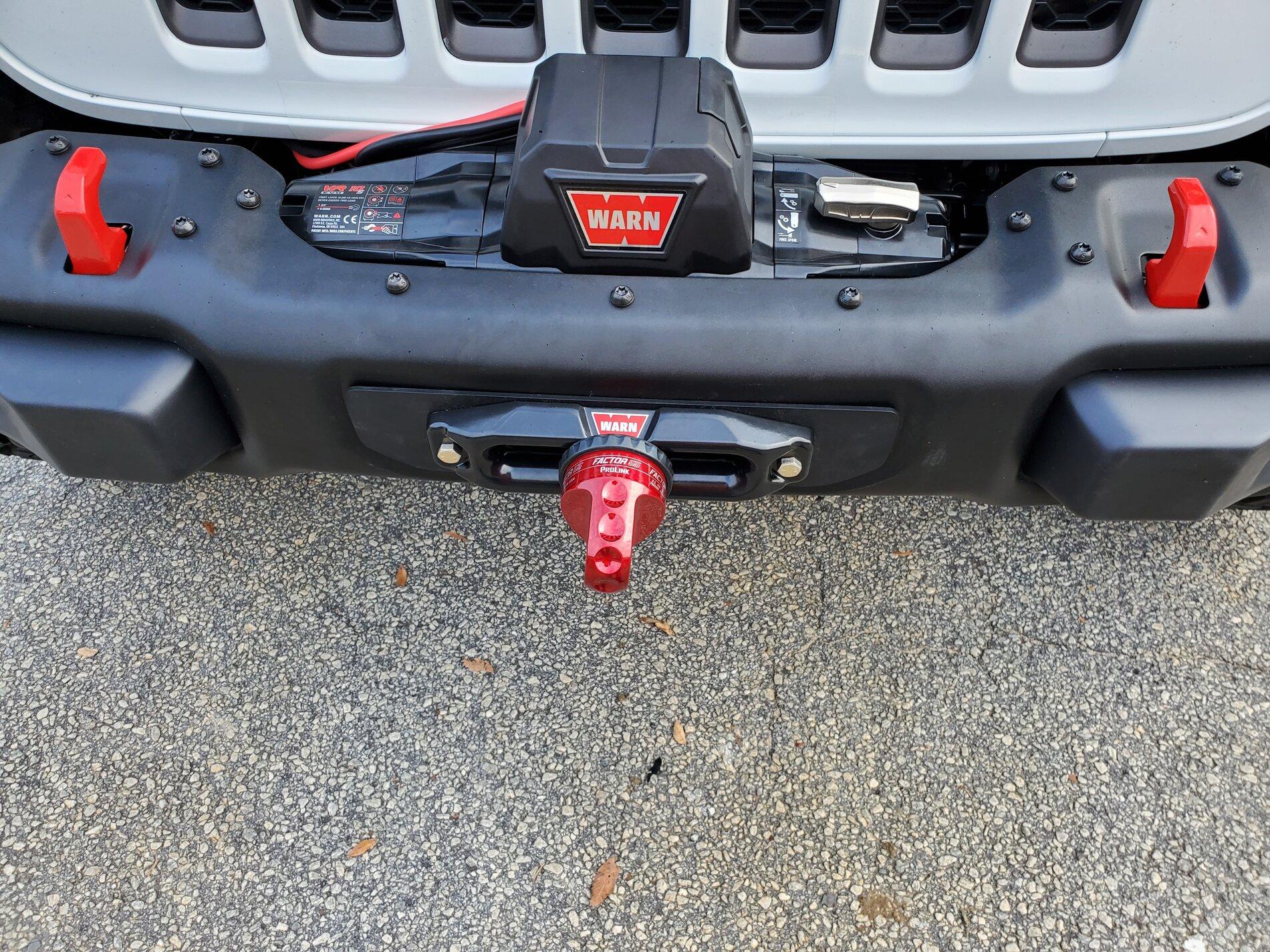

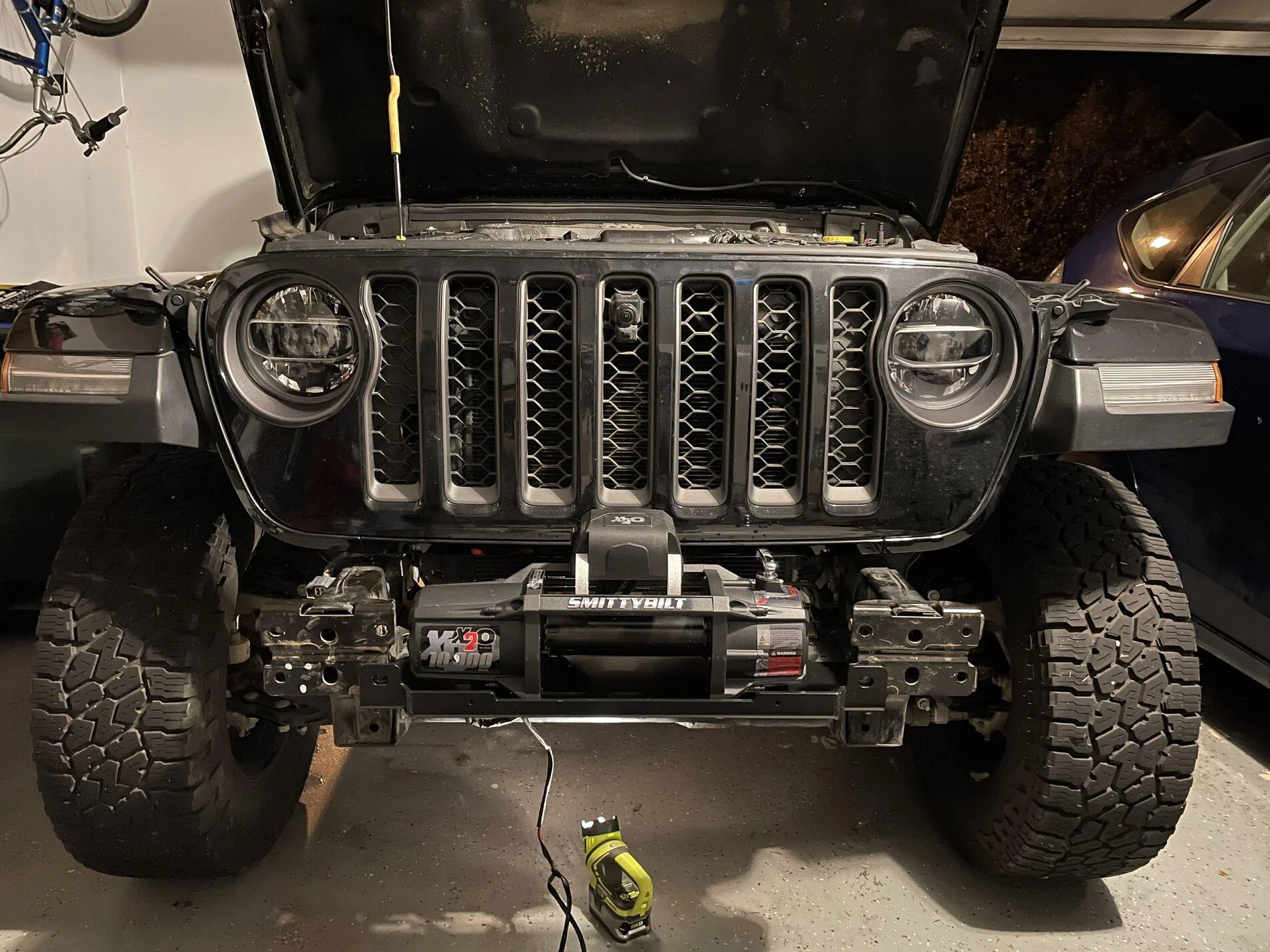

Installed a Rugged Ridge Venator bumper, with a Smittybuilt X20 12,000 winch. Couldn't get the bumper's plastic caps to fit with the factory led foglights.
