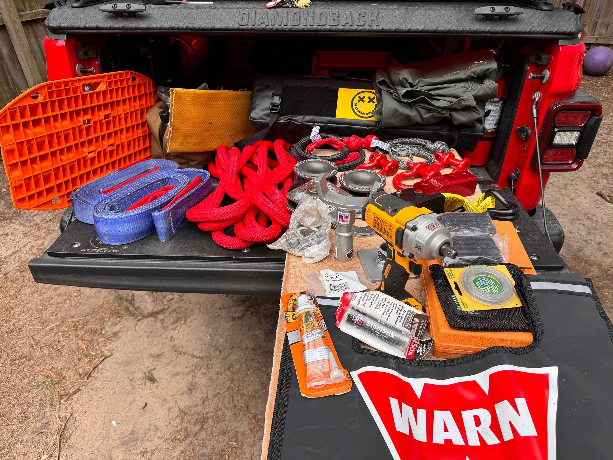

In a large Adventure Tool Company Bag that lives behind the fridge:
  • 3 Factor 55 soft shackles
  • 2 Factor 55 Pulleys and an ARB snatch block so I can back winch (you need a minimum of 3 snatch blocks or pulleys for this)
  • 3 Crosby hard shackles
  • Factor 55 Hitch Link 2.0
  • Factor 55 snatch rope (this takes up most of the room)
  • ARB tow strap
  • ARB tree saver
  • Deadman anchor
  • ARB tire repair kit with lots of extra plugs and steel wire
  • A piece of 5” fire hose as a winch line protector
  • Warn winch line damper
  • Hi Lift lift mate
  • Dickies Coveralls
  • Safe Jack lifting pads and a 3”extension
I also carry a small Atlas 46 bag with:
  • 2 quarts of motor oil
  • Construction adhesive
  • A spare u-joint
  • Safety glass
  • Dewalt battery charger
  • Dewalt impact gun
  • JB weld steel stick
  • Gorilla glue
  • Gorilla tape
  • Mopar fender clips
  • Zipties
  • Gloves
  • Fast Fid for splicing winch line

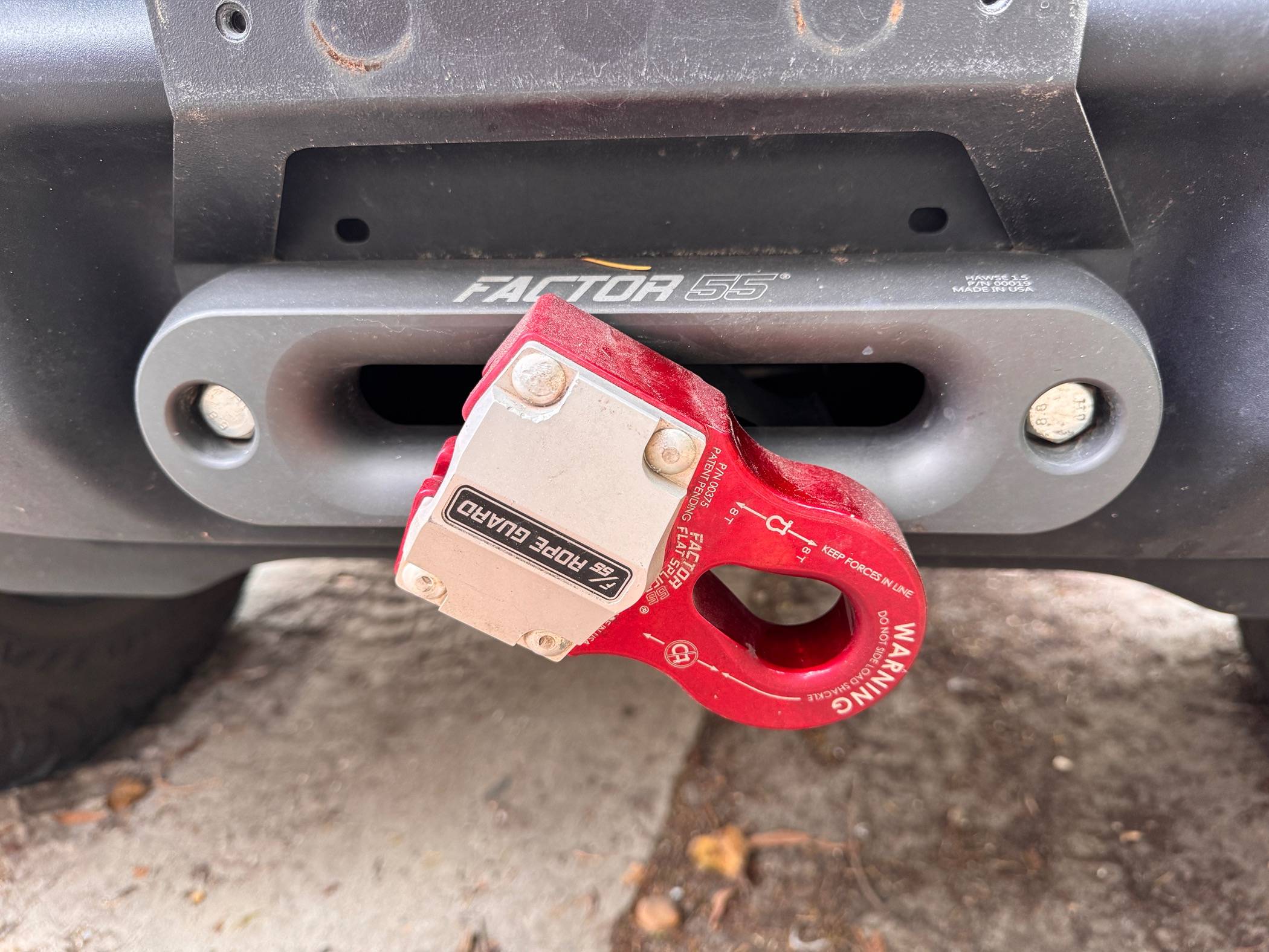

The winch is a Warn Evo with Synthetic line and a spliced on Flatlink

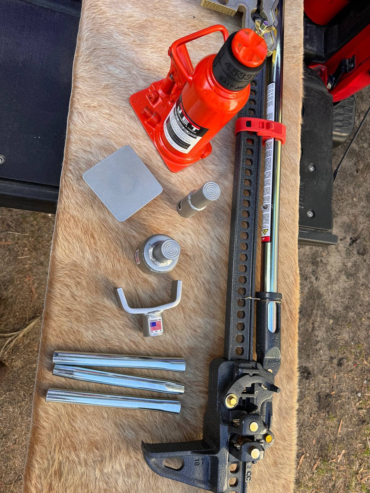

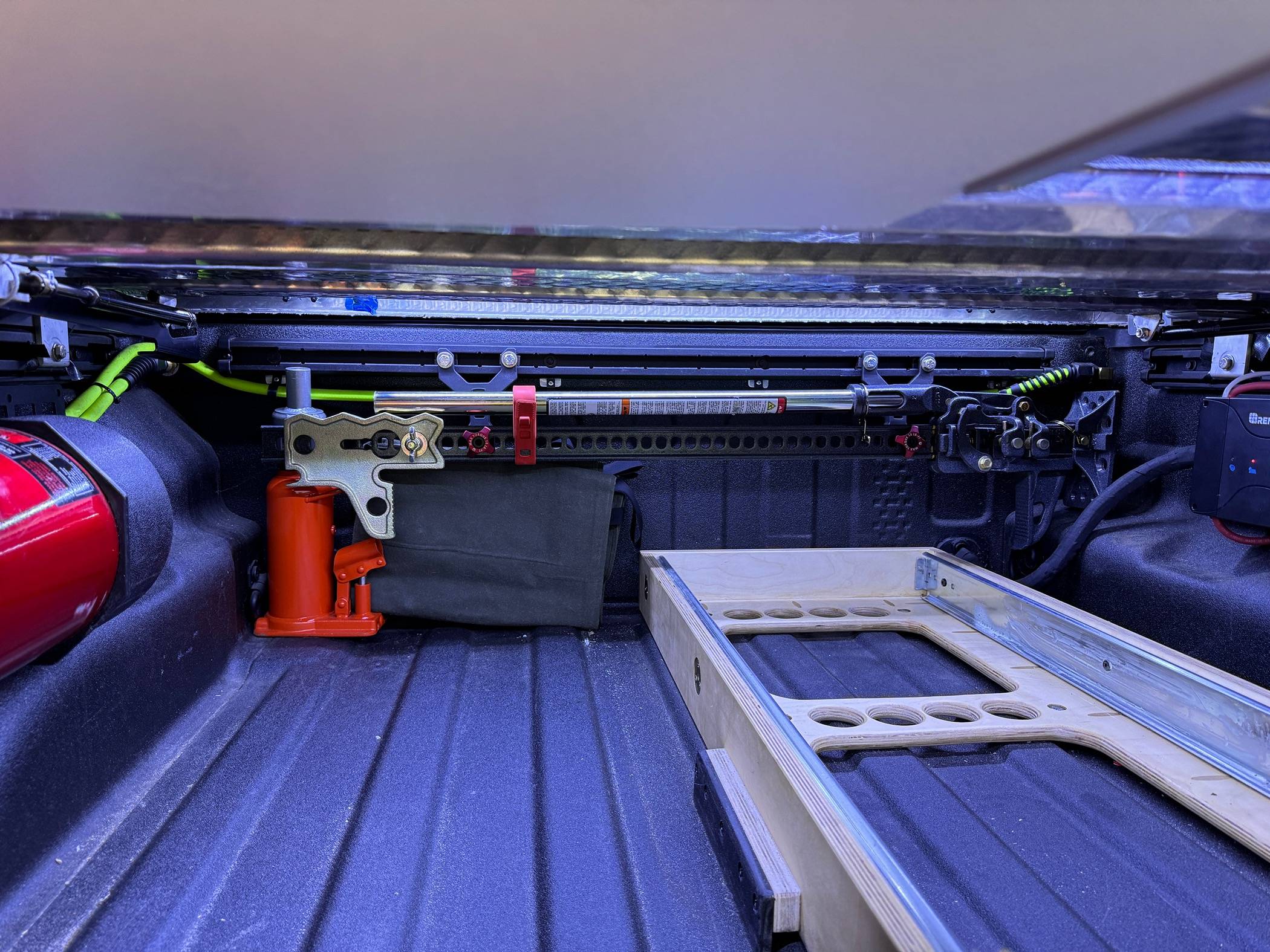

For jacks I carry a Jet (made in Japan) 12 ton bottle jack and a Hi-lift. The Hi Lift is mounted to the back wall of the bed where I hope it never leaves. I don’t use this for tire changes. This is for lifting/leveraging vehicles off of rocks or as a come-a-long. I have a lift mate to go with it.

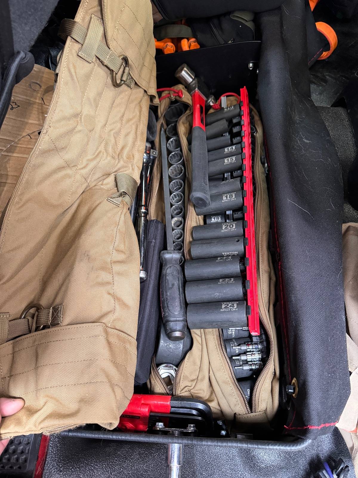

I carry a Yorktown Tool Roll with enough stuff to do basically any repair, including a brass and ball-peen hammers, rubber mallet, torque wrenches and only impact rated sockets a breaker and cheater bars. I also carry an assortment of electrical tools, fuses, etc. This lives locked under the seat. I usually work out of this bag for doing routine maintenance and don’t even mess with my garage tool box.

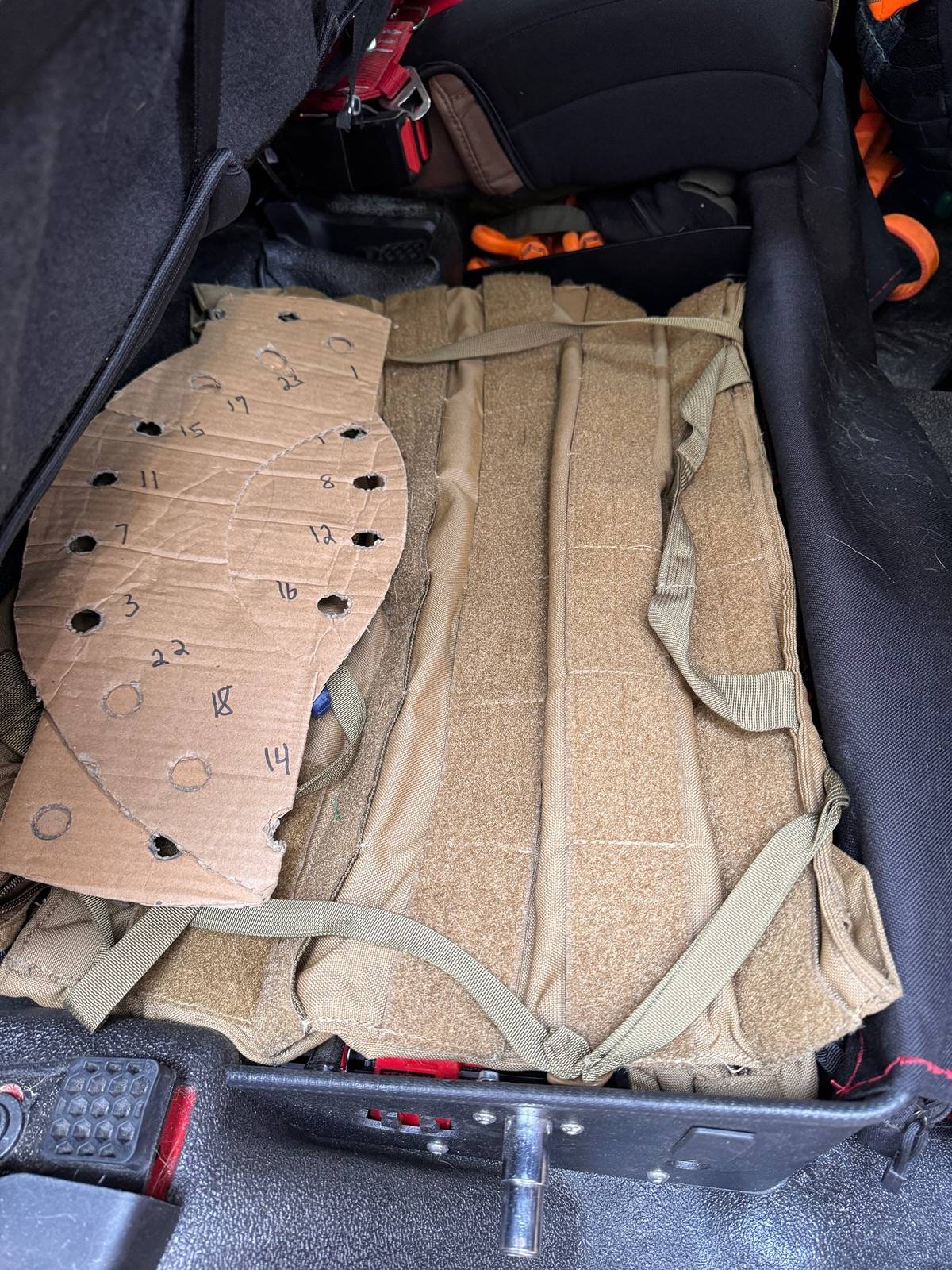

I also carry my cardboard beadlock pattern template for maintaining torque on the wheels.

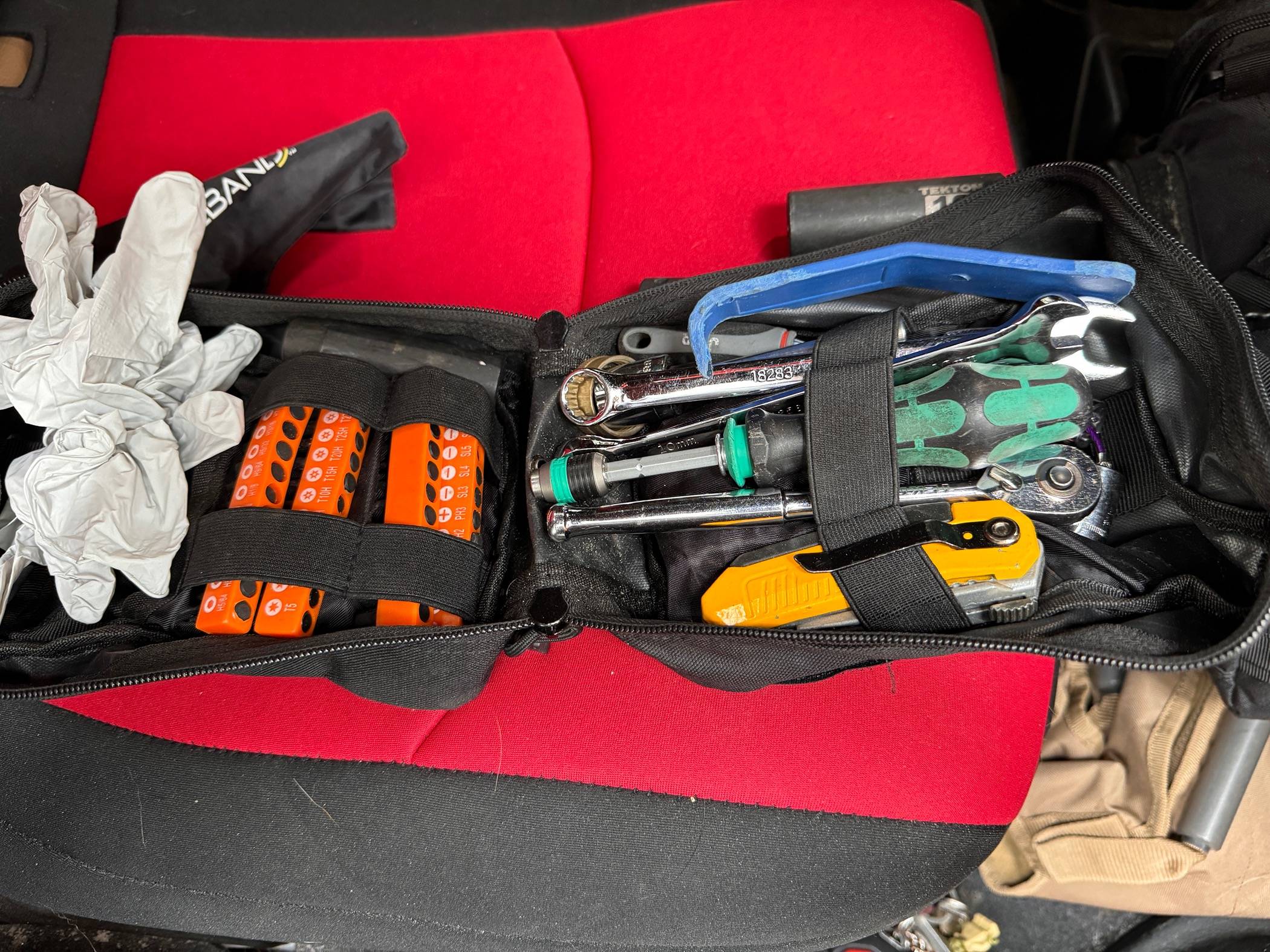

I carry a small bag (attached to a seat molle panel) of 1/4 drive tools with, a headlamp, bit driver and any other stuff I frequently need to grab for messing with the top, trailer hitch, etc. I also carry Dewalt safety goggles because the bottom of the truck is going to be a muddy mess, disposable gloves and work gloves

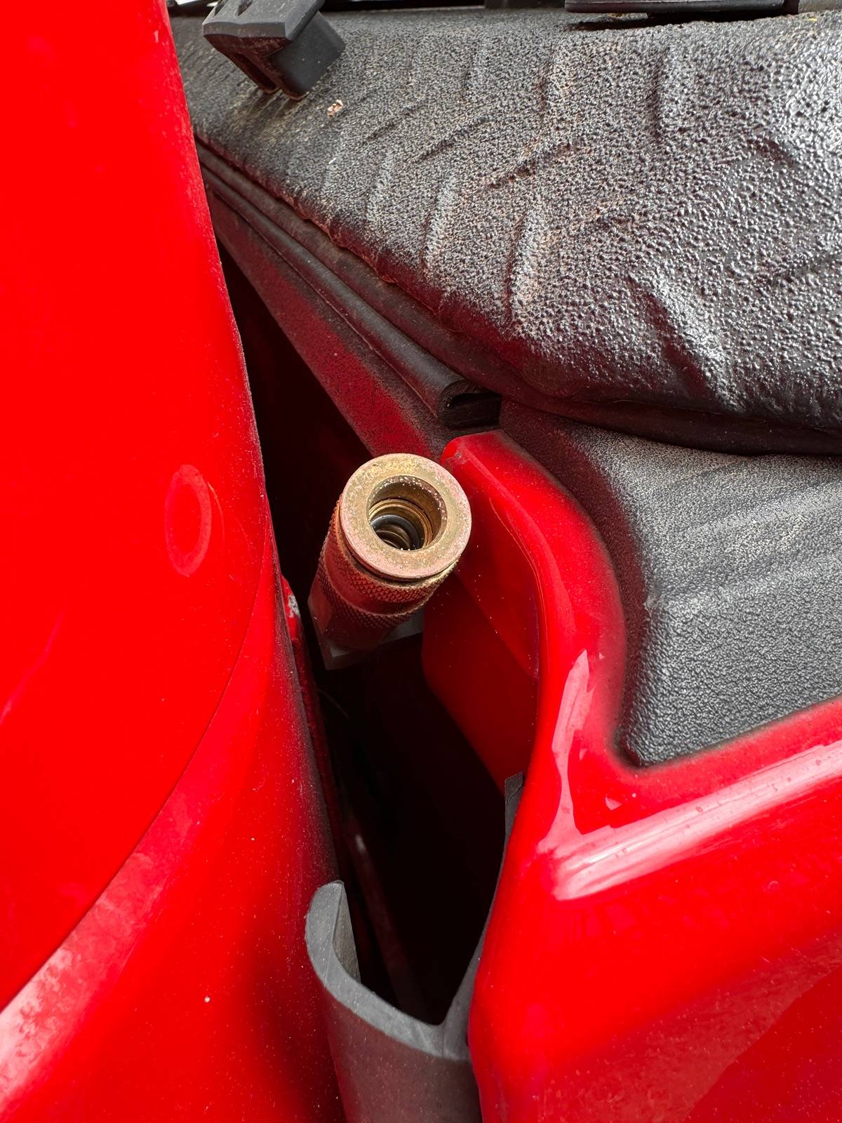

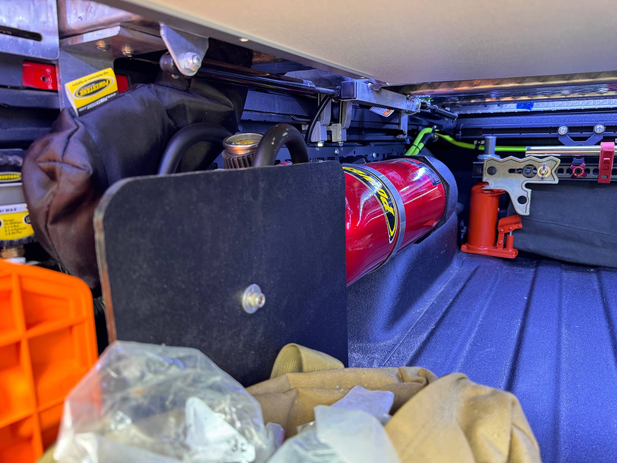

Lastly, I carry a mounted PowerTank which has plumbed-in ports on the side of the truck, hoses for 4-wheel simultaneous inflation, MaxTrax traction boards, a MaxTrax jack base, an spill kit (which everyone should carry but probably doesn’t) and a canvas tarp for working under the truck. I don’t carry air tools because the Dewalt impact gun is better imho and it shares a battery with my portable inflator I use for the water port and my lil’ Dewalt chainsaw I carry for clearing fallen trees and cutting up firewood.
