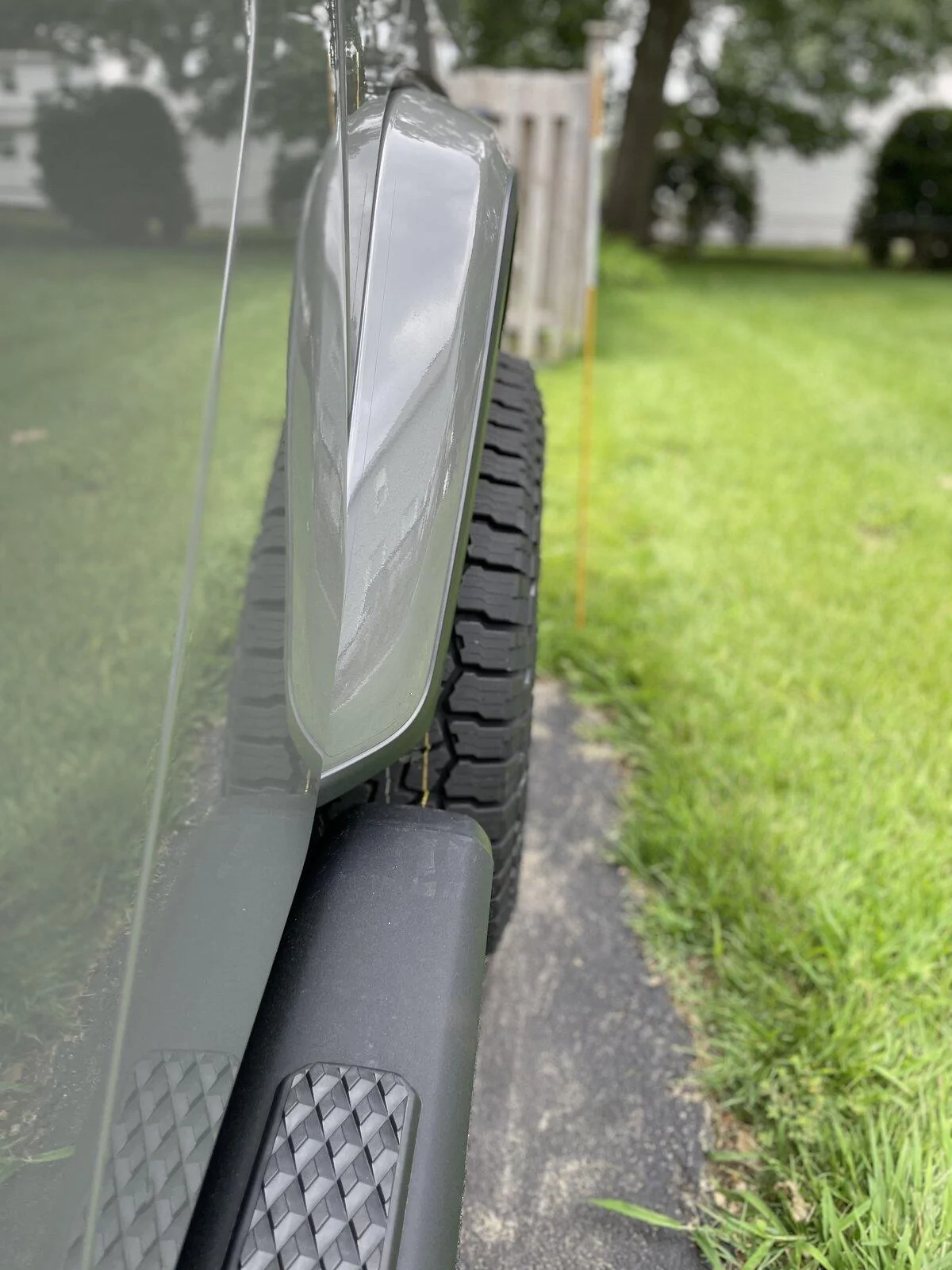

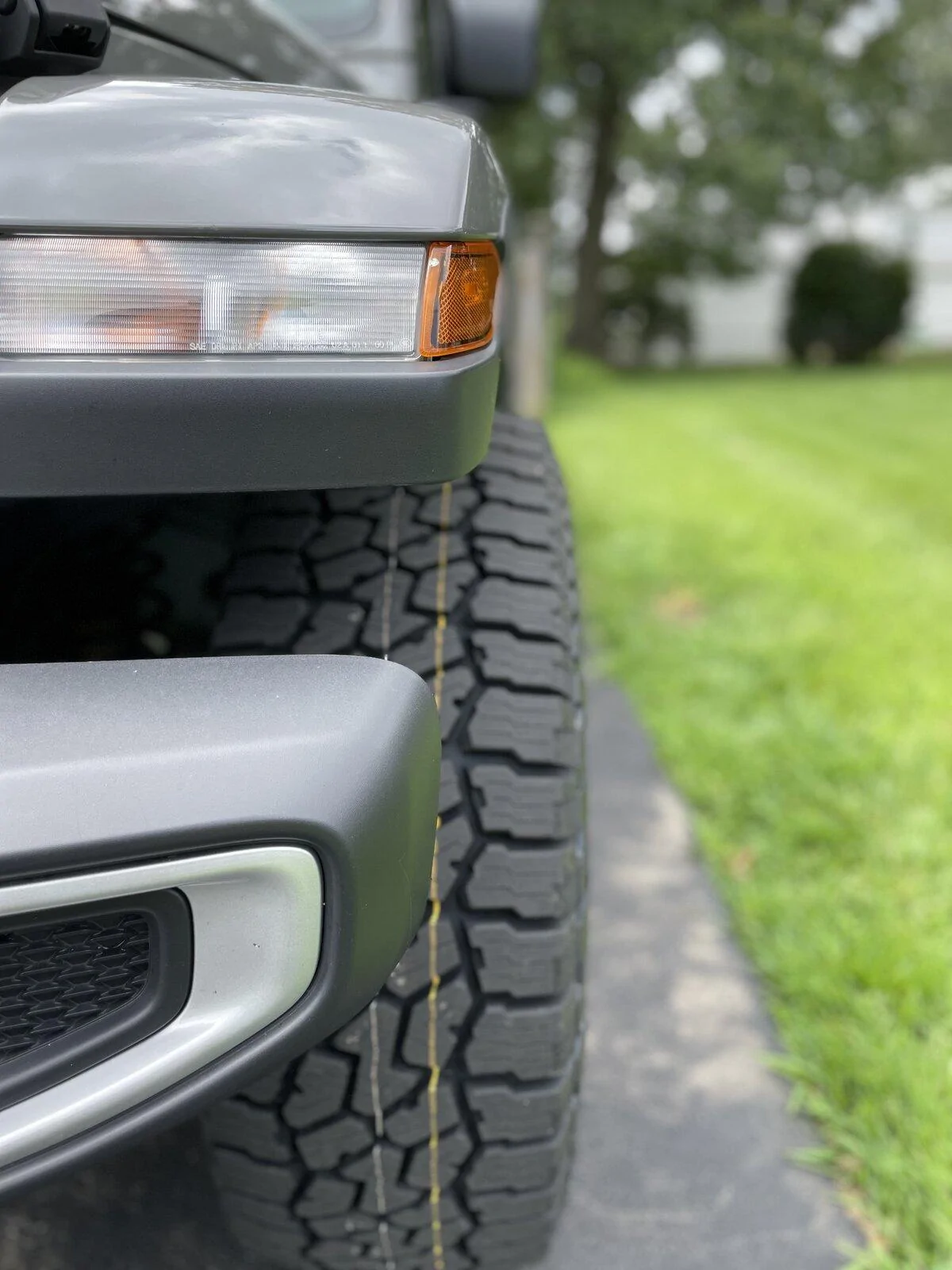

I have a Sport S on stock suspension and put 285/70-17s on +12mm 17x8.5 wheels. Sticks out a little but not overly aggressive. And no rubbing. I probably could have gotten away with +01mm offset which would be tucked in a little more. But overall happy with it.
Contrary to what it appears the higher the + number the less the tire extends out this goes to 0 then - numbers which extend out even more, wheel width also comes into play but on the same width wheel a + number will be more inside the wheel well the higher it is
novdelta
Nick
Aug 5, 2021
53
Oakland, FL
correct. My bad. I always get it mixed up. I checked my paperwork and I put on +01mm offset. Originally thought +12mm but went with my gut
