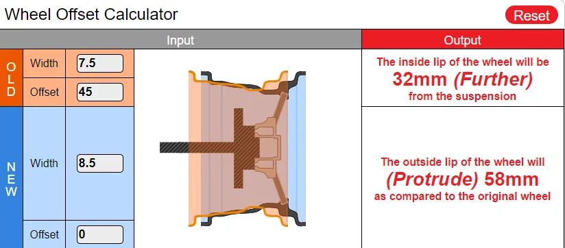

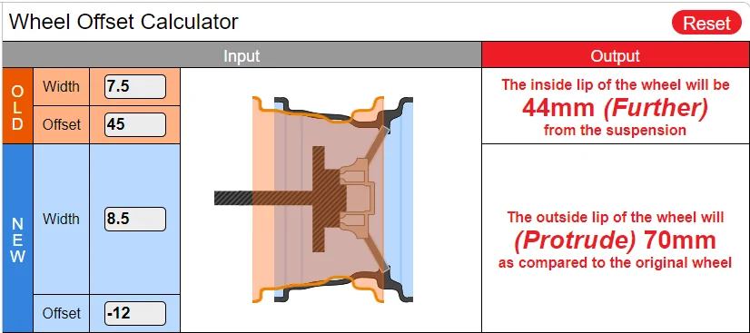

@FLJprCrpr from a factory 7.5inch wide with a +45 to an 8.5inch wide and 0mm offset would give you 58mm poke or 2.28 inches out. -12mm would be almost 3 inches of poke.
Jeep Gladiator Wheel Size Help! 1703088681260
Jeep Gladiator Wheel Size Help! 1703088728826
0 and -12 being the most common offsets.
