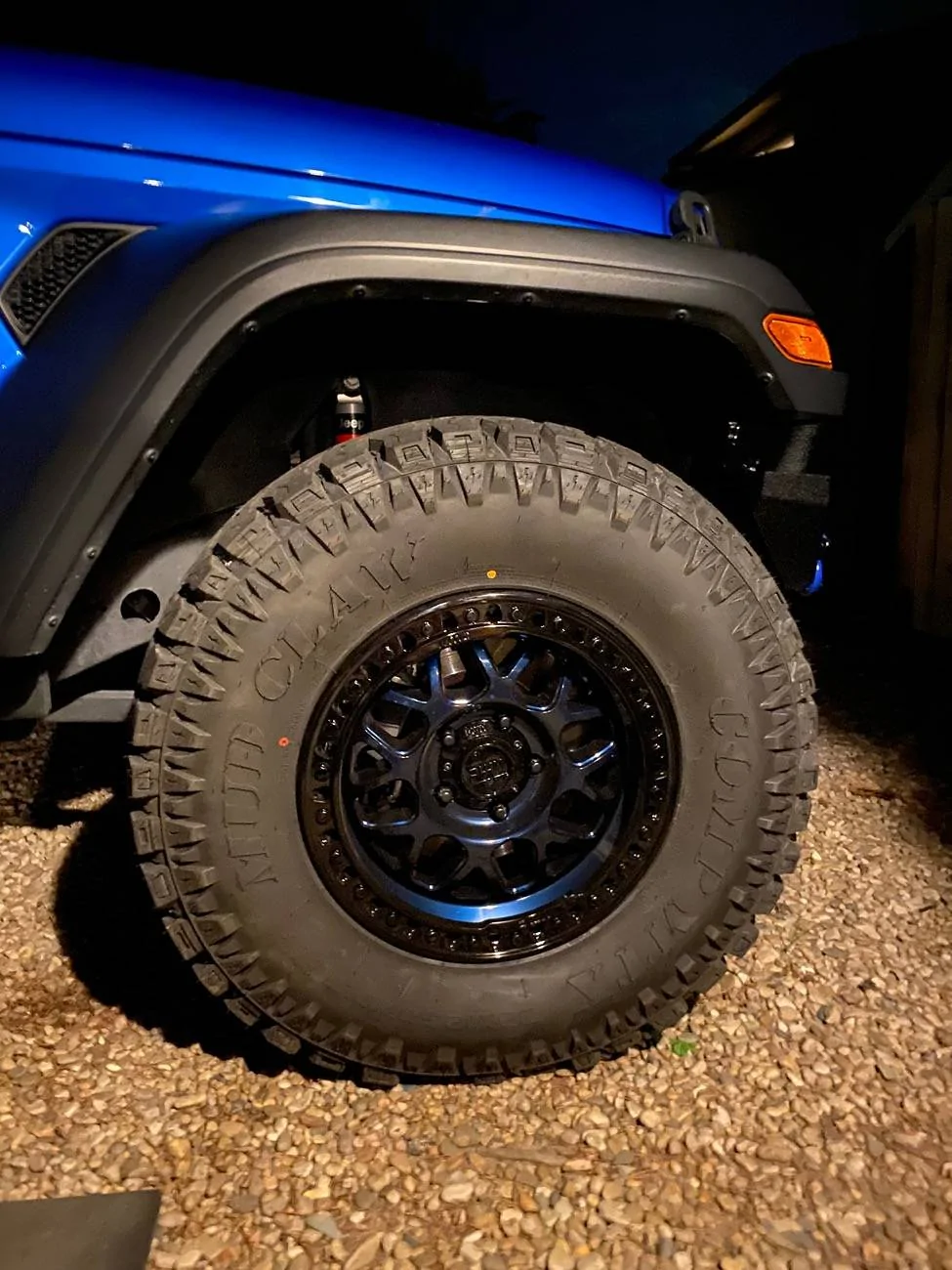

Looking to upgrade wheels and tires on my gladiator. I know the wheels I want but have two size options and can’t decide which to run with. 18x9 0mm or 17x8.5 -10mm. Tires will be 35x12.5
You might want to push to a more positive offset to keep the rubbing to a minimum. I went 17x8.5 +18mm with 35x12.50 MT, with no lift and no rubbing.
Jeep Gladiator Can’t decide which wheel size to go with. Need help! IMG_0912
I think maybe you have that backwards? With all due respect, correct me if I'm wrong correcting you.
Positive offset moves the mounting surface outwards towards the face of the wheel, thus tucking more of the wheel under the fenders. How would that decrease rubbing potential?
A negative offset moves the mounting surface inwards which pushes more of the wheel/tire outwards, away from fenders, liners, and suspension parts.....similar to a wheel spacer.
Our stock modern Jeep wheels have a ridiculous +44mm offset so moving to anything less than that, even +18, would move the wheel/tire outwards and increase clearance. +18 is nice compared to stock. -10mm is better if you want that deeper dish look and more inner clearance.
Oops, sorry I got it backwards…+18mm is what I landed on for poke out and when we mounted the new rim and tire, we full stuffed and max droop it to check rubbing and got none on the JT. Wasn’t really after the deep dish look. Greg_L, Thanks for keeping me straight, OP sorry about the dyslexic thinking moment, I’m sure it was a creeping senior event.

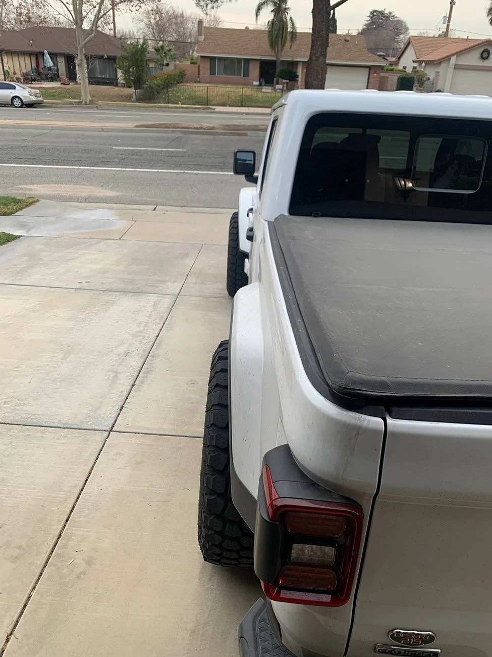

Anyone have pictures of what a -10 offset looks like as far the wheel sticking out?
I can get you close
Jeep Gladiator Can’t decide which wheel size to go with. Need help! IMG_4003
37x12.50r17
