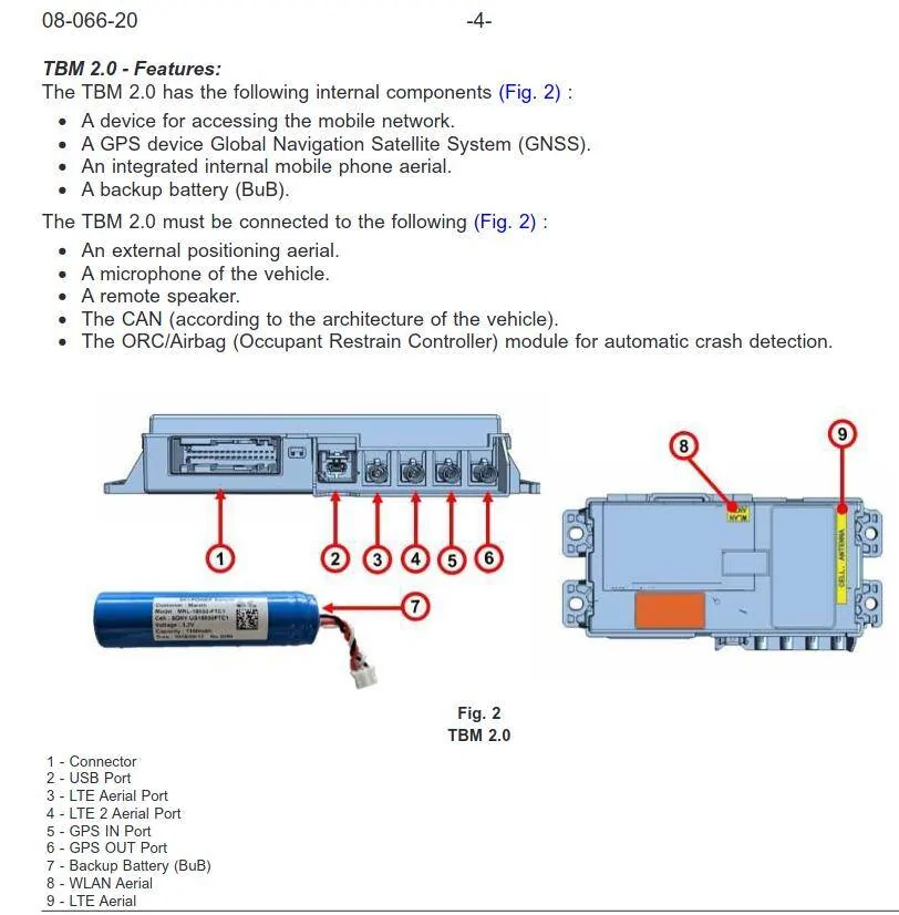

Pretty sure that's not the case. per moparparts website:
https://www.moparwholesalestore.com...yJnk9MjAyMSZ0PXJ1Ymljb24mZT0zLTZsLXY2LWdhcw==
and for the newer ones:
https://www.mymoparparts.com/oem-parts/mopar-telematics-module-68673681aa
Both of them have the TCB module for the gladiators. I followed this video which was still applicable to my 2024:
I'll report back with any oddities, so far everything appears to work via the fob but now not via the phone app. Stereo doesn't seem to be irritated with the unplugged antennas any longer. We shall see...

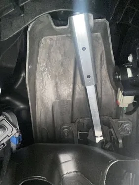

Mine was a bit more towards firewall. It’s up in there pretty high. Unplugged the gray latch plug. Only thing I seem to have lost is xm.
