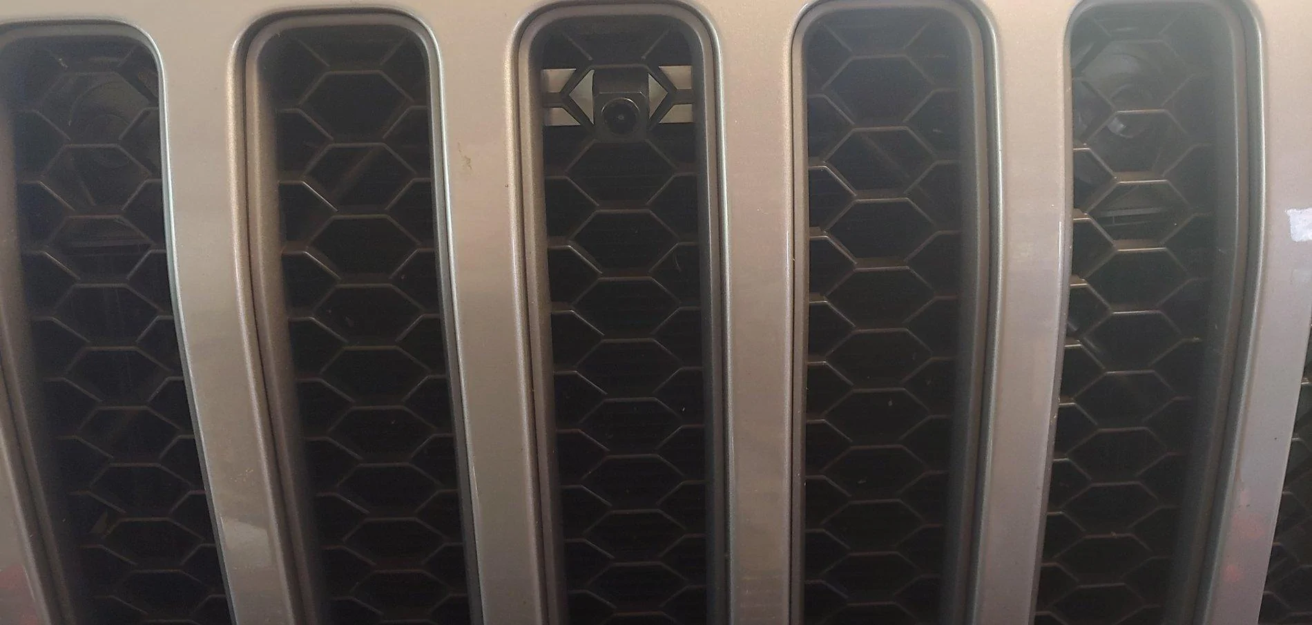

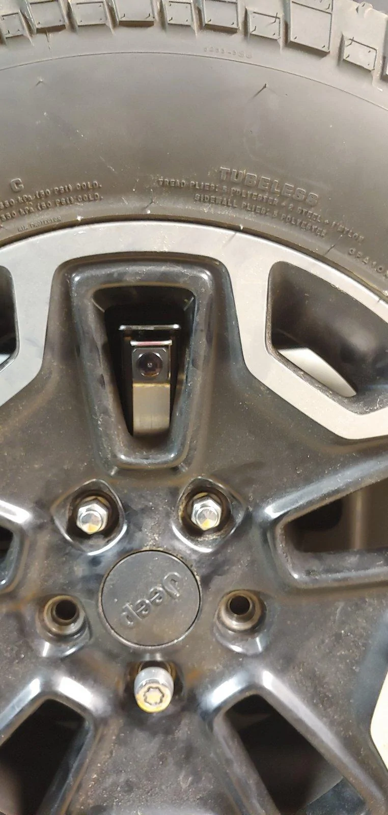

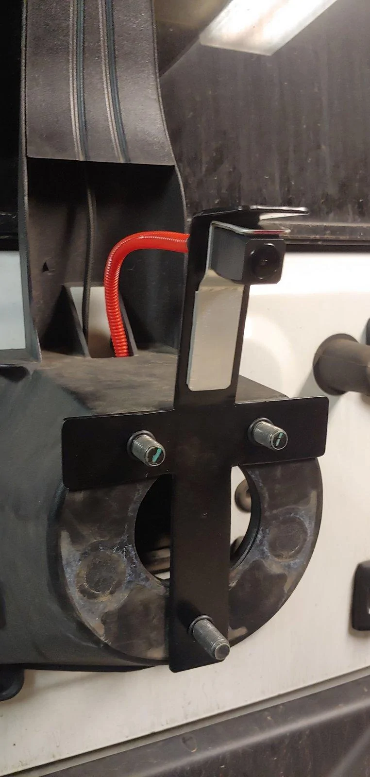

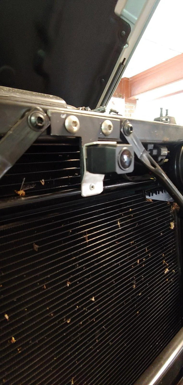

I put the identical unit in my JK. It was fantastic. It didn't have a back up camera so that was a conventional install. I built a mount that went behind the spare wheel.
I have posted about that camera before, it is an awesome buy. Camera, hard wire kit and 64gb SD card well south of $150.
ETA : Garmin and Sony are also going to use the Chinamans cameras, they aren't hand crafted by artisinal Japanese electronics technicians.
Here is the same camera mounted in the JK

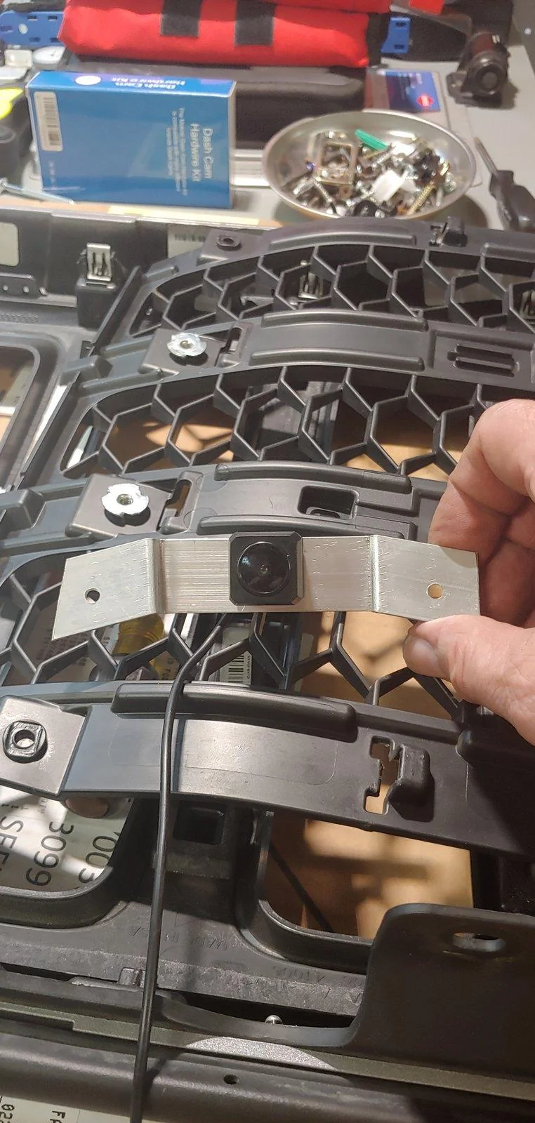

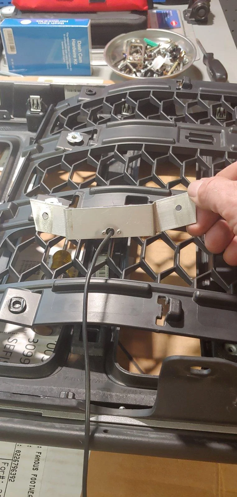

And here is the first prototype camera mount I built for the JT. I couldn't get the camera far enough through the grille that the camera wasn't seeing the "slots", nor could I get it pointed downward enough,
Jeep Gladiator Who ordered front camera? 0928191617b_HDR
so I moved on to redesign. The camera as mounted now will see the ground a little less than 4 feet in front of the bumper.

It displays on a rear view mirror that covers the existing rear view mirror. So it will record dual forward images, one from the mirror height and one from the grille continuously. You select the image that you want by swiping the screen left to right, and can pan up and down by swiping up or down. Conventional front/rear mounting allows continuous dual image (front/rear) recording on up to 64gb micro SD card.
Turn the cameras off and you have a functional rear view mirror.
