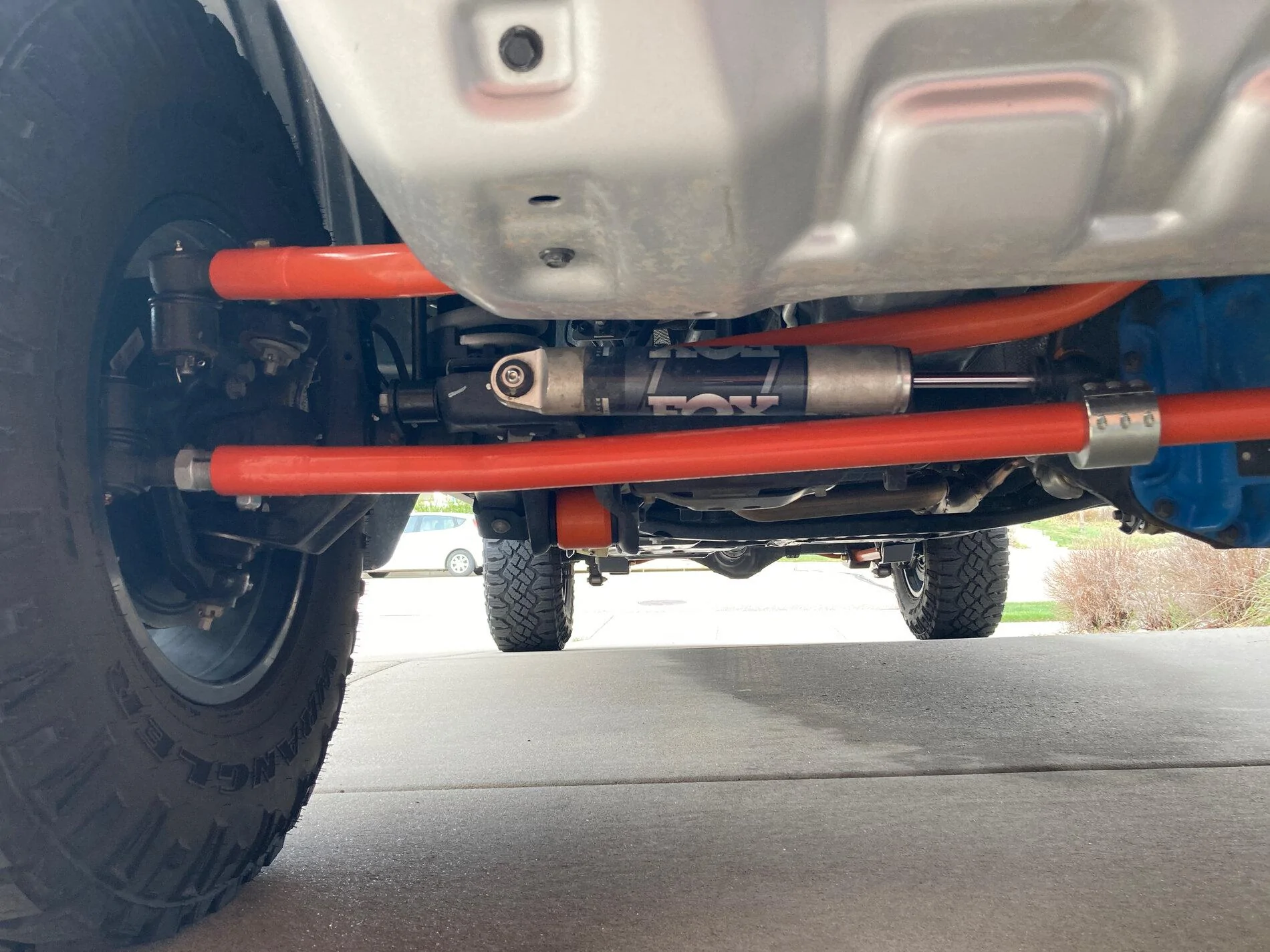

I don't know what shop this came out of, but I do know it is a bad idea and may be dangerous.
Please be educated before you buy and don't let shops do dumb things to your Jeep!
Drag link flip on a 2" spacer lift.
Why is it bad? Because now there isn't enough clearance between the link and the frame rail on the passenger side. Articulation or even a big bump is likely going to cause a solid hit on the frame and drag link.
What kind of stupid stuff have you seen shops deliver?
