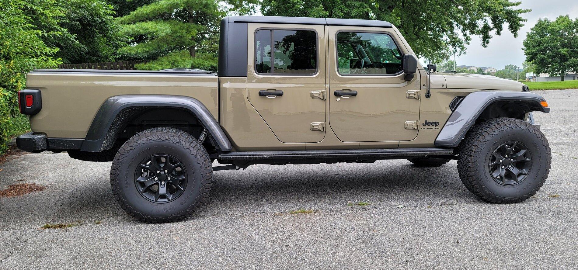

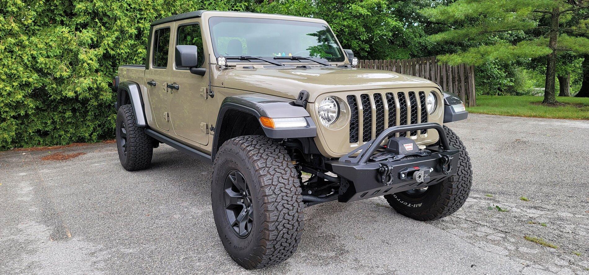

2” Mopar because it was used and cheap, I had planned on a Clayton lift but I figured this would hold me off for a bit while I used the money to upgrade other parts. I am not disappointed in the Mopar lift at all, rides great and gives me the lift that I wanted.

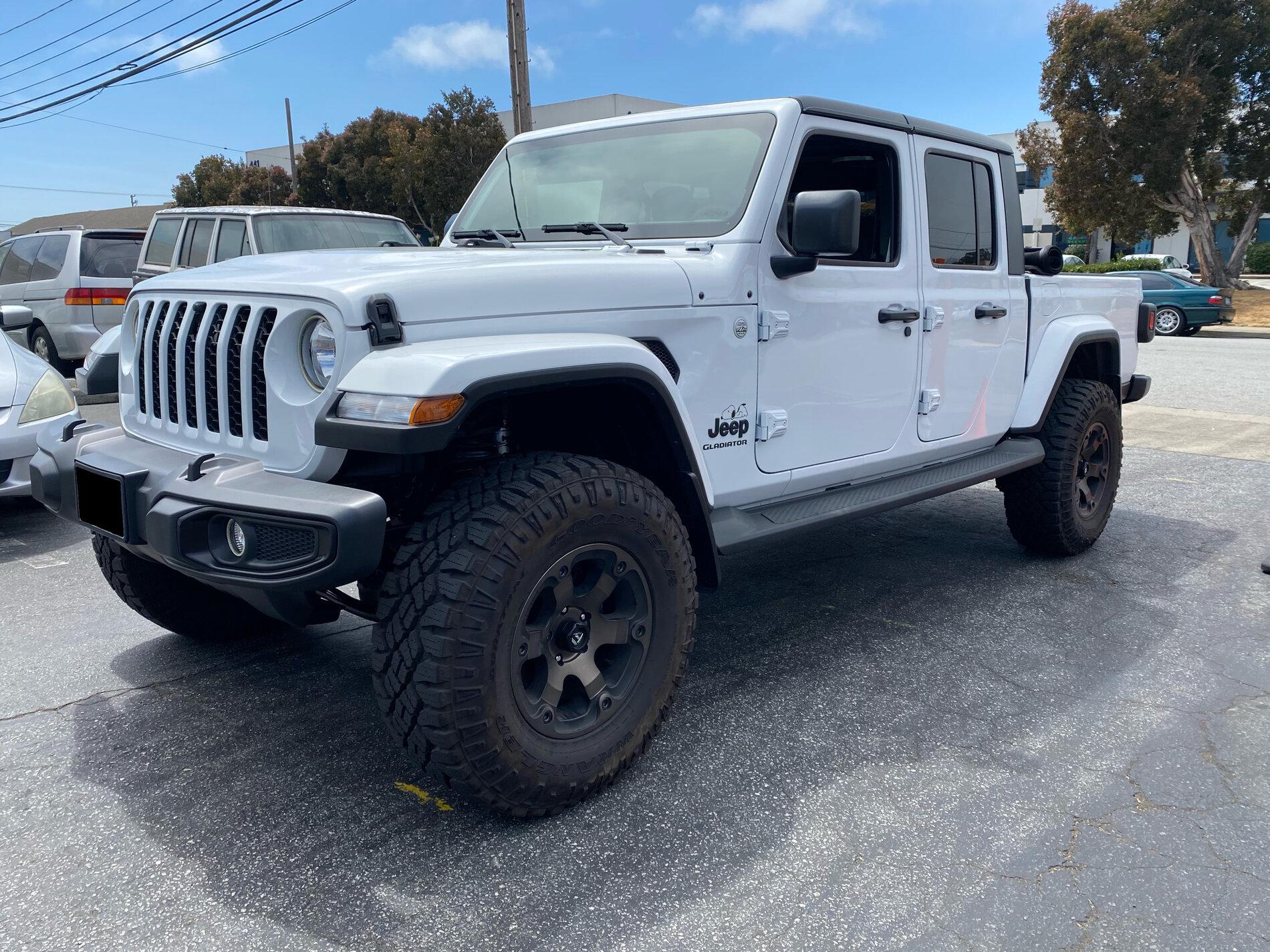

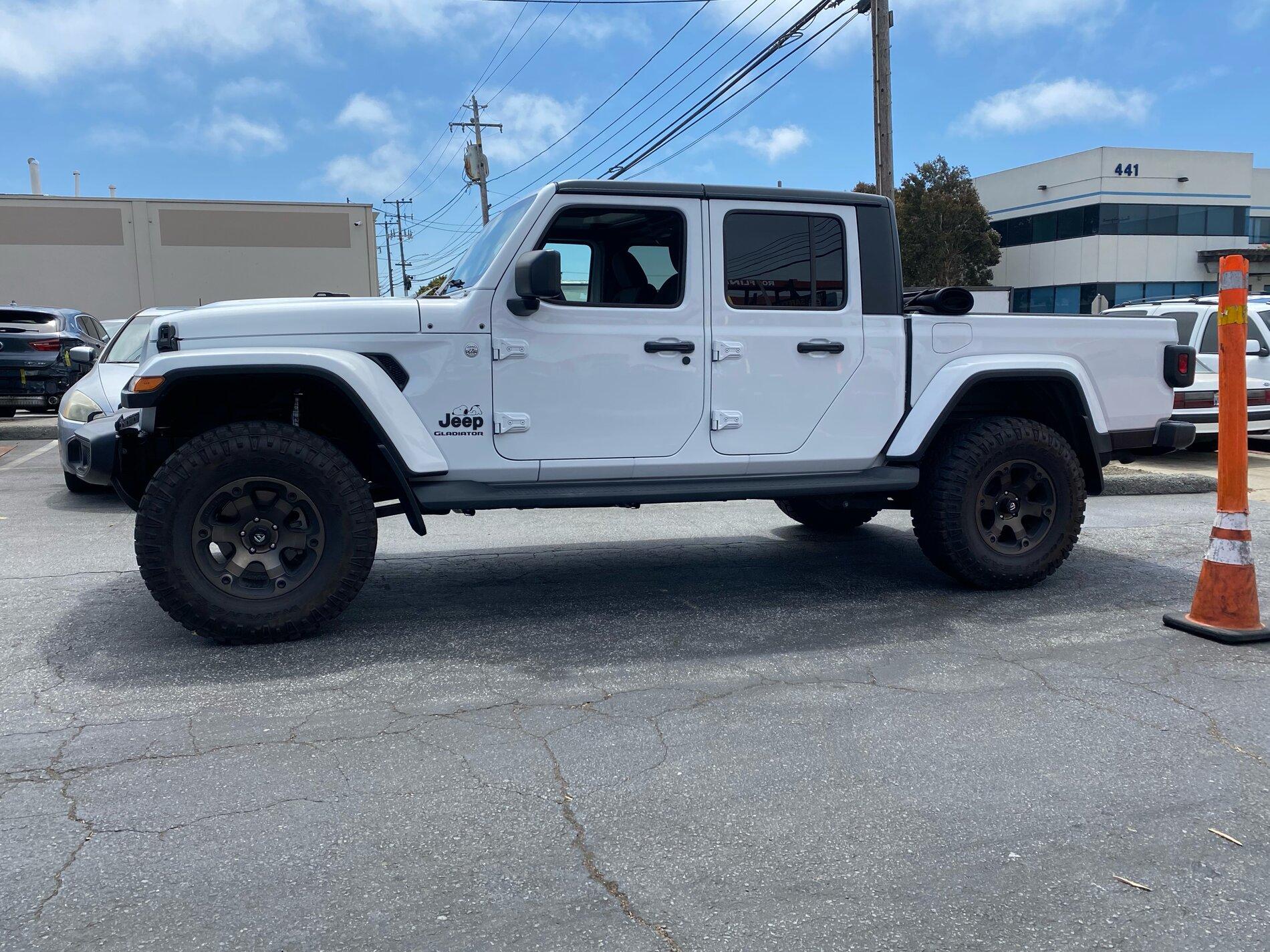

Another vote for MOPAR 2" Lift.
