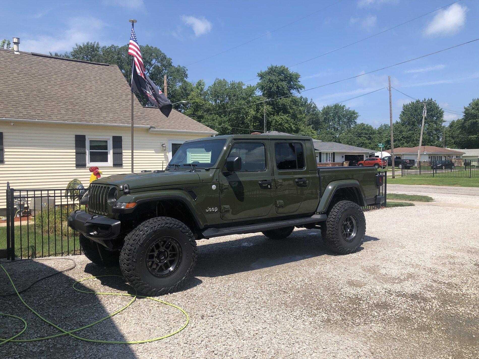

Finishing up my evo kit tomorrow, so far nice components, instructions are terrible. I wrenched in a shop for 5 years and did hundreds of lift/lowering kits. These instructions are shit. I did get a bent rear track bar bracket that they are sending a new one out for.
the sway bar links are cheesy standard ones that will not last long
How'd this turn out?

Track bar bracket ended up being wrong one. maybe a JL one? i could not ever reach evo manufacturing, I contacted north ridge who I bought it from and they took care of me.
I dumped the evo rear track bar for a bent claytons piece to fit a 37“ spare under the bed. My front track bar was rubbing on the factory bracket a bit on the edge. I have a synergy brace too so I ground off the bit it was rubbing on. I believe it may be welded just a bit twisted. I’ll have to replace it once I start some hardcore off roading. Blistein 5100 shocks are a little hard for my liking, a softer ride would have been nice.
4.5” lift nettted a little more than 6” so a bit taller than I wanted
