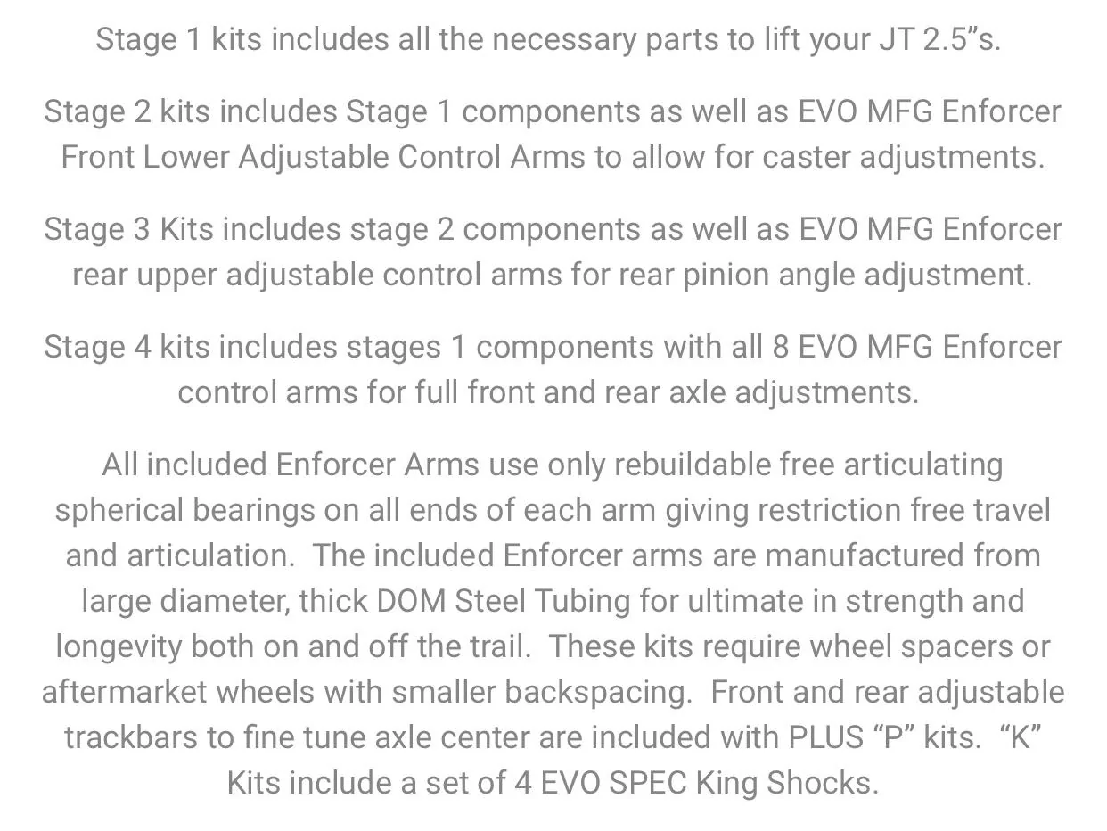

can you tell me the difference between the stages, I'm a little lost on the differences? I'm also assuming that if I got an Evo kit without the king shocks, the only parts I would need would be shocks?

If you go here, and read the descriptions, it tells you what the different stages include...
https://www.northridge4x4.com/part/...acturing-2-5in-enforcer-lift-kit-stage-2-plus
Jeep Gladiator Which Lift Kit to Pick From 5D05FFC6-E93B-4266-998A-EC5FEFF6E22D
And yes, you will need shocks. I have a Rubicon, which comes with Fox shocks from the factory, so, Im going to be using shock extension brackets to reuse my stock Fox shocks. This is a cheap option if you buy a cheap used set of Rubicon take-off Fox shocks from someone selling them online.

Thank you so so much for the help!
The long and short of the evo lift is the control arms. The higher the stage number goes the more of the control arms that are included. The stage 4 is complete.
