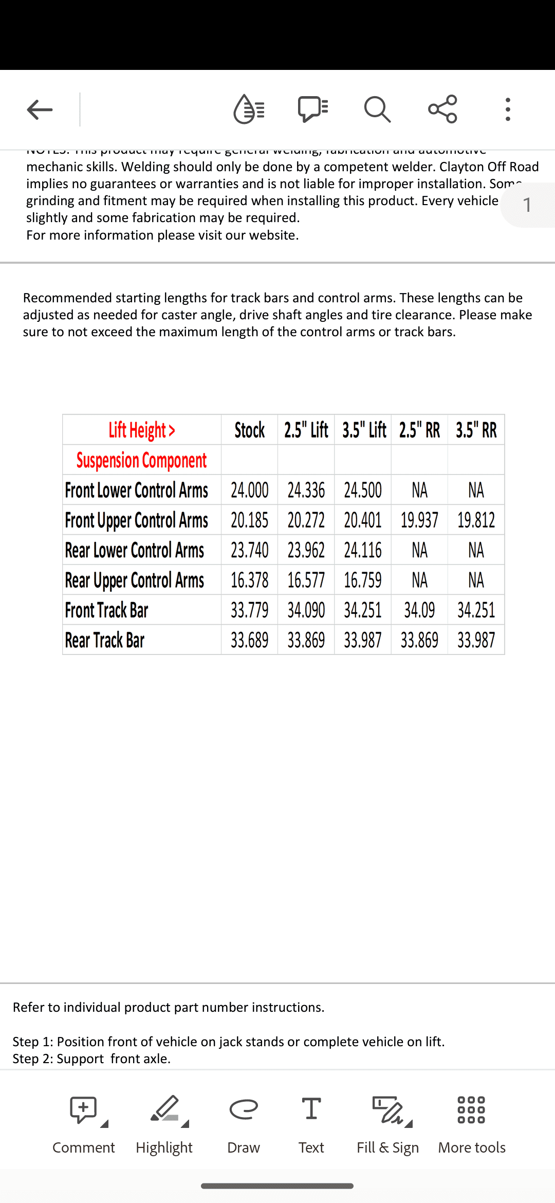

There is no difference in the trackbar between a rubicon and a sport, but at 3" of lift, your front axle will be off center.
Agreed, but my point was that adding a Mopar lift doesn't require a greater amount of adjustment than a Rubicon. That there's a large number of folks running the Mopar lift straight out of the box with 1/4" offset and no issues. The adjustment is 1/4 -1/2 inch max. Here's an example of the amount of adjustment from Clayton's 2.5 inch lift.
Jeep Gladiator Which lift kit do I buy? Screenshot_20230605-094128
JT1
Nov 13, 2020
768
744
Oklahoma
2021 Gladiator Willys
getting away with it doesn't mean it's correct.
Replace the trackbar.
Next step is "why does my jeep pull right"
