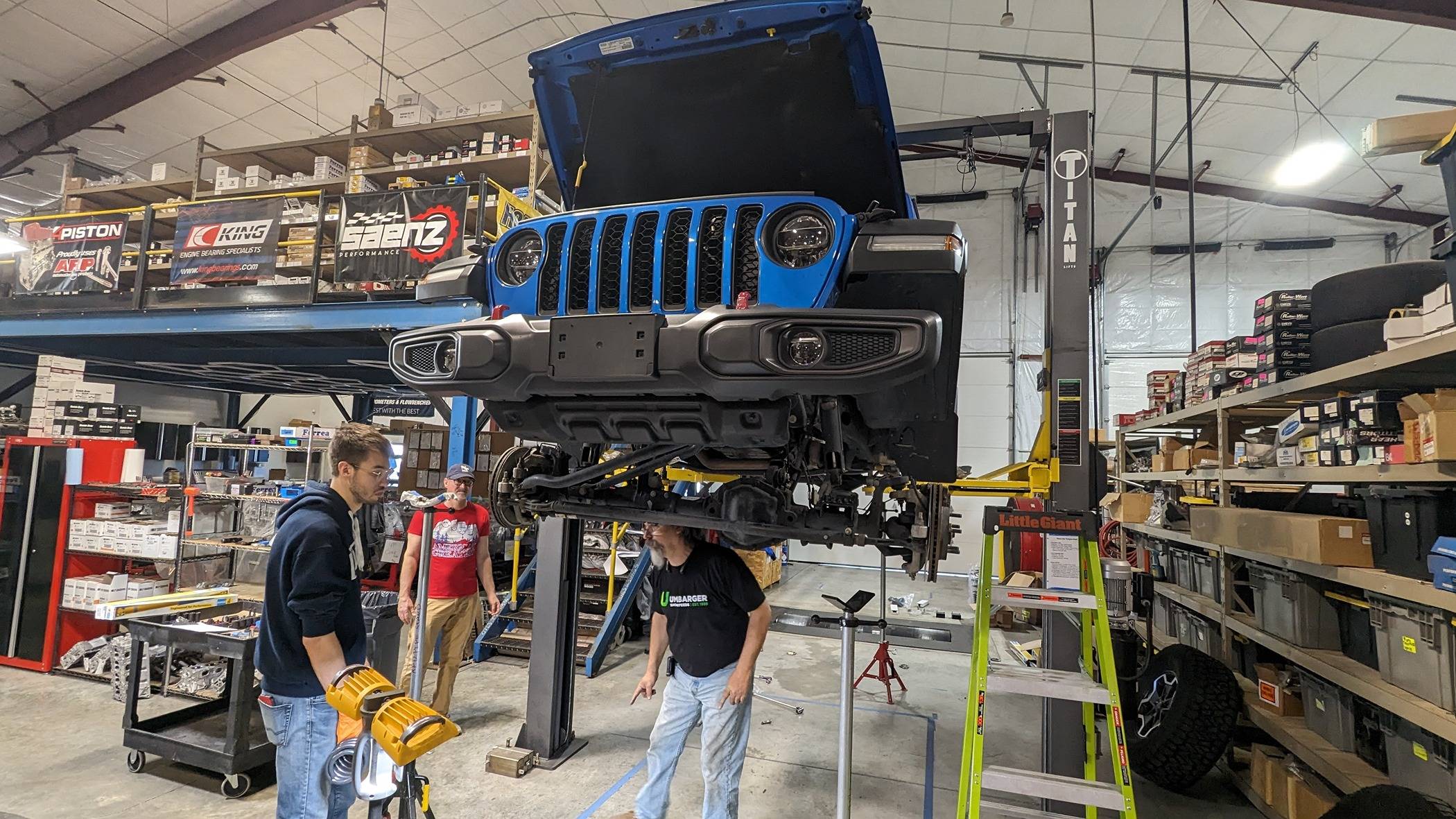

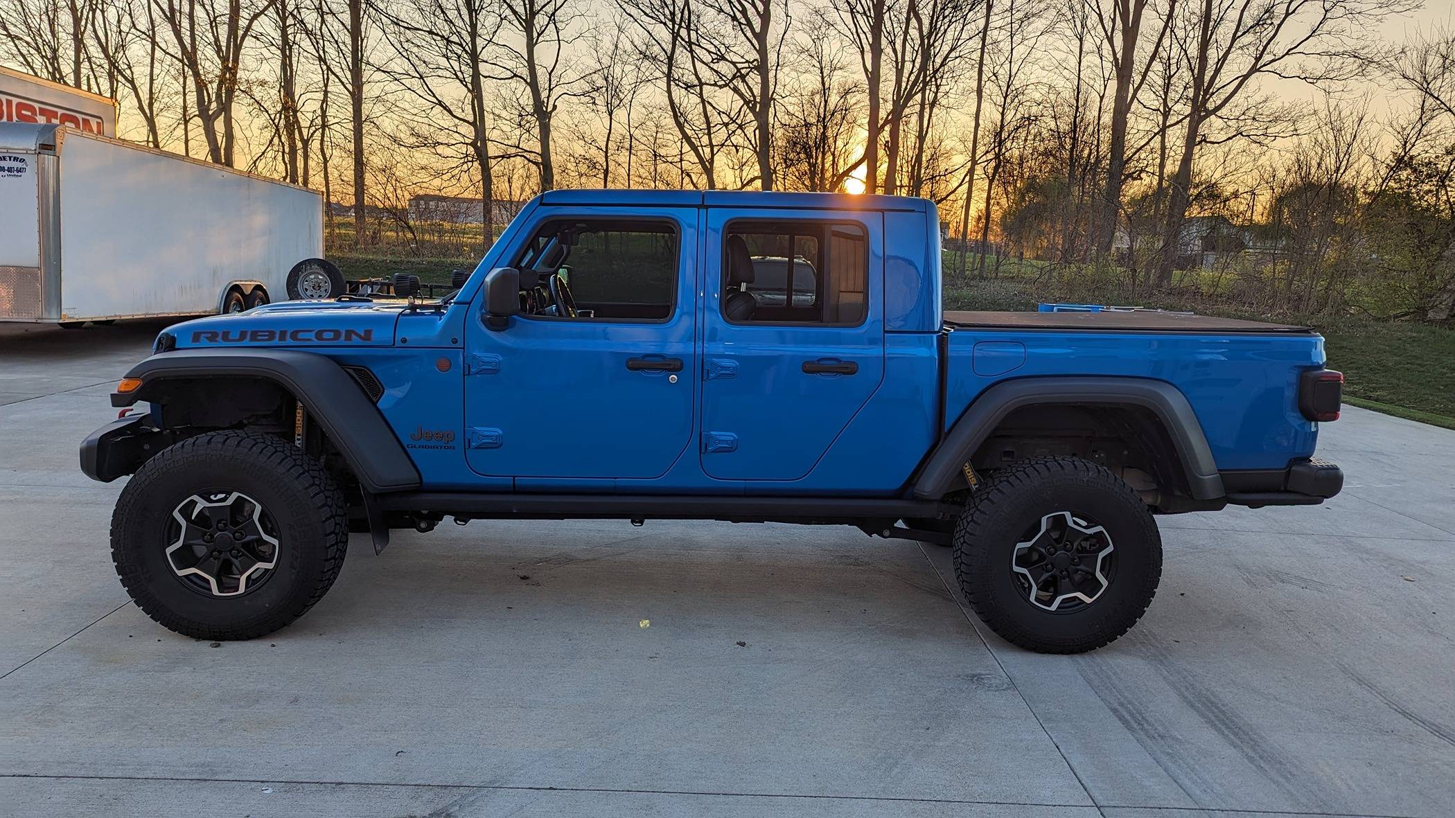

The AEV lift has been installed! It took us about 9 hours, with a lift. We did not rush anything and really took our time to do it right and it is perfect. It drives beautifully with no shimmy or wobble of any kind. It tracks true and feels perfect. I did install the lower control arm relocation brackets and I think those are the key to getting the caster angle just right. I could not be happier. Of course, I have only driven it on-road, so the jury is out on off-road performance, but the AEV 2.5 Dualsport on my old JKUR performed exceptionally well off-road, so that´s what I expect. It looks like it got a significant amount of lift. Unfortunately, I forgot to measure it. But you can see from the pics. I love the stance of the truck (I do like some rake. It is a truck, for goodness sakes, and it needs that for when it gets loaded down. I hate the looks of a loaded truck with a nose high attitude.)
Anyway, I will update as I drive it more. Next up....I sent for a Rough Country adjustable front track bar. Before anyone poo poos that, I had two of them on my JK and never had an issue. The nice thing is that it can be adjusted while on the Jeep, saving me from installing and re-installing to fine tune it. On my JK, once it was set, it never moved in probably 50k miles of driving and off roading. And it is solid forged steel. VERY much stronger than stock. Never had an issue with the bushings, either. They are just like OEM.
Here are some pics... Break over angle issue.....SOLVED! LOL.
Big thanks to my nephew and 4Piston Racing for letting us use his lift and tools at their factory! Maybe down the road I will put one of their 1100 horsepower Honda 4 cylnder turbo set-ups in this Jeep! Lol!

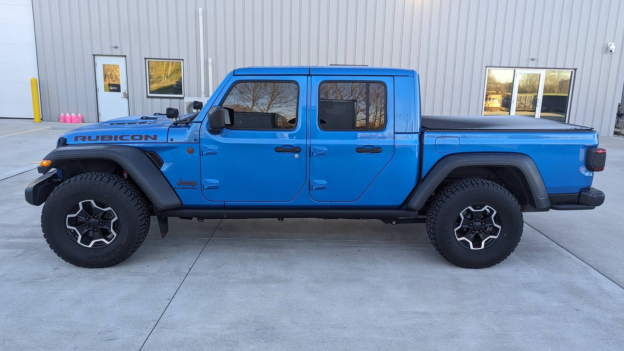

Before.....

After......
