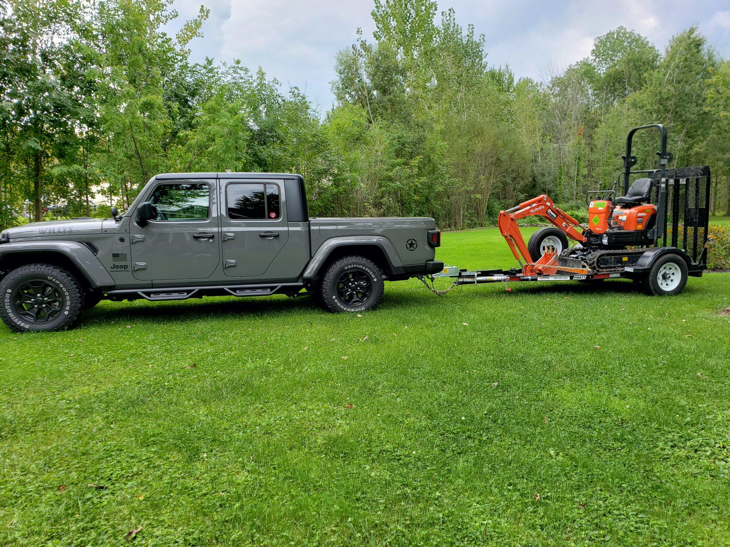

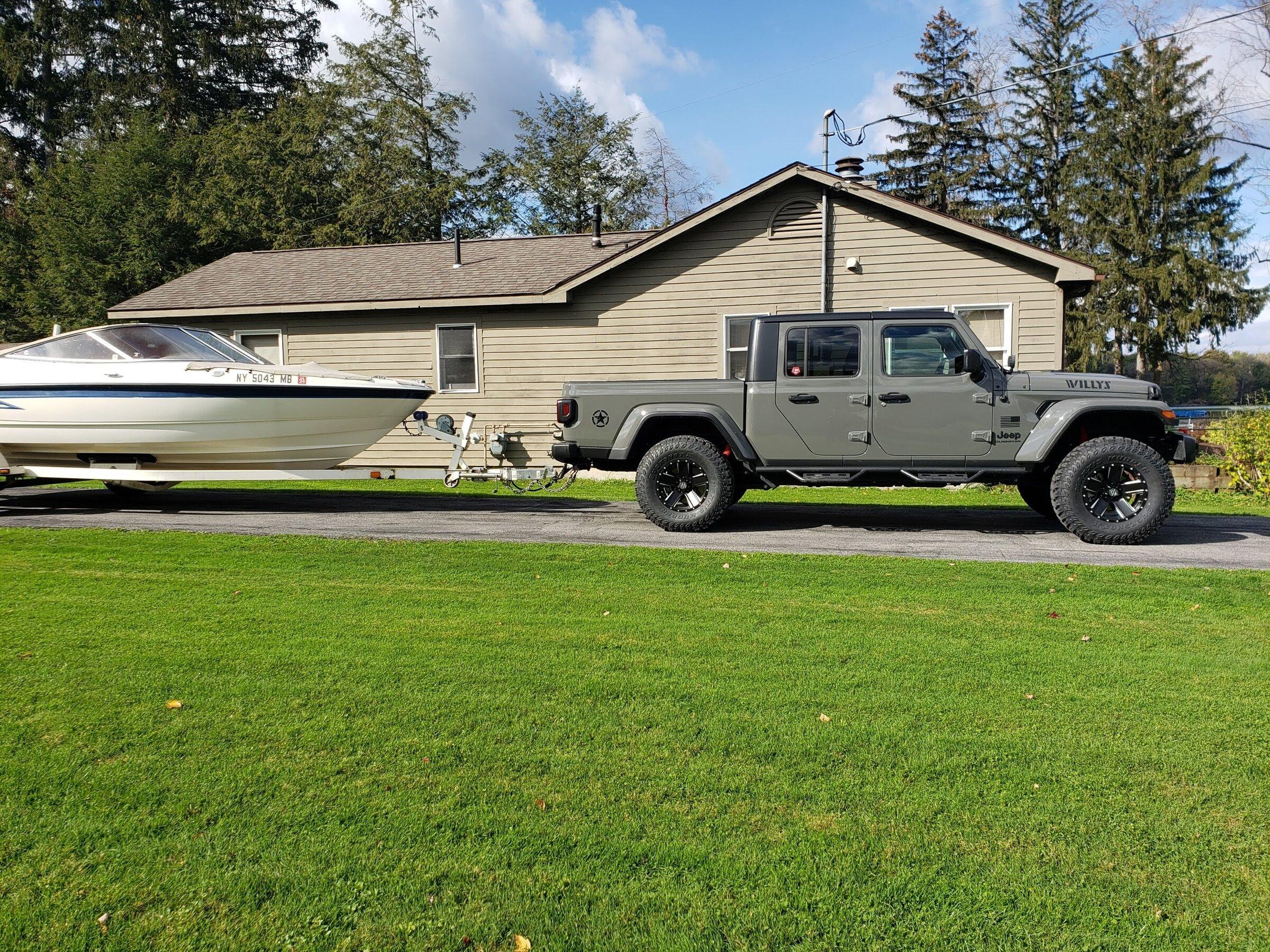

I agree with what others have already stated, get what you need for your intended purpose. And the snobs out there. Its firmer than stock Willys, which I hoped for! I dont rock crawl, I just light off road. I dont like stock, on anything! I like to personalize my stuff, this kit works great for me. Yes you lose the factory rake, so plan on 3/4" rear spacer. Or if you gotta winch & heavy bumper in front that'll possibly help. The front springs were a lot stiffer than the rears. So I expected the rear to sag a little when towing. The spacers or bags or both will fix that. Prior to my lift my JT also squatted when towing. I only use a 2.5" drop hitch because of the weight being towed I already know that its gonna sag. First pic is stock towing the smallest mini excavator that I find for some yard work. Second pic is our 21' boat w/about 1/2 tank fuel.
