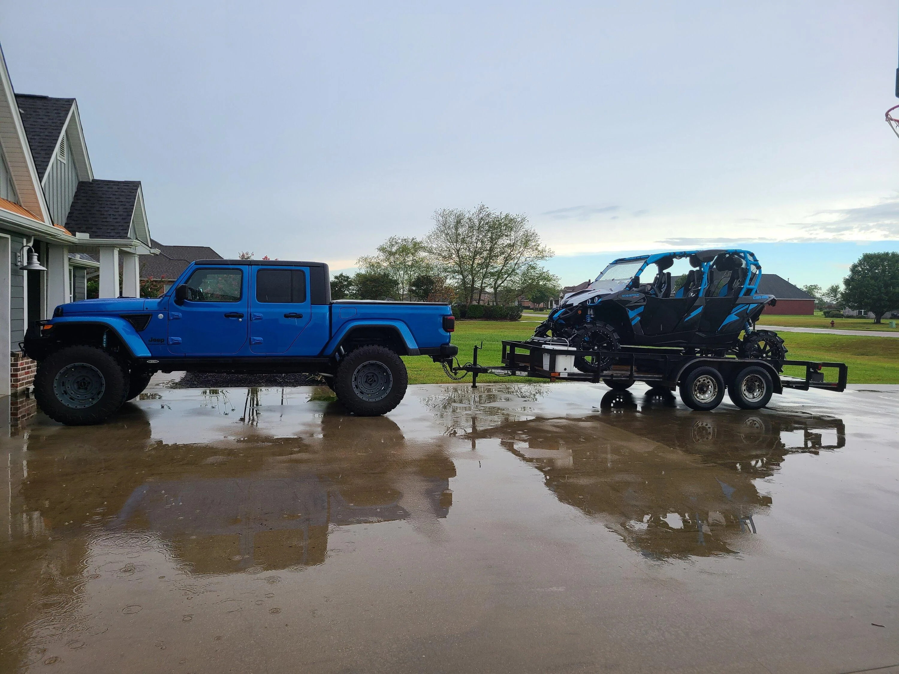

Overall it was a solid lift. It was a pretty smooth ride until i added the .75" spacers in the front. The rear springs did not do very well under load and the bed sagged pretty severely.

Towing or bed loaded down with cargo? That's good to know. I'll be towing a small trailer (1200 lb) occasionally. Unfortunately, no one seems to know what the stock spring rates are, so I have nothing to compare aftermarket springs to.

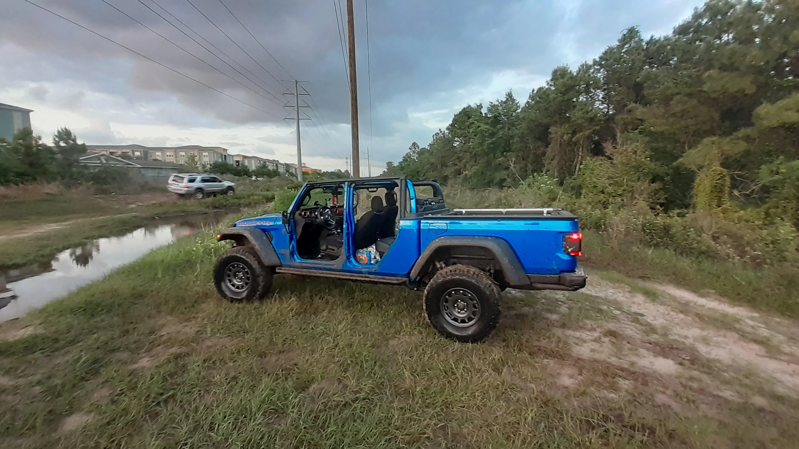

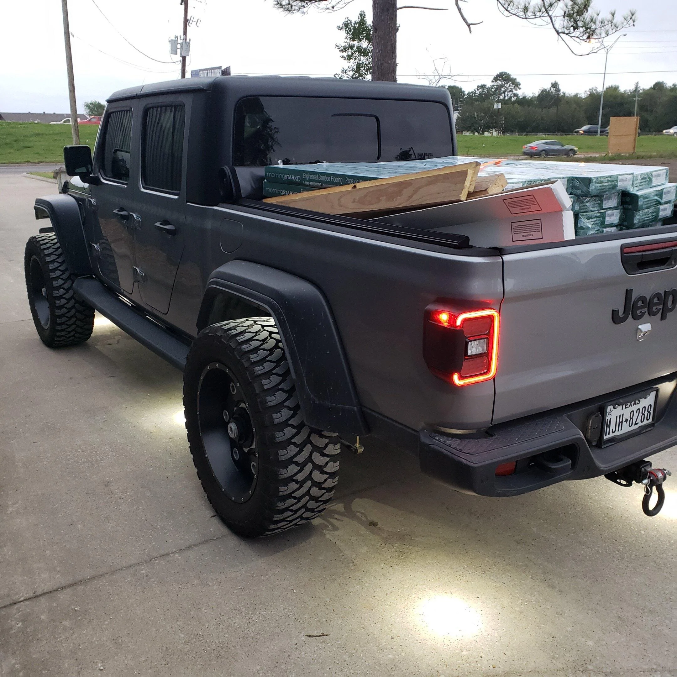

The 1st pic was loaded at max payload.
Jeep Gladiator Which lift kit? SJ or RC? 20191029_173559
Jeep Gladiator Which lift kit? SJ or RC? 20200604_190919

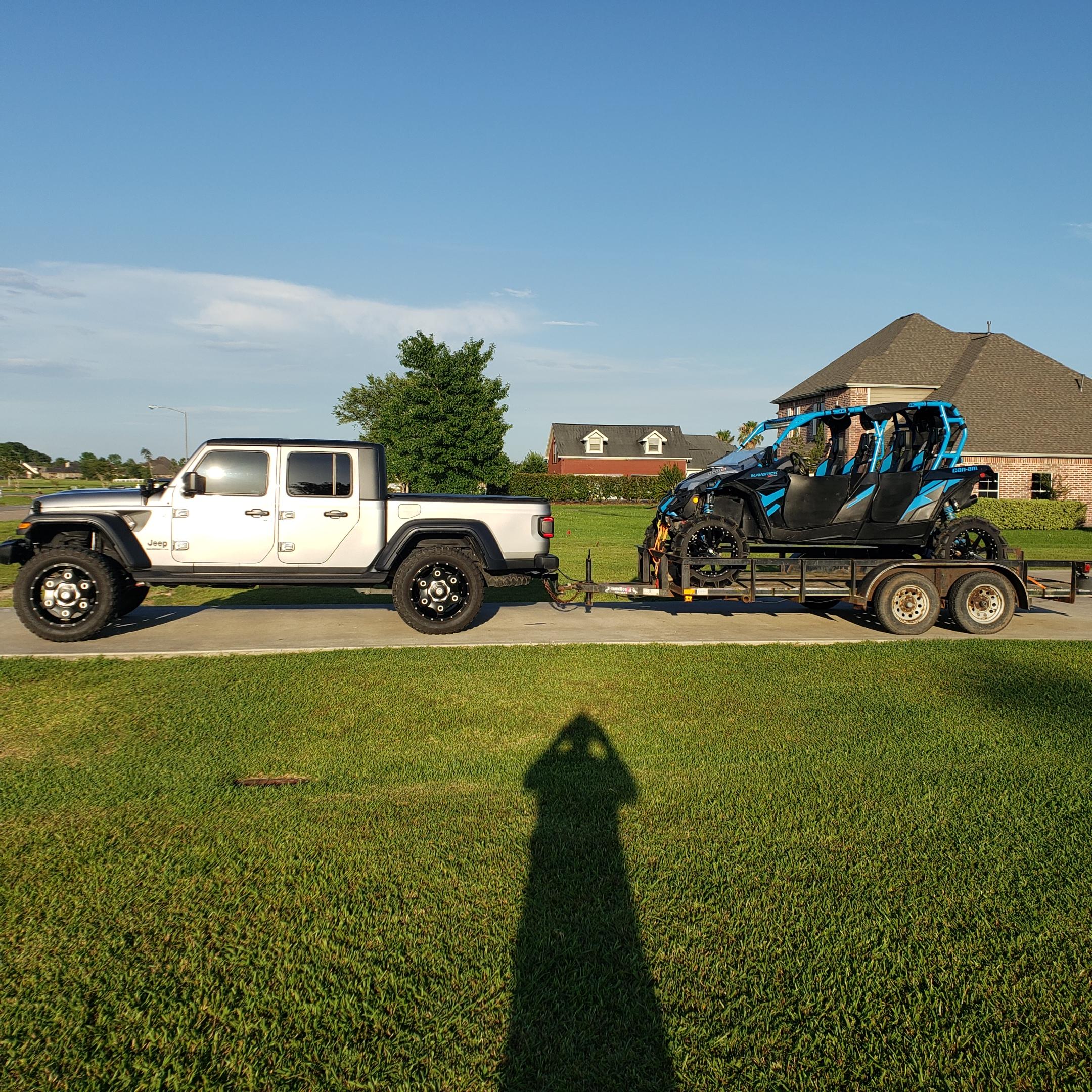

I have a diesel too but I wanted the dynamic action of overloaded gas engine coil springs, and left the adjustment/ stiffening factor to heavy duty adjustable Falcon shocks and in this case I'm very happy with my Skyjacker lift.
Pic shows front 3.5" springs and back is 2" springs w ¾" Daystar spacers. Quite a bit of rake (which I like) for just a ¾" difference.
Jeep Gladiator Which lift kit? SJ or RC? 20220423_195201

My gladiator is my work truck and during the week it has approx 300-400lbs in the bed and rides about 1½" high in back.
