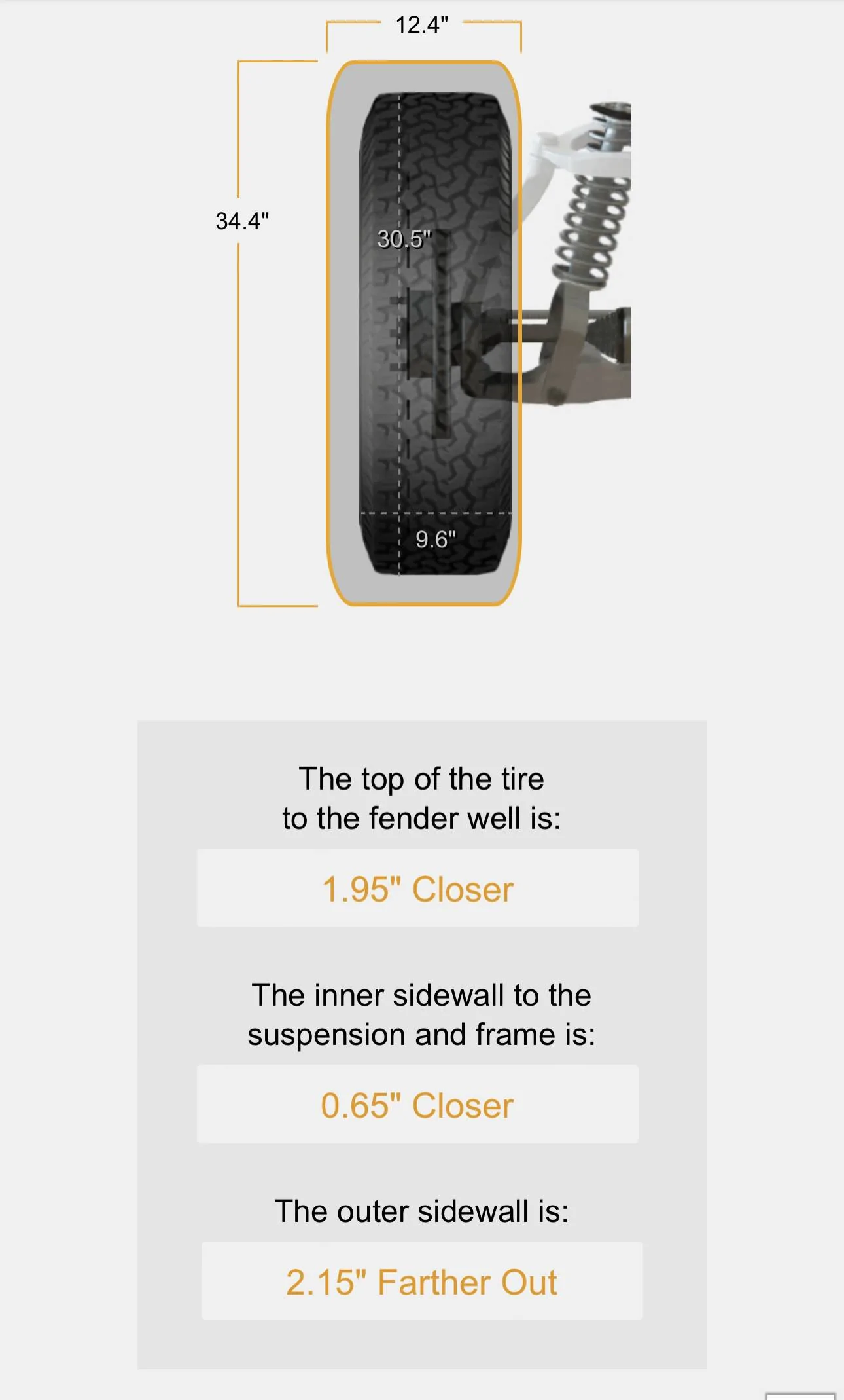

Lift install is $577 plus tax. That includes alignment, QC check and if it’s not in factory spec they make adjustments until it’s right. I know everybody has a certain look they are going for, but I personally don’t like my tire sticking out past my fenders much (had that on 2012 JK). My whole concern was weight added in to rolling mass. So I went with 51lbs tire and and 34lbs wheel. Here is how my wheel setup compares to factory wheel.
Jeep Gladiator Which lift kit do I buy? IMG_0419
