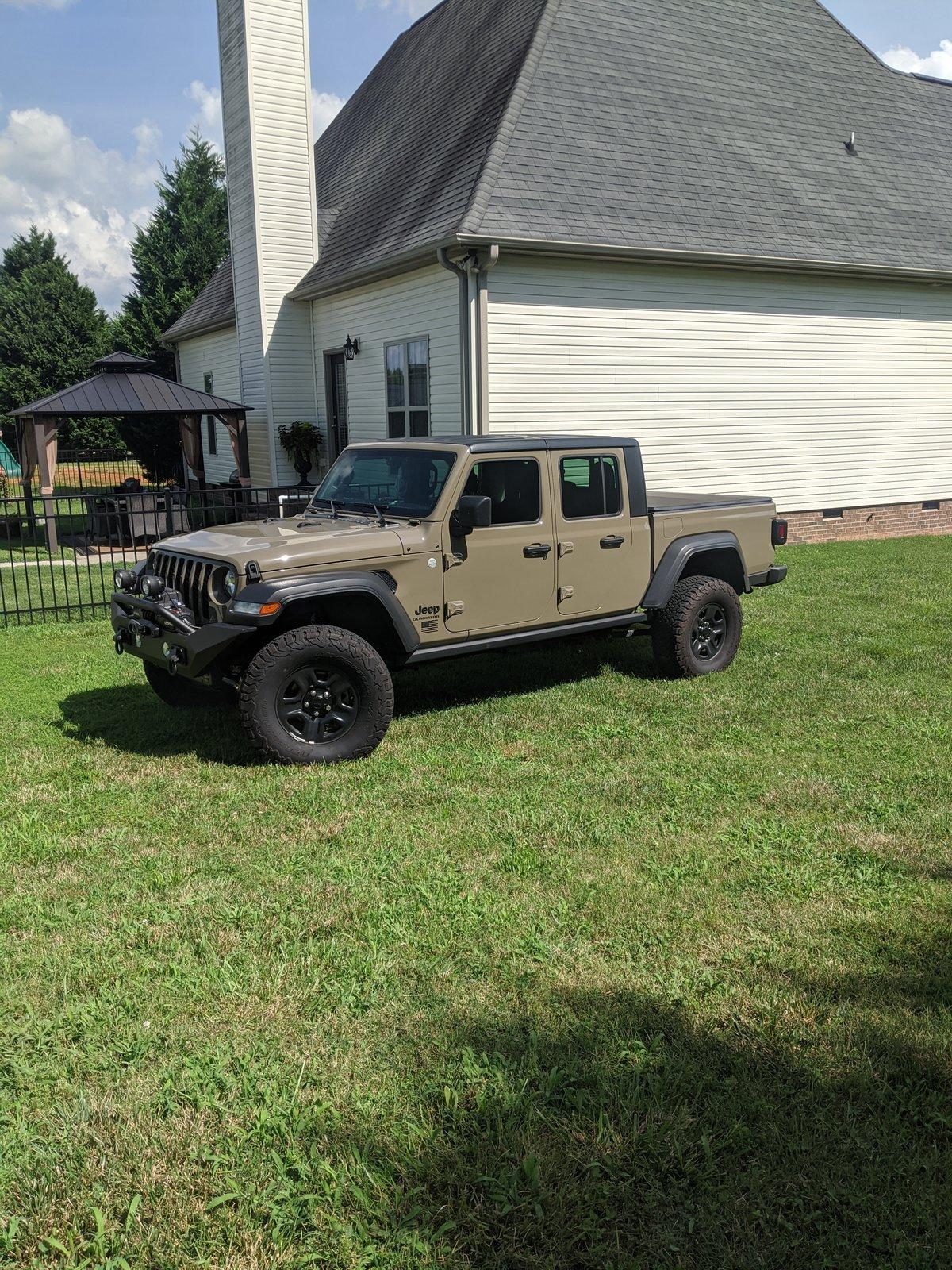

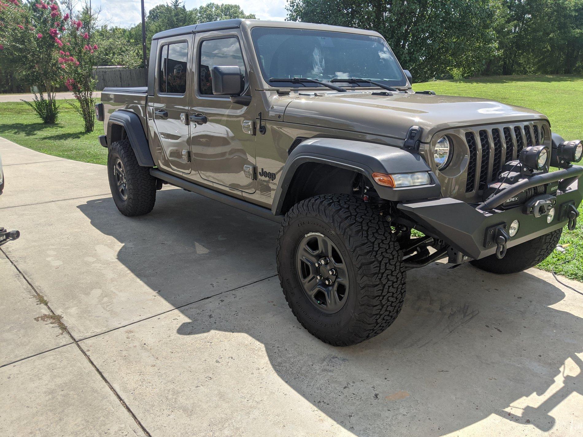

I'm no expert but I only spent a total of $1000 installed on my lift and mine rides better than it did stock. Rubicon take off front springs with 2.5" ReadyLift SST spacers front and rear and Rubicon take off Fox shocks. I could probably go 90% of anywhere I need to go off road if I wanted to. It's more about the know how than the height or price of your lift when off roading. Just my opinion on it. Unless your doing some extreme competition wheeling I wouldn't spend more than $3,000 total on a lift and tires.

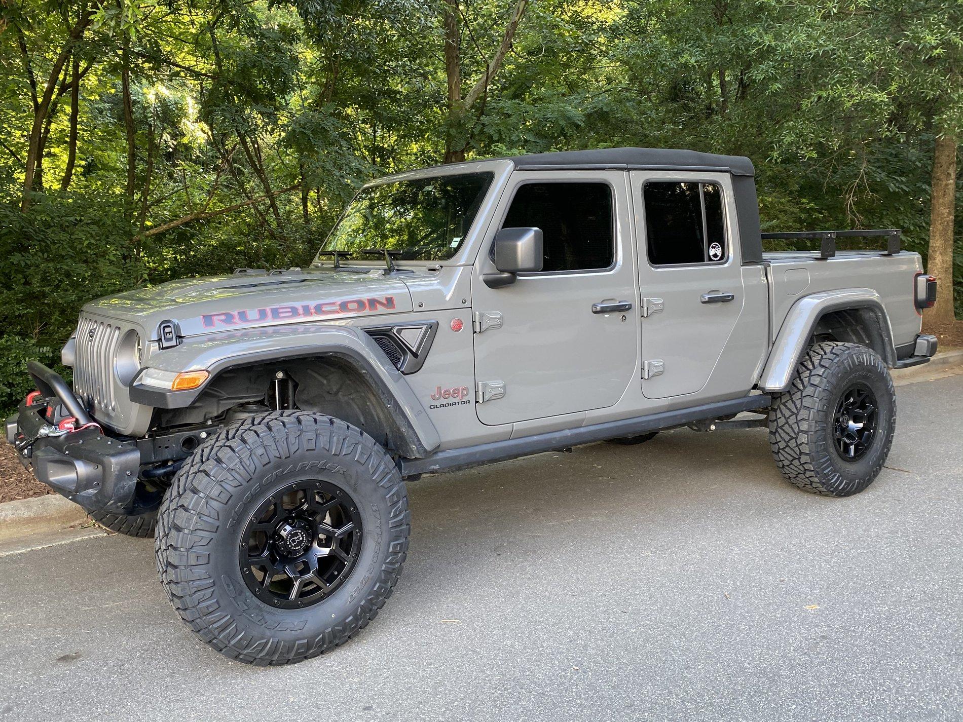

I’m running 3.5“ front and 2” rear coils with 37’s and love the improved look over stock. I ran 35’s on a stock setup for a few months as well and the new setup is just as smooth. The taller coils in the front makes up for the factory rake, seeing as a lot of people are still adding leveling kits to the mopar 2” lift. Stock I hit every possible bump on the trails. After a minimal lift and bigger tires it was a game changer. I think all-in, I’m somewhere in the ballpark of $4.5k with JCR sliders pending.

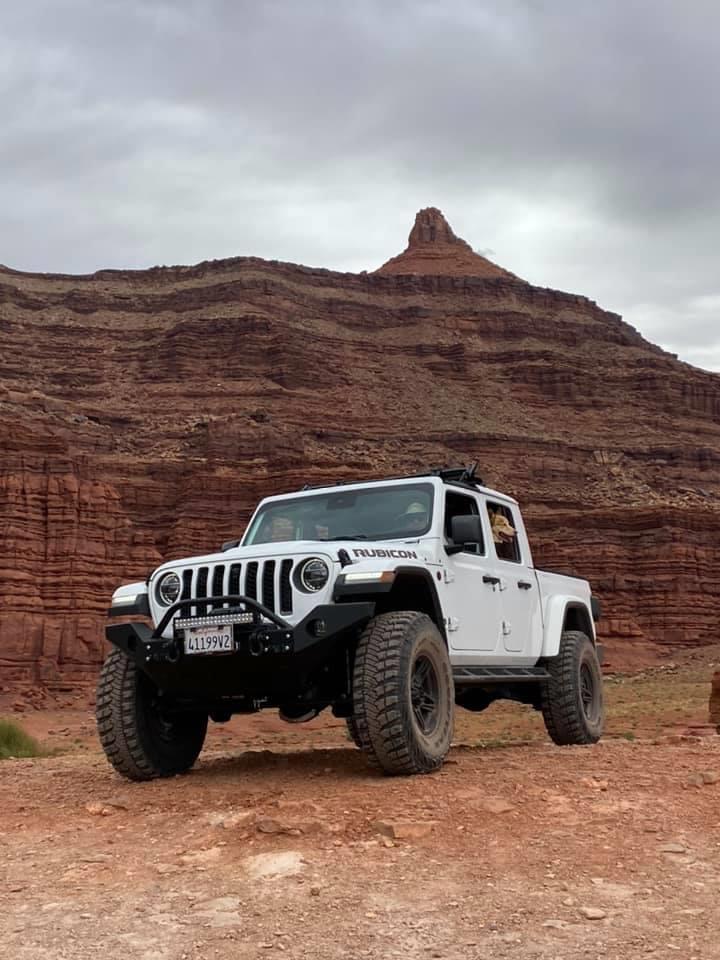

Being I keep my jeeps a long time I went all in with a 2.5 inch Clayton offroad, Falcon 3.3 shocks and misc. Tires and wheels alone are $3,000. Honestly this thing drive great. Stock on rutted roads couldn't go more than 5 mpr. Now 25 mpr and I feel like its a smooth road. We spend a lot of time in Moab, Big Bear and other off road ares.
Daily driver and I experience now no highway wobble.
Really comes down to you pocket book and what you really are going to use your jeep for. For me its all about the adventure.

Stock gearing. No issues at all on or off road. Might take the plunge later but for now I didn’t notice a huge difference. I went to 35’s immediately and then to 37’s a little later so it was a gradual change.
