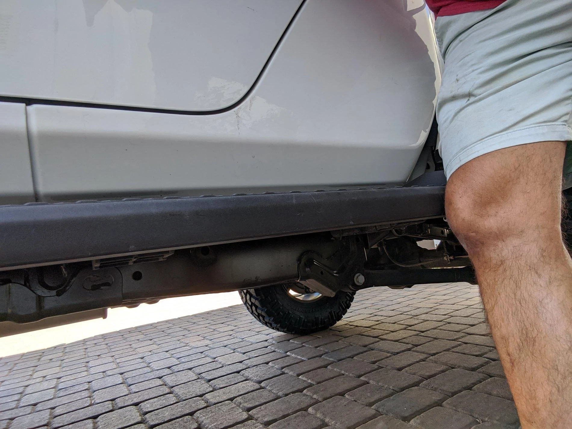

This is 2.5" Clayton lift (more like 3.5+) and 35s next to a 6'2" person. Running boards at my knee now.
I felt this way when I dropped my truck off the jack stands after installing the 3.5". I stood next to it and thought.Whoa, glad I installed the Rock Slide Engineering steps already.
Request for anyone with a stock Rubicon... Can you measure the height of the top of the bed rail? I was too giddy and excited to get the install started that I forgot to take before measurements.

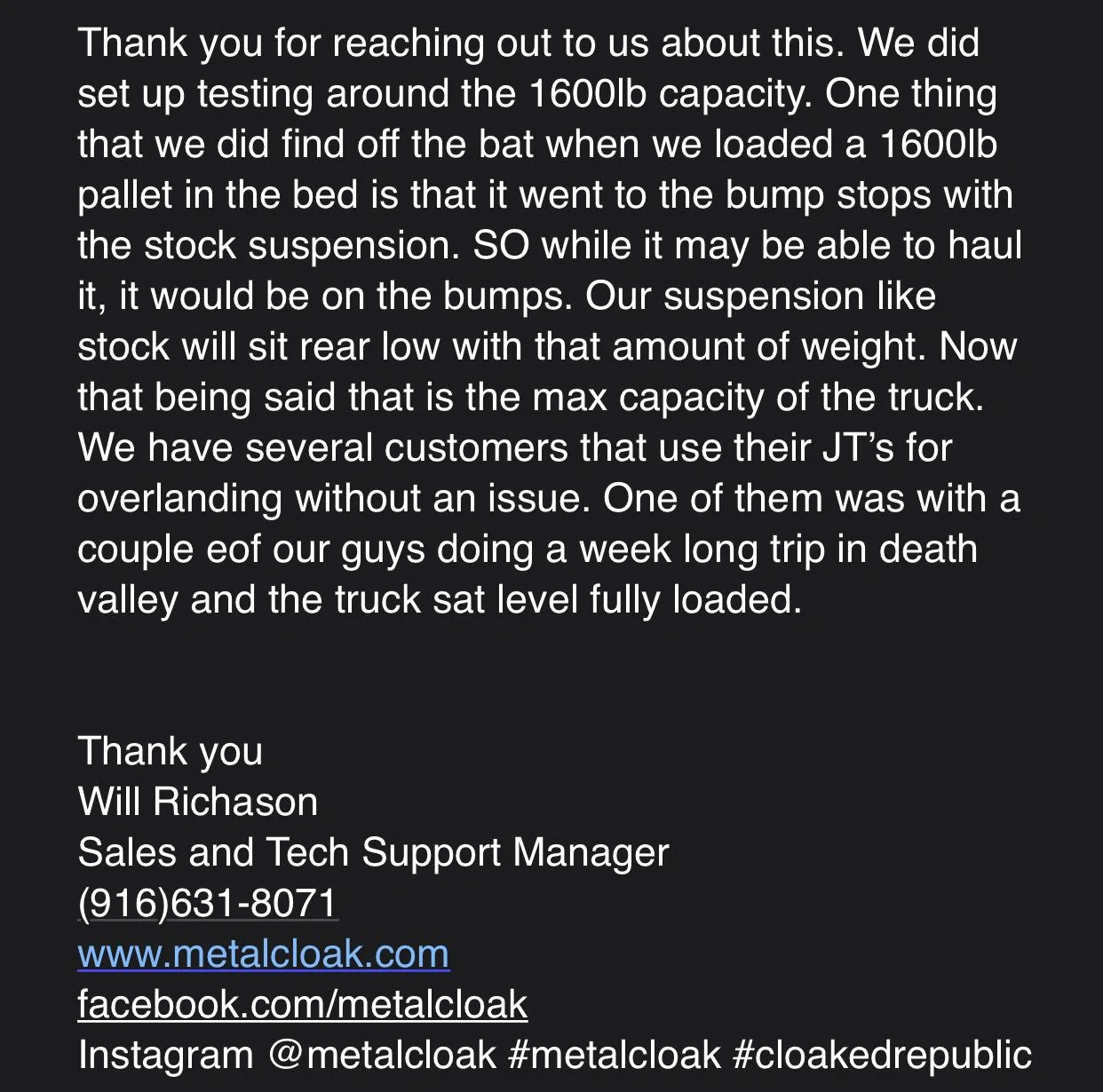

Are your guys' lifts maintaining payload rates? My biggest hesitation (after price) for a lift on my JT is losing the 1550lbs payload and accompanying tow rating from the rear progressive springs that are a big reason for Jeep's payload rating with the Sport Max Tow package
Also, Metalcloak seems to recommend a driveshaft for a 3.5" lift due to the degree of changed geometry (pun intended), what are your thoughts?
Is progressive the same as "triple rate"?
Yes Progressive rate springs are just any multi rate spring, so could mean dual rate or triple rate. In the case of our JT rear coil springs they are a triple rate design :like:
First I am hearing of "Progressive rate springs are just any multi rate spring". I seem to recall Jeep specifically distinguishing their Rubicon dual-rate springs from the Sport Max Tow Progressive rate springs. Both have different product numbers and different looks.
What about the driveshaft? Do you offer one to go with your kits? I'm leaning towards you guys given the extra weight/thickness of your parts. Did you test your kits with payloads? Metalcloak said they put 1600lbs in the bed and drove it, though it was riding on the bumpstops. Will look through emails to post screencap shortly
As for the spring rate question, it gets confusing, generally multi rate coil springs are referred to as progressive rate coil springs, but really a true progressive rate coil spring gradually changes the rate through the spring, and a dual or triple rate coil spring actually just suddenly has the rates change on the coil. I know that this sounds confusing, but that's why generally they are referred to as progressive or multi rate springs because its one of those things that sort of lost its meaning over time. True progressive rate springs are not very common either.
We do utilize a much higher spring rate than most other manufacturers, and therefor our kits are able to handle a really good amount of weight. We have some guys who have 4 to 500 lbs of weight on or in the bed and the truck sits level loaded up, while some others in the 7 to 900 lbs range throw in a small spacer in order keep some rake in their overlanding builds.
Replacing the front driveshaft is always recommended, but is only absolutely necessary if you plan on wheeling and flexing the vehicle out a lot. Other than that you would be able to get away with the factory unit for a while without issue.
Hope this helps.
It does, thank you. Do you offer a driveshaft, as I wheel fairly regularly

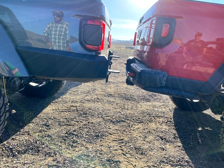

This is not the best picture, but the Gray JT on the left has MetalCloak 3.5" rear coils and 37's. The Red JT on the right has the Clayton 2.5" rear coils & 35's. Look at how much higher the tail lights on the red one are. The Clayton coils are taller & stiffer. I haven't had mine (the red one) squat yet. I haven't had a ton of weight in the back yet, but the factory coils (Max Tow) I had showing some sag with just tires/wheels in the back. To do over again the only thing I would of done different with my lift is I would of probably gotten the 3.5" (the gray one has had its rear coils changed out to the Clayton 3.5" since this picture was taken & it looks really good).
