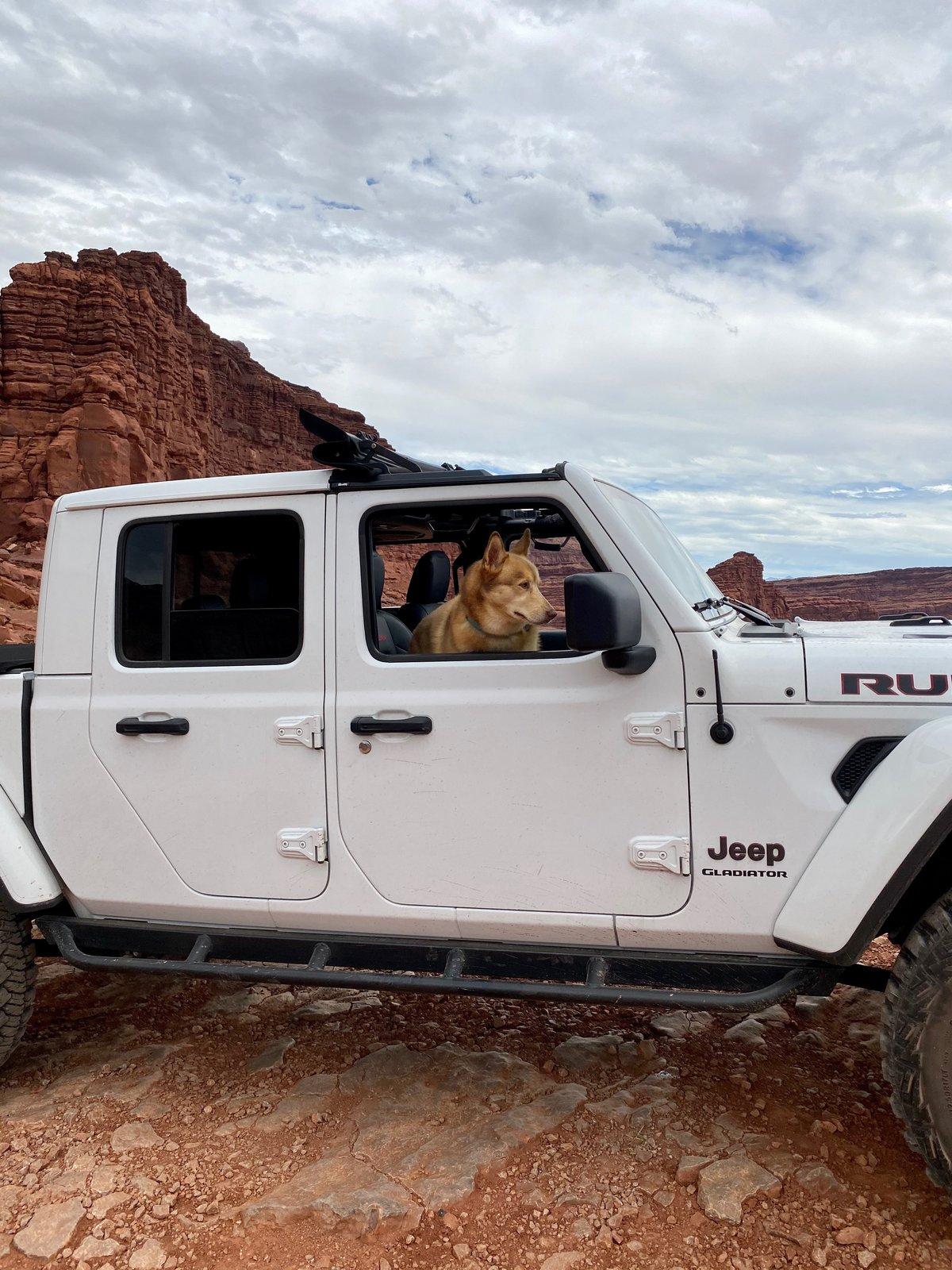

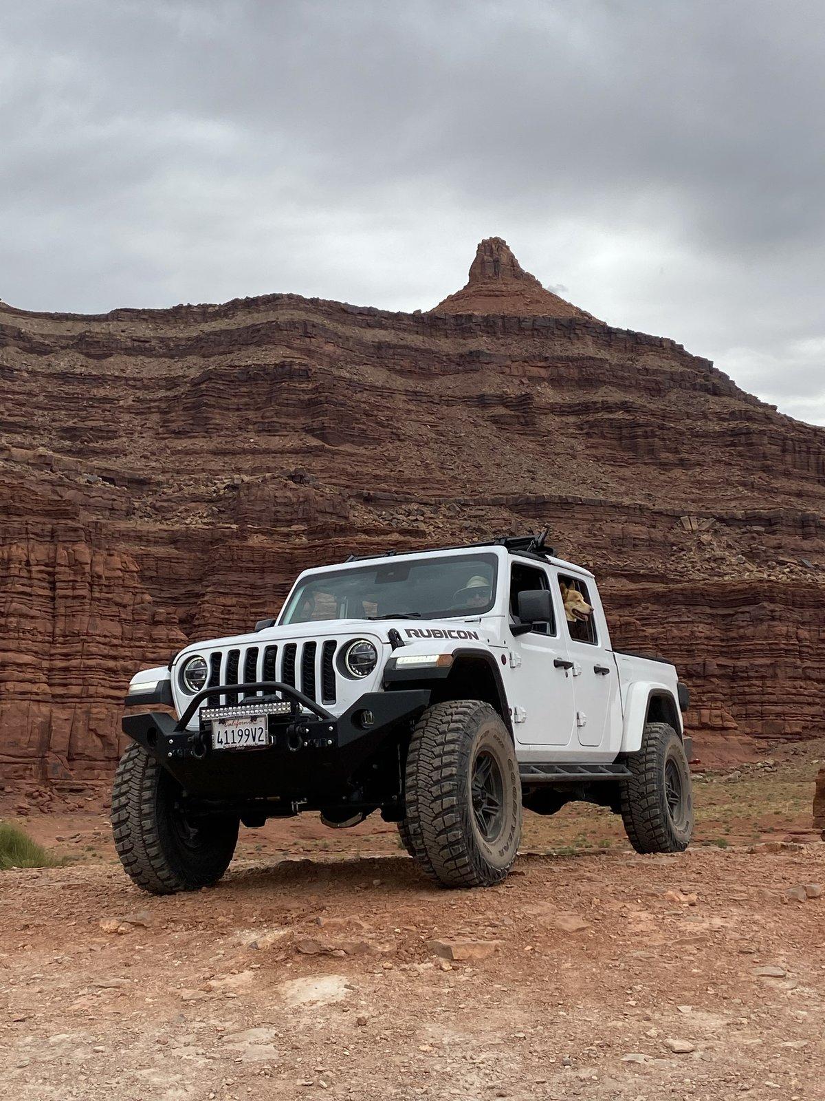

Finally made it to Moab. My wife is the toughest critic and loves our lift, shocks and 37 inch tires. did I say she loves our Clayton off-road lift with flacon shocks 3.3. We did hard trails and over 50 miles of crappy dirt roads. All I can say is smooth and controlled. Even our husky loves it.

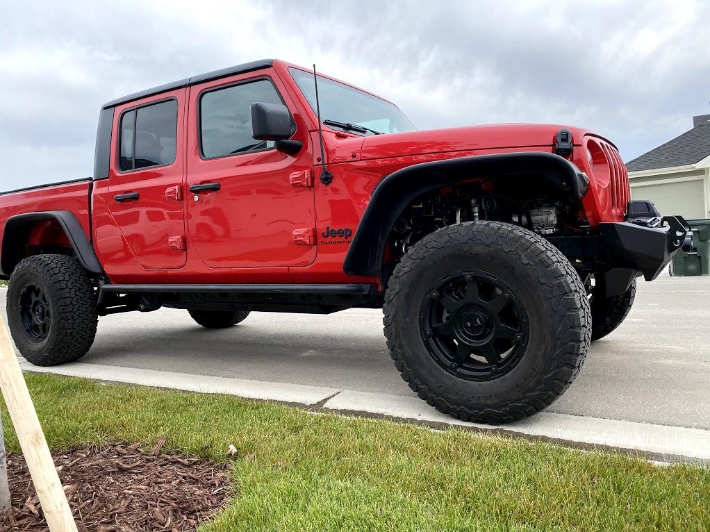

Yes I did... And its way higher then I was expecting. I am not at all complaining, but as @j.o.y.ride said in his its way higher then the advertised 2.5". I didnt get measurements, but I believe I got 2" extra at the front end & it was already up 1.5" . I havent been out to flex it yet, but the on road ride feels much better. Part of that is the steering which the synergy sector shaft brace seems to of resolved the rest of my complaints with part.
So far I am more then completely satisfied with what was done. If I have to nitpick anything though it would simply be that the retaining braces for the JKS quicker disconnects are almost certainly going to be in the way of the ACE inner fenders I have sitting in my garage. Thats not a big deal though I will just pull the braces & ziptie the swaybars out of the way when I have them disc.
I have only taken one pic so far.
Jeep Gladiator Which Lift Kit to Pick From IMG_0733

35's? That looks great! Congrats on your purchase and results.

I measured a solid 3-4" on every corner from the 2.5" lift. @Clayton Off Road said it's for some settling and adding components and gear and still having the 2.5" clearance. Which is WAY more honest an approach than 2.5" being maybe 2" in reality and then settles and loads to 1.5" like some other options.
You absolutely get your money's worth and more with the Clayton stuff. And they refuse to sell a kit without a trackbar like some other even notable brands do.
Yeah 35's (well technically 315/70r17 on 0 offset wheels).
It really does look fantastic. Not trying to toot my own horn... but I am anyway.
