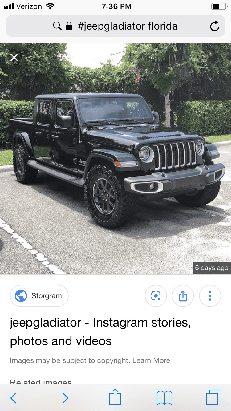

There's a guy that put 35" bridgestone KO2 on his overland 18s.
I'm cheap, I plan on getting 295/70/18 Falken Widepeaks when Discount Tire does its labor day sale. They are supposed to measure 34.3, vs 34.5 of 35" KO2

I’ve personally seen Toyo AT 35/12.5 on stock overland wheels. It looks great, but I’m planning 285/75r18 which is 11” width and 34.8” measured fully inflated.

Thanks for the input guys. So a 285 will fit on the stock overland wheels? Considering the stock is a 255 that seems like a big jump. I'm ok with the stock diameter and ground clearance, but I did think the stock tires just looked too narrow and of course the street A/S tread is a little wimpy and probably not great off road.

Some manufacturers of 285/75 (Specifically the Cooper AT3 LTX has 7.5 in its recommended tire width for that size. 295/70 works as well but it’s a wider tire and 7.5 is the minimum depending on brand. The Cooper is 7-9.5 or something which is why it’s my current choice once I get the truck
