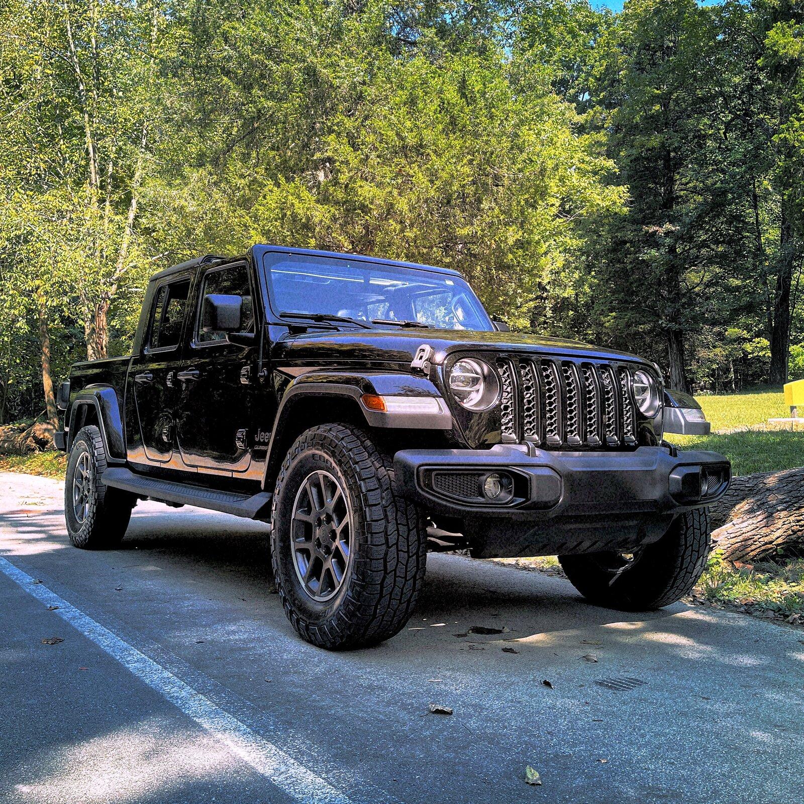

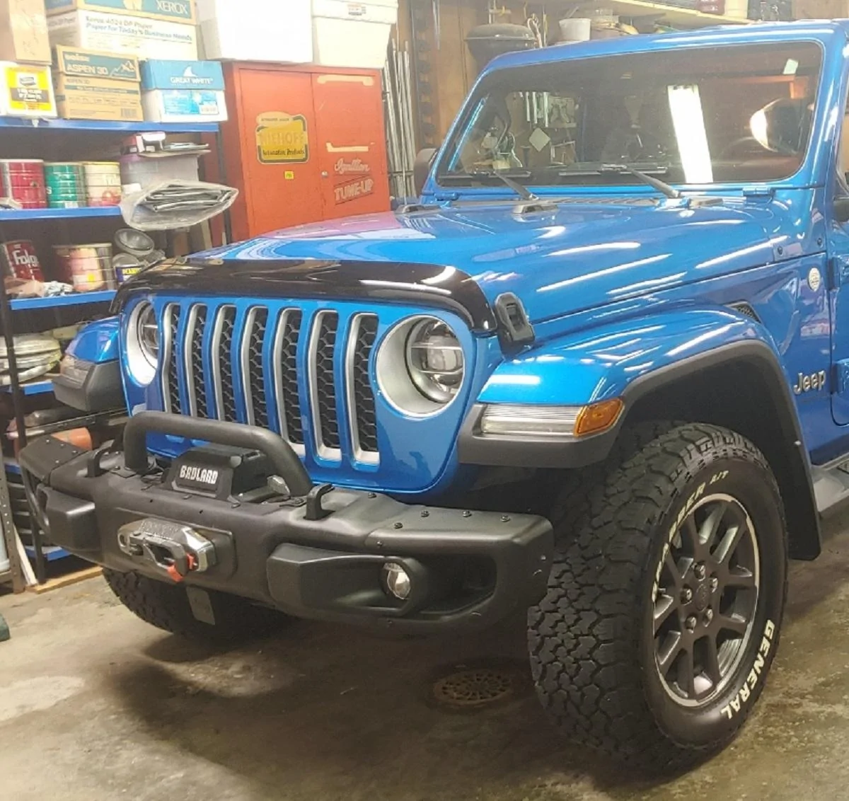

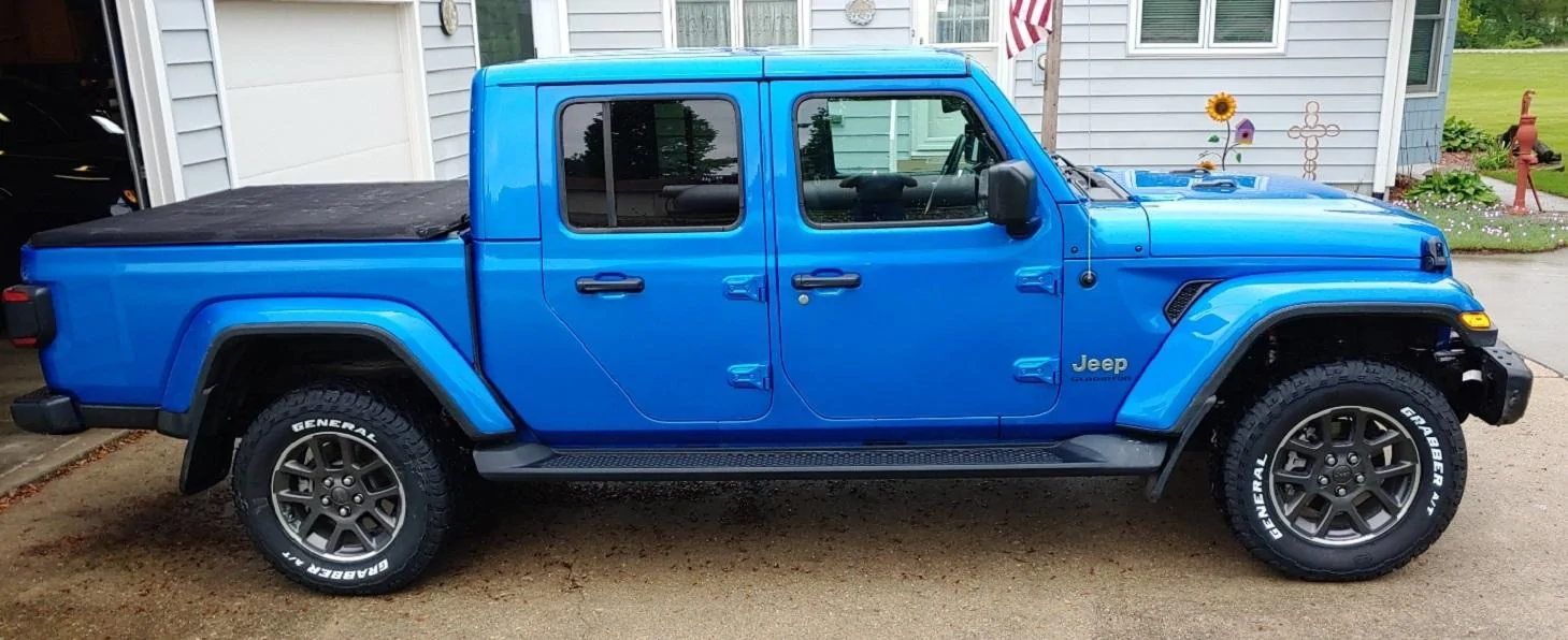

Overland, no real lift, stock wheels - General A/TX tires - Love 'em
Great in rain, very easily balanced (my neighbor bought General tires for his classic car and it took almost no weights to balance his tires)
Just an idea, option, whatever.

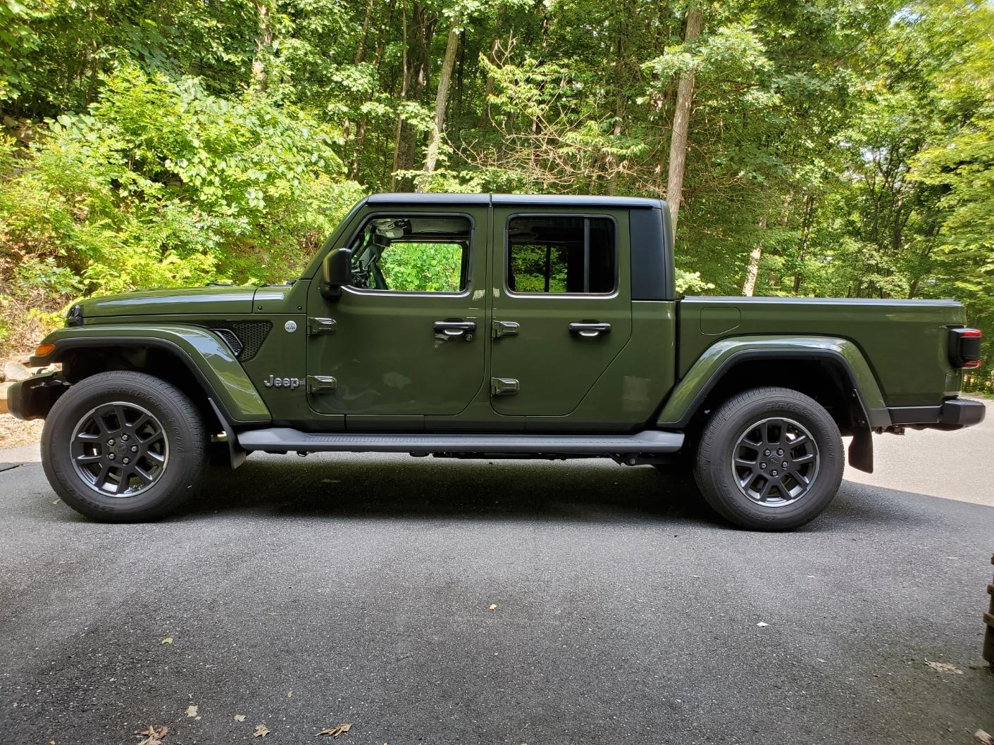

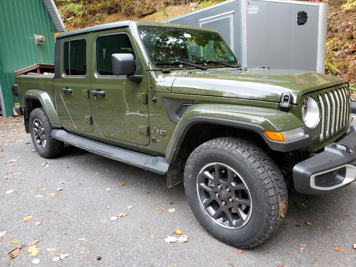

Searched a bunch before going the route I did.

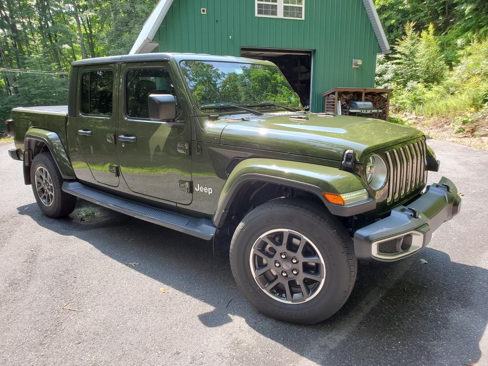

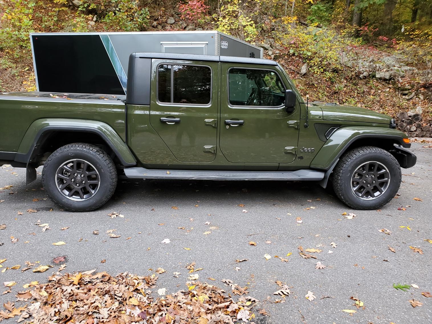

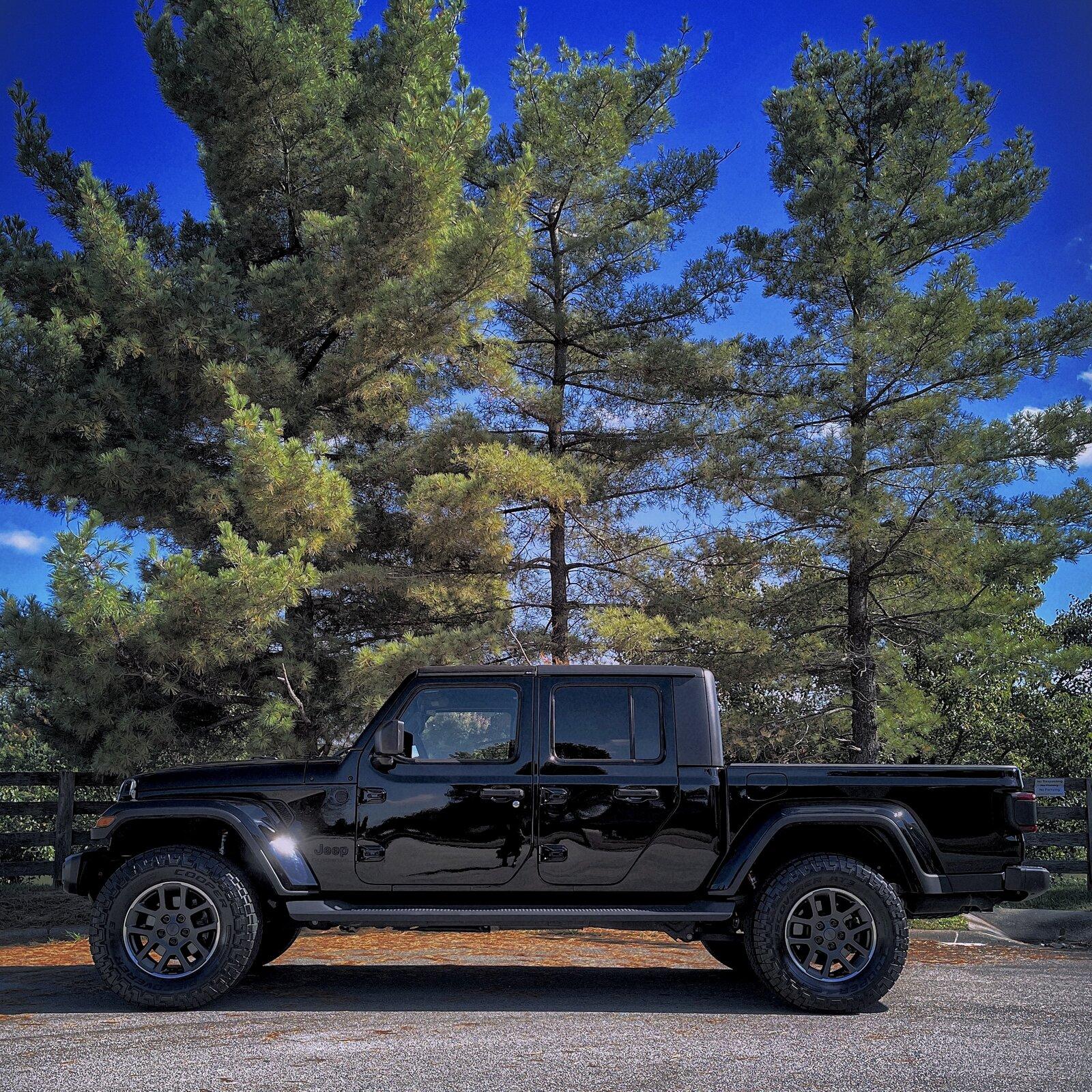

295/70/18 Cooper Discoverer AT3 XLTs on Overland wheels. Fit fine with no lift. No rubbing etc. I ended up adding rubicon take off and teraflex leveling kit. Only for aesthetic purposes only.
First pic is before and after with total stock suspension only adding the tires. Second is after adding the rubicon suspension. Third is adding the leveling kit. Again going with 295/70/18s you’ll be fine. Or even 285/75/18s which are a tad bit taller but narrower. I split the difference and chose the 295s and am happy. I’m primarily a city driver and the Coopers are amazing and super quiet. Yet can still handle an off road situation.

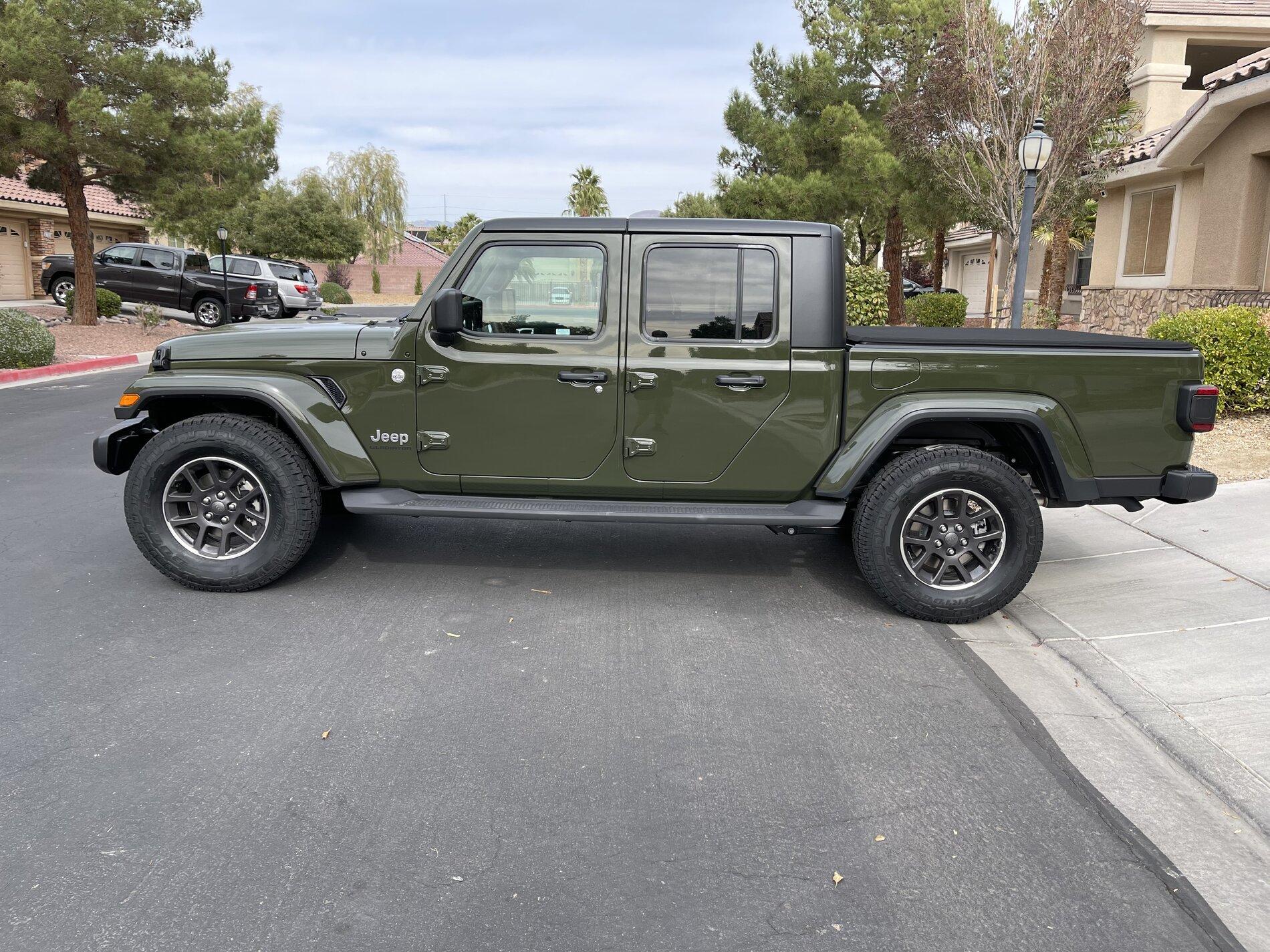

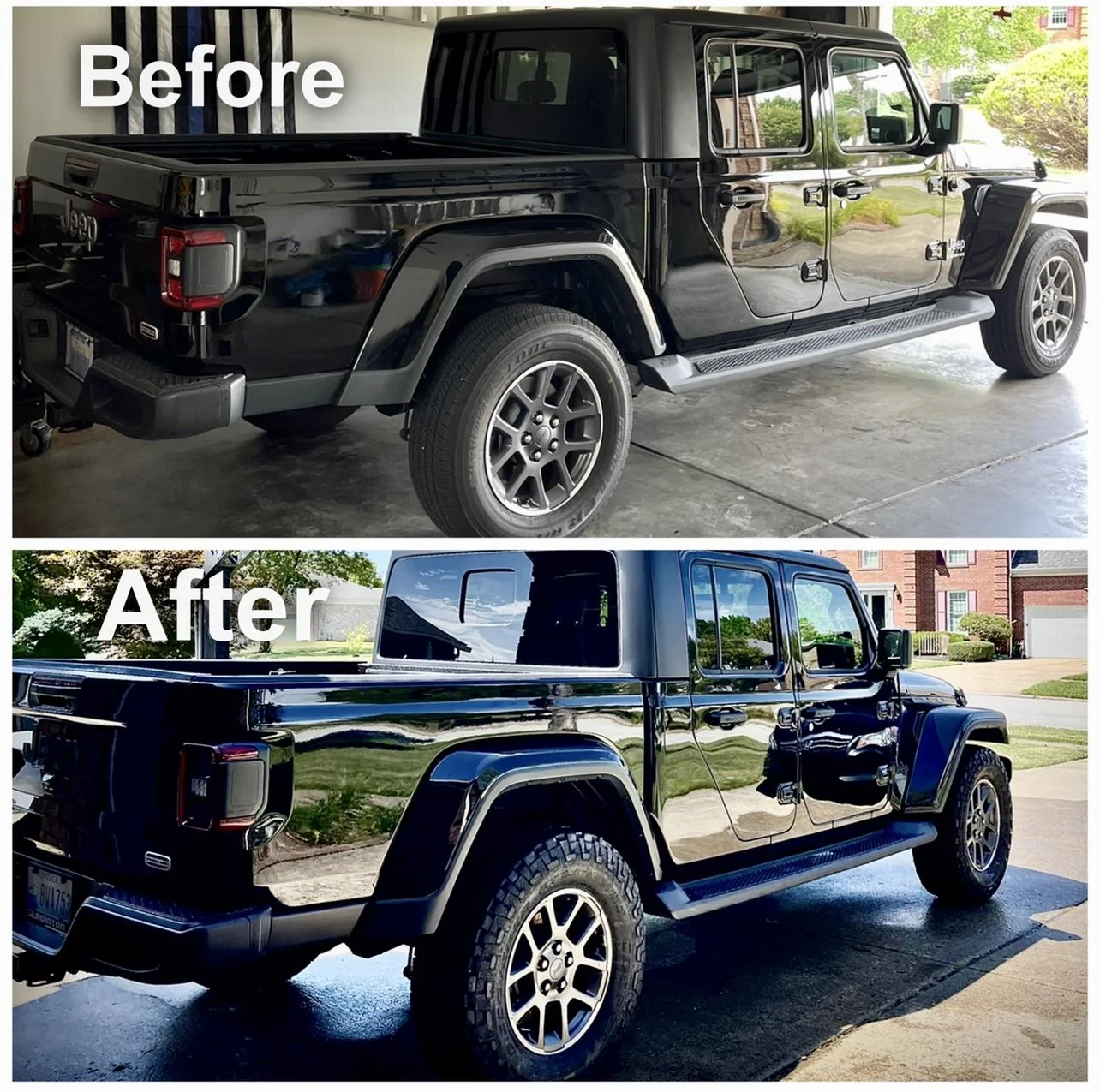

I went with Cooper Discoverer AT3 4S. Not super aggressive but good road manners. I have extra rims so I use these in the winter and the stock Bridgestones in the summer. Same size and nearly the same weight.
Before:
Jeep Gladiator Tires for stock Overland? 20210724_144901
Jeep Gladiator Tires for stock Overland? 20210725_151348
After:
Jeep Gladiator Tires for stock Overland? 20211017_130257
Jeep Gladiator Tires for stock Overland? 20211017_130242
