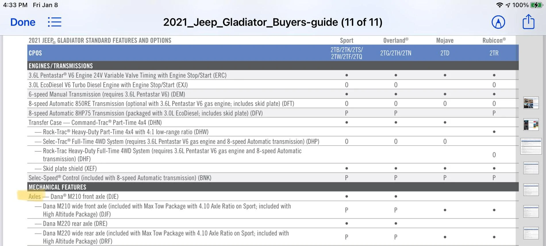

Pretty sure all Gladiators have a Jeep version of 44s, called M210 (front) and M220 (rear), according to the 2021 buyers guide. The Rubi, Mojave, Max Tow, and High Altitude have the “wide” axle versions.
Jeep Gladiator Willys gladiator ecodiesel queations DB04C767-E185-4B9C-AAD9-4B537F3135D0

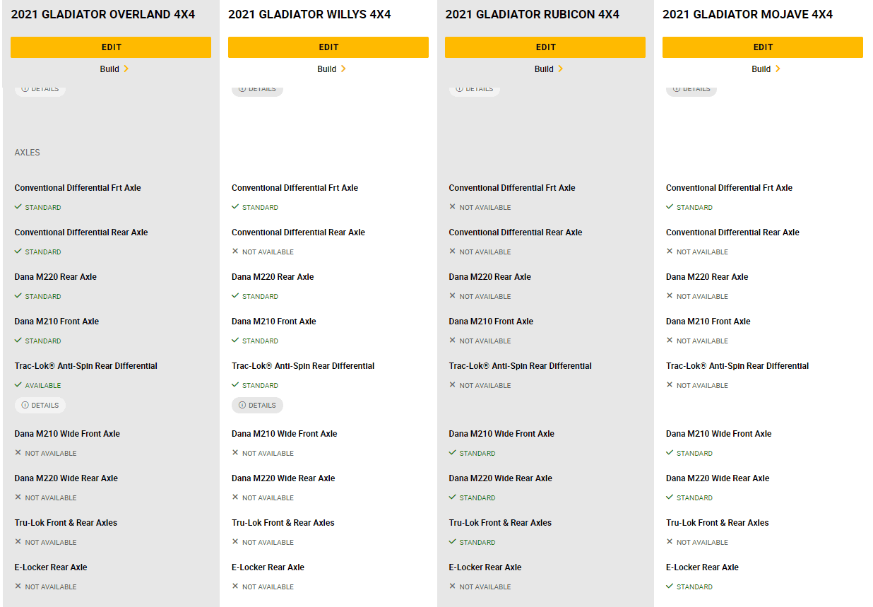

I was just comparing axles between the trims yesterday. The jeep.com site has a lot of great information. If you choose Gladiator and compare models, expand the powertrain tab and you'll find a treasure trove of information:
Jeep Gladiator Willys gladiator ecodiesel queations 1610142692823
