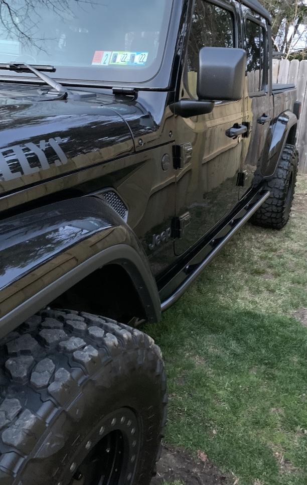

Installed Rockhard 4x4 Rock Rails that showed up today. Well, mostly installed. The absolute last bolt that I was tightening all a sudden got real loose then fell right out. Seems that the rear body mount nut let loose but that’s a battle for another day.

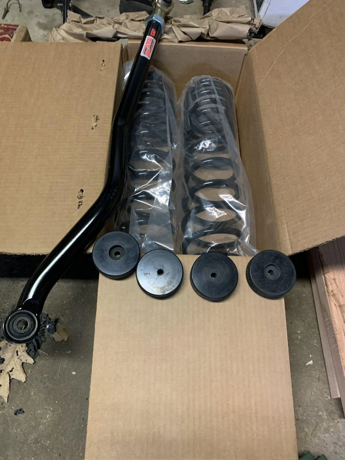

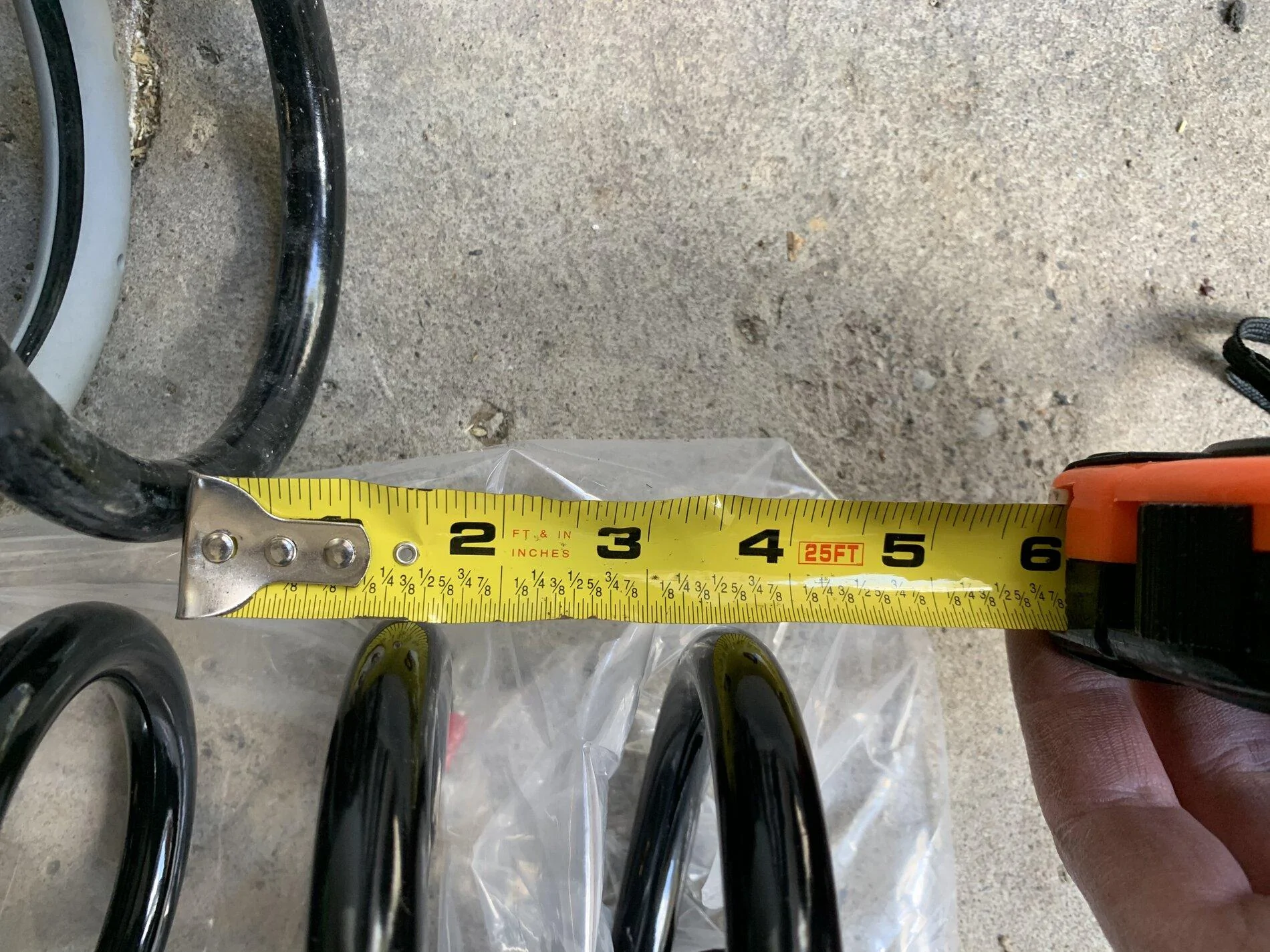

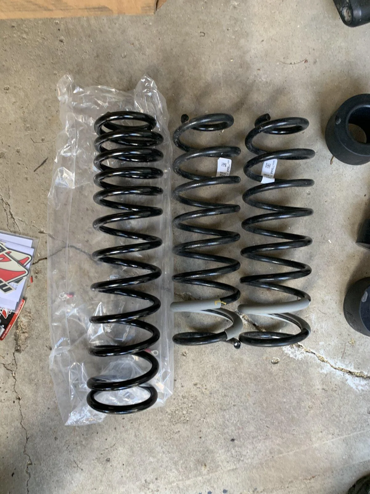

I leveled out my Jeep today by removing the from AEV 2” coil spacers and adding 3.5” JKS coil springs.
The JKS springs were ~ 4” longer than the factory springs.
Jeep Gladiator Willys-Overland JT Build 81C2BD7C-5813-437B-AFEC-2543124A6031
Jeep Gladiator Willys-Overland JT Build 09916D5F-522A-4083-9063-D56ECDF0D01B

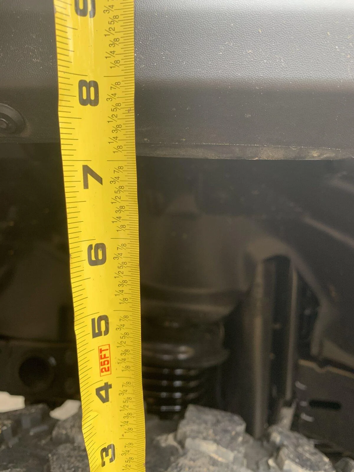

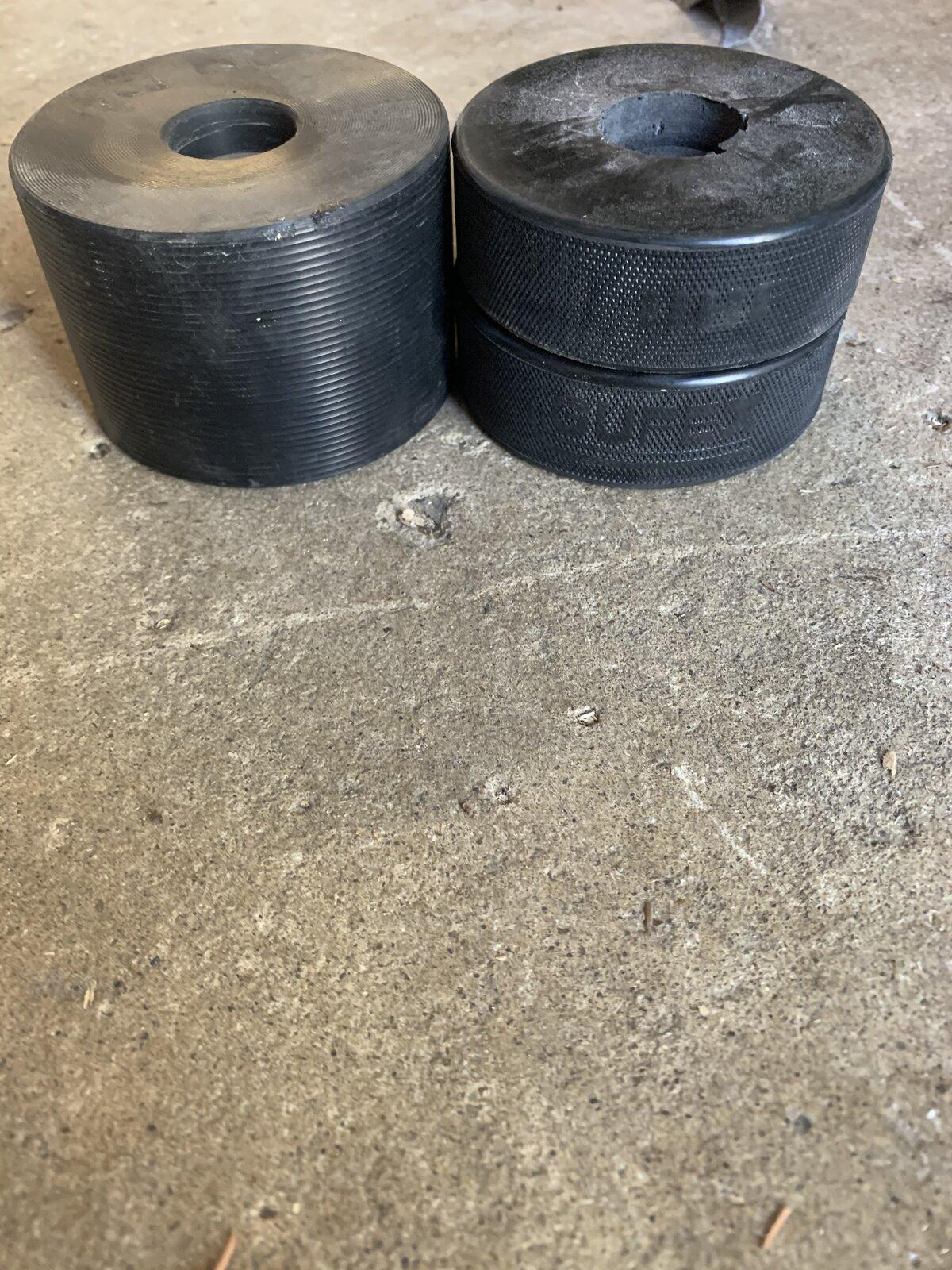

While I had it apart, I swapped in some high quality Czech bumpstops.
Jeep Gladiator Willys-Overland JT Build 0ABE8886-5B60-4B41-879D-E16083386154

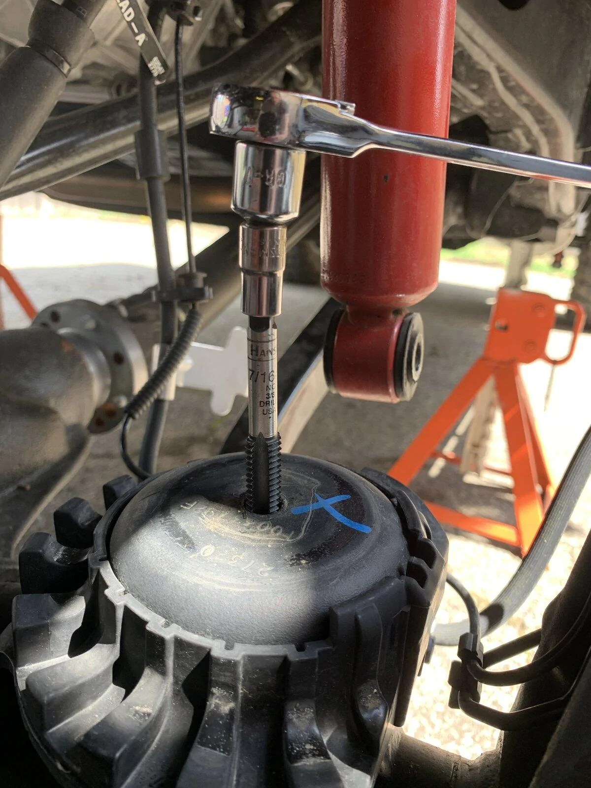

To make fine tuning the uptravel easier in the future, I tapped the spring perches. (Did not love trying to get a nut in below them)
Jeep Gladiator Willys-Overland JT Build ADE75BE6-433F-4DBC-8AE7-1F94A89BFA65

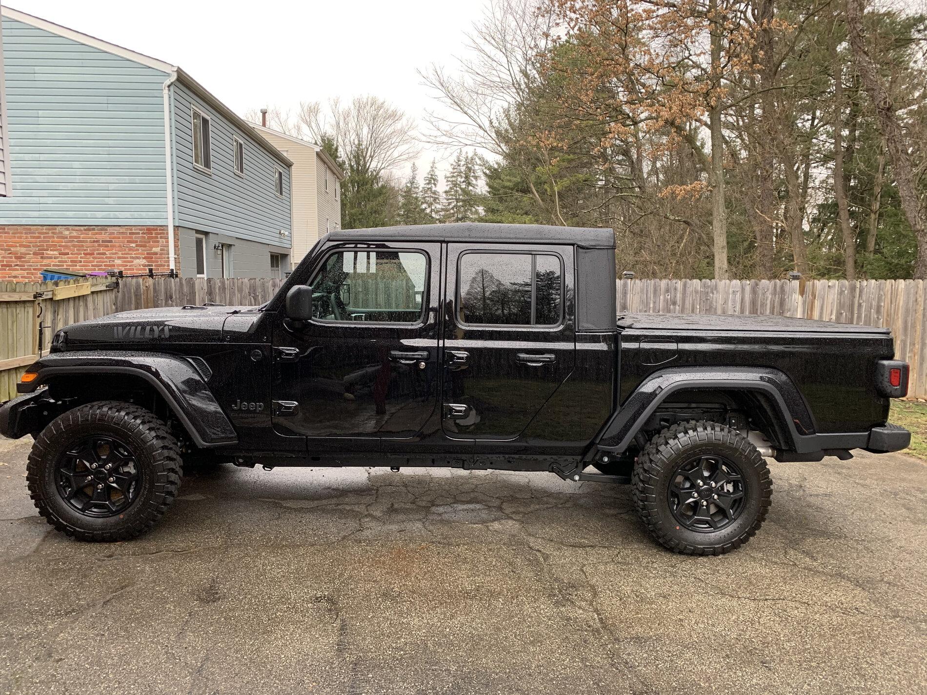

After the swap, it’s sitting ~2” higher in the front. Part of that gain is likely due to the factory springs sagging with the winch, bumper, and heavy rock rails.
Jeep Gladiator Willys-Overland JT Build 92CC7D35-BD53-4F33-9636-EF6EF6095D84
Jeep Gladiator Willys-Overland JT Build A219FBC4-0692-4423-966B-3741EF2532C3
Jeep Gladiator Willys-Overland JT Build CC16CFA9-90B5-4712-961E-5F2CBC9B03AC

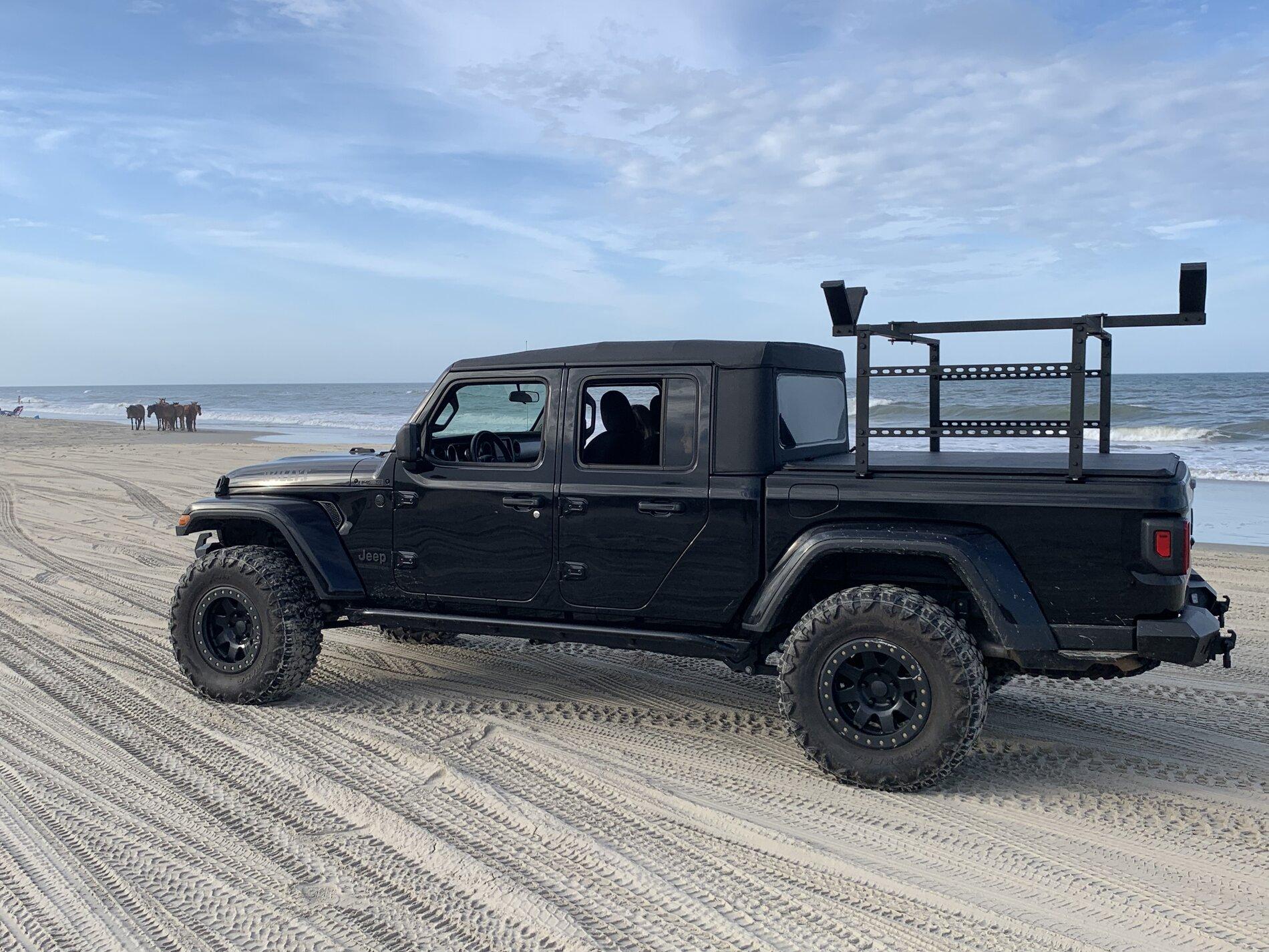

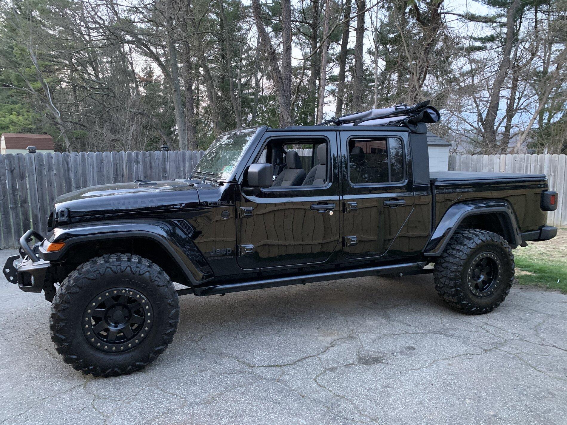

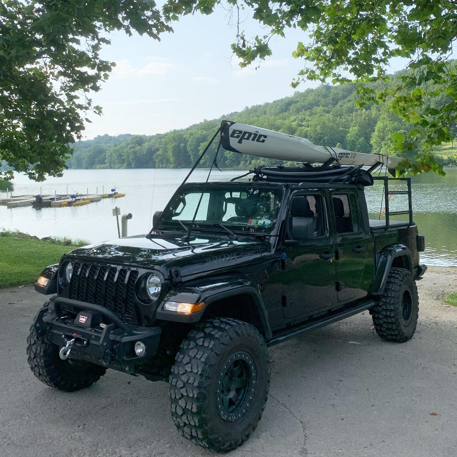

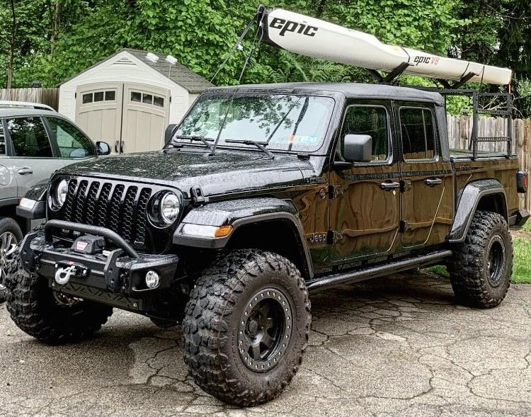

The DIY rack is finally done. I’ve been putting some miles on with the kayak up top to ensure everything holds up. I think it’s going to serve its purpose well. Though aesthetically, the rack would look better if it was lower, being at cab height will also allow me to carry a SUP or anything else of the like.
With the removal of the 4 bolts on the bed rails, I can easily remove the rack by myself. Also, the DIY bed sliders are incredibly handy for accessing the rack to strap things down. Finally, the trifold tonneau cover can still function just as it would if there was no rack.

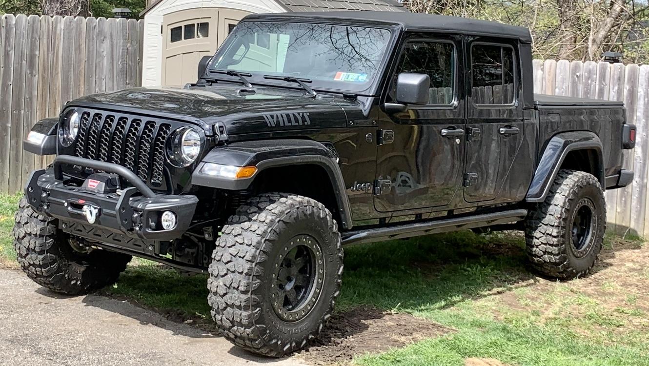

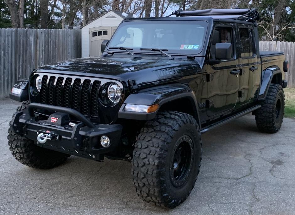

Bumper is sharp. Wheels look good. Dont stick too far out in my opinion, looks good.
I agree looks good. But the state of Pennsylvania doesn't allow the tires to stick out at all past the fenders. Depending on where you're driving, you could be asking to be pulled over in this state. I've been grappling with the same issue, looking to find some nice 35 inch tires that stay tucked.
RCKLNDR
RCKLNDR
Drew
Aug 27, 2019
485
895
Pittsburgh
Jeep
Yep, they stick out way too far for PA. They were tucked pretty well on my JK but on the JT, it’s a different story.
Just like when I got ticketed for driving doorless, you never know when you’re going to catch the wrong officer on the wrong day. I’ll run this way until it becomes an issue.
