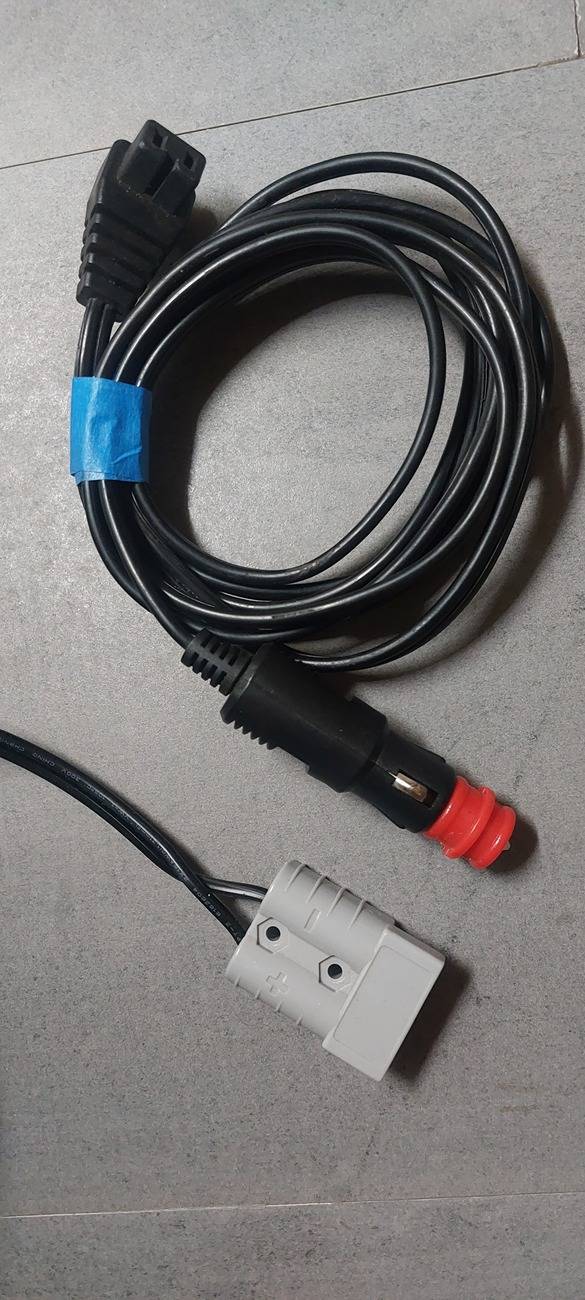

Thanks. I'll look into those or a SAE plug. Maybe I can add one of them to what I already installed.
