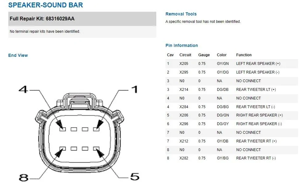

Does anyone know what gauge the speaker wires are in the B-pillar on the passenger side? I haven't found a definitive answer via searching.
I plan to tap into those wires for a source signal for my amp and want the right size Posi-Lock connectors and 4-conductor wire...

Jeep uses a metric 0.75mm wire gauge. Nearest AWG conversion is 19 AWG but you really will not find that laying around so 18 AWG is more practical.
Great info. Thanks! I will post pictures.
