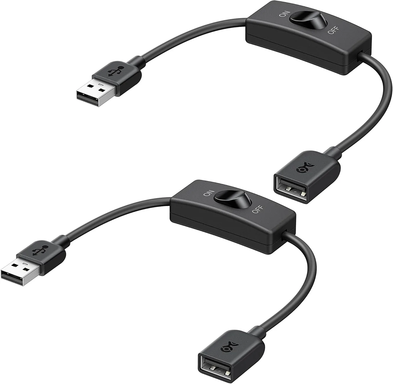

This is a known issue that the USB stays on for I think 15min if I remember correctly before powering off. I just used these inline on/off switches and just turn the adaptor off when I get to where I am going. These also help when the android auto bugs out while you are driving it is easy to just flip the switch off and then on again while driving to reset it.
