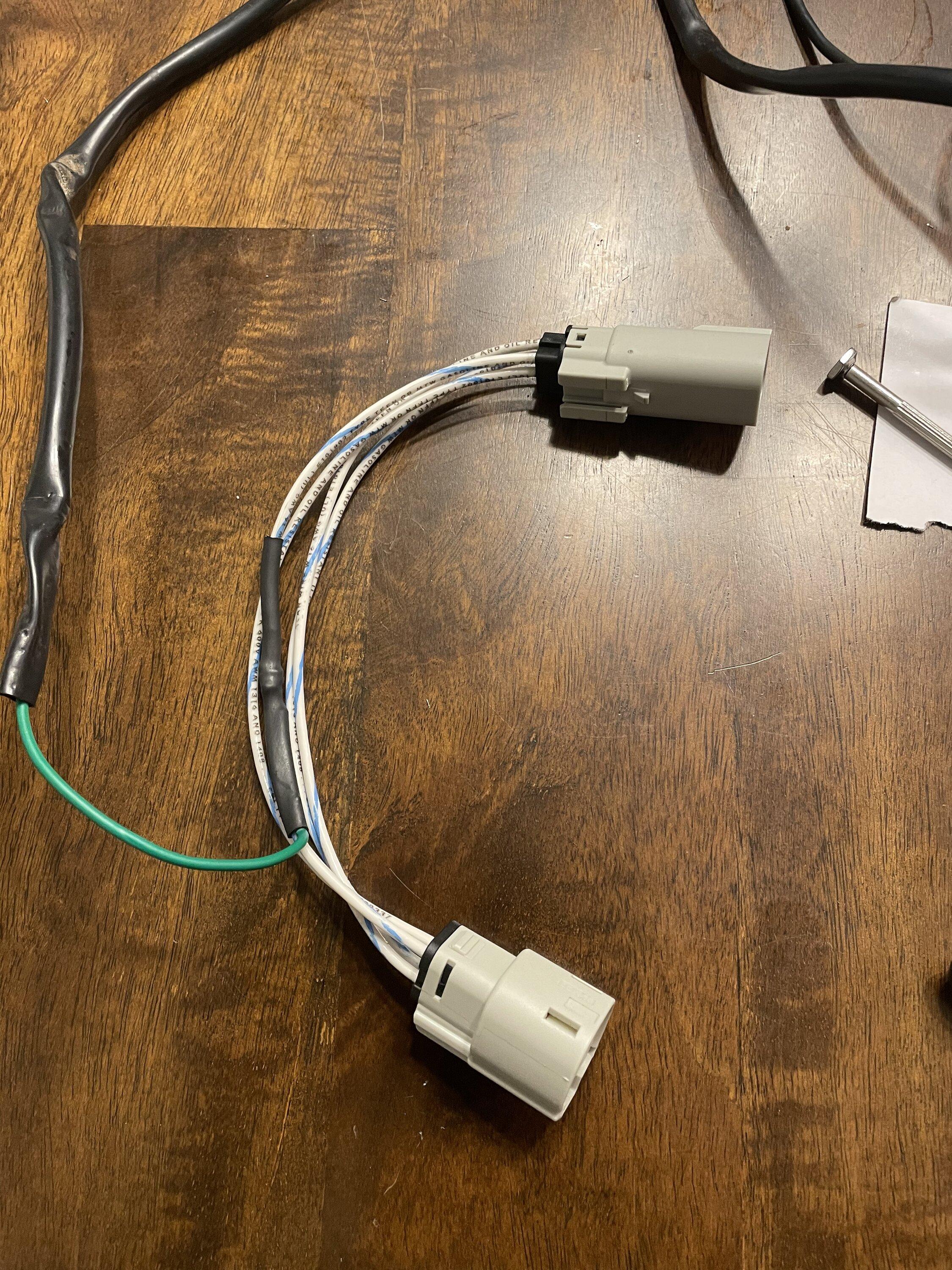

put the connector off the light and turn it on and use a volt meter to find your hot wire. use that wire as the trigger for your relay which will pull the main power from your aux switch if you want it selectable or batter if you just simply want it on anytime you fogs are on. you will need to tap that wire by either using a crimp on wire tap or soldering. i just did the same thing except i wanted mine to come on with high beams. i just made an extension cord essentially to extend the oem wires so the oem wires were never actually cut or tapped. i just tapped my extension.
Thank you! What is the number on that connector? You know off hand which plug that is or do you have e link to it?

that picture is of a grey molex mx150 which is actually the wrong connection. i had to remake it with a black molex mx150 which is alittle different and i didn’t take a picture of that extension. that is the plug for the headlights. if you tap that connection you would have the option for low beam or high beam only. i choose to tap high beam so it was fast for me to dim my auxiliary lights on the road. https://a.co/d/fiFOsNJ
