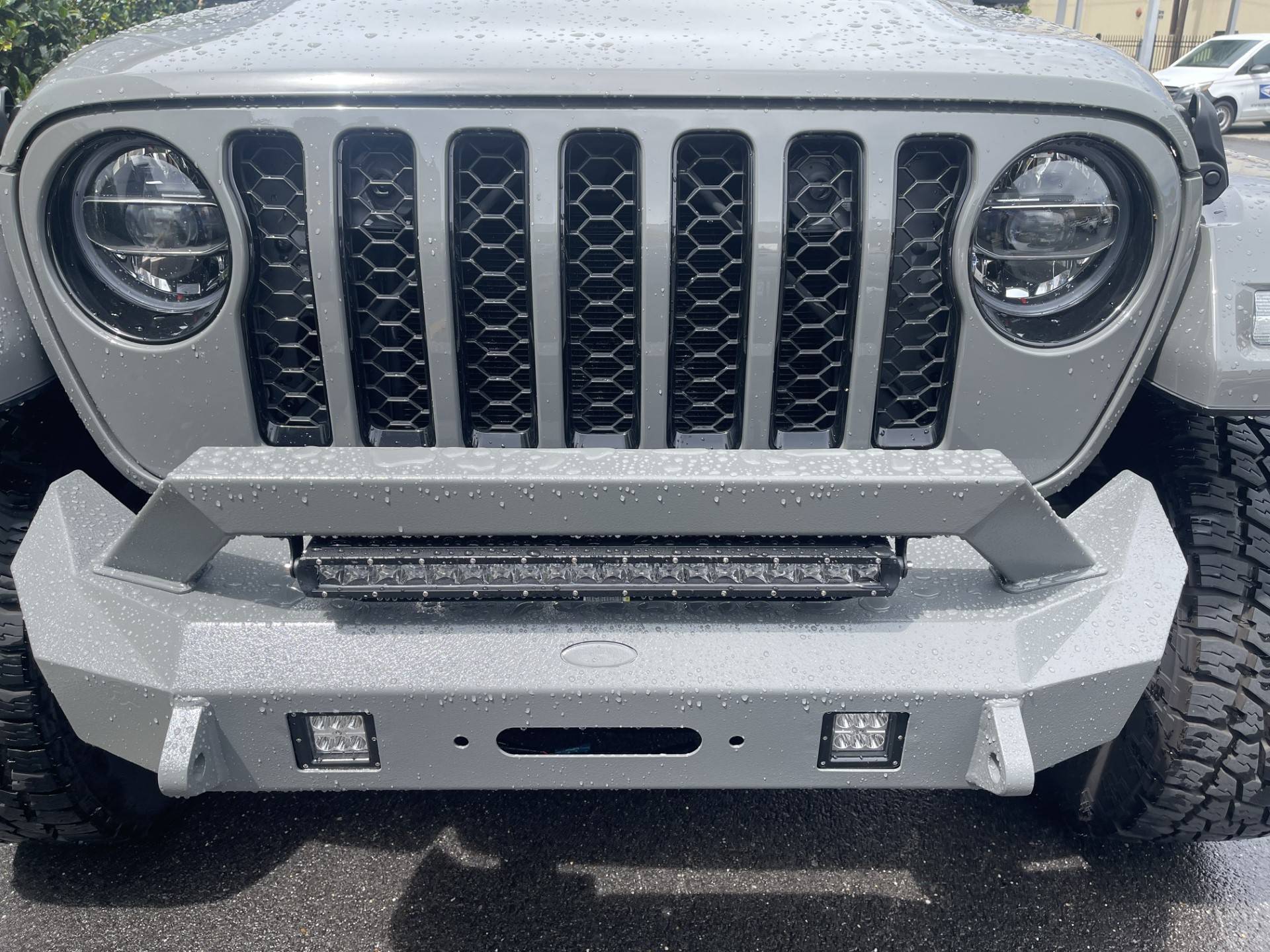

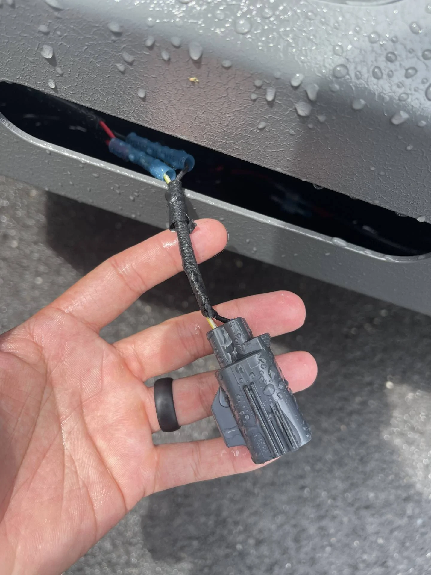

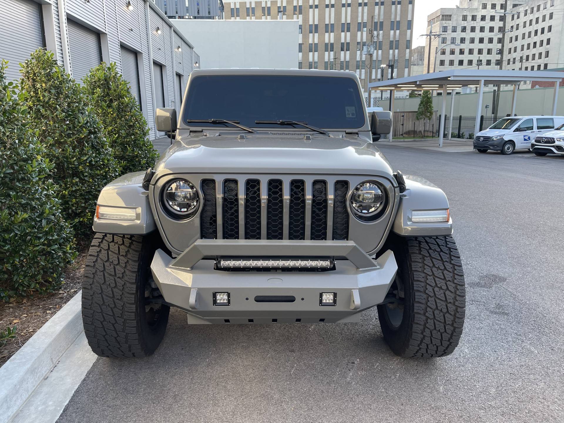

Thank you for the quick reply, I have this set up now. Took my old connector off my stock bumper and tapped in but the only flicker every 10 seconds. Not sure what to go after next, possibly a relay?

Use one of the current connectors towards a relay. Isolates the lights and power from melting down backwords. Real darn basic non-mechanic description.
I have a relay protecting the circuit for a simple cube I use for back up. The relay is activated by low volt off the 7 PIN back up wire, rest of the circuit is high power off the battery (or empty fuse space-can't remember) with a fuse.
I just did 3 circuits with overkill on a side by side (Massimo Buck 450)..\ Simple 9 Inch bar out front, simple 2 small rectangle's out he back and 4 rock lights form Harbor Freight, all LED, each on their own circuit, own switch and own relay. 3 Relays may have been overkill, OR they just make good sense.
With that many lights going on the new bumper, use a relay.
These Jeeps are not ones you want to take lightly with electrical changes, IMO.

The fog light circuit is sized to handle halogen lights, so it’s most likely going to be able to handle ~5A.
So if your LED lights draw less than 5A, you won’t need a relay.
5A is a LOT for LEDs.
