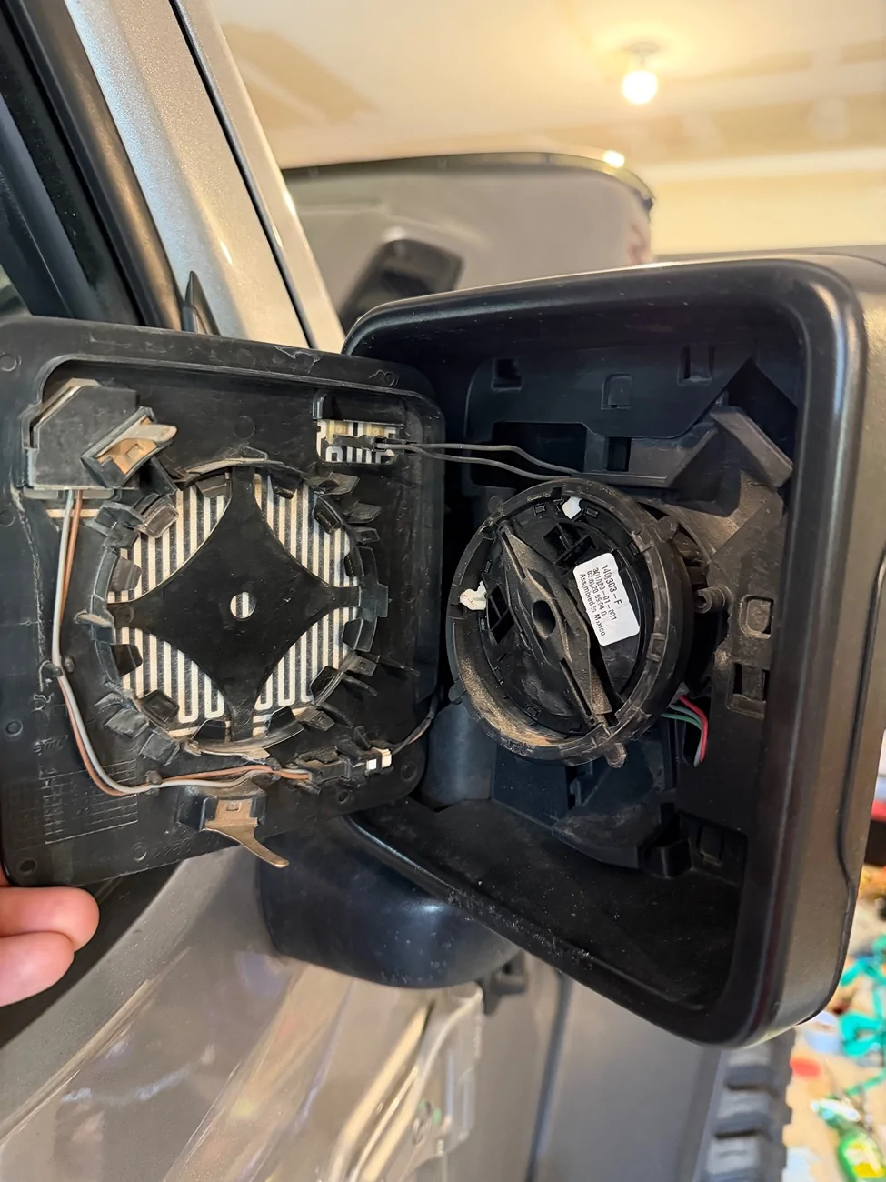

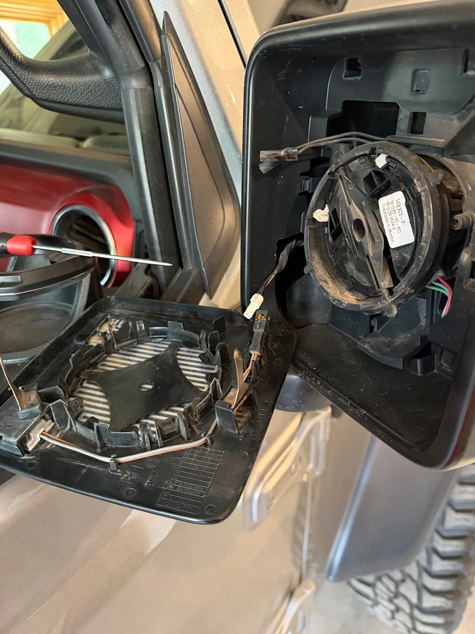

The instructions were clear and accurate. Per their recommendation, I adjusted the mirrors all the way up, then carefully used a wide trim tool to let the bottom edge. They both popped out without damage or difficulty. You need to remove two heating element wires, which I marked with a sharpie to make sure they went back in the original positions. The BSM wiring is clipped into a retainer. It and its wires need to be carefully removed with a pick before disconnection. Then the old mirror is out.
I also took the opportunity to clean the inside of the housing with detail wipes. Lots of dust from across the country in there.
You need to remove one of the adjustment stops for use in the new glass. It doesnât matter which, but one of them allows access for a pick below the stop, so that one is easier. Then install it into the same spot in the Wolfbox glass.

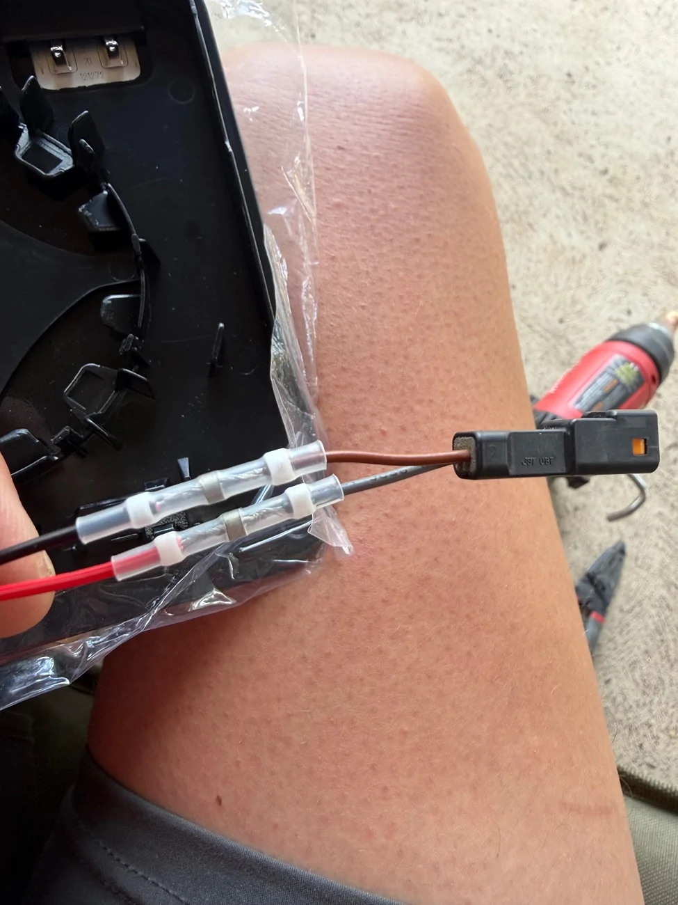

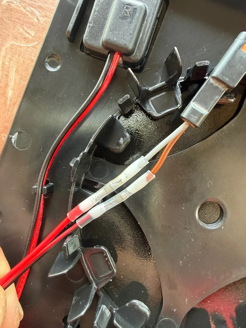

I found that the connector for the BSM light (triangle) on the new glass wasnât a match for the oem connector. This was a test of a new product, so no big deal. I cut the connector off the oem mirrors and solder/heat shrink connected them to the new mirrors. Prior to permanently connecting them, I tested the connection for functionality with the jeep, and documented the correct wiring connections. I communicated this to Wolfbox. The correct connections are as follows:
Wolfbox Mirror Black â> Jeep Harness Redish Brown
Wolfbox Mirror Red â> Jeep Harness Gray

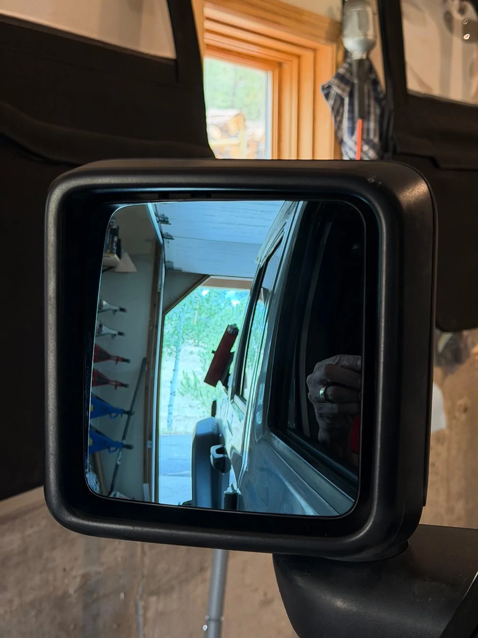

Then itâs just a matter of routing the wires, and carefully snapping the new mirror onto the motor assembly, making sure the adjustment stop goes into its cavity.

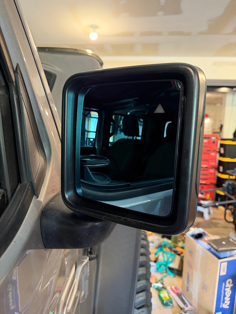

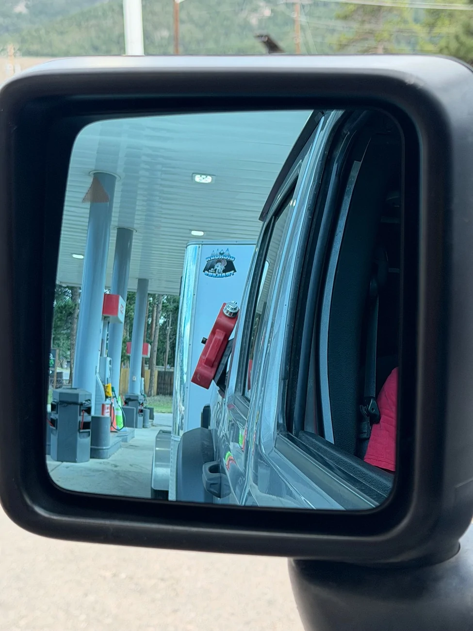

I tested the blue tint version of these, and was very happy I did. Theyâre much nicer on the eyes. I purposefully did this install right before a 9 hour round trip with my 14x7 enclosed cargo trailer, with a decent amount of night driving. The wide angle was immediately an improvement. Leaving my narrow driveway with that trailer was historically difficult, because the factory mirrors werenât able to show the side clearance of the trailer and the driveway. I can now easily see this on both sides. The blue tint eliminated headlight glare from the rear with larger trucks.
Others have said theyâve had trouble with full adjustability with this glass. I didnât have that problem at all, with either side. It has the same range of motion the oem glass had in my opinion. But the convex shape provides a wider and taller view. I genuinely love these mirrors. What a difference in function. And I never wanted to change the look of my jeep by changing the housings, or adding something to them. The BSM triangle is the same color orange, and looks oem. Even though they are heated, they opted to skip the etching of the heat symbol, and the passenger âobjects in the mirror areâŠâ text. Both are fine with me. Itâs a cleaner look and we already know those things.
I spoke to Wolfbox in detail about the connector mismatch, and provided detailed pictures of the oem connector. Theyâre correcting it on their end with production.
