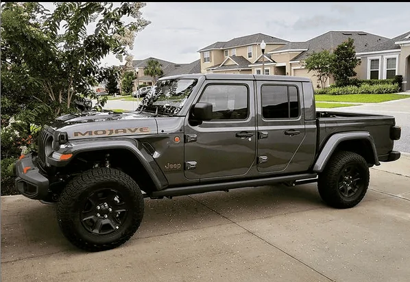

Just looking to trade my stock Mojave wheels straight up for some stock Willy's wheels.
Tires can be swapped too (just to keep it simple) as long as the mileage is similar within reason, and everything is intact (TPMS included, no holes or patches, etc).
PM if you want pics or anything. They're just the plain black Mojave wheels shown here:
