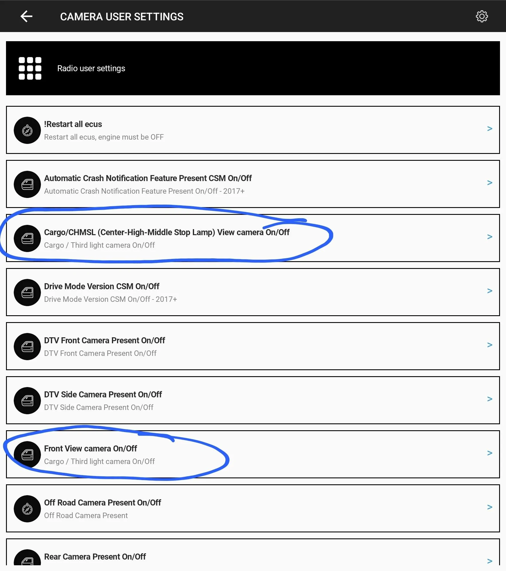

I used a JSCAN app and bypass cable to add the Cargo camera, made it active in two locations:
Jeep Gladiator Z Automotive JSCAN Issue Screenshot_20220130-161012_OBD JScan

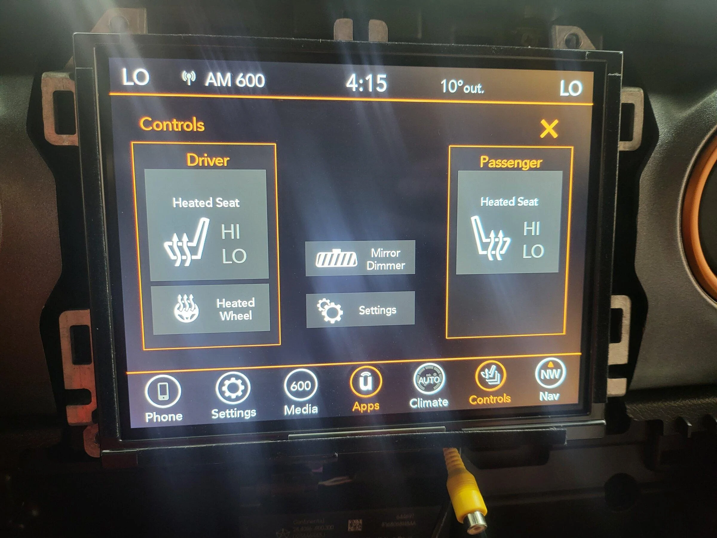

Now, when I turn on the radio I'm missing multiple apps, including my Sirius XM as well as my factory backup camera button:

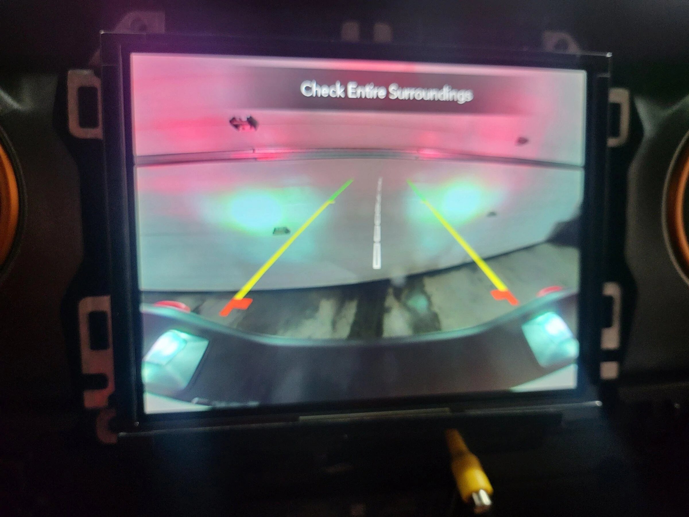

However in reverse it does work:
Jeep Gladiator Z Automotive JSCAN Issue 20220130_161512
I plan to let it sir for a day and drive the Audi and maybe that'll trigger some car jealously.
Any initial recommendations, or thoughts are welcome.

FWIW, I believe Front Cam and Cargo cams are two different things. Front Cam is for the full Trail Cam. What you added is the Cargo Cam. I would revert the setting for the Front Cam and then do a reboot and some 5 minute sleep cycles.

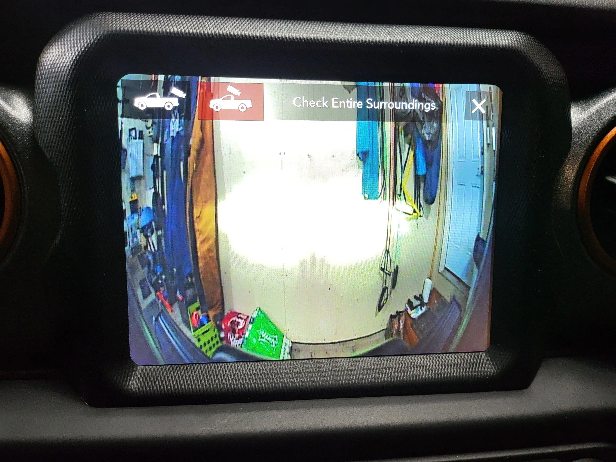

Well, the baby needed to be up at 1 AM, so I sure did a dad thing and checked on the Jeep.
And would you believe it.. it's all fixed. Cargo camera is blue screen, haven't plugged it in yet, but that is awesome sauce.
Thank you guys for teaching me patience. Miyagi Do.
