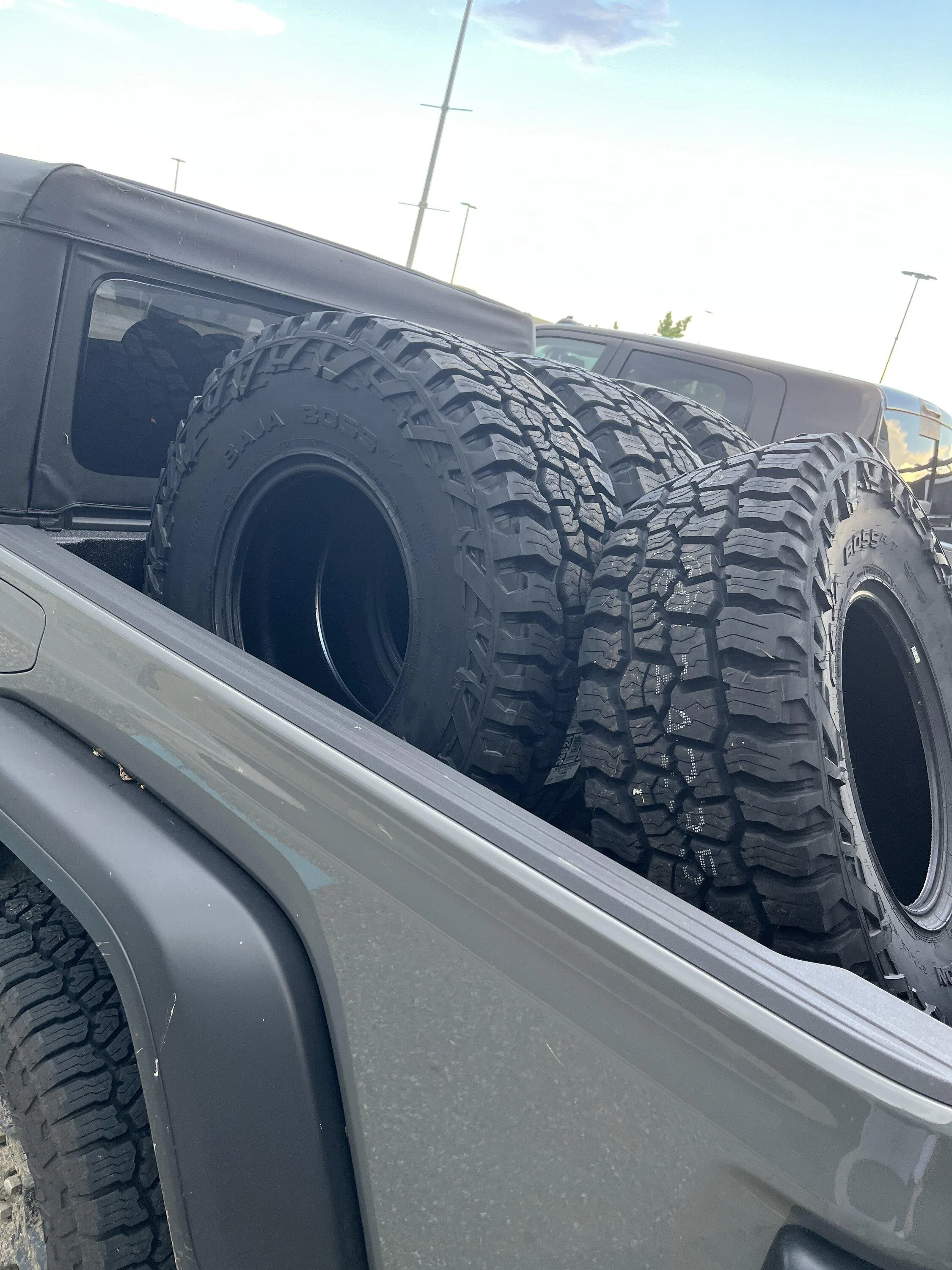

Well got the tires but the shop said I came to late so they wouldn’t mount and balance so hopefully tomorrow and will be installing lift tomorrow as well.

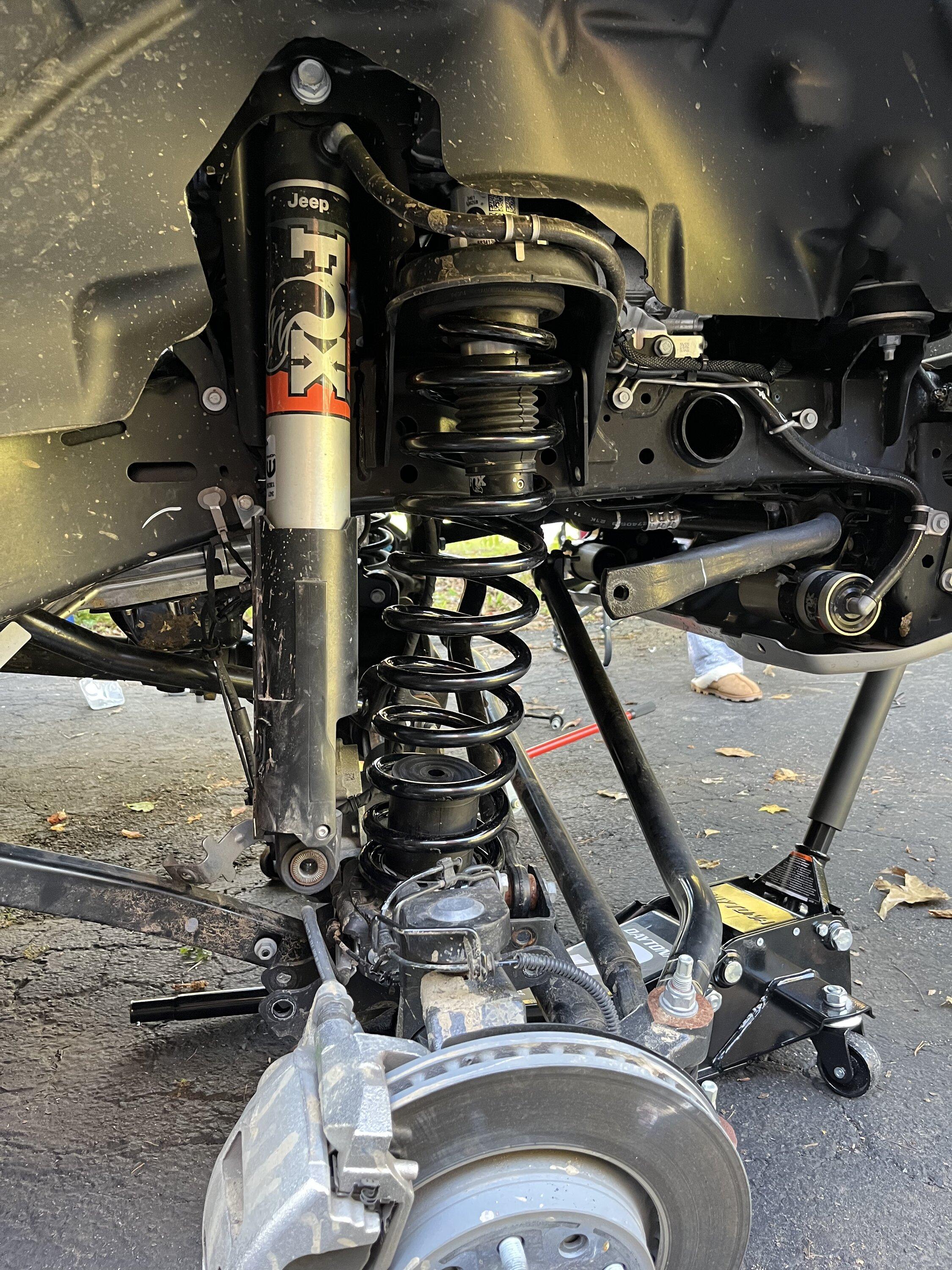

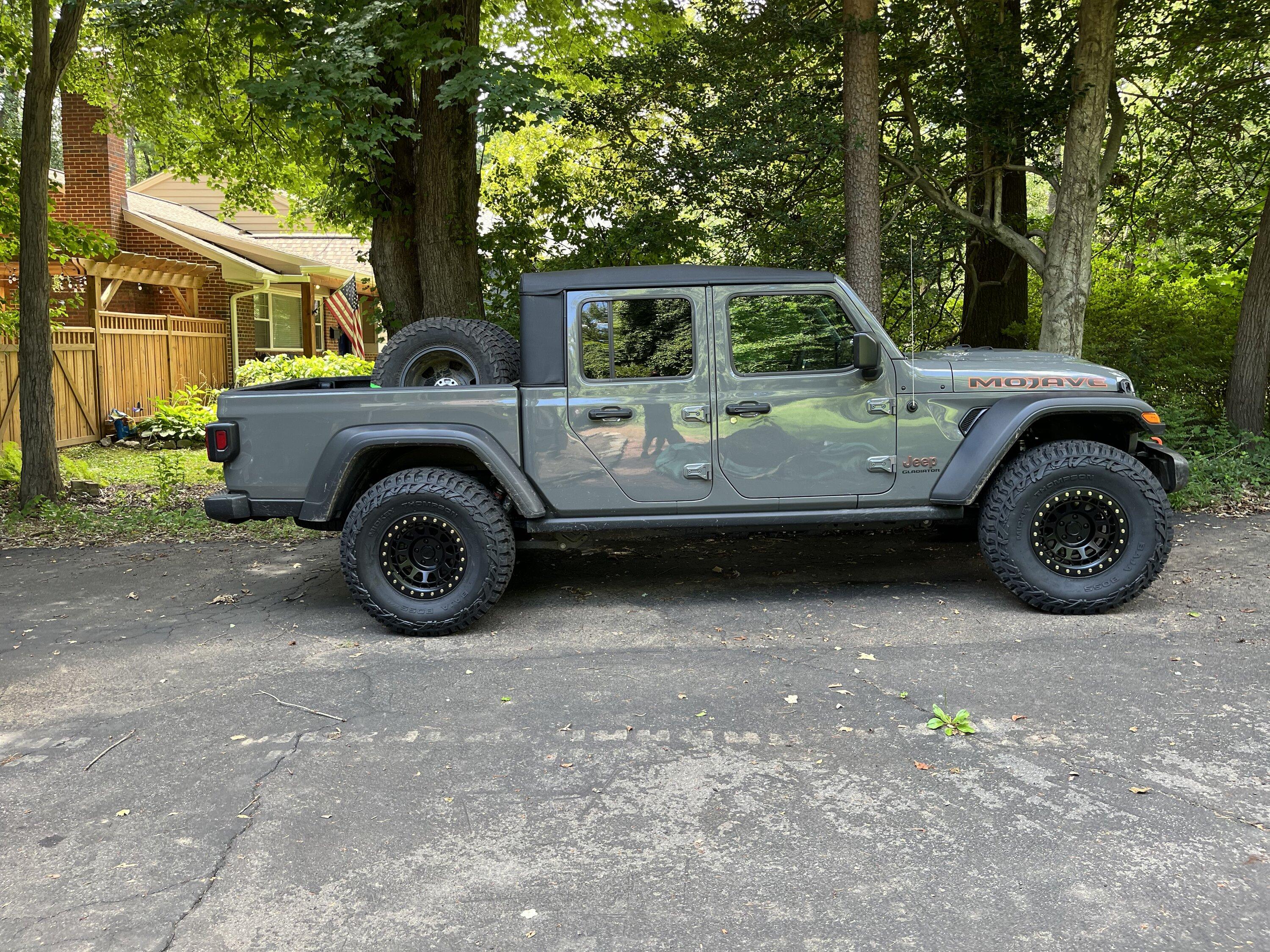

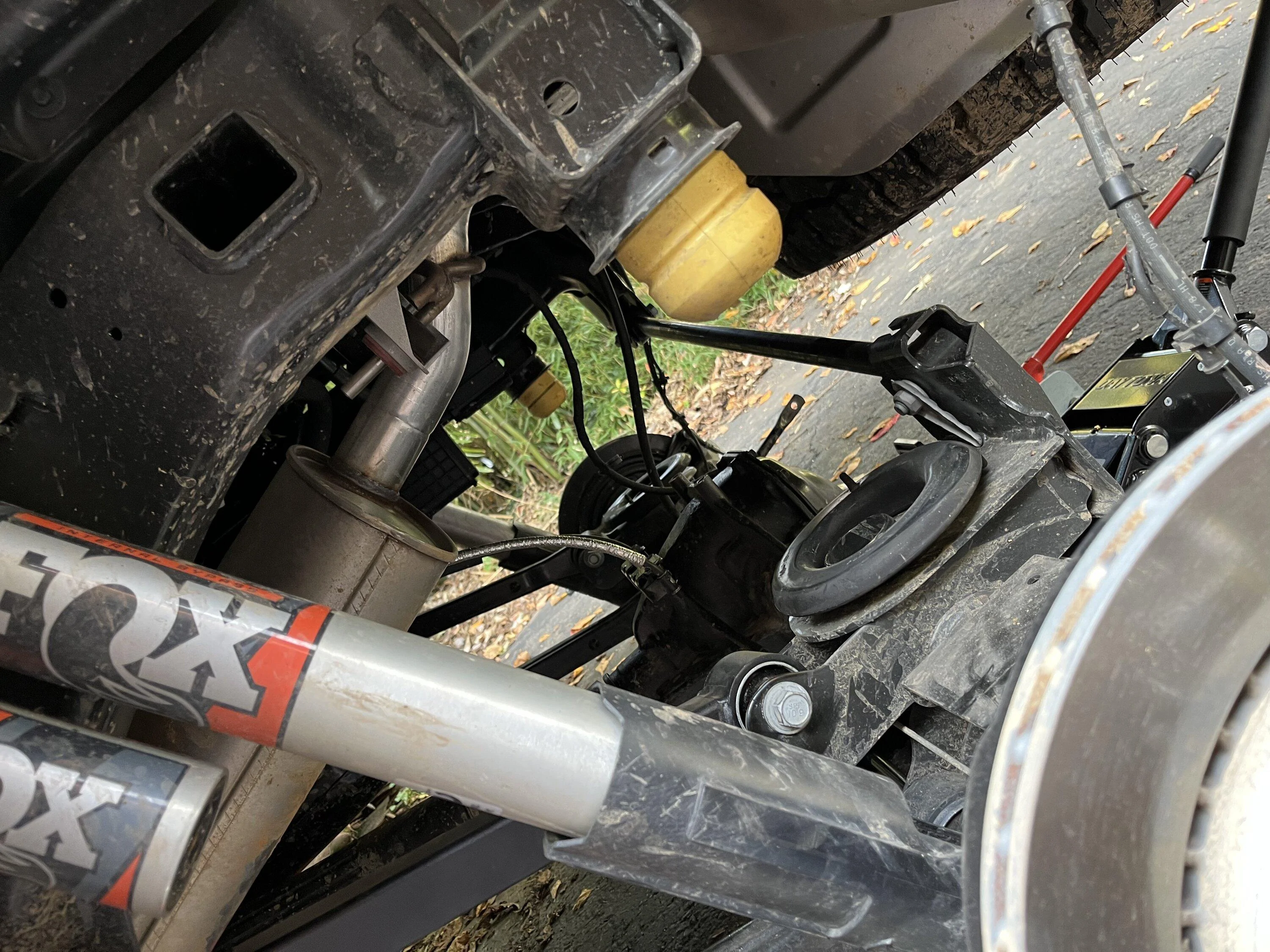

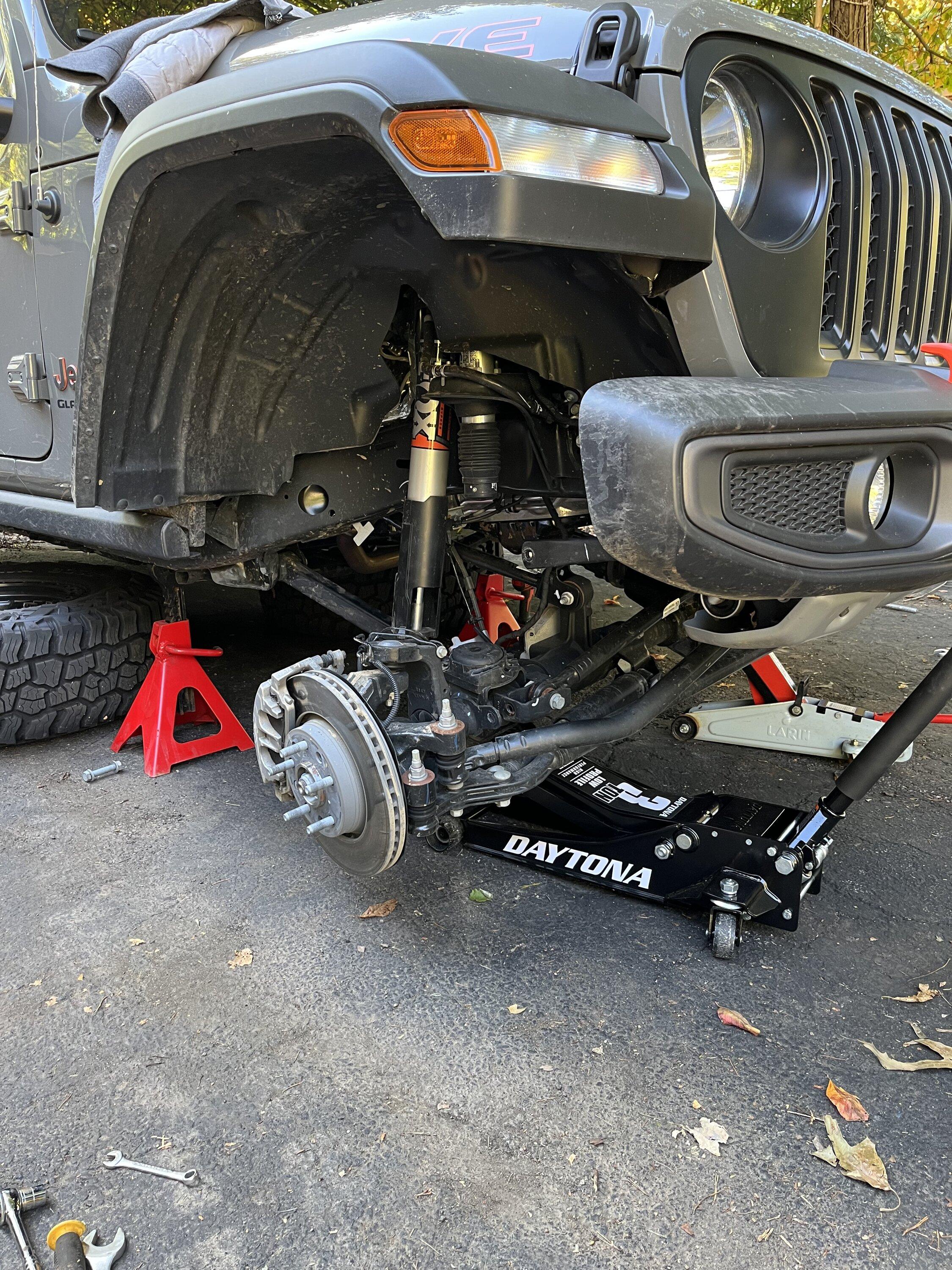

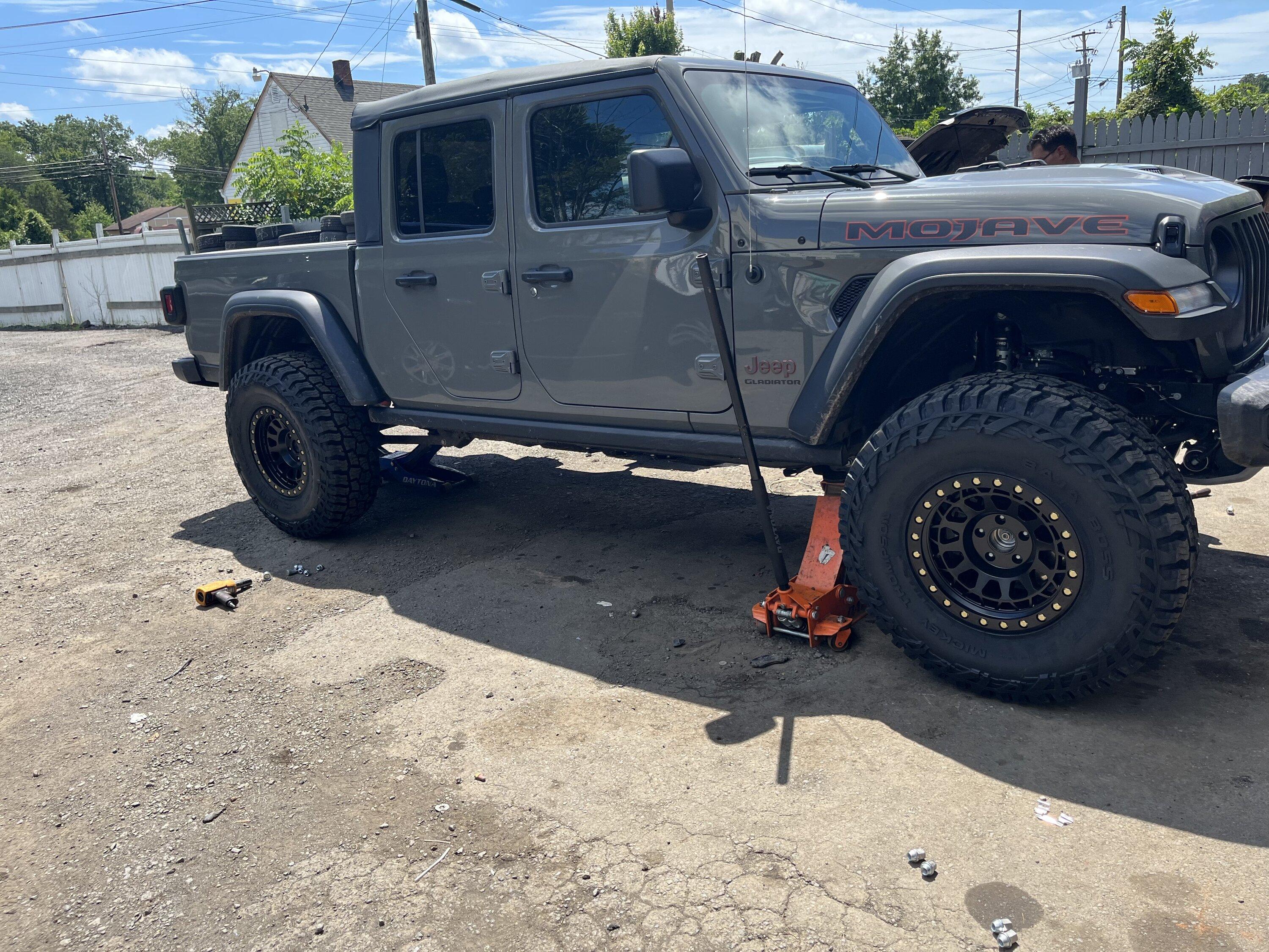

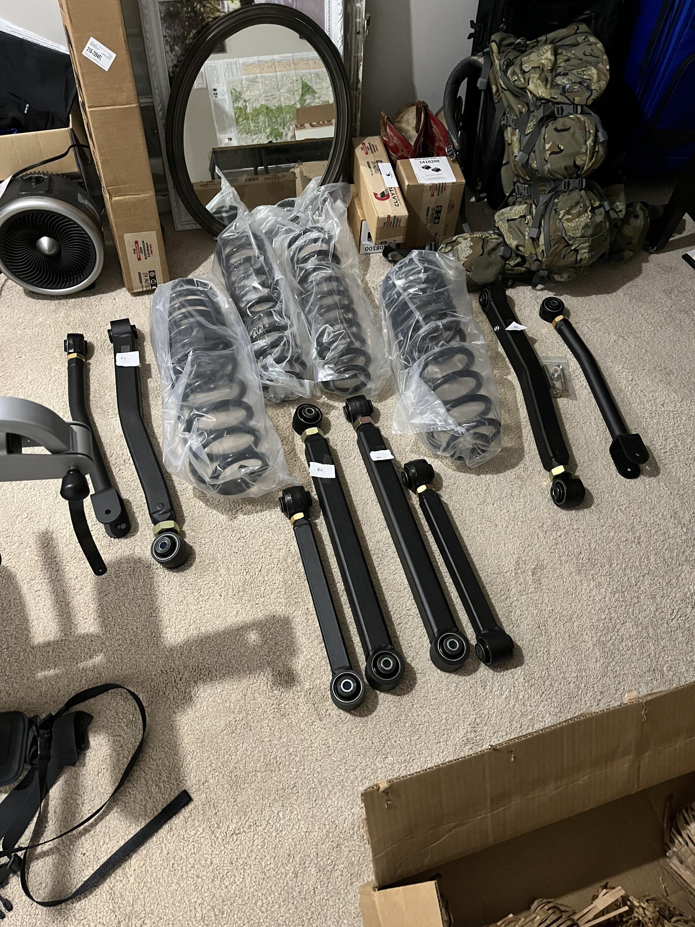

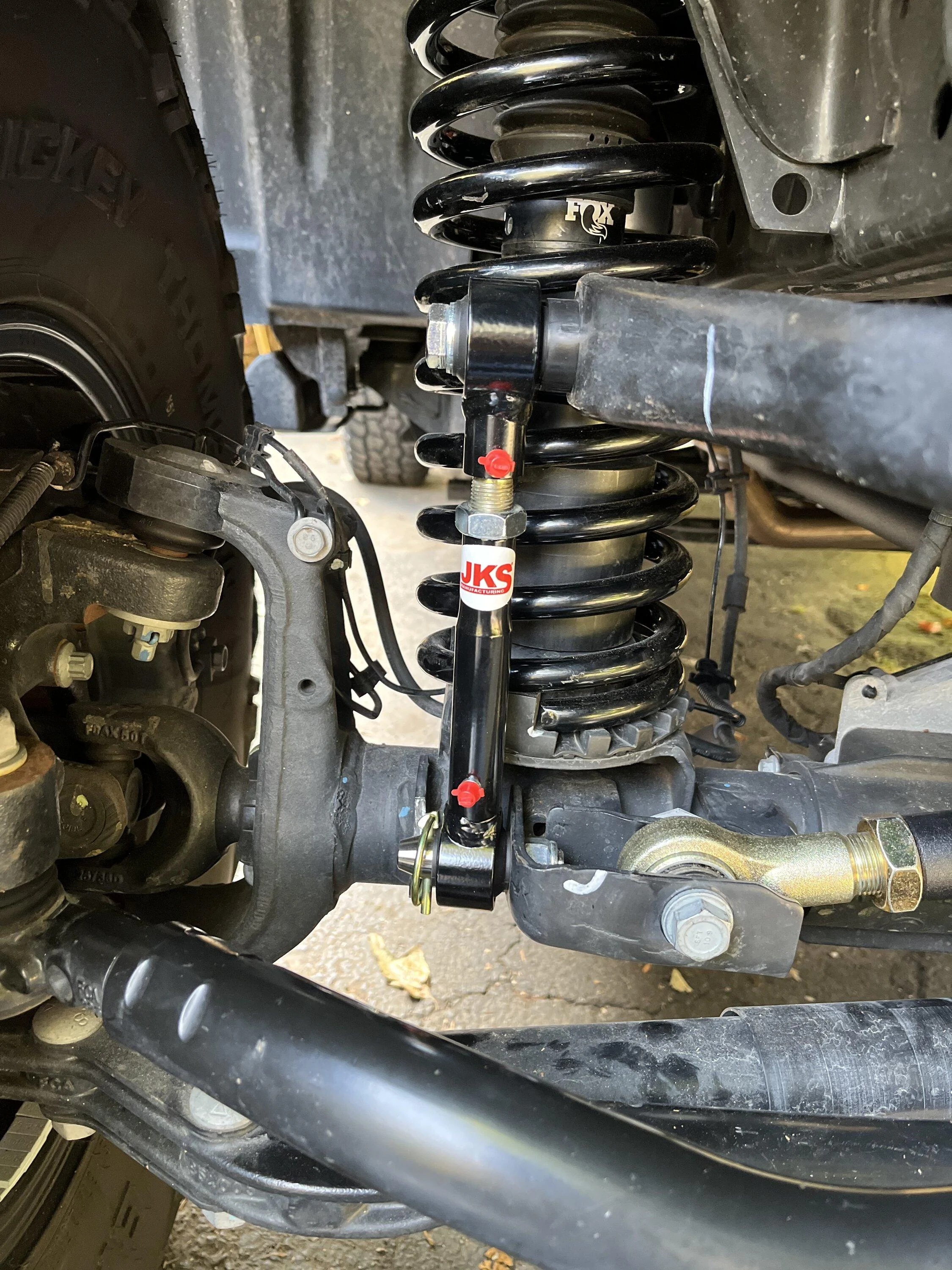

Welp, put the @Clayton Off Road 2.5” overland plus on today in the drive way. Ran into a few issues with the Rusty’s Shock Extensions and bolt diameters but she’s all together now. I was super nervous about the rear end as the brake lines got pretty tight and it was still a pain to get the rear springs in there with keeping the original boot that kept falling out. I still need to torq everything down and take it down to the shop for an alignment. I hope I did alright for a novice haha.
i also went ahead and put in the JKS quick disconnects
Pic #1 with the stock tires in the bed is before the lift, 37s on stock suspension.
up next is the Evo Quarter Pounder and Warn Evo VR 10s.

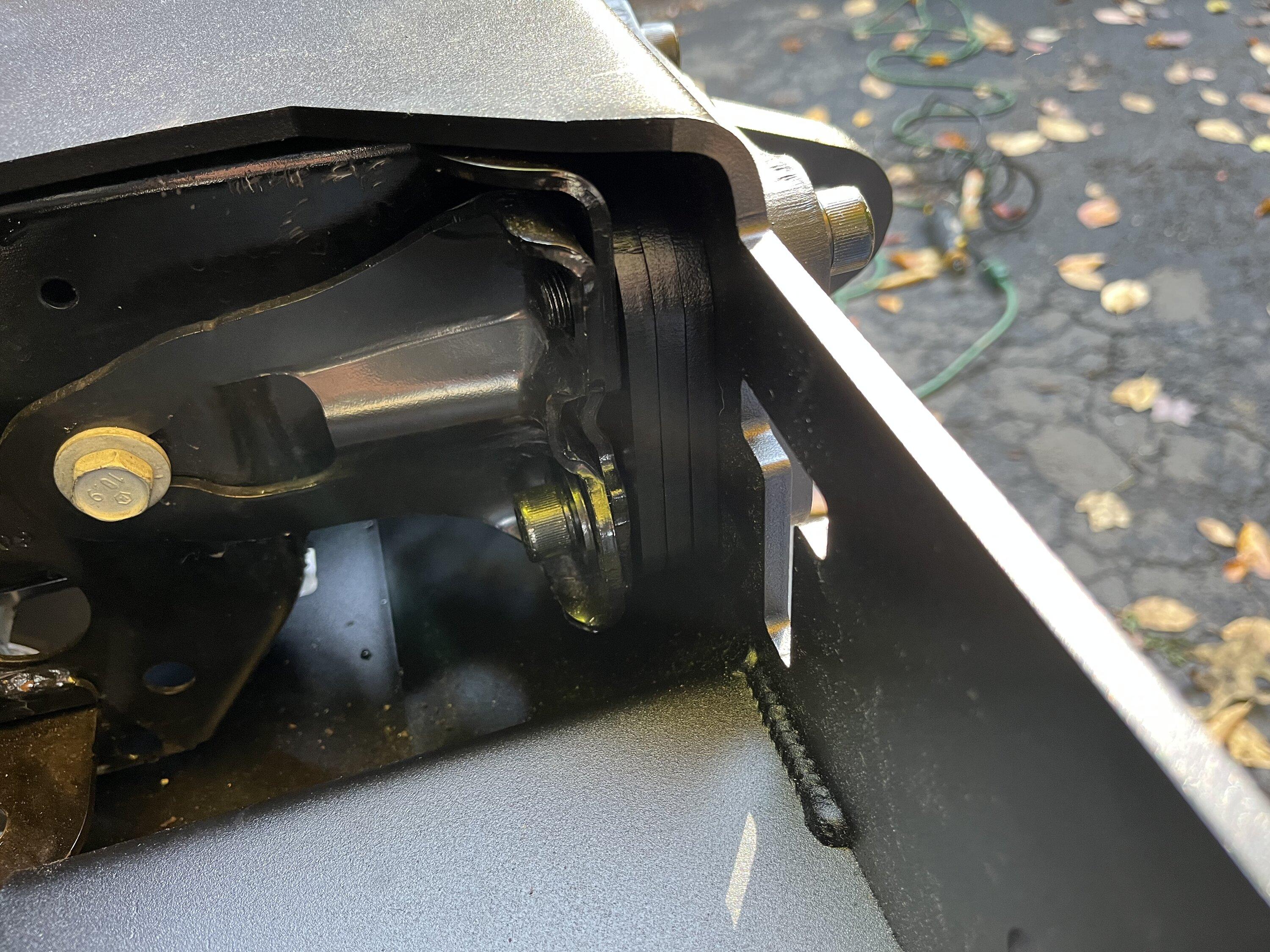

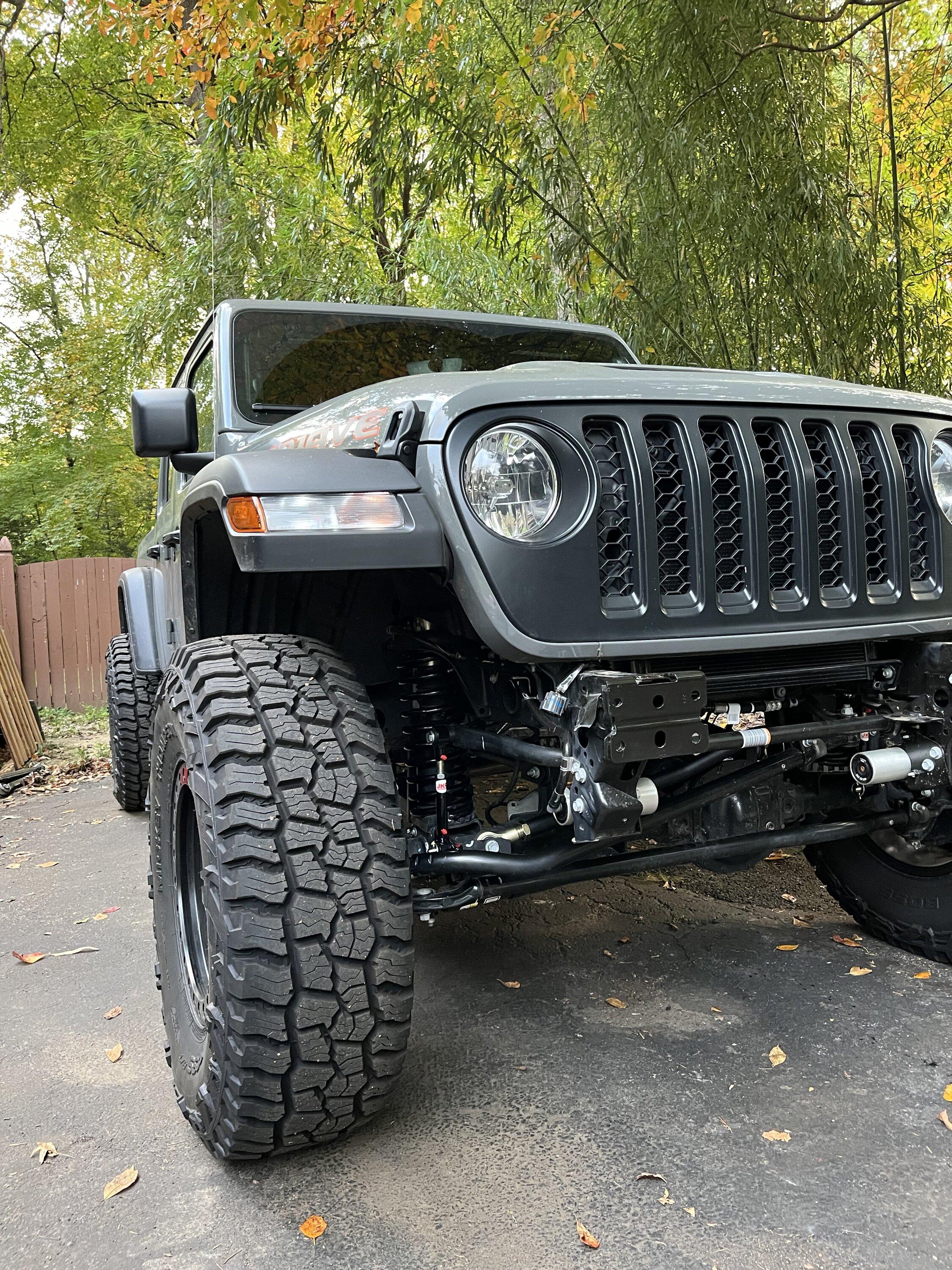

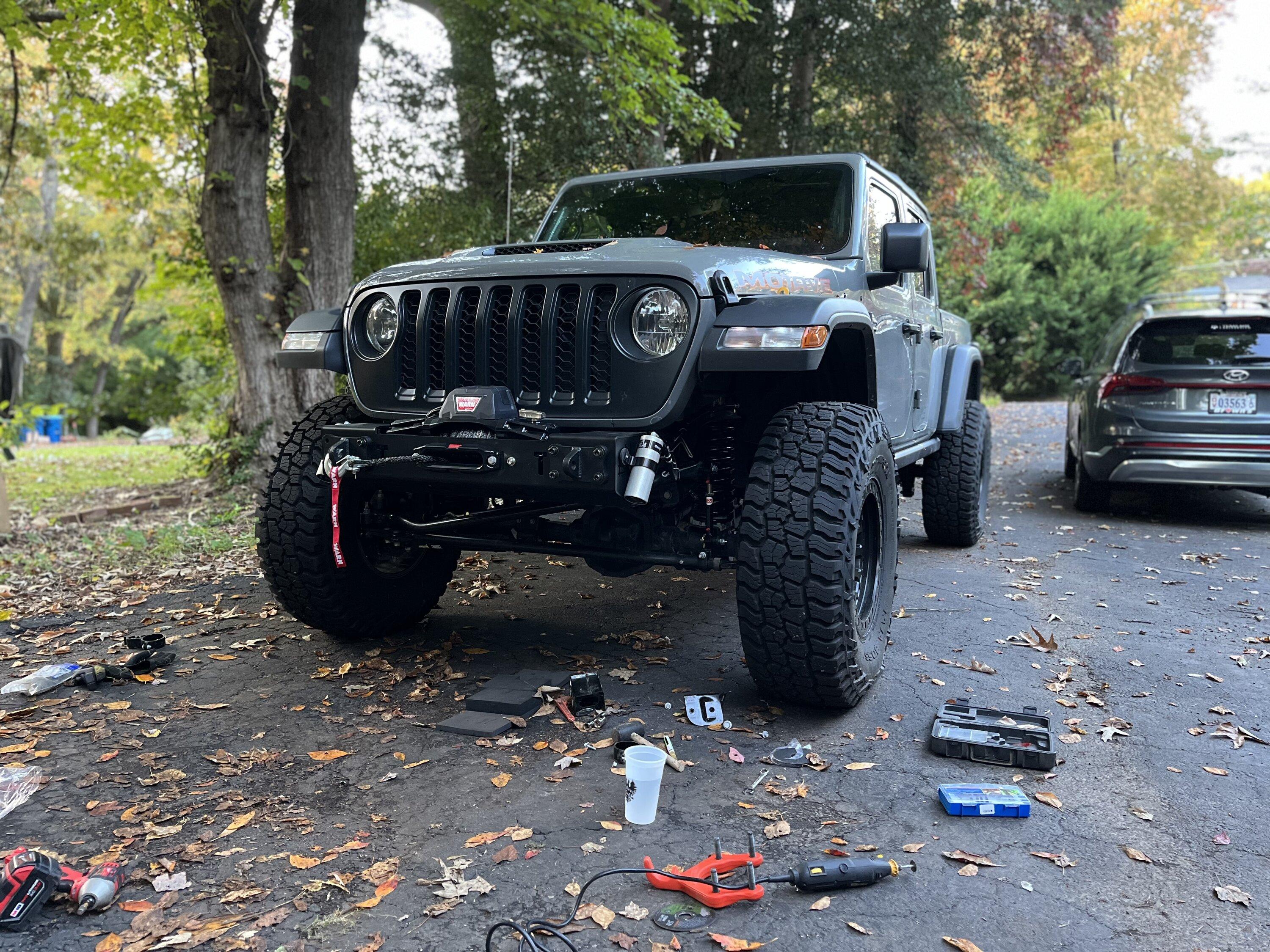

Installed the Evo Quarter Pounder today but found in my D-Ring mounts box I only had 4 long bolts and 4 short bolts @EVO MFG can I get 4 more long bolts for the D-ring mount?

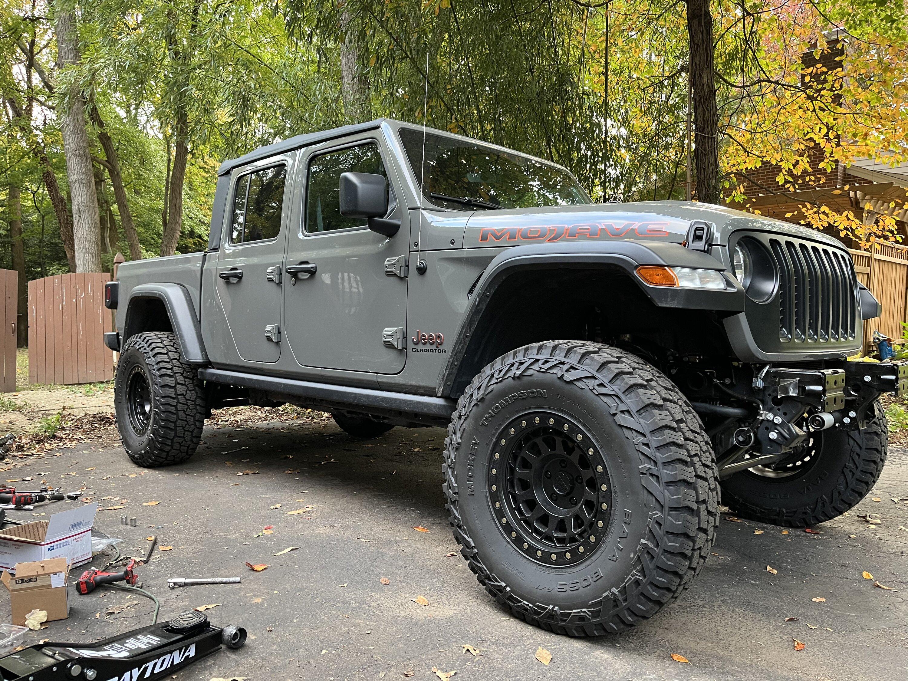

installed the Warn Evo VR 10s, I really wanted to hide my wires but the only way I have seen people doing this is by cutting the bottom of the grill, which I didn’t want to do.

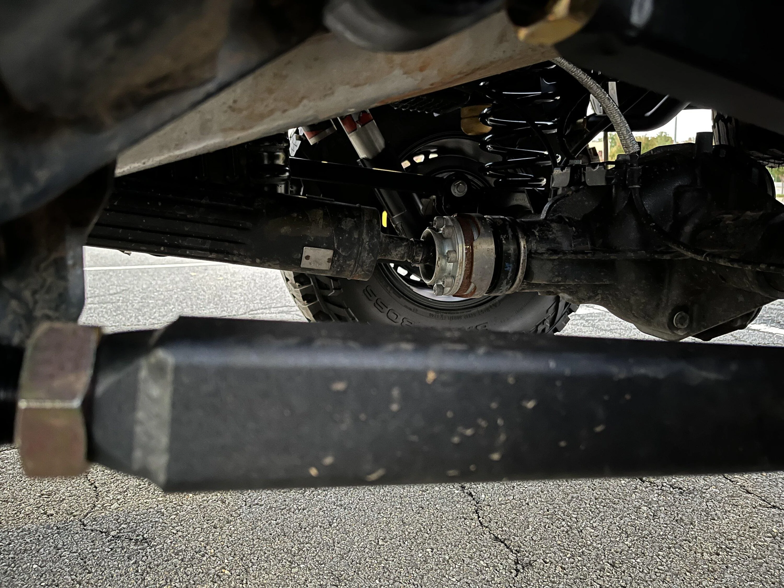

Can you guys also let me know what you think about my pinion angle, I may need to drop my UCA’s and redo it.

I’d suggest you probably don’t have enough thread on even the ‘long’ bolt. I’d suggest ordering some new Grade 8 (or higher) hardware for the bumper attachment and make sure you have sufficient threads exposed to get the entire not over it.
NoSoGood
NoSoGood
Adam
Jul 5, 2022
36
50
Fairfax, VA
2022 Sting Gray Mojave
Ended up taking the interior plate of and it gave me more than enough thread.
