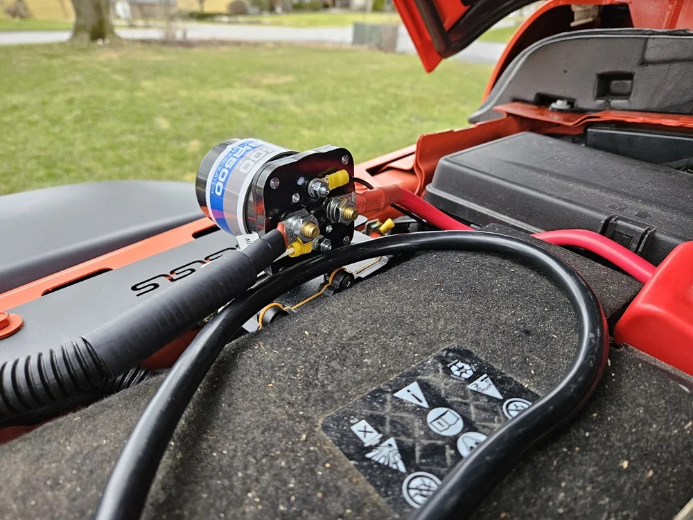

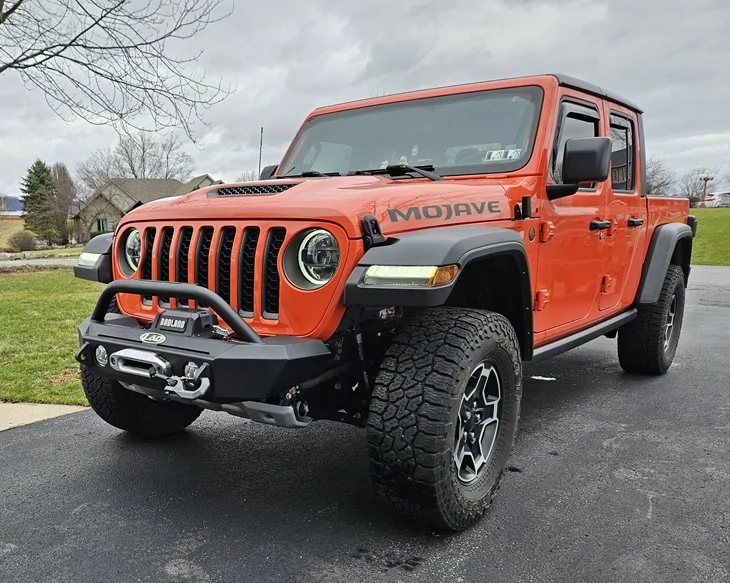

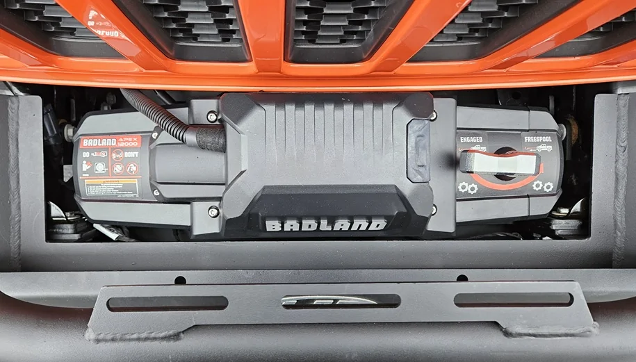

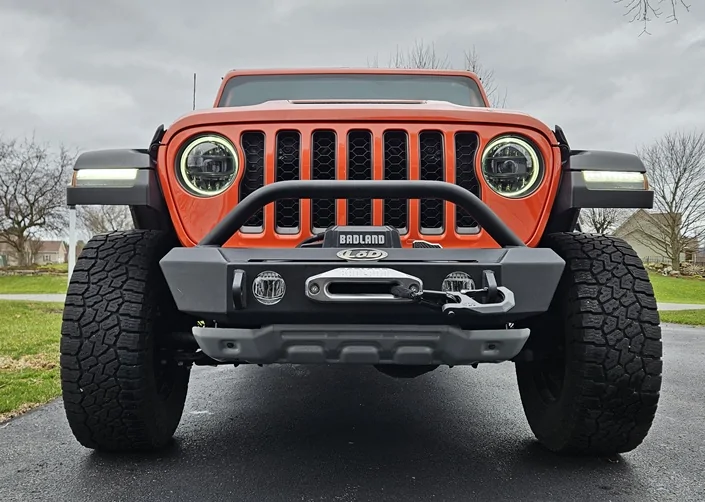

A few weeks ago I picked up an LOD Signature Series Shorty bumper from @B.A. Baracus and I finally got around to installing it. I was able to snag the Badlands Apex winch at Harbor Freight over winter when they had a sale on them. My buddy came over yesterday and we got it all installed despite the graupel (aka snow covered in ice, he was proud that he knew that word).

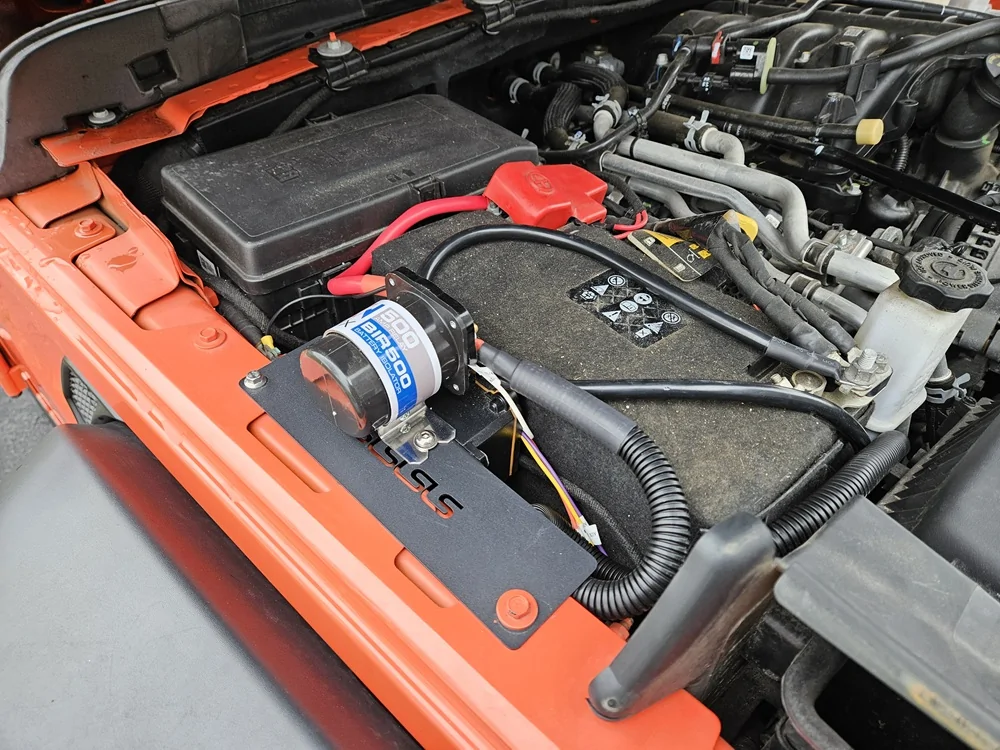

The bumper install wasn't too bad. It was a tight fit getting to some of the nuts and bolts to tighten them, especially once you put the winch in there. We did have to modify the winch and take the cables out the side of the cover. It was really easy to do that and my buddy even had a rubber grommet that covered the old hole. I used my Aux 3 button wired to a 500 amp relay to control power to the winch. I mounted the relay on top of my Lasfit aux button mount in the engine bay, which worked out nicely. The only thing I have left to do is do some heat shrink on some of the cables and shorten the two big power cables.
Overall I am extremely happy with both the bumper and winch!

That bumper works with factory lights and factory sway bar skid ?

It works with the factory LED fog lights and the Mojave skid that protects the remote shock reservoirs. I believe the Rubicon sway bar skid is the same size as the Mojave one so it should work with that. The bumper directions say this bumper works with three different kinds of factory fog lights. There was a bracket that is used to fit one or both of the other fog lights. Mine bolted right up to the bumper without the adaptor bracket.

I thought Aux 3 and 4 were only 15 amps, while 1 and 2 are 40 amps. I would assume you'd want higher amps for a winch, or am I wrong ? I don't have a winch, just thinking out loud...
