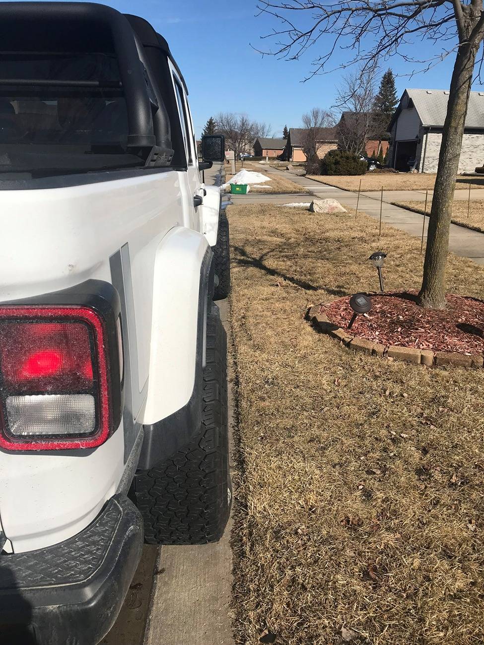

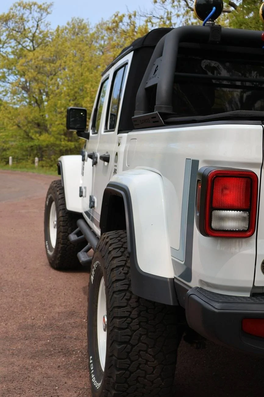

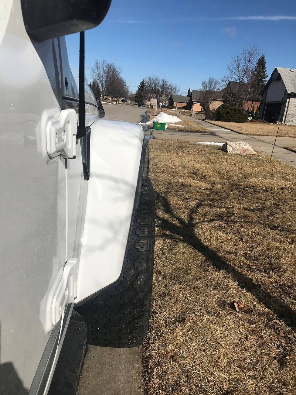

CJ retro wheels are 17x8.5 with 5.2" backspacing. I wouldn't want to go too much less due to tire poke and ball joint issues as mentioned before . I originally had 35's and now running 37's but both are 12.5" wide, so the tire poke is basically the same
Jeep Gladiator 2.5" lift with 35's, what backspace on a 17x9 rim? Brockway MTN 2
Jeep Gladiator 2.5" lift with 35's, what backspace on a 17x9 rim? Eagle harbor 1
Jeep Gladiator 2.5" lift with 35's, what backspace on a 17x9 rim? wheel poke front and back 2
Jeep Gladiator 2.5" lift with 35's, what backspace on a 17x9 rim? Wheel poke front
