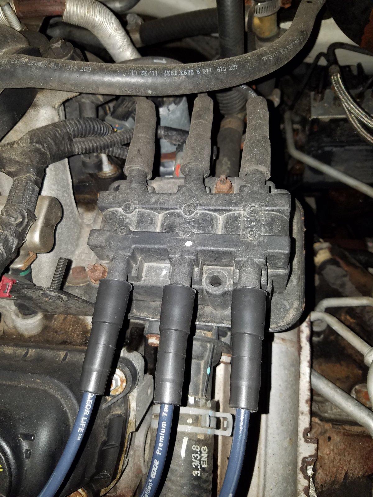

Well now i'm lost.
Still only having misfiring on #2. I looked up online that looking at the engine from the front bumper, the closest, far left cylinder is #2. The plug wire running to this said #2, and on the coil pack it ran to the #2 spot. So i'm thinking i've got the right cylinder.
I changed plug and wires on 2,4,6 yesterday.
I sprayed all around the #2 cylinder intake manifold with a spray bottle. Didn't notice anything. Pulled the #2 new plug, smelled a bit like gasoline, so i'm assuming the injector is working.
Did a compression test on #2=160psi, #4=155psi, #6=158psi.
I don't know if a leakdown test is needed if you have decent compression. And i don't know if this is a thing, but i tested #2 again, 155psi. Then i went to buy beer, came back 20 minutes later, the gauge was at 153psi. So it didn't lose hardly any pressure. Is this the same as a "poor mans" leakdown test, or is this horribly not accurate and doesn't mean anything?
I should have a new coil pack tomorrow from Amazon. I'll swap that out and see. Maybe only #2 isn't working, even though its wasted spark and has 3 coils for 6 cylinders?
