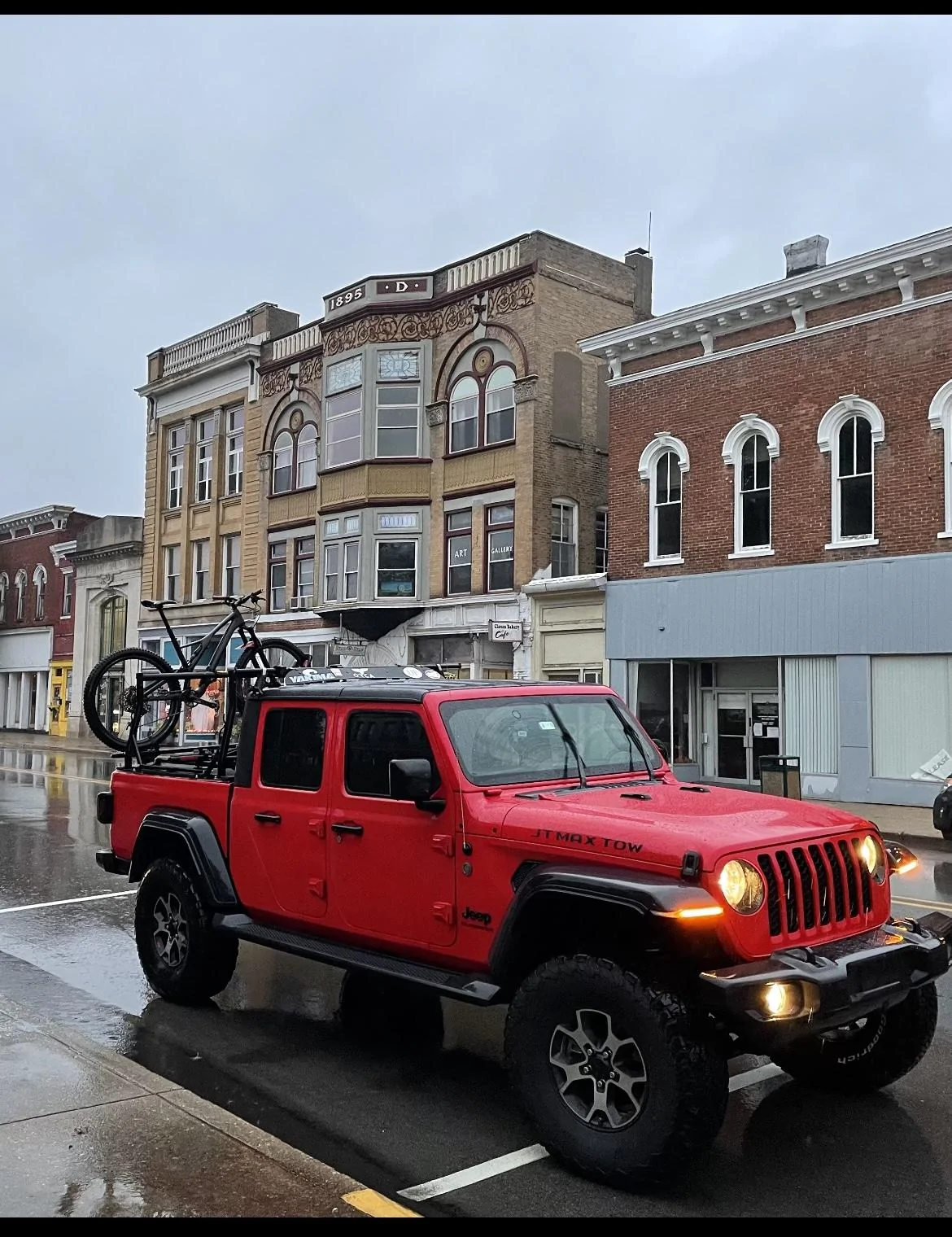

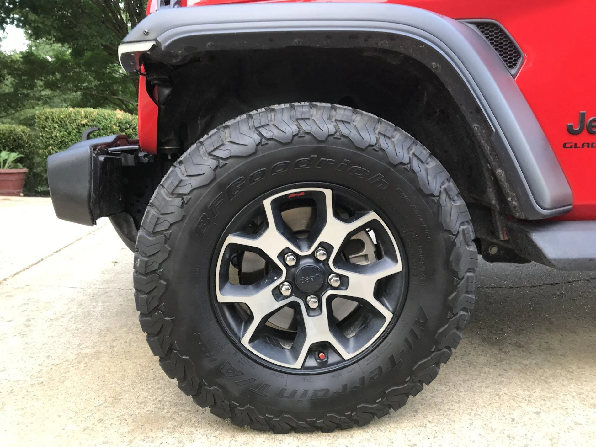

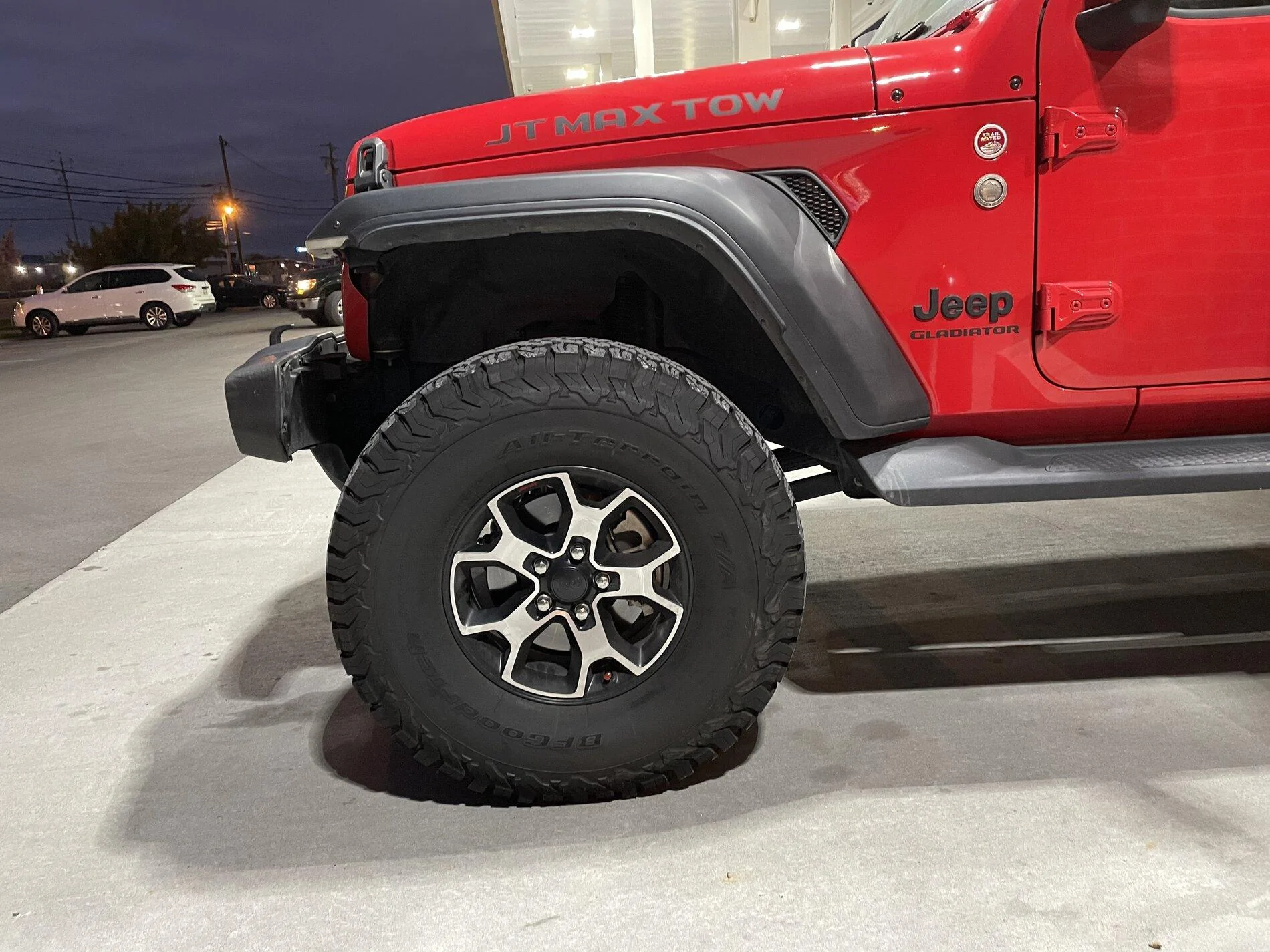

My JT has run well over the 4000 miles I thought I did this Summer... more like 7000. So the stock Bridgestone tires are done at almost 50,000 miles.
I bought some used wrangler Rubicon take offs as temporary wheel and tire set until I have time to figure out best lift, getting these headlights and fogs switched to LED,better tail lights, front bumper, winch, and tires will be 37x12.50x17 BFG AT KO’s.
Here are pics with new to me wheels and 285x70x17 BFG at KO’s.
I will say that the Jeep steers m, looks and handles much better with these.

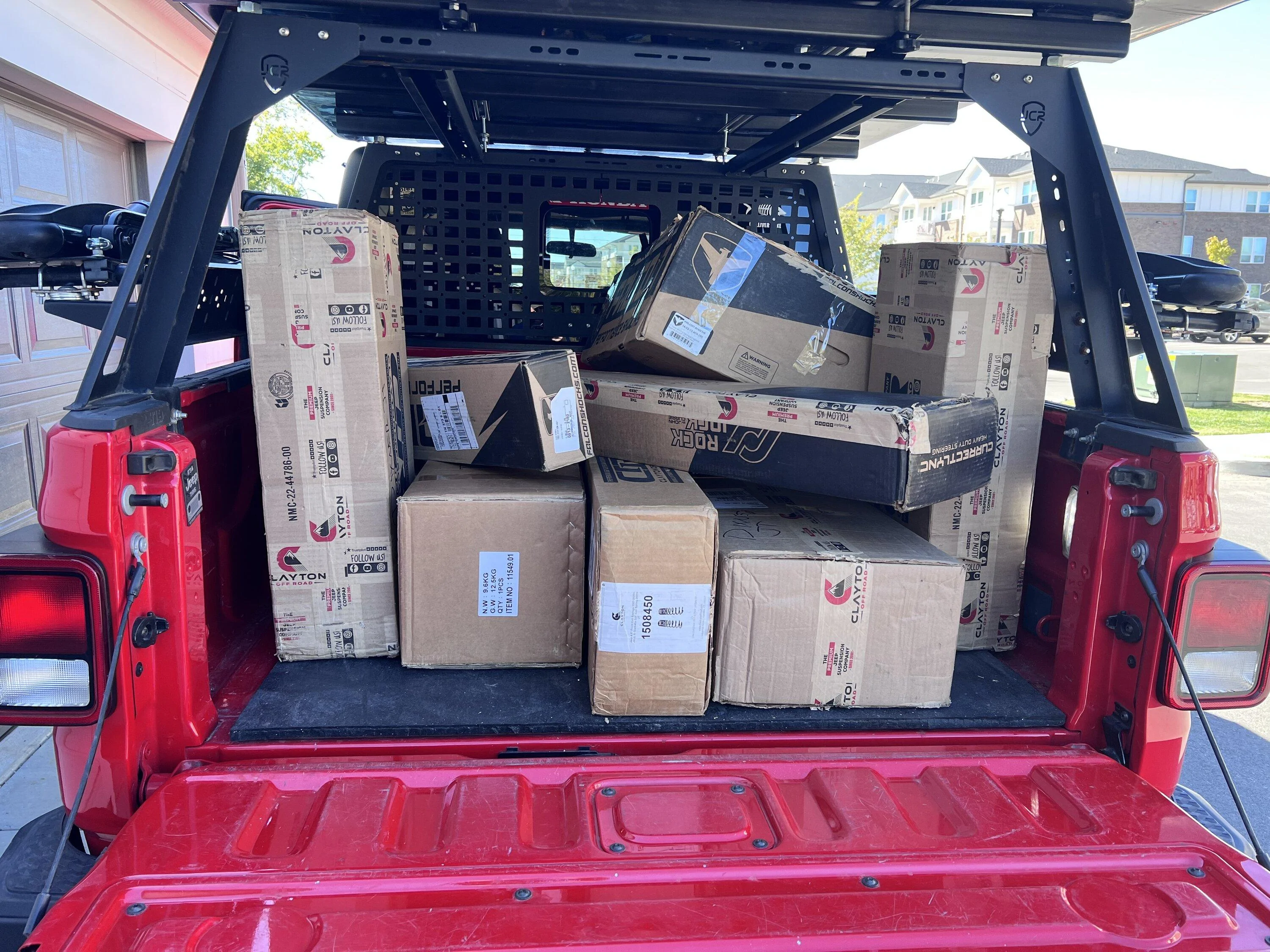

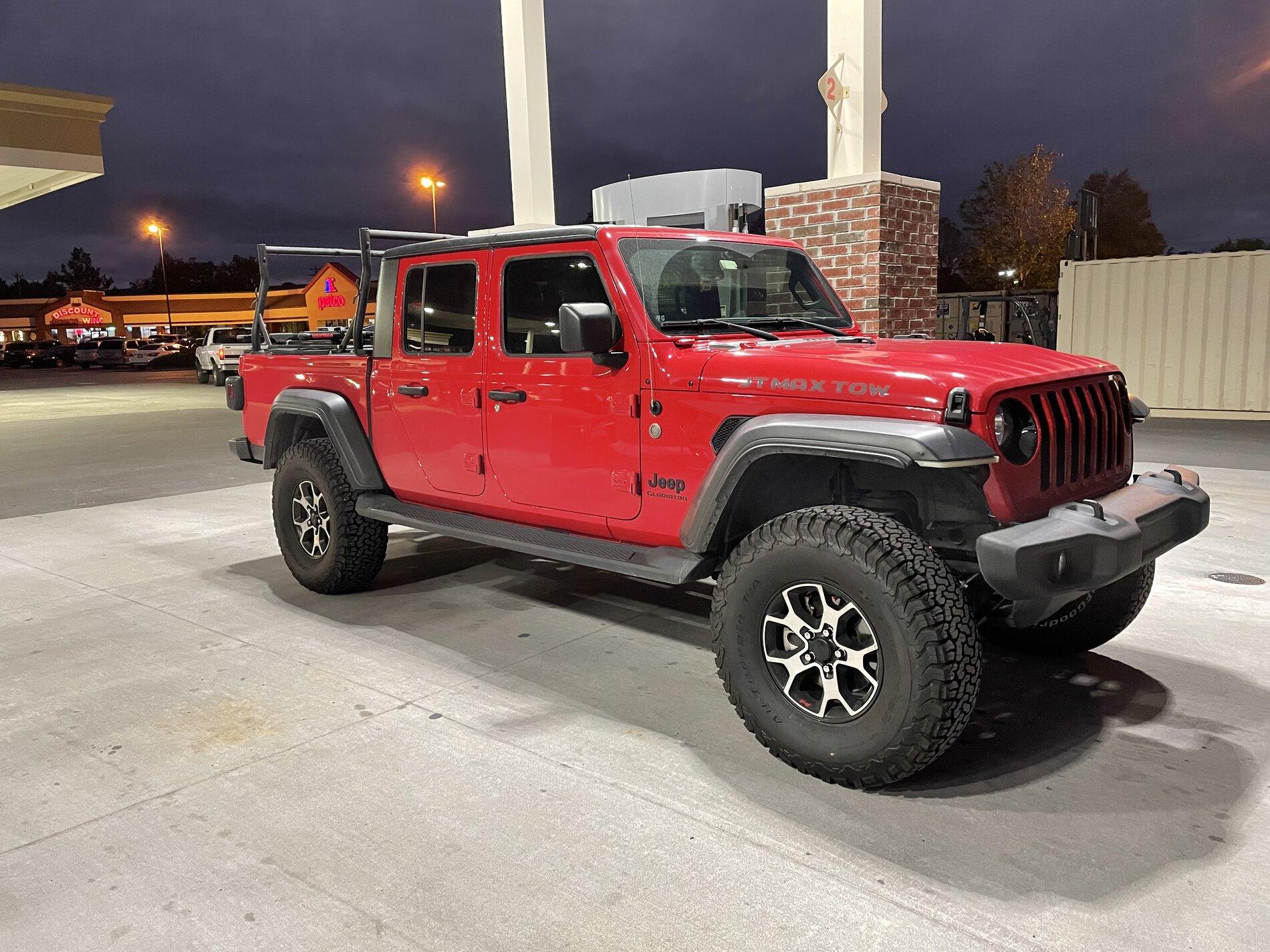

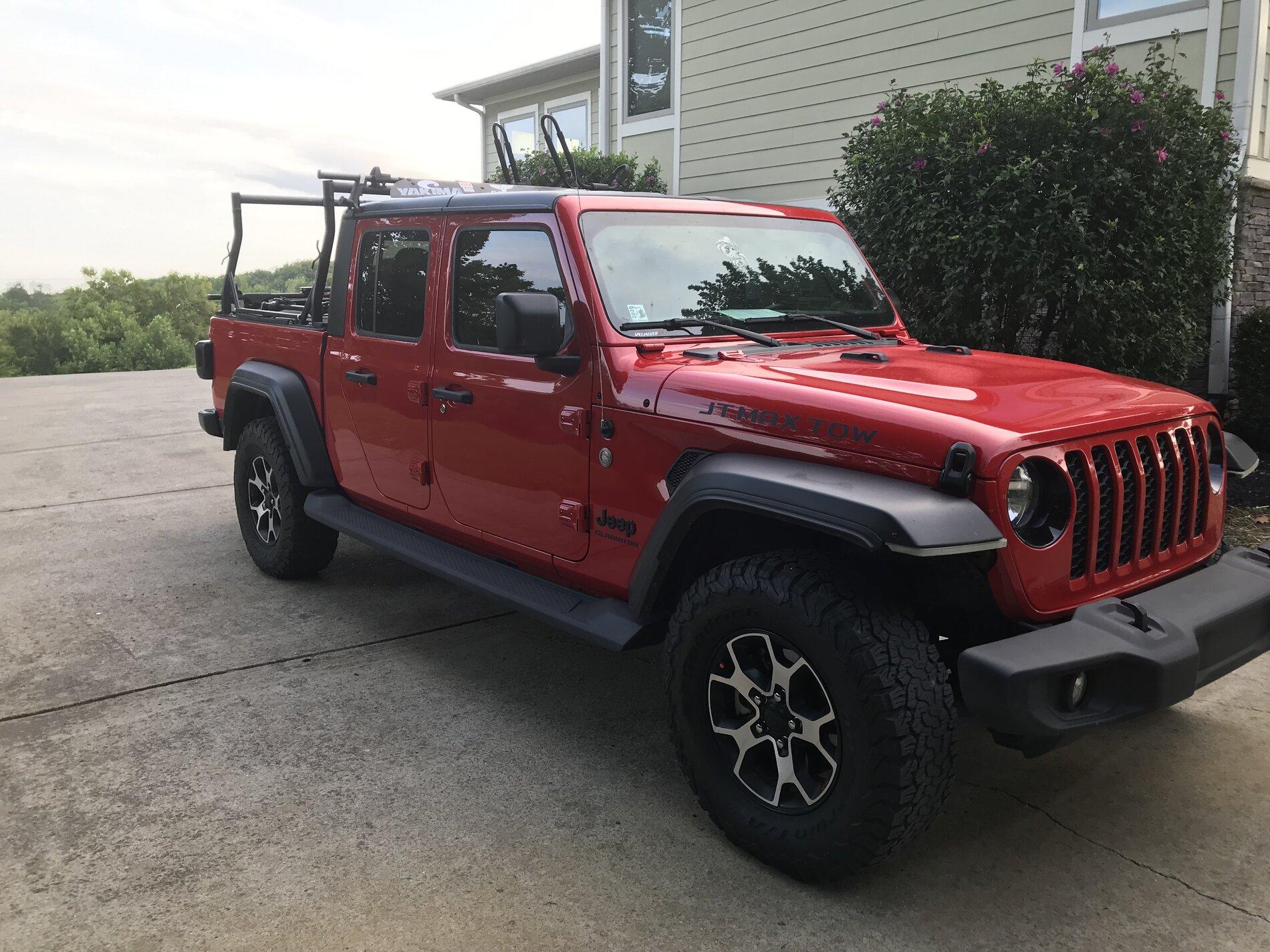

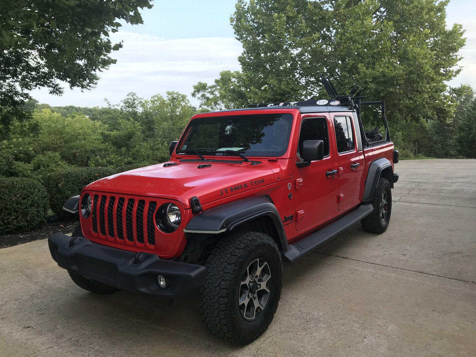

A few updates for the ‘ol Max Tow JT
- Tazer
- 37 x 12.50 x 17 BFG ATKO2s
I ran about 1500 miles with no lift and the BFG s , no rub and ride is very smooth. MPG dropped from 20-21 with th original 245x75x15’s on a trip to 18 mpg with 285x75x17’s and with the BFG 37’s I got around 16 mpg.with the tazer added.
with 4:10’s and 37’s with a tazer the drive is very livable. Still feels like same amount of power, but rarely see 8th gear.
Today I had a 3.5 Rubicon Express lift put on by 4 wheel parts (they always do an excellent job for me, especially since I do not have time to do a lot of work myself). They had it aligned, the lift kit comes with adj trac-bar etc and springs for all four corners and their basic shock.
the ride? Is perfect! Will cruise 70-75 no problem. Feels a little stiffer but that is a good thing as my original suspension started to feel really sloppy after 50,000 miles. You definitely know that you are driving a lifted Jeep on 37’s but it is very stable and comfortable smooth… really smooth ride.
if you’re not looking for a full 37” tire (these measure about 35.8 at 34 psi. The ride is awesome! I love it.
I also got the arcus bumper in and a 10,000lb Smitty Built Winch with Synthetic line. I’ll put that on in a couple of weeks.
the rear sits level now, I do not like it. I will add a 2” spacer for now, but probably add some heavier springs for the rear. I will see what the new bumper and winch do to the front fo
Irate though.
I enjoy the JT more now even though it’s a little slower (still cruises well in the interstate). The 2013 GT Mustang 5.0 6 speed manual convertible is there for a thrill when ever I need that!

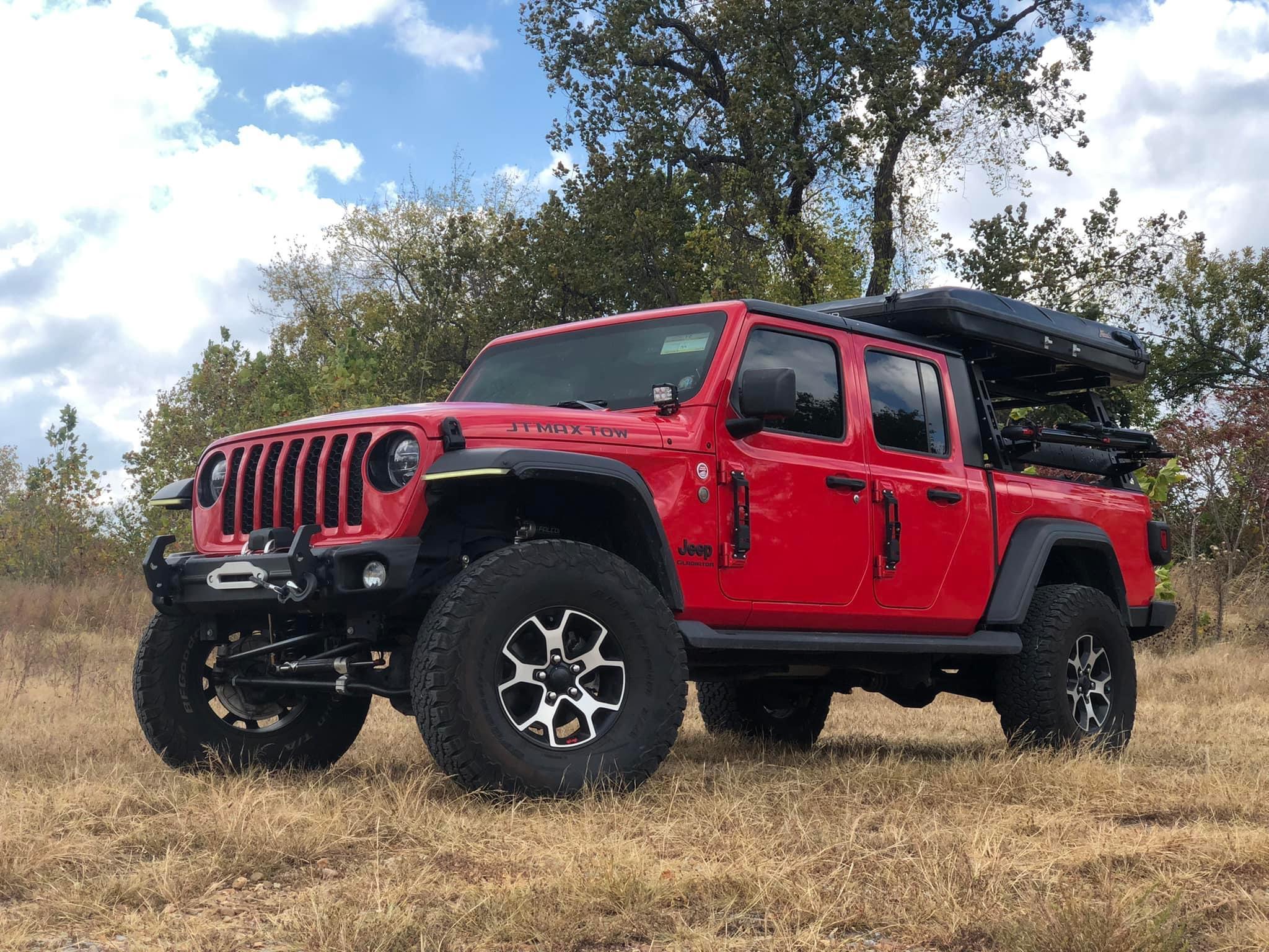

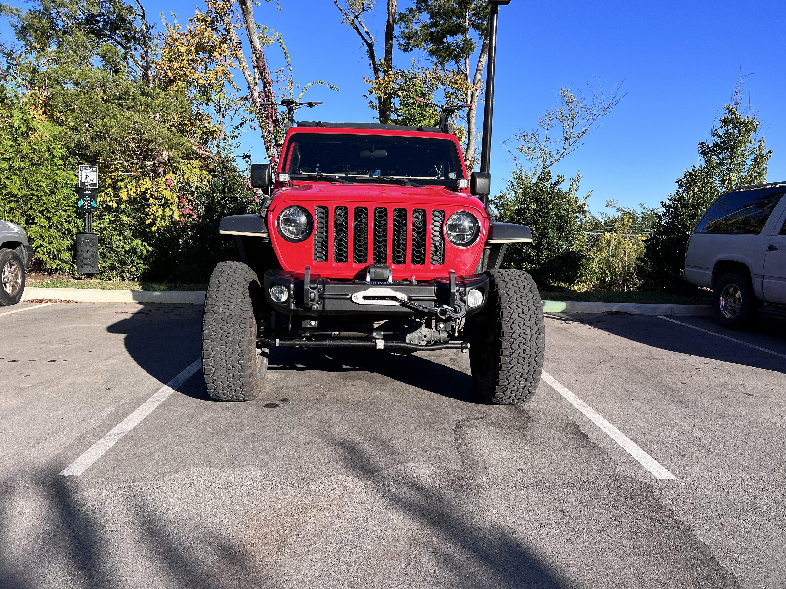

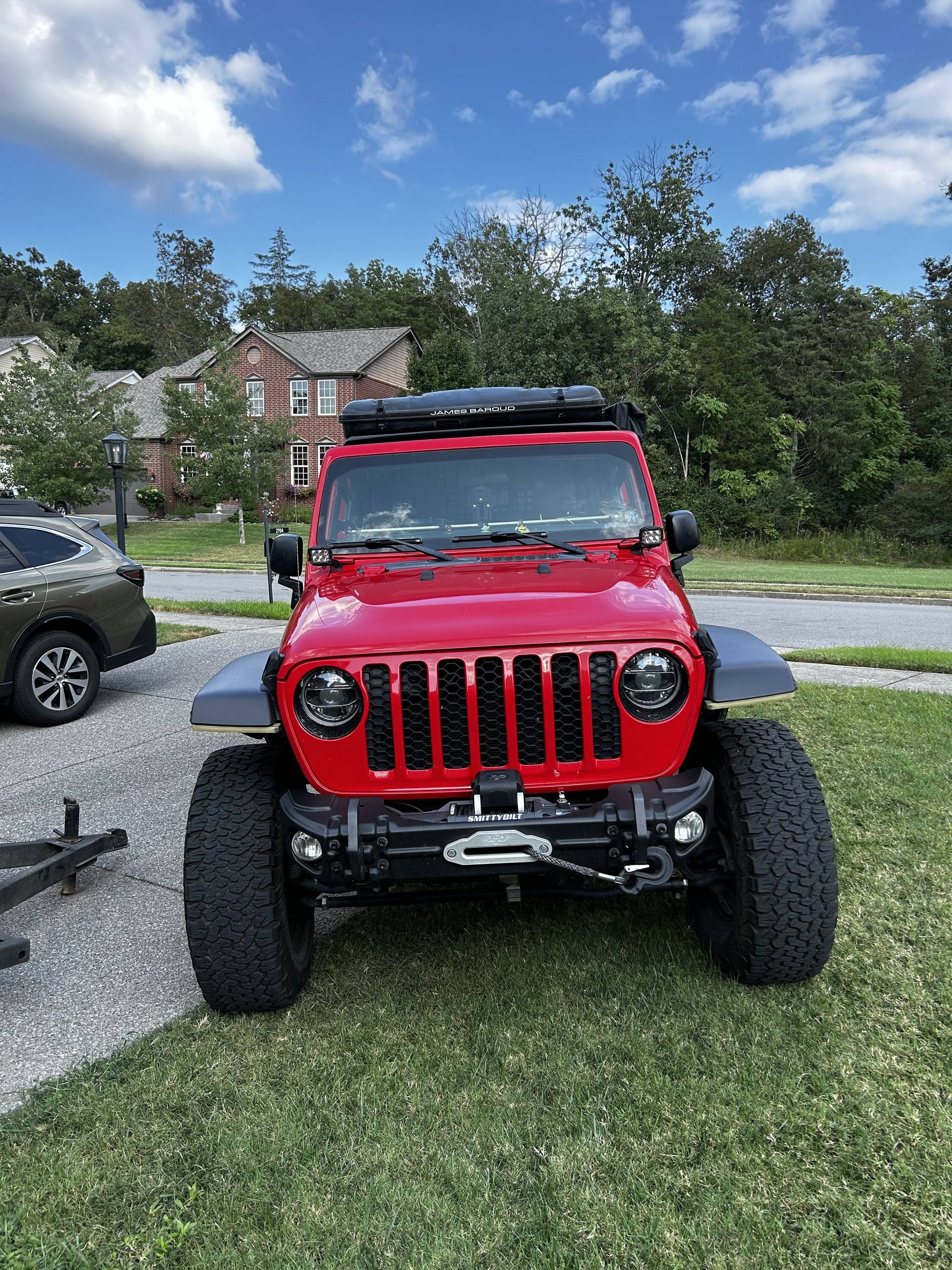

Quick update on my set up… i love it!
The 3.5” Rubicon express lift is really nice even with their basic shocks. I’ve driven about 2000 miles with this lift, 37x12.50x17 BFG KO2s, 17x7.5 Wrangler Rubicon JL rims, taser mini. With 4:10 gears and the taser the JT handles the 37’s with no issue.
MPG’s around 16.
I have a Arcus front bumper and SB synthetic 12,000 lb winch, 2” wheel spacers, black lug nuts, DV8 LED head lights and Diode Dynamic HID yellow fog light bulbs, as well as new Oracle LED tail lights yet to install.
This set up is absolutely awesome and very reasonably priced for 37’s. This could be a daily driver, though my JT is not a DD. With Taser and 4:10’s I can see 8th gear in flats on interstate, 7th on hills to 5th on steeper hills. I feel like there is plenty of power and cruise smoothly at 70-80 mph.

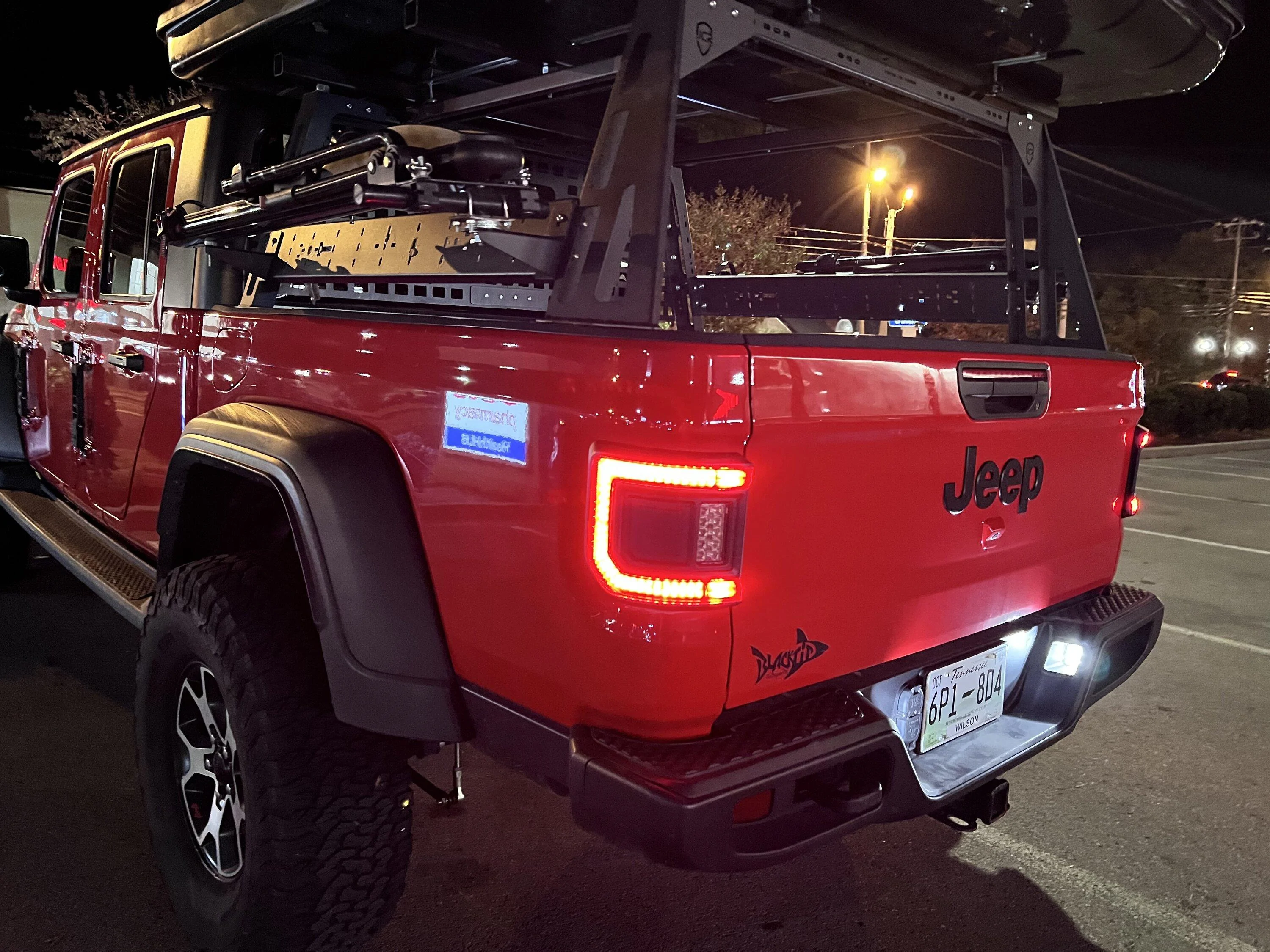

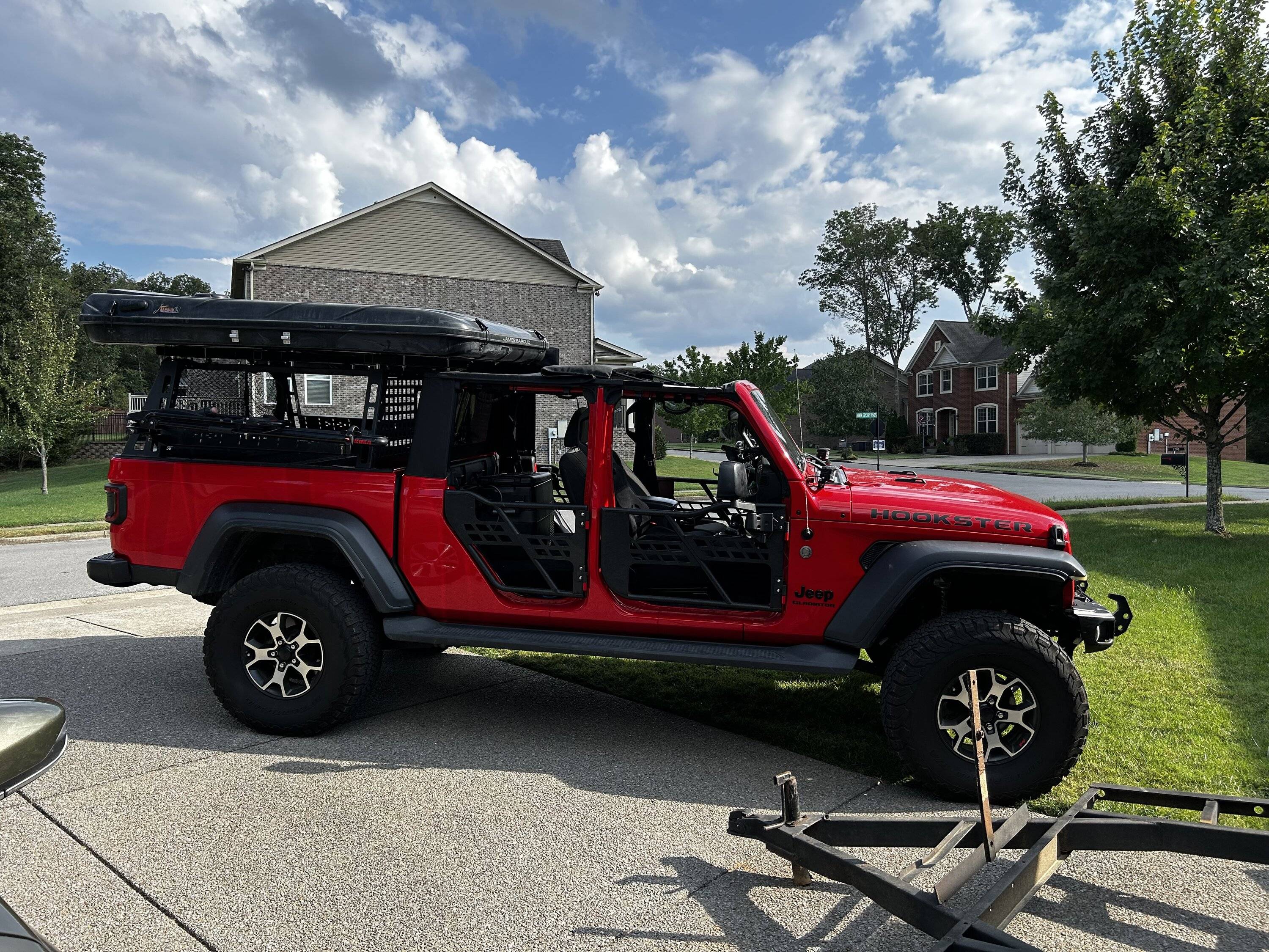

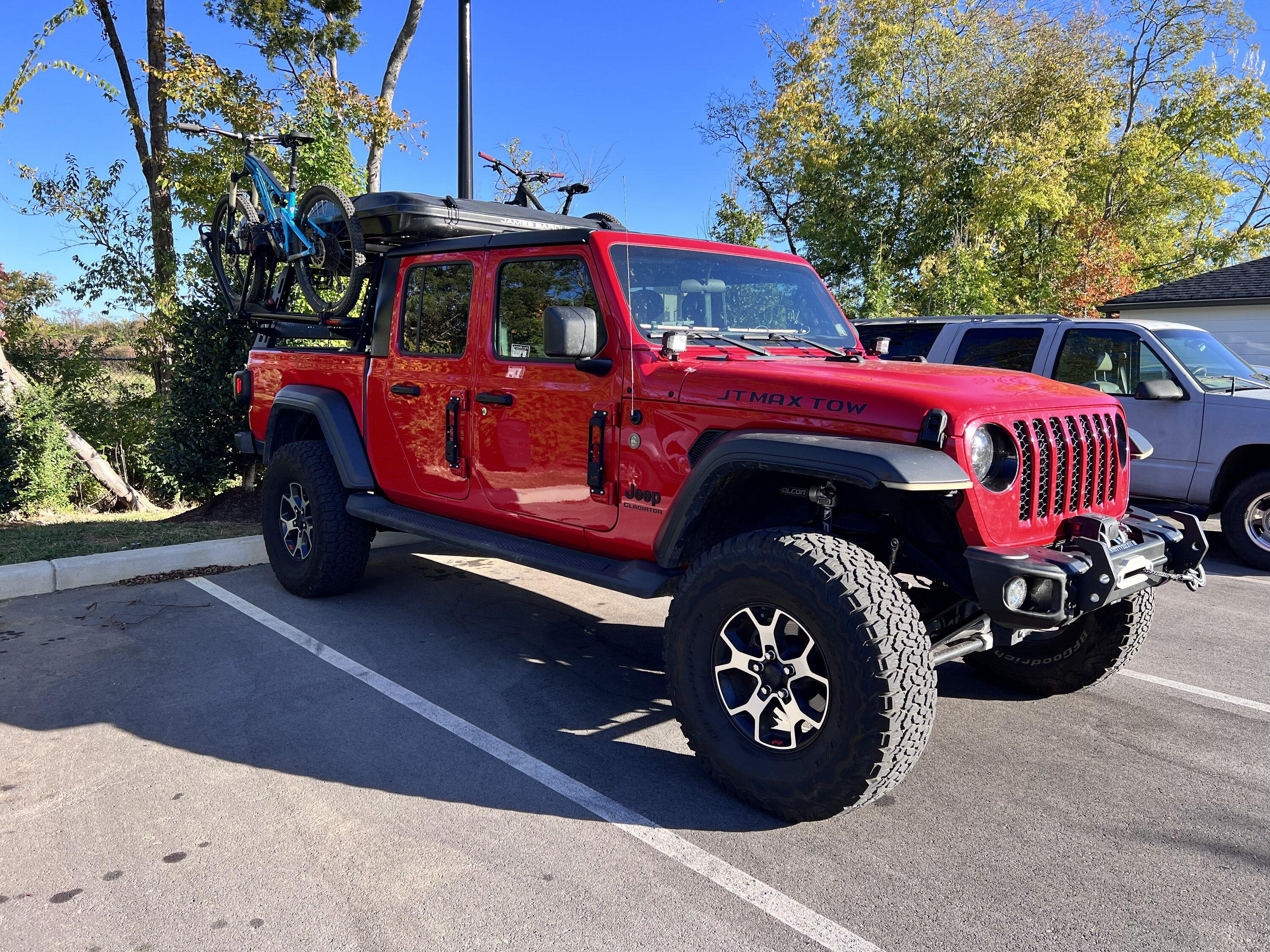

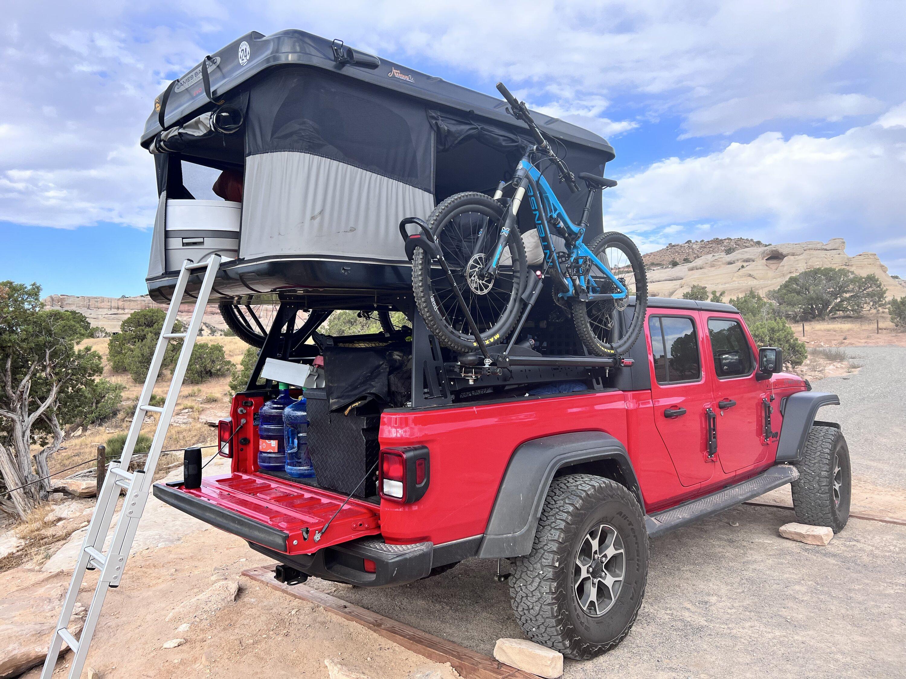

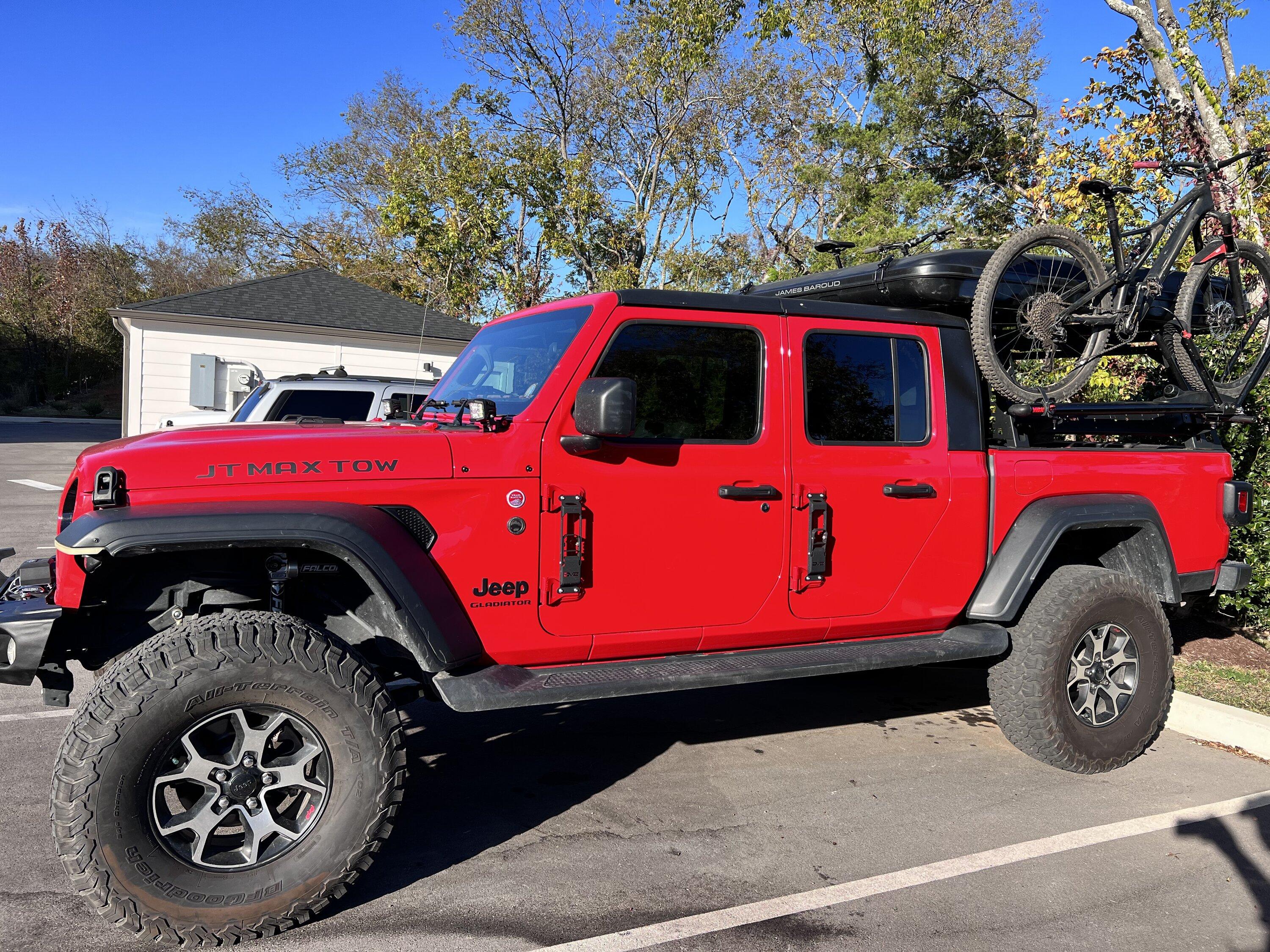

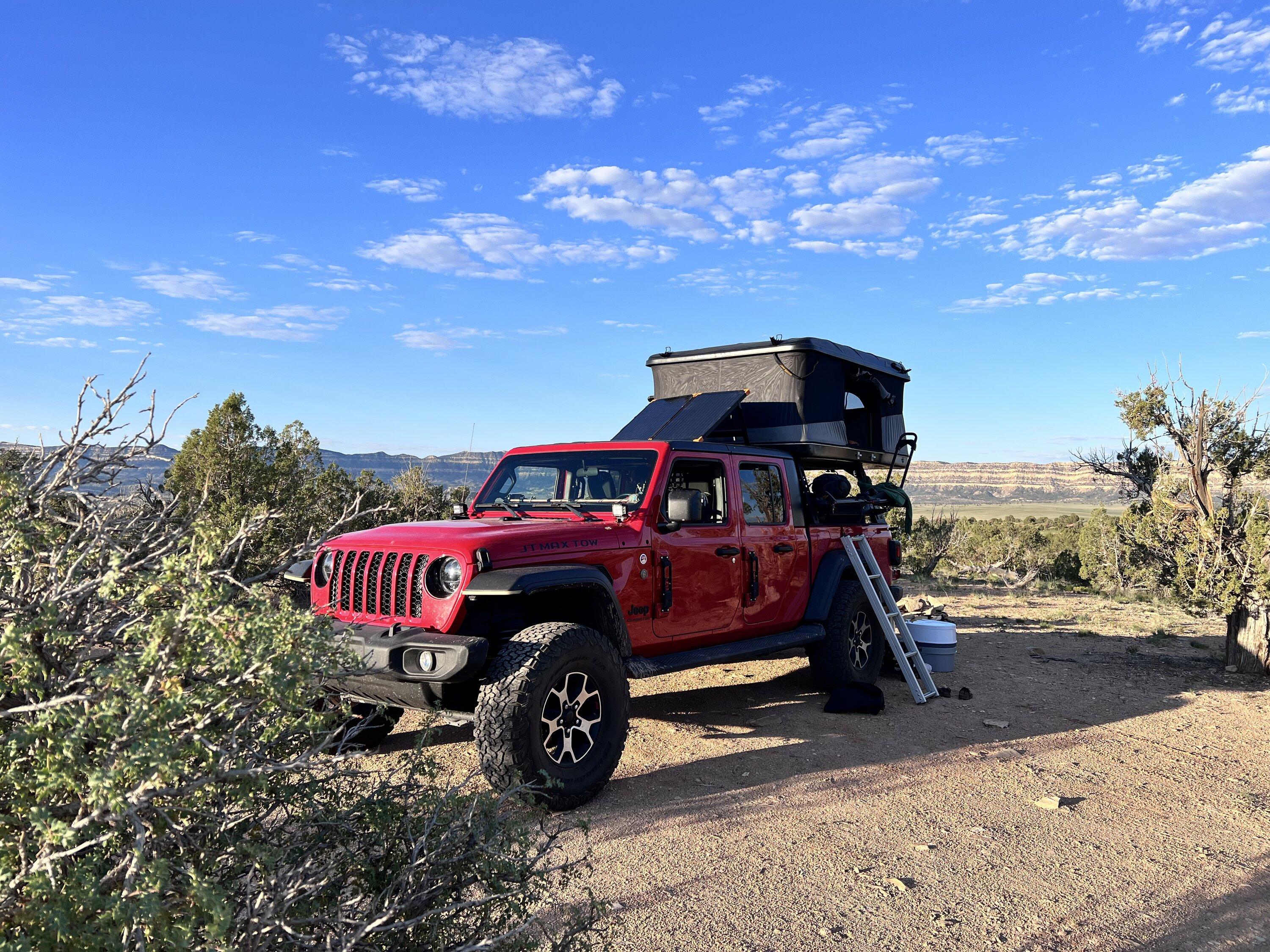

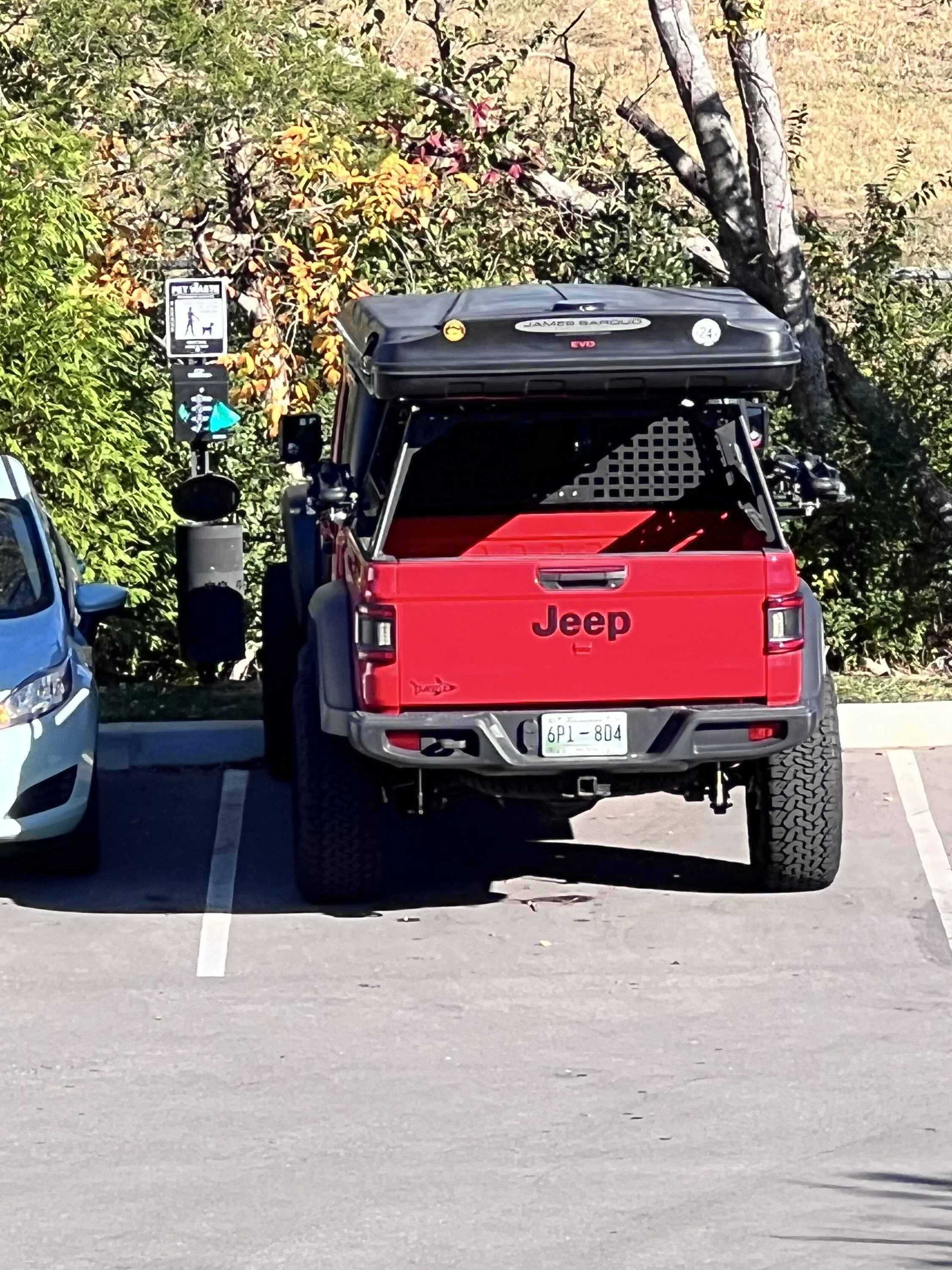

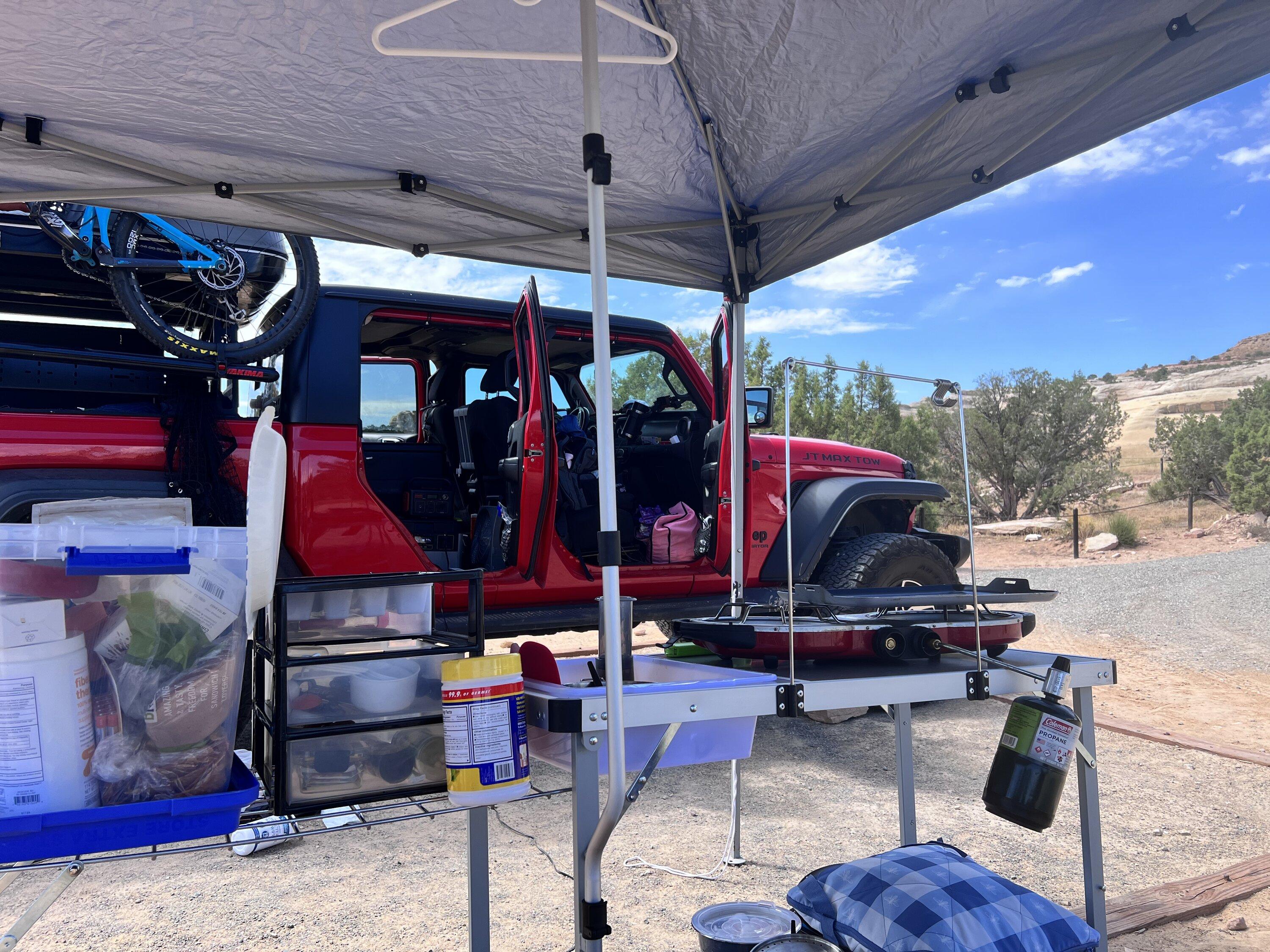

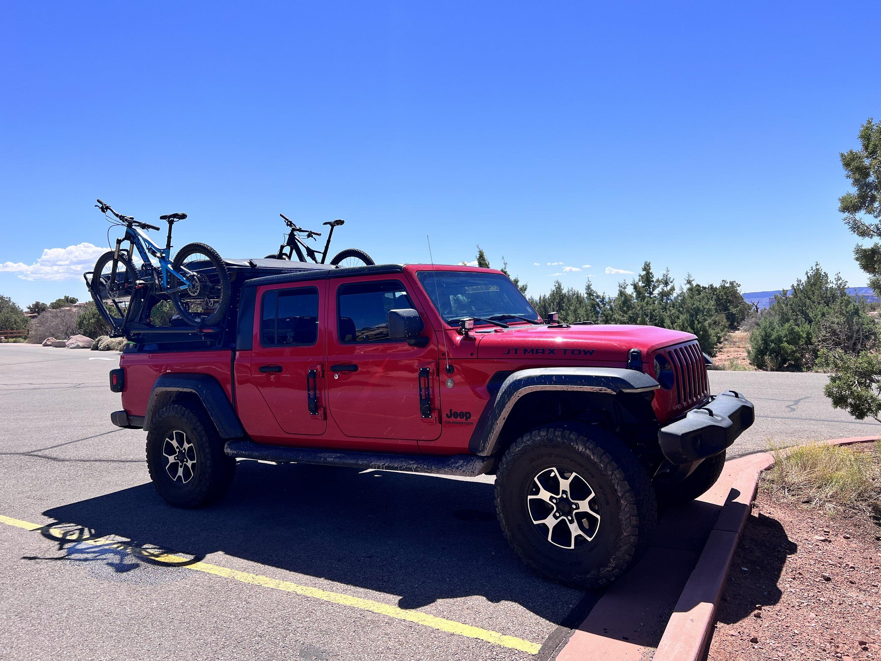

So… ? … a lot has happened!
I lost my job in May, suddenly fired for reasons I won’t discuss on here. They had nothing to do with my job performance.
I decided, screw it I’m taking the summer off (I have money saved up and after the crazy year needed to stop and think for a while).
I have been all over Michigan, Wisconsin, North Dakota, Utah, Wyoming and Colorado this summer.

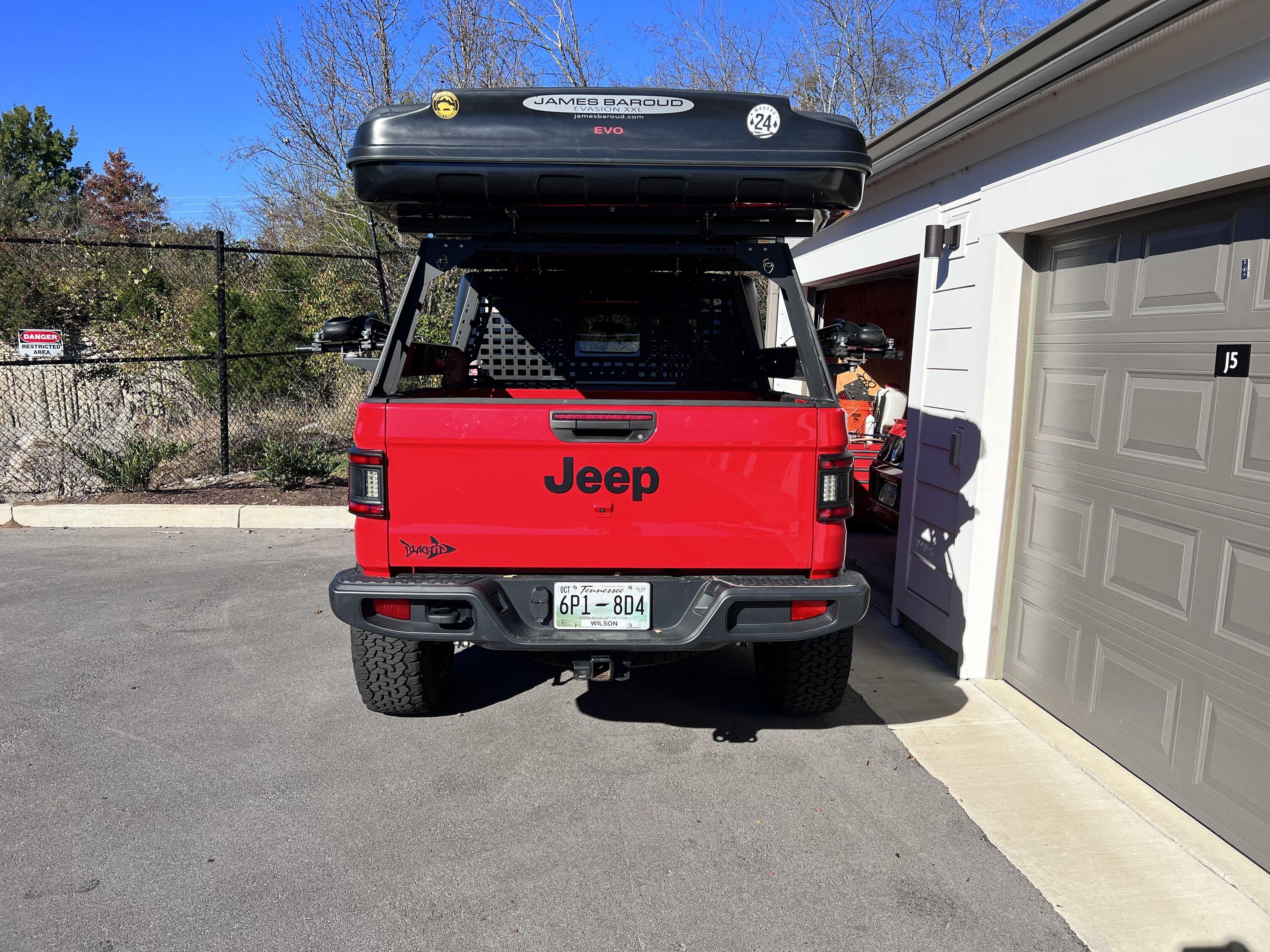

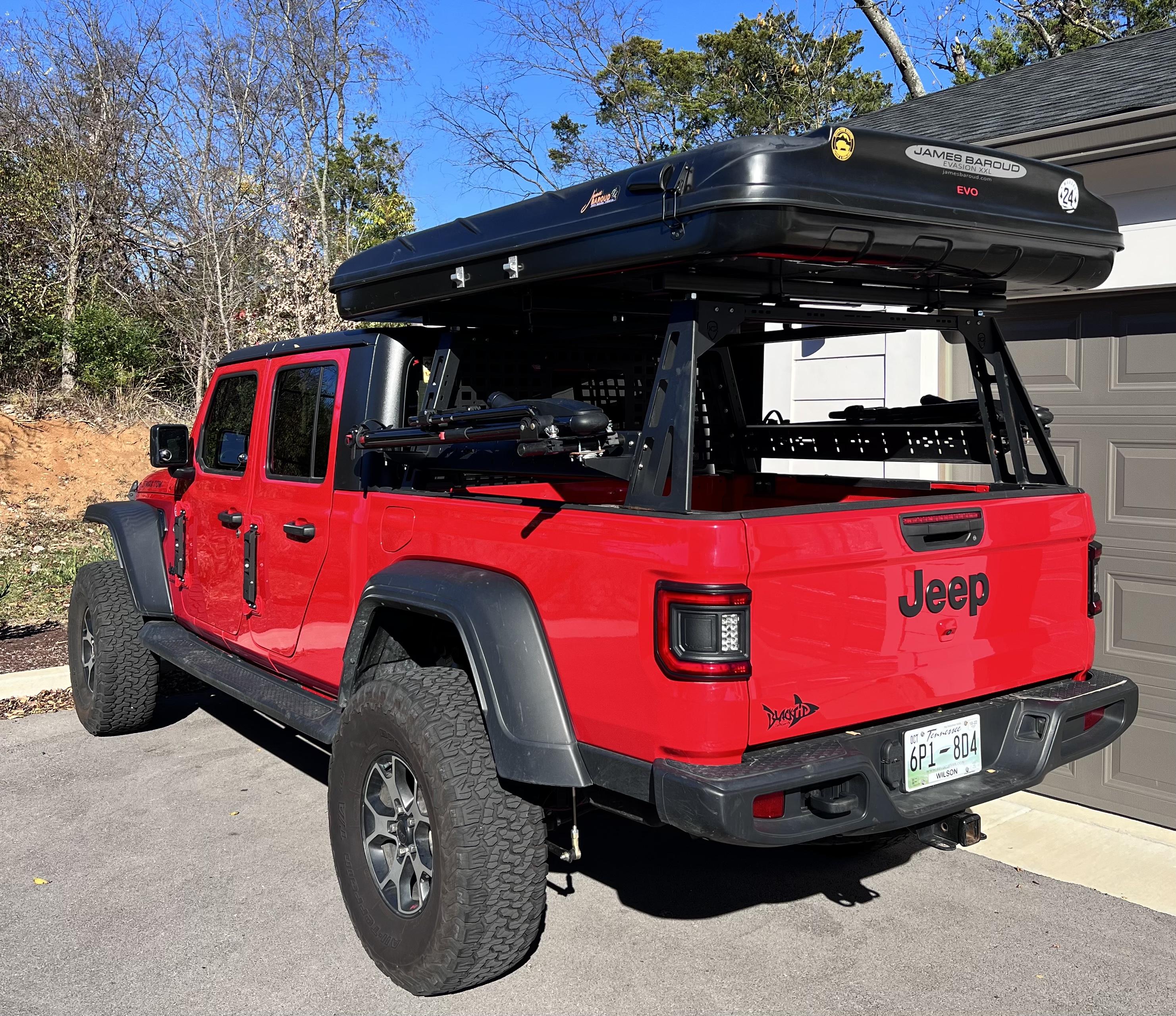

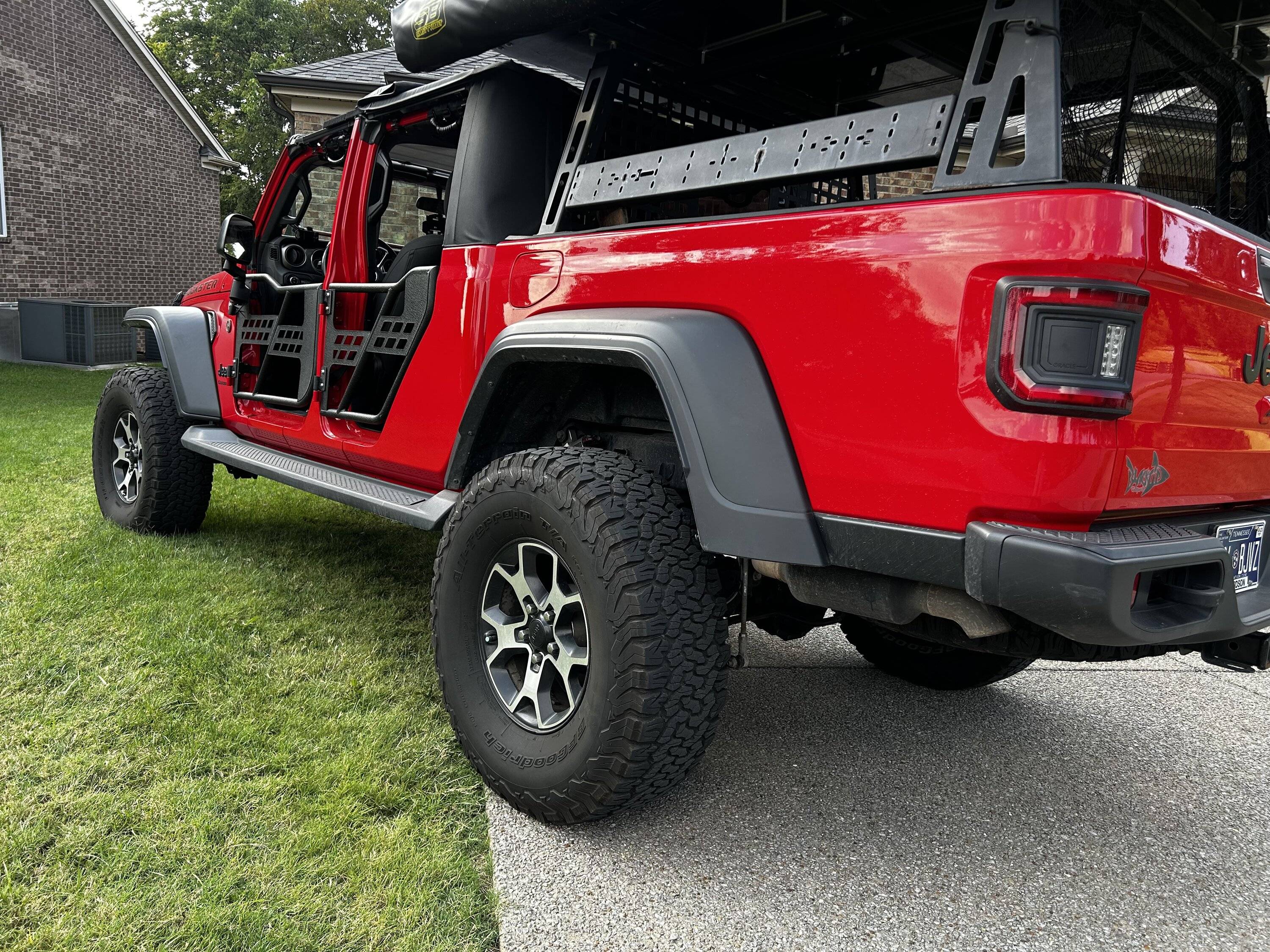

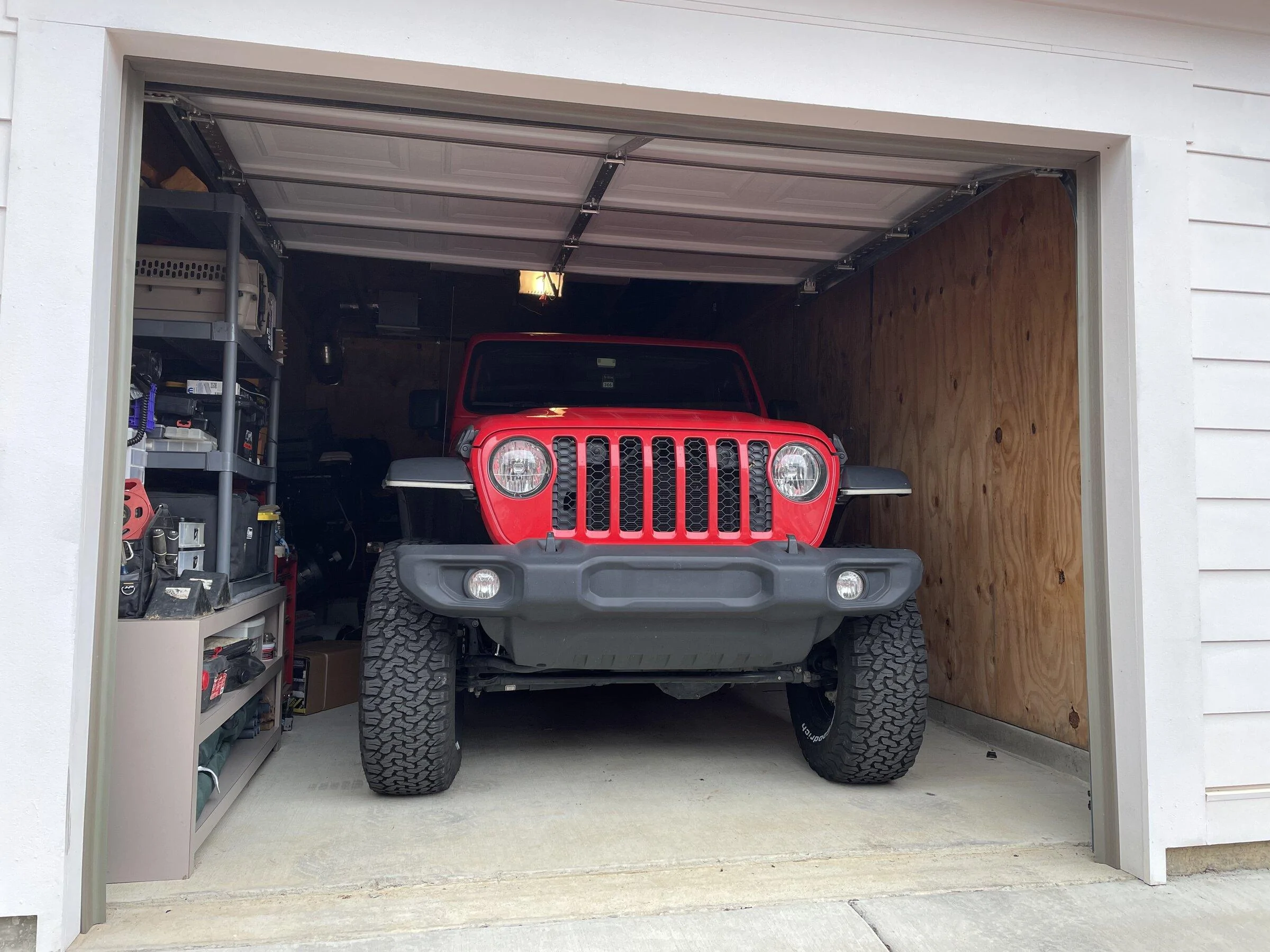

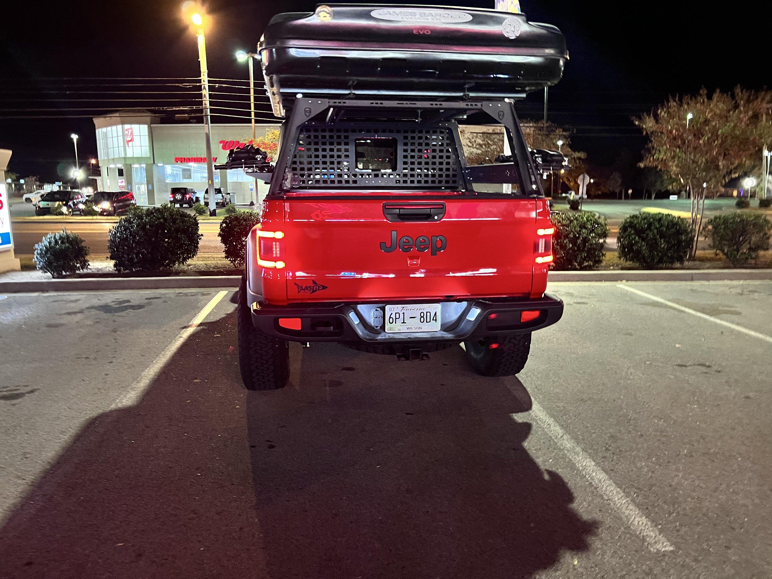

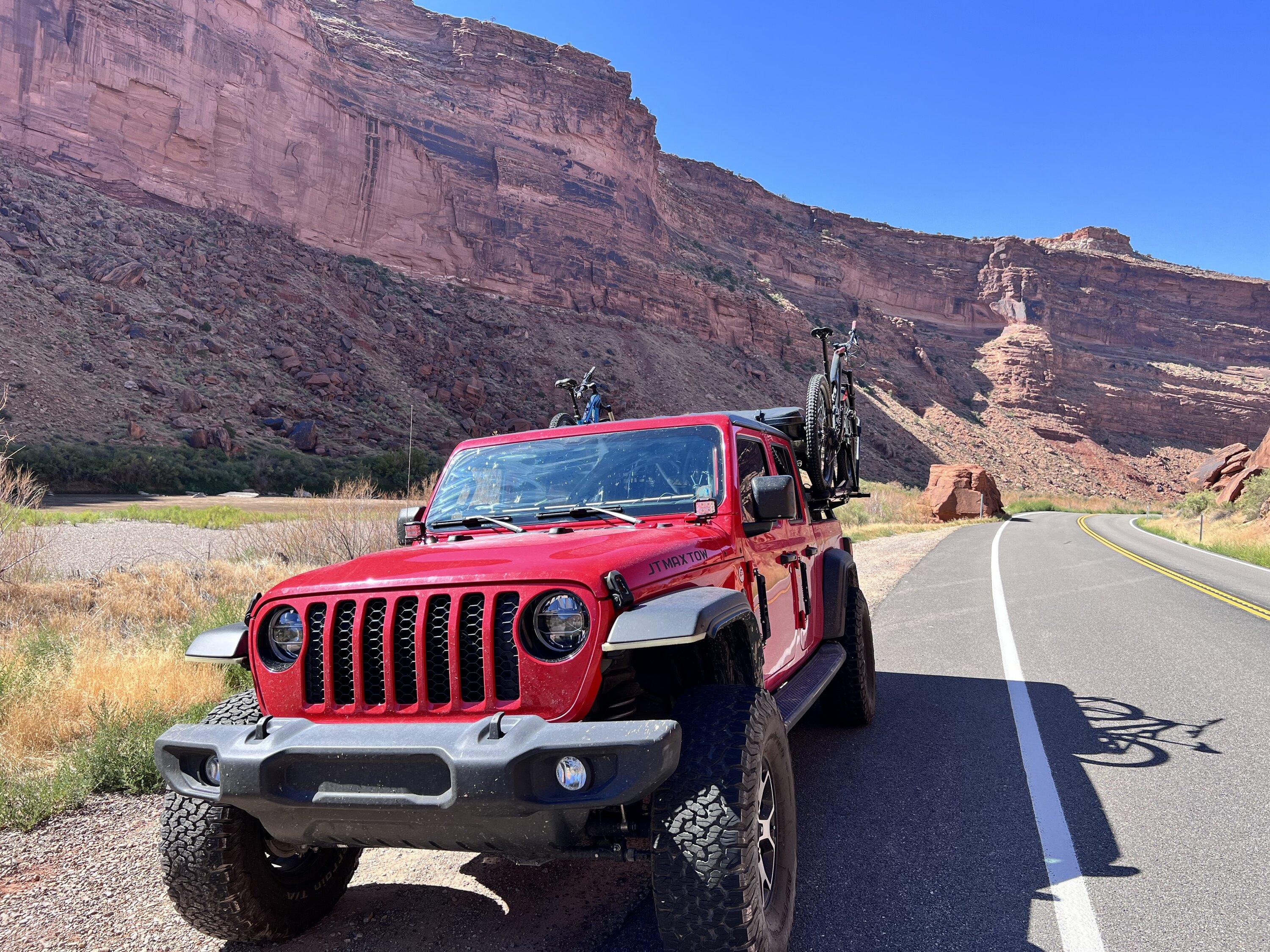

The build ;
-added a JB EVO XXL RTT
- Goal Zero 1500
-100w solar panel
- refrigerator
- JCR Full height rack
- and some other camping items to go off grid on BLM out west.
This was a fantastic summer and I am glad that I just stopped the madness and left.
The Bad with T;
- The Rubicon Express Lift is not meant for my heavy towing and overland setup.
- when loaded I was on the RE rear bump stops so I took those off and installed a 1” spacer lift in the rear to get me through until I figured out what to do for a fix.
- the fix will end up being Clayton full overland 3.5” lift (I hope it fixes my rear sag and loose ride). I am also finally having the front Arcus Bumper installed as well as the SB 10,000lb winch with synthetic line.
The RCR rack was too low to allow RTT to ride over the truck cab. I hade to raise the using 3 square stock 2” steel cross bars that I made (still had to add a 1” spacer). I really want to be able to swap hard top for soft top in the summer. I am hoping there is a no “man bun” option coming soon.
I’m having the JCR rack modified to add a rear open lift gate. Also am having an engineered lift made for the RTT while on the JT. This electric lift will have a HD aluminum rear hinge and two front electric lift actuators that will allow the front of RTT to be auto tilted up in the front to allow the hard top to be removed and soft top installed.
Hard maybe to visualize but the JT is in the shop for a few weeks and I will get her back out after I get back from more travels. Some for fun and some for my new job (Oh well, I’ll have to drive the Mustang Convertible Coyote 5.0 6 speed manual some while I await the next phase of the JT to be completed.
I have a bunch of small projects to complete when I get the JT back. I will post up some pictures then.

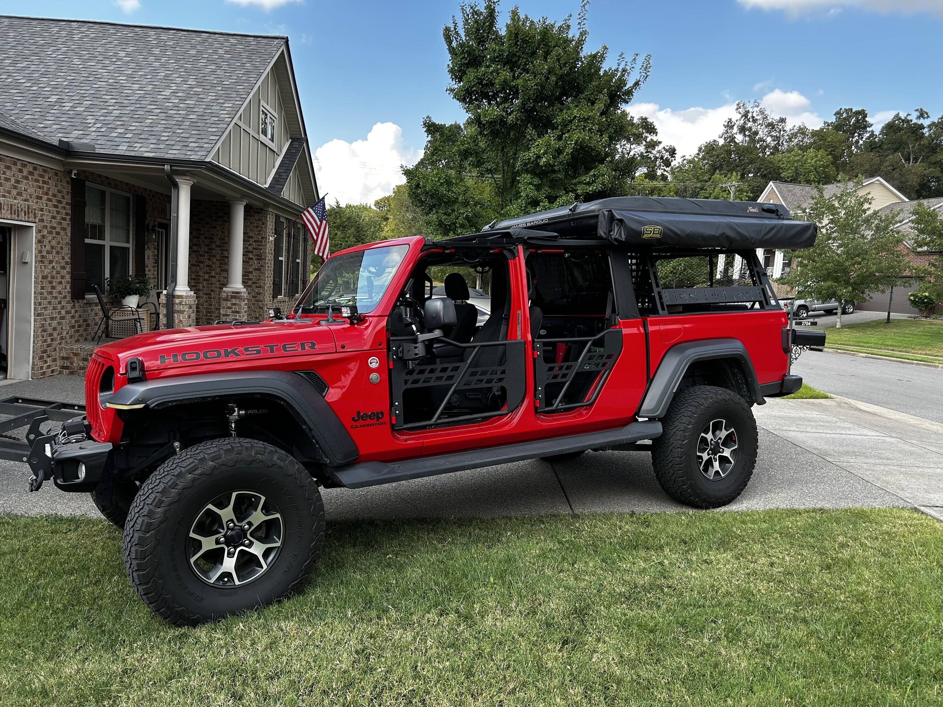

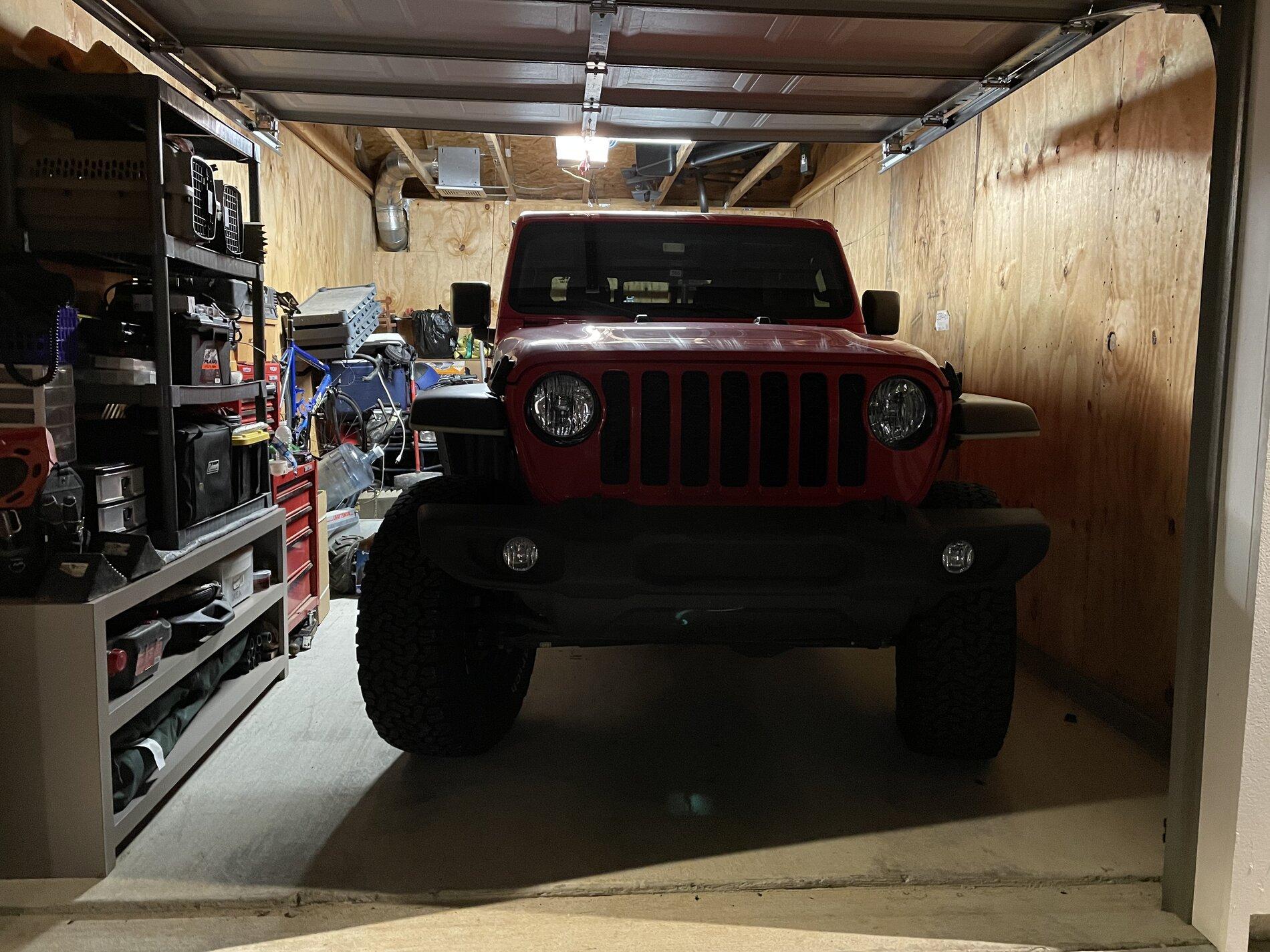

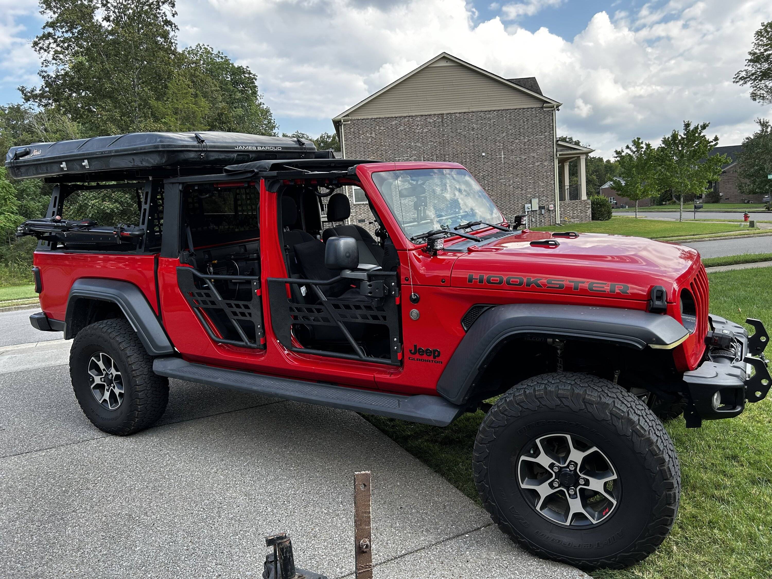

Well, I am still out of town and the JT has a new 3.5” lift (Clayton Overland with falcon shocks) new bumper and winch. Tomorrow parts for RTT lift to change hard top to soft top and back should be in tomorrow.
TN Off Road put a pic on FB today. Will have to do until I get back home to see ?ster then.
Jeep Gladiator 2020 HOOKSTER ? 362690C8-3CE3-4E61-A016-1093F7D62F41
XJADDICTION
XJADDICTION
Dec 16, 2017
821
1,669
TN
2020 JT SS Max Tow, 2005 WK Hemi, 2013 Mustang GT
Surgical CSFA
Couple of new pictures. Drove it today for the first time and Clayton has it right. The Overland 3.5” lift with Falcon Shocks is incredible!

Finally added the Oracle tail lights! I absolutely love these! They are very bright and IMOP look better than the fancy LEDs the factory sells.
I know the Max Tow haters will be so happy, I have the new “HOOKSTER “ hood decals so the Max Tow will go. I also have the rear tailgate and light surround satin black out wrap as well as the GLADIATOR raised red outlined tailgate emblem to put on. I still have the HID fog lights to install and the hood lights and rack lights to hook up.
Jeep Gladiator 2020 HOOKSTER ? CD8C097F-6F64-4338-B221-A2678BD2FBD8
Jeep Gladiator 2020 HOOKSTER ? 6C1A8C3C-AED4-44DA-8E36-03104339A7F5
Jeep Gladiator 2020 HOOKSTER ? 1B7571FD-EF06-49A3-B56B-15502AAB9055
Jeep Gladiator 2020 HOOKSTER ? 389BDCDA-275C-4E44-9003-D8A7AF7968BC
Jeep Gladiator 2020 HOOKSTER ? 7C5CFD8E-BDDB-4361-9B8B-00A50016D2FB

I have done a few more fall mods to Hookster and I still have a bunch of stuff to finish.
So, here it is with the voyager soft top and steel tube doors.
Jeep Gladiator 2020 HOOKSTER ? IMG_3353
Jeep Gladiator 2020 HOOKSTER ? IMG_3351
Jeep Gladiator 2020 HOOKSTER ? IMG_3348
Jeep Gladiator 2020 HOOKSTER ? IMG_3354
Jeep Gladiator 2020 HOOKSTER ? IMG_3358
