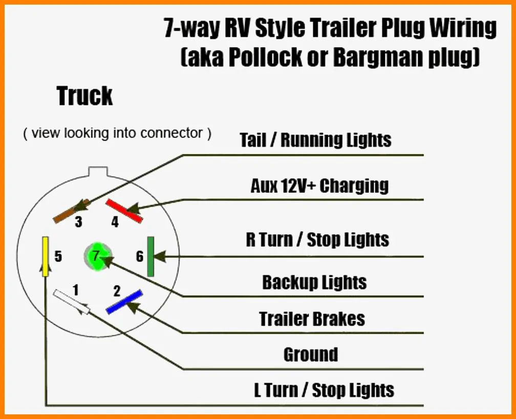

As above, I'd start by checking the ground (#1 in the image). Check continuity between the plug #1 on the JT and a known good ground on the JT (like the frame). Also check the same on the trailer (the mirror-image for #1) and a known good ground on the trailer (maybe its frame).
I'd lay odds that one or both have a disconnected or missing ground wire. It works on the other vehicles by grounding through the hitch. Your new JT has too many freshly painted parts to ground.
