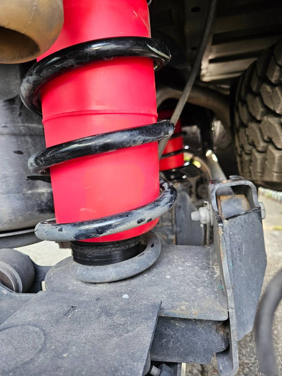

First, thanks everyone for your input/ideas. I went with the red airlift bags and I got the redarc liberty brake controller. I did my first trip fully loaded in the camper and bed. My test drive with 15psi in the bags but I still had too much bounce. I ended up putting 25psi and that made a huge difference. The trailer brake works great and install was pretty simple. It did great towing 35mins to our campsite. The next trip its going on it to Bantam Fest, which is about 1hr and 40mins from me. Hopefully everything goes to plan. I would like to upgrade the rear sway bar before I leave though, just to see if it helps any. I will be buying the Timber Grove air spring kit (19'-UP JEEP Gladiator Rear ASAM 2nd Gen Air Spring Kit (SQ6466100)) here in a few weeks, just for a more permanent solution.
